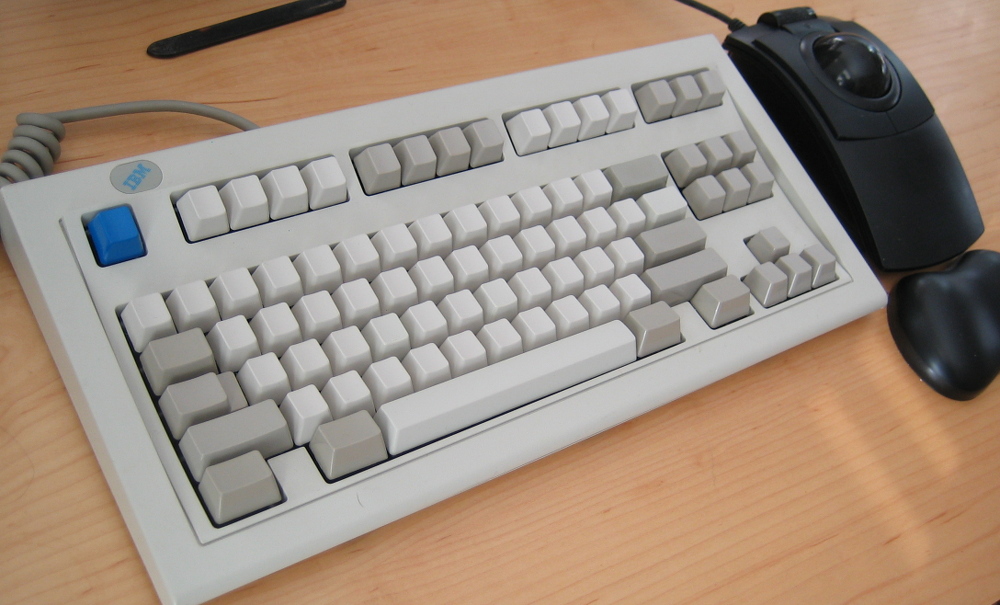

by ne0phyte
Got a blank set of keys today. It looks really good :mrgreen:

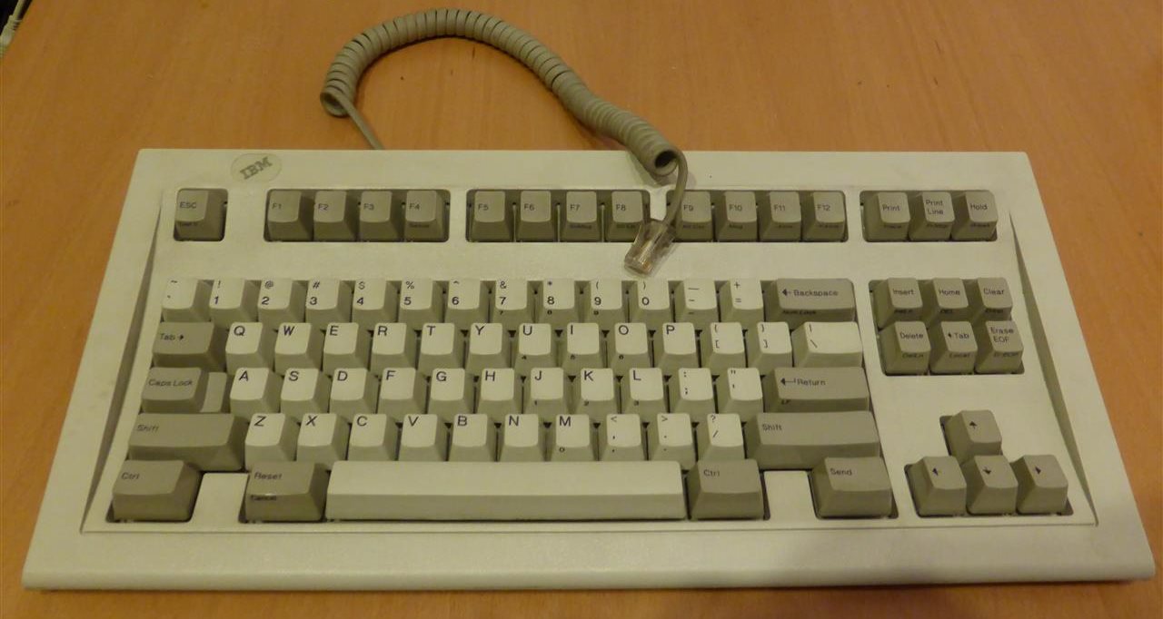

by Halvar
Thanks to a pointer from Muirium in the "why not us" thread, I was able to get a terminal SSK from a seller on ebay UK. It originally had an RJ45 connector and a fixed cable. I was lucky, the keyboard seems to not have seen a lot of use -- the springs feel great, and there are no broken rivets, bent springs or other problems. Sorry for the somewhat poorly illuminated pics.
Terminal SSK
Terminal SSK
terminal_ssk (Custom).jpg (110.49 KiB) Viewed 11727 times

I originally planned to use a Soarer converter to connect it to my PC. However, when I took a closer look and opened it I found that the key layout is identical to a PC SSK, and the two membrane cables that connect to the converter look the same and have the same positions as in a normal PC Model M.

And what can I say -- it works like a charm! The matrices seem to be just the same between the Terminal SSK and the classic fullsize PC Model M. All keys and also the membrane contacts that are not used in the ANSI layout work flawlessly.

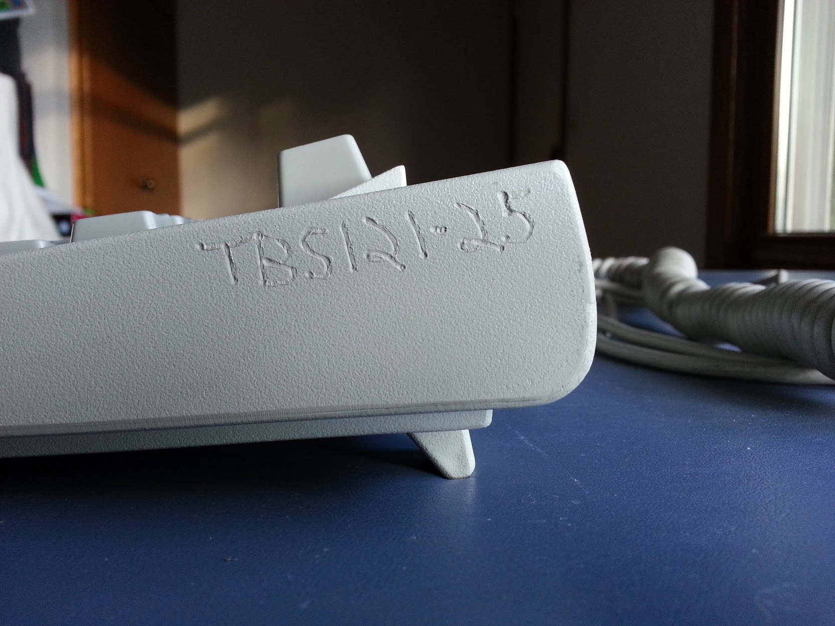

Posted: 21 Oct 2013, 14:46
by Game Theory
but engraved
Posted: 21 Oct 2013, 22:57
by Muirium
Evil, but not nearly as bad as scrawling on the top.
Just imagine the computer lab where there were 25 or more of these! It would be like visiting Webwit's place.
Posted: 22 Oct 2013, 16:59
by litster
I think this is one of the ones from Bryan_Twizzle on GH maybe 1.5 years ago. He had a bunch for sale from his dad or a relative. I bought a couple of SSKs from him. He even threw in a silver square lab Model M when I bought the second one. They were all dirty but after a clean up they all look like new now.

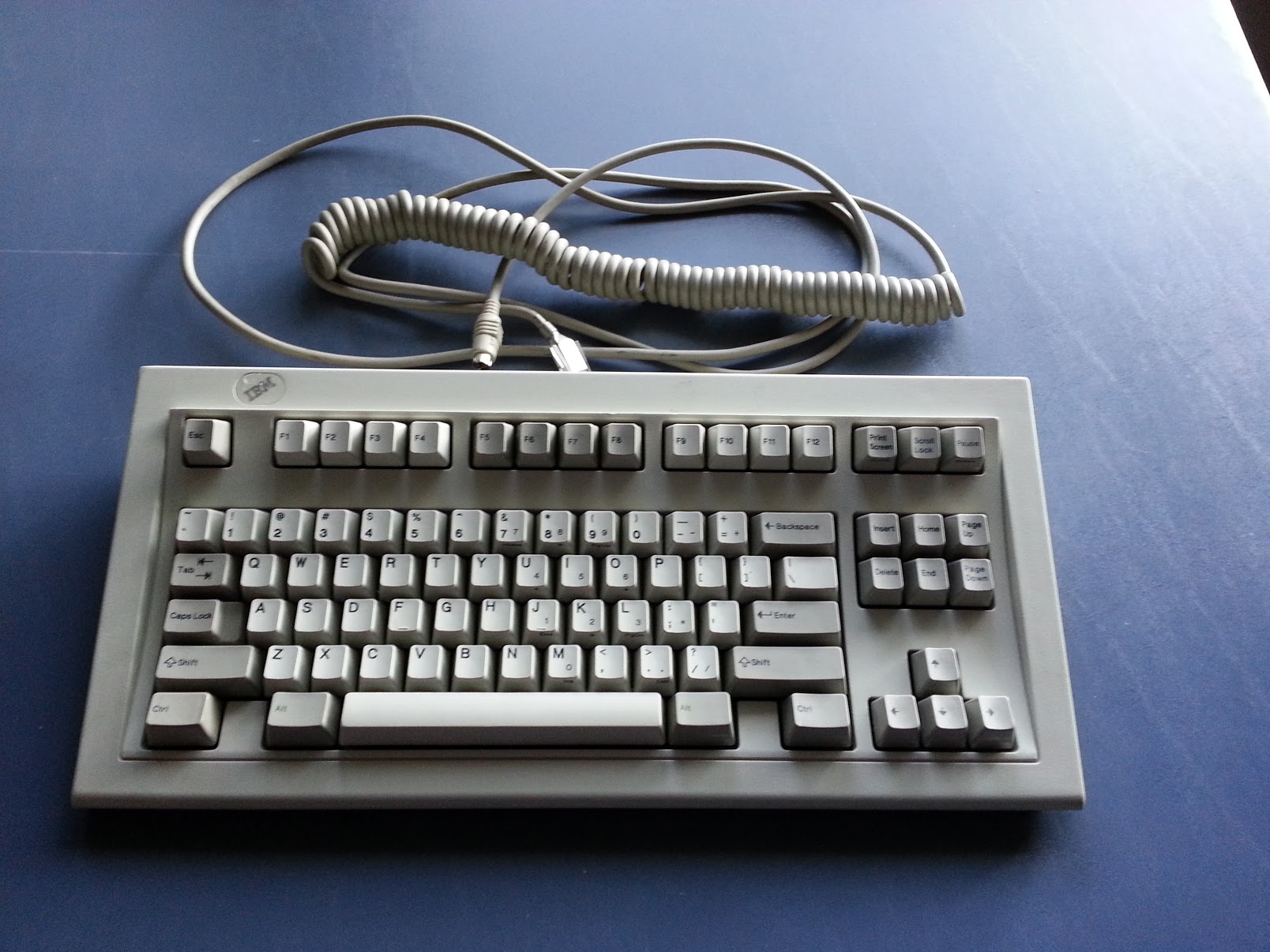

Posted: 08 Nov 2013, 17:42
by nourathar
recent arrival:
Looking at the other picts in this thread I wonder if there's a difference between those with black logo's and those with blue logo's ?

Posted: 08 Nov 2013, 17:53
by Muirium
Blue labels are the later Model Ms. Of all sizes. I think grey label was the one before that (where the logo is grey on beige plastic) and silver labels are the oldest of the three (where the logo is on a shiny silver square). Today's SSK (from the same batch as yours) is my first blue label IBM. I've several grey labels now, and one silver label PC/XT Model F.
Don't think there were SSKs back in the silver label days, but this is exactly the place to guess out loud and have someone show a picture as proof of the opposite!
