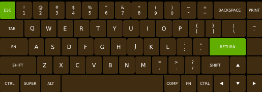

BrownFox layout is an mx mini with the bottom row 1,25-1,25-1,25-6,25-1.5-1.5-1-1-1 and without the 2° row?
Backspace is 1u?
Posted: 05 Jun 2013, 19:37
by matt3o
Muirium wrote:Blank PBT DSA: now that's three things I like. I could definitely redesign for that. Could you give me a list of all the keys, by any chance? I'm going to get creative.
Quite right about the space bar, I forgot you put the Teensy there. What's the suggested width?
Keys will be a standard 104 ANSI (+ maybe tsangan, 1.5 mods and 7u spacebar)
I'd say the minimum is 6u.
pasph wrote:BrownFox layout is an mx mini with the bottom row 1,25-1,25-1,25-6,25-1.5-1.5-1-1-1?
mx mini with 1.5, 1, 1.5, 6, 1.5, 1.5, 1, 1, 1
but also what you suggest would be feasible.
Edit:
brownfox

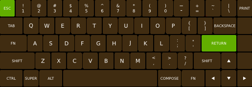

your layout is really beautiful but
6 spacebar not really that standard
1 backspace?
Posted: 05 Jun 2013, 19:45
by matt3o
pasph wrote:your layout is really beautiful but
1 backspace?
fortunately I have quite a few 6u spacebars after DSA retro :) but a more standard layout is feasible.
backspace can be 1u, 2u, or 1.5u in place of \| key
Edit:
this is a "standard" alternative

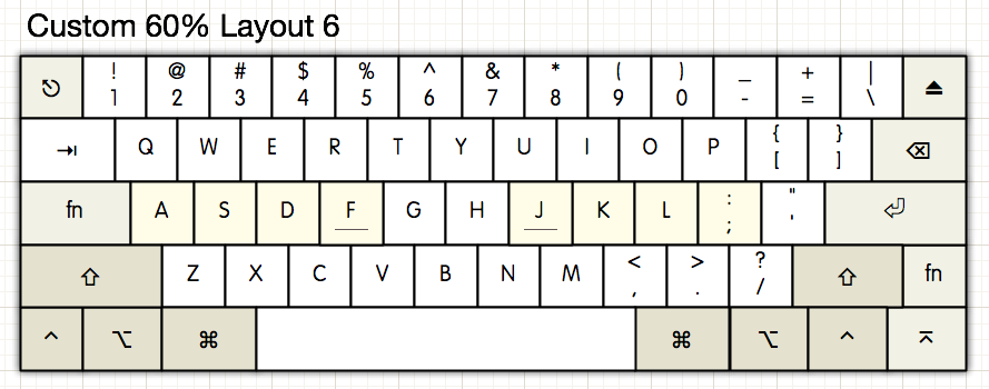

Right, this is my 6u space bar adaptation:
Custom 60% Layout 6
Custom 60% Layout 6
Picture 1.png (46.94 KiB) Viewed 10067 times
It's almost standard ANSI above row 1 except for the right hand shift, which is HHKB / Pure style with an extra 1u key to the right. Have you got the caps for this Matteo?
Are all the row 1 keys round profile on DSA or is it just the space bar? I can't tell from the PDF.

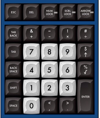

I'd be interested in getting a plate cut for a numpad, if that would be possible in your run. I'm going to be using Matias switches, and I have no idea where to begin with the CAD drawing so that the holes are the right size. I'd also be potentially interested in doing a version for Honeywell hall effect switches.
Numpad
Numpad
Posted: 05 Jun 2013, 23:29
by Muirium
If there's anyone who can use up a whole sheet, you're the guy!
From small numpads, great numboards grow.
Posted: 05 Jun 2013, 23:37
by matt3o
Muirium wrote:Good on you Pasph.
this is doable, but if you want to go all blank you can't use dsa retro.
jpatters wrote:I'd be interested in getting a plate cut for a numpad, if that would be possible in your run. I'm going to be using Matias switches, and I have no idea where to begin with the CAD drawing so that the holes are the right size. I'd also be potentially interested in doing a version for Honeywell hall effect switches.
problem with Matias is that we need a 1mm sheet plate, so we would need some orders just for that.

Left shift and return are indeed >2u. I'd rather not split them into smaller keys. I'm good so long as you've DSA caps for them, my preference being brown and with the correct legends! Got any matching spare right shifts that would fit, too?
F & J are relegendables for homing purposes, brown too if possible.
Good job you've a fair old inventory of spares to dig into. These are the standard ANSI keys, so should be easiest to swap out in future.

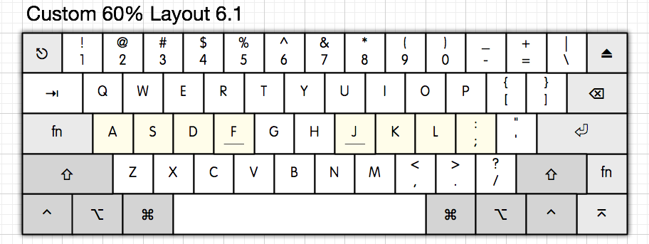

Confirmed layout for production!
Custom 60% Layout 6.1 Default Layer.png (48.65 KiB) Viewed 9995 times
Keeping it simple. Row 1 is 1.25 x 3. 6.25. 1.25 x 4.
Requires stabs for standard ANSI 6.25u space bar, standard ANSI left shift, and standard ANSI return.
Right shift is, of course, HHKB style. As is the top right corner, where there's two single keys instead of a standard 2u backspace.
One open Steely-style case and plate for this, thanks.
