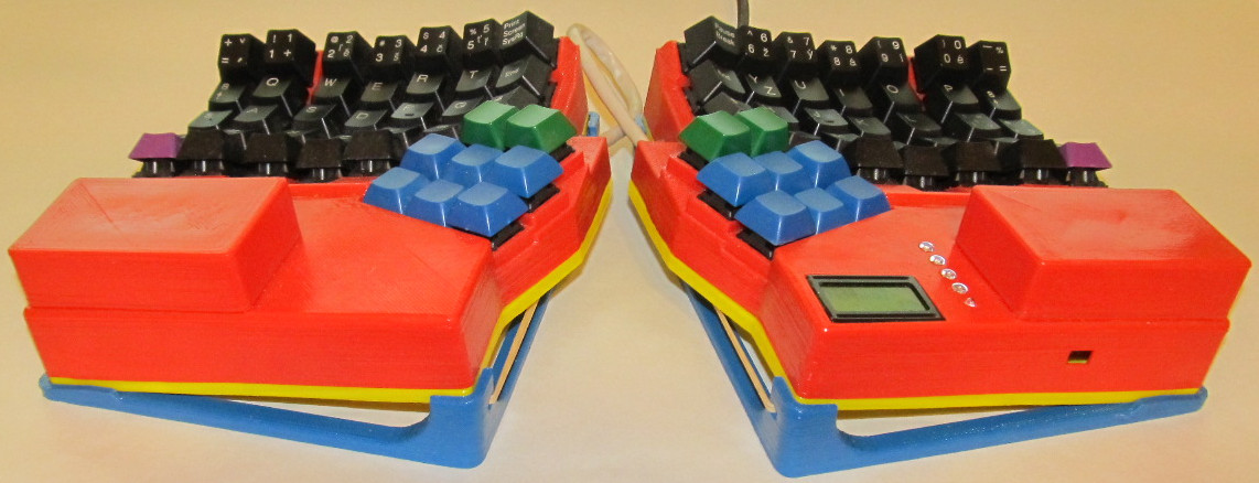

Posted: 31 Jan 2016, 02:04
by vvp
And for the few guys who are trying to build v0.7 themselves.
I made a simple tilting stand.
If you want it then the STL files are here.

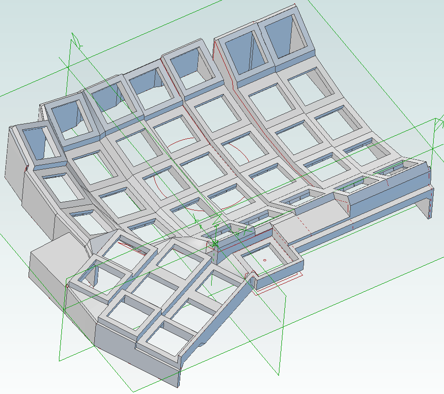

Posted: 09 Oct 2016, 17:52
by vvp
Well, I printed a mock-up of v0.8 keywell. That is the only significant thing I did from May. Looks good. I though that the new (green) layer shift key will be easier to access than the current layer shift (the key to the right of the green key). But it is about the same thanks to the fact that the current layer shift is a bit easier to reach compared to v0.7. This happened because the whole thumb cluster areas is deeper by about 5 mm now. Well, even better.

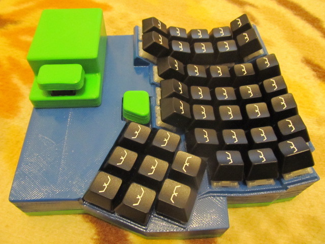

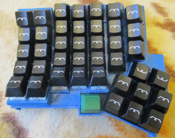

Posted: 05 Nov 2016, 19:24
by vvp
Proposal for the left side. The green buttons are new. I will probably finish it as it is (without changing the shape). Then I use it for few months and possibly experiment with the palm rest and the palm button shapes.
I guess I should call it K84CS now.
Yeah, I run out of the blue filament :roll:
K84CS v0.8 left side

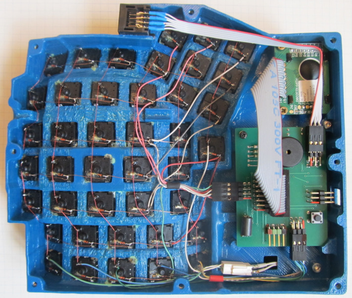

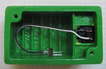

Posted: 17 Dec 2016, 14:04
by vvp
The right side is almost done. You can see the new thumb cluster key at the end of the pointing finger column. The white connector (at the end of the little finger column) connects the palm button to the key matrix. The hex slot screw head in the bottom right corner holds the palm brick. The other such screw is below the PCB (not visible here).
The picture of the inside of a palm brick with its palm button is below. This is a brick for the left side but the right side brick is just a mirror image.
The shown key well wiring is an example of how not to do it. The problem started because I soldered all the diodes on switches like in v0.7. It is better to solder enamelled wire on switches so that diode does not get thermally destroyed(*). Because of the diode orientation like in v0.7 I was forced to put the enamelled wire on rows as in v0.7 too. But it would be better to have the enameled wire on columns instead so that at the end of key well column I can easily extend it to the last thumb cluster "row" button. Because I did not have enamelled wires on columns I needed to connect the key well columns with the last thumb cluster switch using a wire with a plastic insulation which can be soldered to diodes at lower temperature. But this means stripping insulation. Which is the work which would not be needed if I would be wise enough to orient the diodes properly.
Summary: It would be much better to solder the diodes with their cathode (the black strip side) to the switch. Then I could connect rows with bare (un-insulated) wire. This would work nice since the row wires are not crossing in v0.8. Then I could connect columns with enamelled wire (directly to switch pins) and easily cross it at the end when extending it to the last button in the thumb cluster "row".
The other thing which should have been done differently is the diodes on the two bottom keys of the pinkie column and the pointing finger column. There is little space there to solder column wires. It would be better if the diodes would be positioned about 5 mm higher (more far away from the end of the columns) to provide more space for soldering.
Otherwise it looks OK.
(*) One needs to solder enamelled wire at a rather high temperature. E.g. for Ø 0.2 mm it is about 400 °C. Using a lower diameter wire would need lower temperature. Next time I'll go for Ø 0.15 mm.
