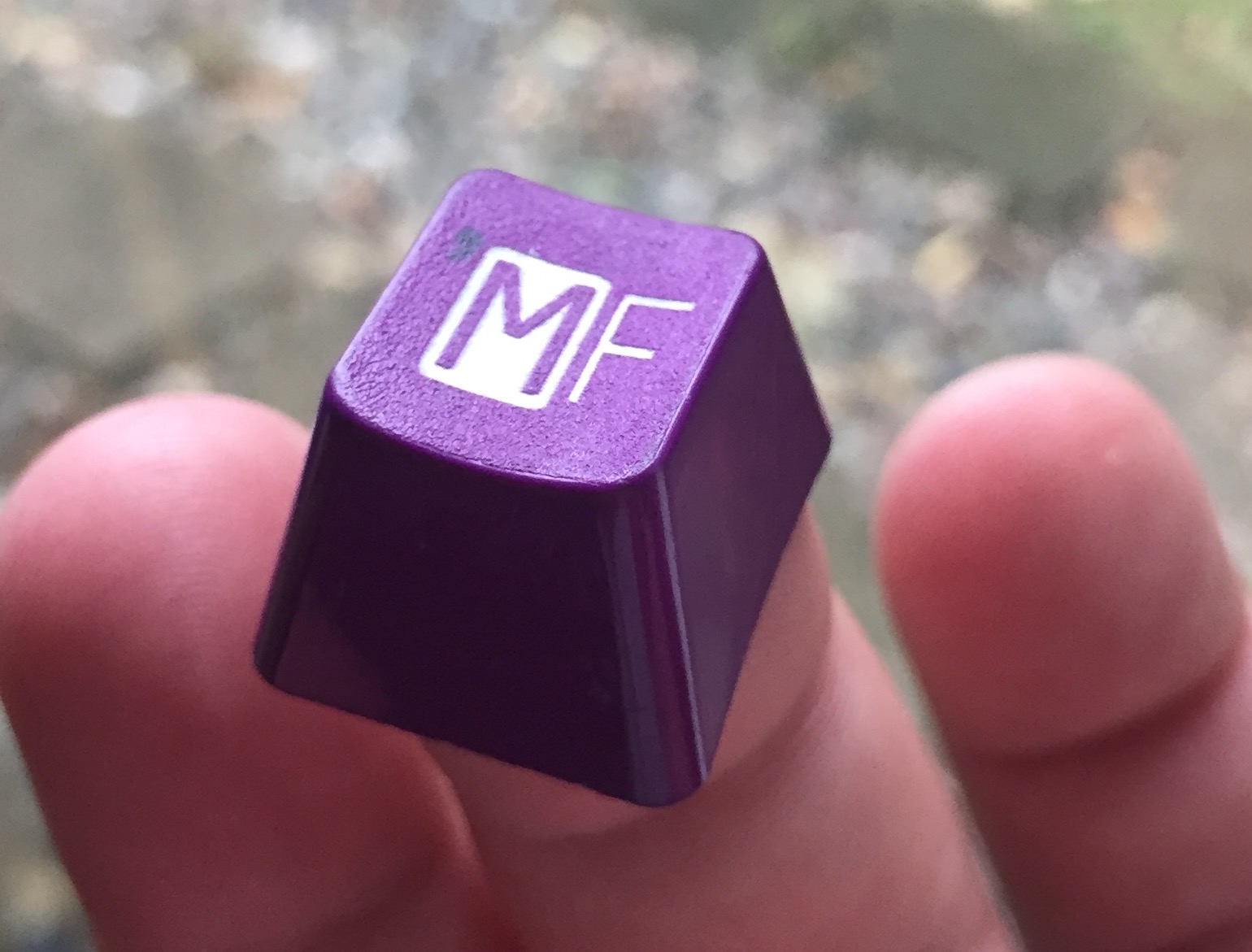

Additional shot with natural lighting that captures color and texture better. It really does look nice in person
- IMG_8822.JPG (244.19 KiB) Viewed 7859 times
Beautiful! Interesting how all that great PBT texturing is gone in the large lasered areas. Is there a setting that would randomize the cut depth per pulse? If so, maybe a final re-texturing pass would be good when removing larger contiguous areas.

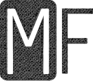

Techno Trousers wrote: Is there a setting that would randomize the cut depth per pulse? If so, maybe a final re-texturing pass would be good when removing larger contiguous areas.
It really won't be a setting in the laser itself. You would accomplish that type of effect with something similar to the following (versus all black). The power of the laser at a given point is controlled by the level of darkness of the image it is attempting to engrave
- mf-mosaic.png (70.21 KiB) Viewed 7803 times

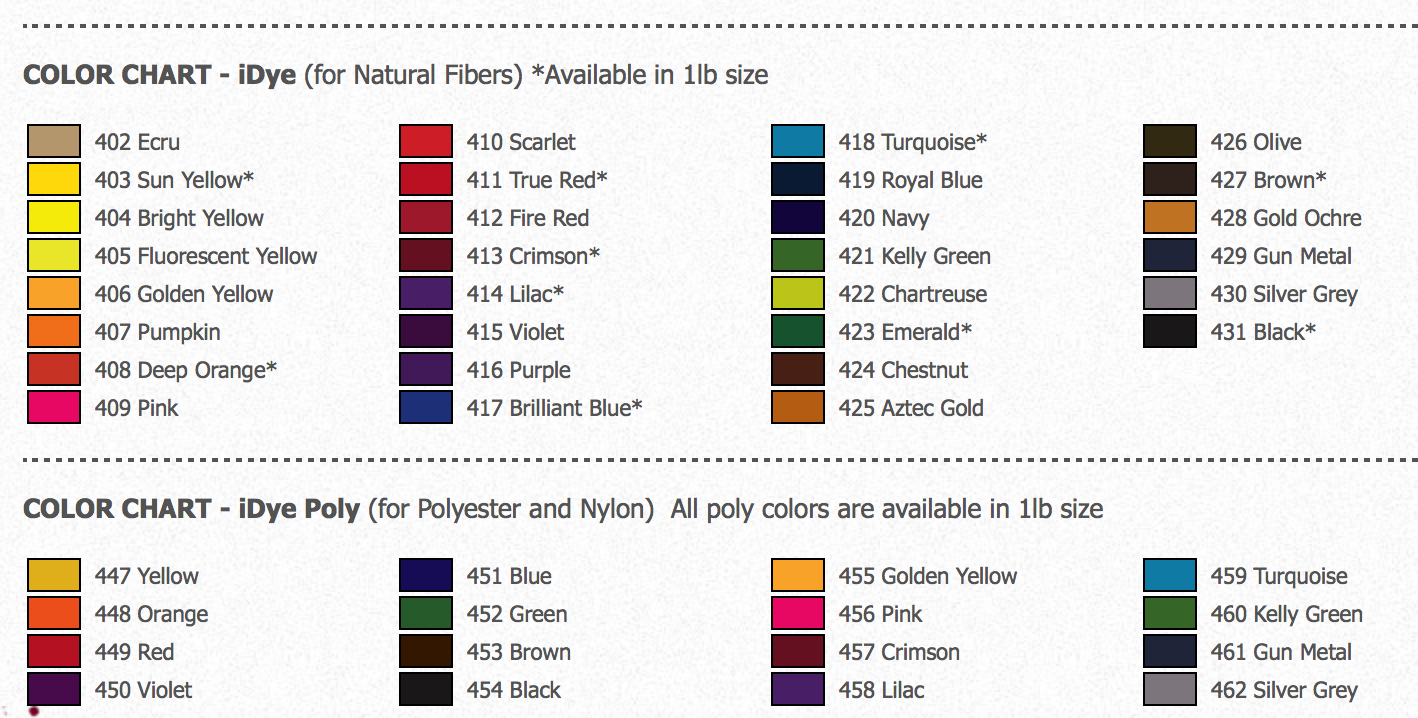

On this vein... Assume we only do a MF novelty cap this first time around for Phase 1 (trial effort) for maybe 1-2 bucks a pop. What color combinations would we like to see? I will start a vote after you kick out some options. I realize we could order even a single cap from Unicomp, but we have to go through the dye process. I would only want to dye caps in bulk. Yell out some combinations that are interesting from the following. I have my own ideas, but won't taint. I would be willing to deeply engrave any cap color later (not two tone). This is asking for color options where dyes are used.
Cap colors are the dye
- Screen Shot 2016-09-24 at 2.28.16 PM.png (969.57 KiB) Viewed 7748 times
Font colors are the Unicomp key cap

The test caps were iDye Poly (Black and Violet) on vintage pearl (early 1990s M122). Cap starter color should be as light as possible; white should give the most predictable end result. I would suggest that we stick with the iDye Poly as PBT is more like Polyester or Nylon than cotton or wool. Longer time in the dye results in deeper, darker, longer lasting color. I don't remember how long these were in, but the reds in my signature were about an hour at about 90C.

Based on feedback, I don't even think we need a vote. It sounds like everyone is comfortable with "brilliant white" as a cap font. And for the dyes... I would like to make available the following (agreed with WCass... these are the poly dyes)
- 448 - Orange
- 449 - Red
- 450 - Violet
- 452 - Green
- 454 - Black
- 462 - Silver Gray
The blue is the one that is a bit "messy". It is a color we are picky about (as humans). I am not sure if the 451 - Blue will be too Royal, and am afraid the 459 - Turquoise is a bit too "Caribbean". That is the one in the unknown. I plan to dye until no further pigment is available (saturation) for each.

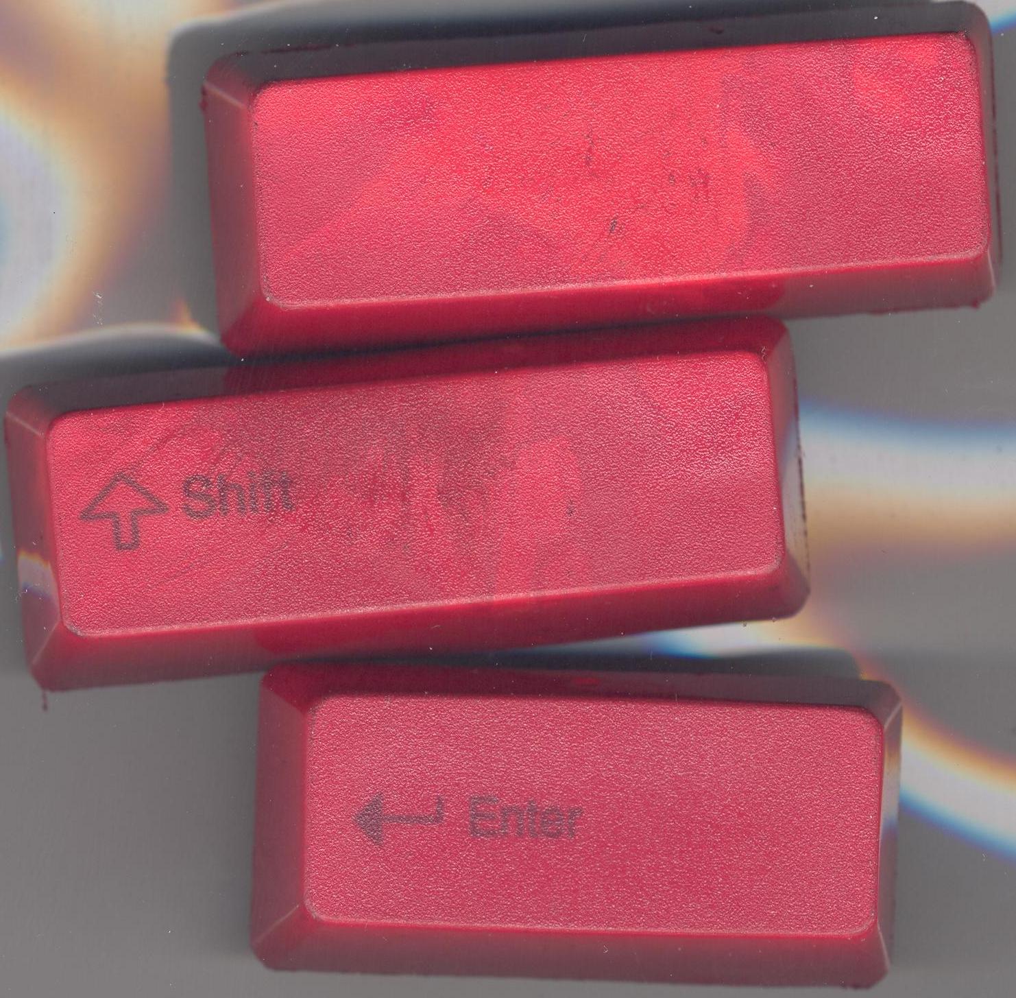

I think Blue (451) will probably look really nice. Some bit of the background will be part of the end color. For the same reason, you might try Crimson (457).
I dyed a set of printed bright white caps Red a while back and the color came out lighter than my 5 year old RIT dyed batch and was splotchy. I suspect Unicomp may have treated them with something that would wear off with use (maybe just mold release). You might want to rinse them with a stronger solvent than alcohol before dying. All three of these were in the same batch.
- test.jpg (316.15 KiB) Viewed 7539 times
Posted: 25 Sep 2016, 03:27
by lot_lizard
wcass wrote: I think Blue (451) will probably look really nice. Some bit of the background will be part of the end color. For the same reason, you might try Crimson (457).
The blue choice echos intuition. I will follow the same lead on the red (stands to reason).
wcass wrote: I suspect Unicomp may have treated them with something that would wear off with use (maybe just mold release). You might want to rinse them with a stronger solvent than alcohol before dying. All three of these were in the same batch.
wow that is surprising. I might give them a full blown chemical bath in the parts cleaner then. I know it won't hurt PBT, and is more effective than any ultrasound cleaner

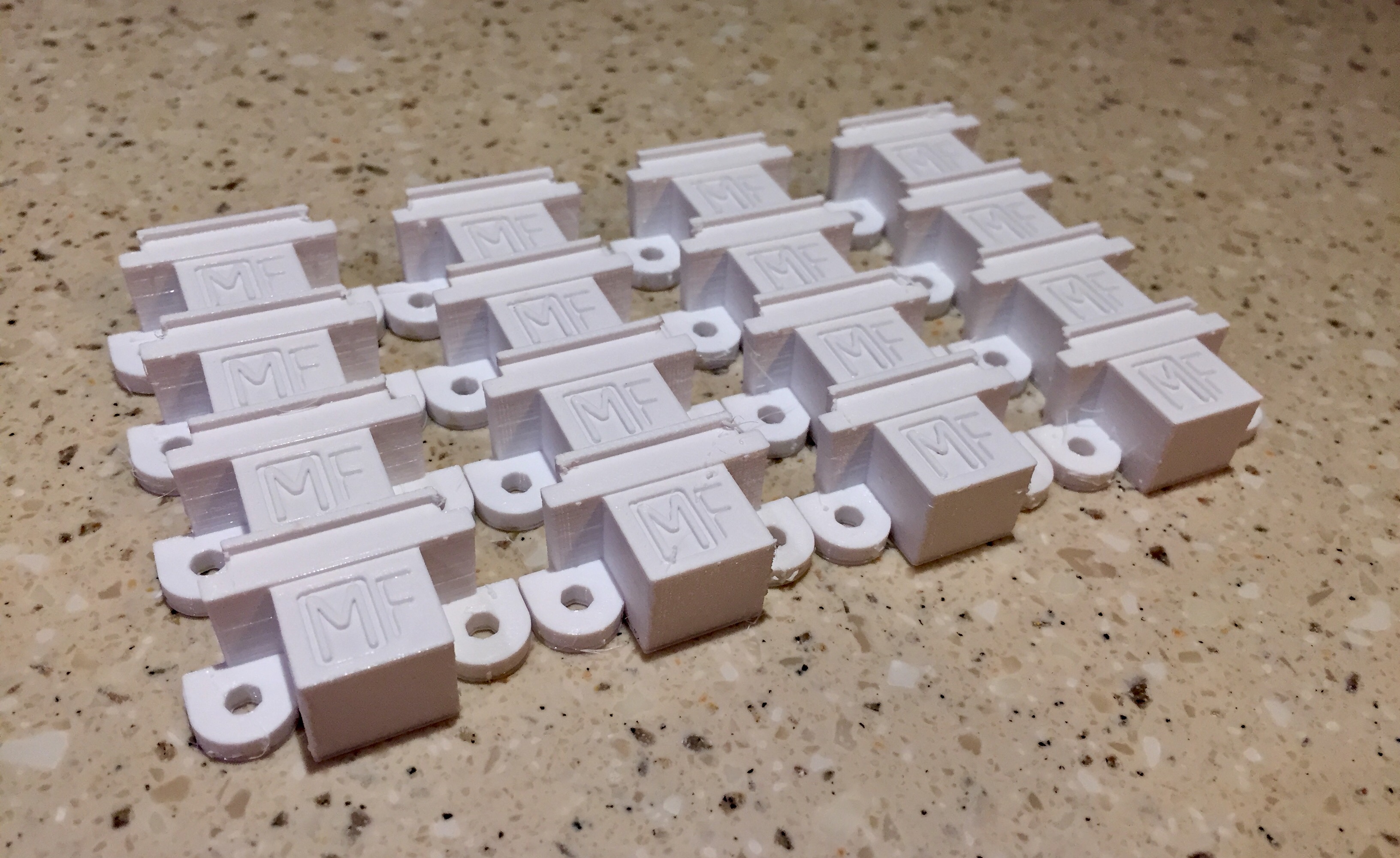

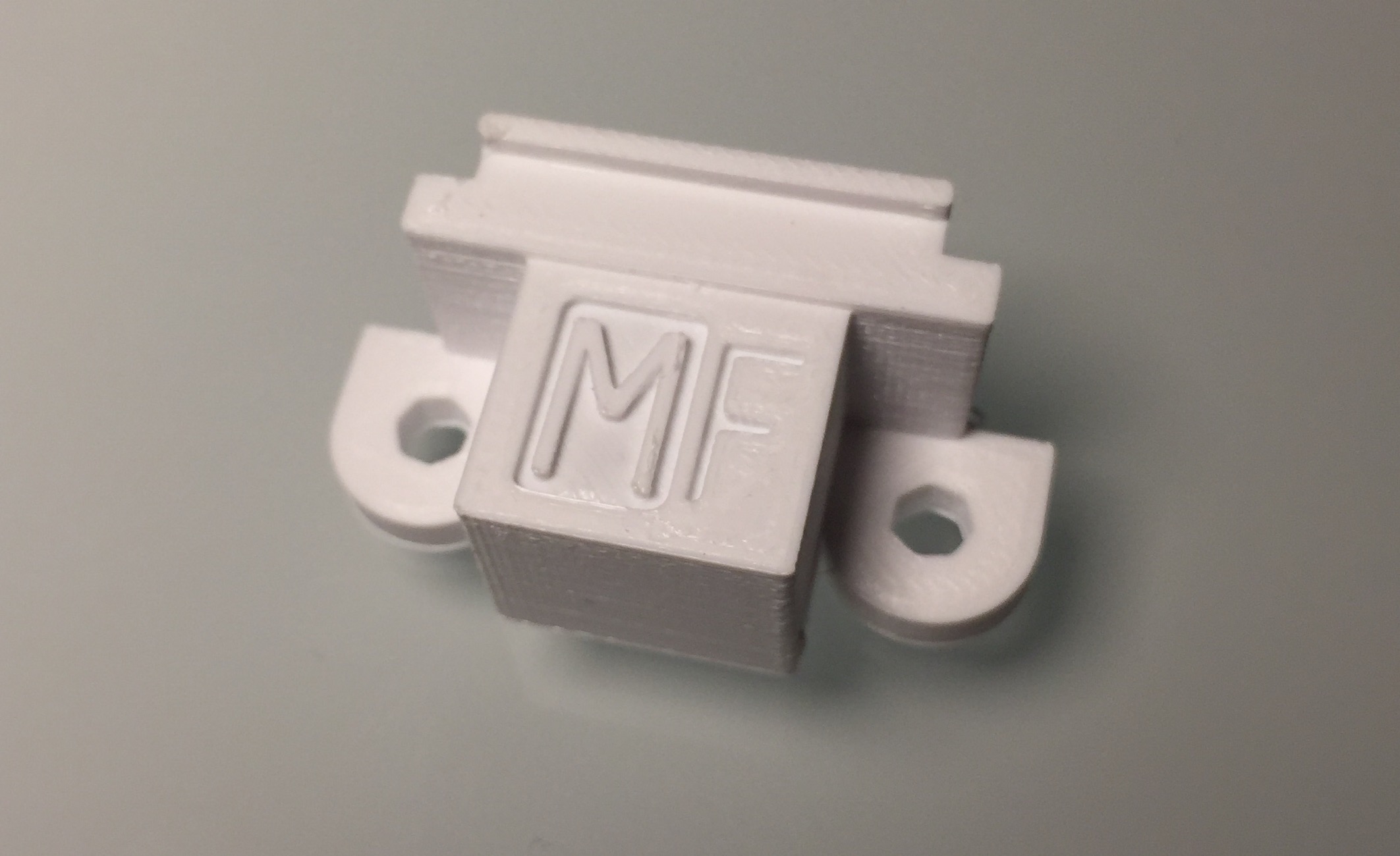

Finally dialed in the settings for the coplyester (thanks Wodan for the initial settings lead). I ended up reversing the image for the propaganda, and adjusting some speed/heat/fan settings, but the end result is really good (FINALLY). Let production begin. Thanks andrewjoy for the material tip. This filament (PET) is much more resilient than the PLA (though tougher off the spool to make "work")
- IMG_8826.JPG (289.37 KiB) Viewed 7629 times
Posted: 26 Sep 2016, 14:26
by regack
lot_lizard wrote: Finally dialed in the settings for the coplyester ...
That piece looks fantastic.

Work has gotten in the way of progress, but I did come home to our first batch run on the printer. Small cleanup all the way around on the pieces (was expected), but glad it wasn't an unattended plastic "ball of mess". I've ordered a few poly dyes, and have some test pieces to try color matching to the standard case (should be pretty easy) and the industrial case (expected to be difficult)
- IMG_8856.JPG (1.06 MiB) Viewed 7396 times
