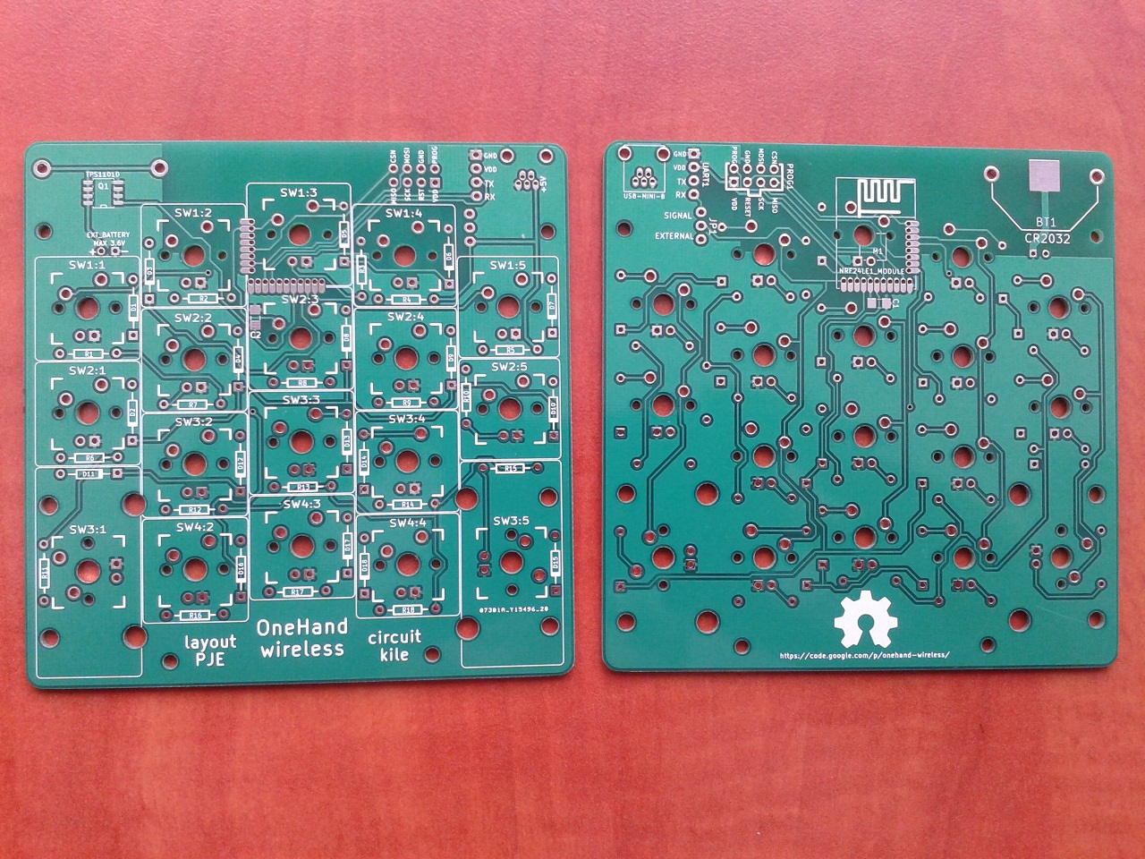

Look what Santa just brought! :D
onehand wireless PCBs
I didn't expect these for another 10 days at least. By a stroke of luck, the family is out of town for the weekend, so I will have two whole days to play with my precious creation.
I pledged for one of these https://www.kickstarter.com/projects/ee ... nt-adapter and I'm still waiting for it - it should arrive any day now. That thing will help a lot with tweaking the current consumption and prolonging battery life.

kile wrote:Look what Santa just brought! :D
Looking good!
I'm excited to see how the wireless system works out. I decided against wireless, and LEDs for V2 of my design. I'm thinking of a V3 with embedded CPU as it would give me an excuse to buy a reflow oven :)

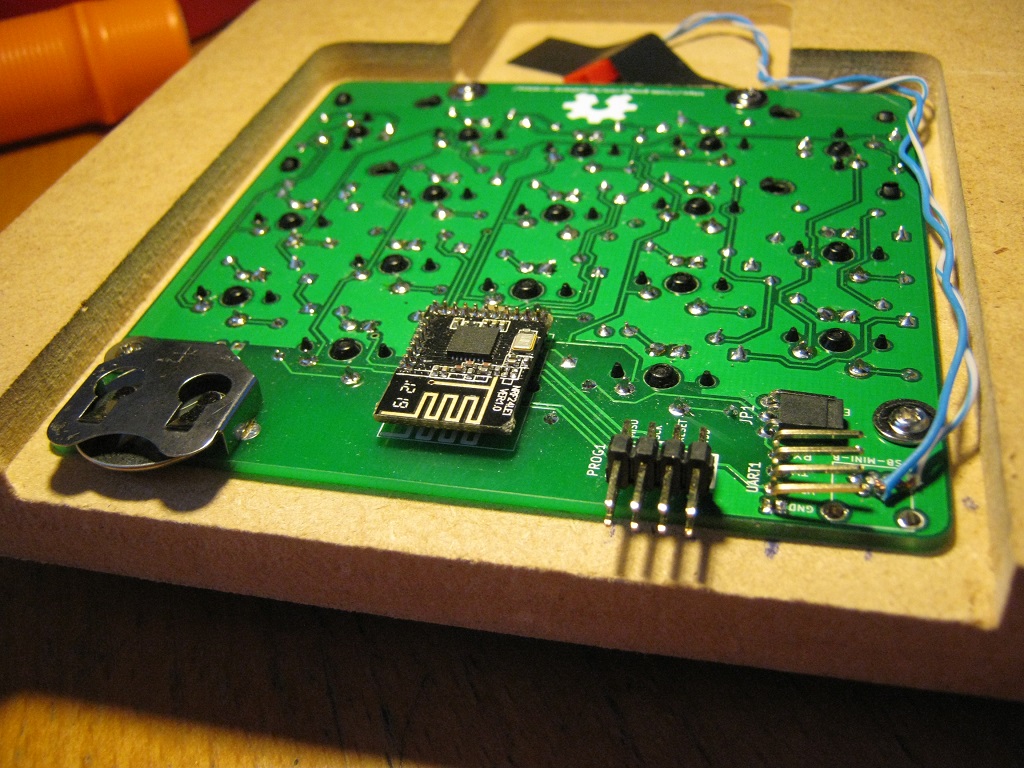

And it's working! :) I made "only" one mistake on the PCB design - I reversed the LED USB plug. It should actually be soldered to the top of the PCB to work properly, but I wanted it on the bottom. No biggie, since I only use the LEDs for laughs anyway. I soldered a JST connector to power the LEDs from an external battery just to see what it looks like with all the LEDs on.
So, everything works - the matrix, the UART debug output and the most important thing - the radio. But, nothing works as it should :) I am not putting the MCU into sleep mode at all yet, so it draws a lot of power. Which is why I didn't solder the CR2032 battery connector yet. I am powering the circuit from the programmer connector and reading the matrix in an infinite loop, just like you would on a wired keyboard. I'll work on this during the weekend.
Most of the caps are leftovers from the max keyboards translucent set I bought for my beloved 7G. The rest I took from my old 6Gs. I'll probably get a full blank set for this board from WASD or some other place. Any suggestions?
PCB with blacks
PCB with blacks
board bottom
board bottom
board connected to the programmer and the battery which powers the LEDs
vegas mode
vegas mode

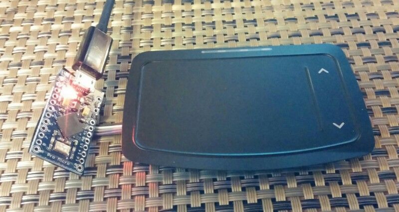

I've been playing with my V2 layout, and have come to the conclusion that it's good enough! The PCB allows a ProMicro to be mounted on the rear in the same way as before, but a second PCB without the CPU can be linked for a TwoHand layout. Also I've included two I2C connectors to allow daisy chaining of the boards with CPUs, and finally I've added the PS/2 interface, which uses the serial TX/RX pins for added flexibility.
Before I pulled the trigger on the PCBs I did a basic test on the PS/2 touchpad interface, using a cheap ($3) surplus Synaptics touchpad from a laptop wired to the TX, RX, 5V & 0V pins of the $5 ProMicro.
I've used the various PS/2 Arduino resources on the web to write an interrupt driven touchpad interface. It generates x and y positions as well as the virtual button press signals from the PS/2 stream. Using the interrupt driver for the receive should allow it to run in the background without interfering with the keyboard scanning too much. I now have to decide how I'm going to use the pad - mouse replacement, or cursor control... For some reason the side scroll bar is not working - probably a configuration issue, but I'll keep working on it!
Now that I'm reasonably happy with the next iteration I'll probably be ordering the PCBs this week.

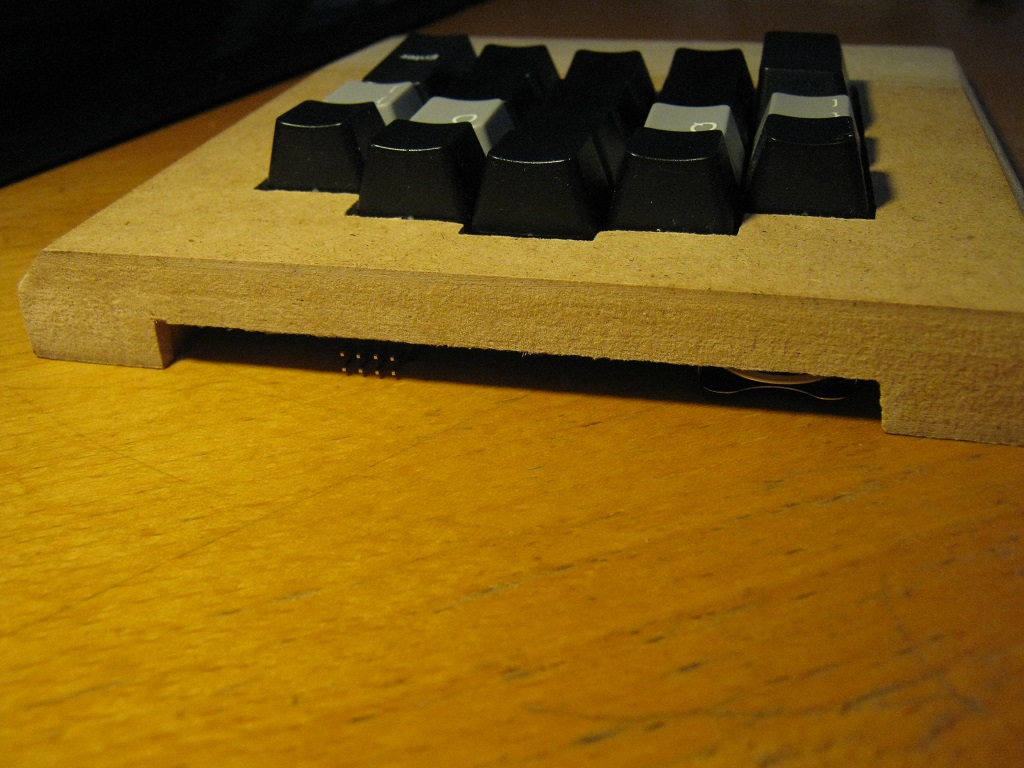

I had a prototype case made. I'm really happy with how it turned out. It's MDF and not real wood, but it's good enough for a prototype. I messed up a few spots for about 1mm, but overall - YESSSS!!! :D
view 1
view 1
bottom view
bottom view
front view
front view
top view
top view
Posted: 01 May 2014, 13:04
by Muirium
Rather smart. But you're going to want to so something about those loose wires, Mr. 2.4 GHz!

Muirium wrote:Rather smart. But you're going to want to so something about those loose wires, Mr. 2.4 GHz!
Yeah, I know. A wireless keyboard with wires sticking out of it :roll:
Anyway:
look ma, no wires!
look ma, no wires!
look ma, no wires! (part II)
Happy now? :D
The white/blue wire will have to stay. That's the LED power cable, and I don't want to remove it yet.
And the serial debug connection has been replaced with a pin header, so I can now plug it in/out as required.
matt3o wrote:I just wanted to chime in to say that I'm enviously following this thread and you gave me some very interesting ideas for my future builds.
Well, thank you from my part. But as I said before, this is really not as complicated or hard as it may look. And I am more than happy to share any and all knowledge I might have on these things. All that's required is an honest will to learn. Coming up with projects that allow me to learn about electronics is my main motivation for doing this. I don't really need this keyboard that much, you know :)

kile wrote:Happy now?
That's better!
Now I wonder if, with a little creative battery relocation, I could fit your PCB into Mohitgarg's case
Hmm, probably needs too much saw!
