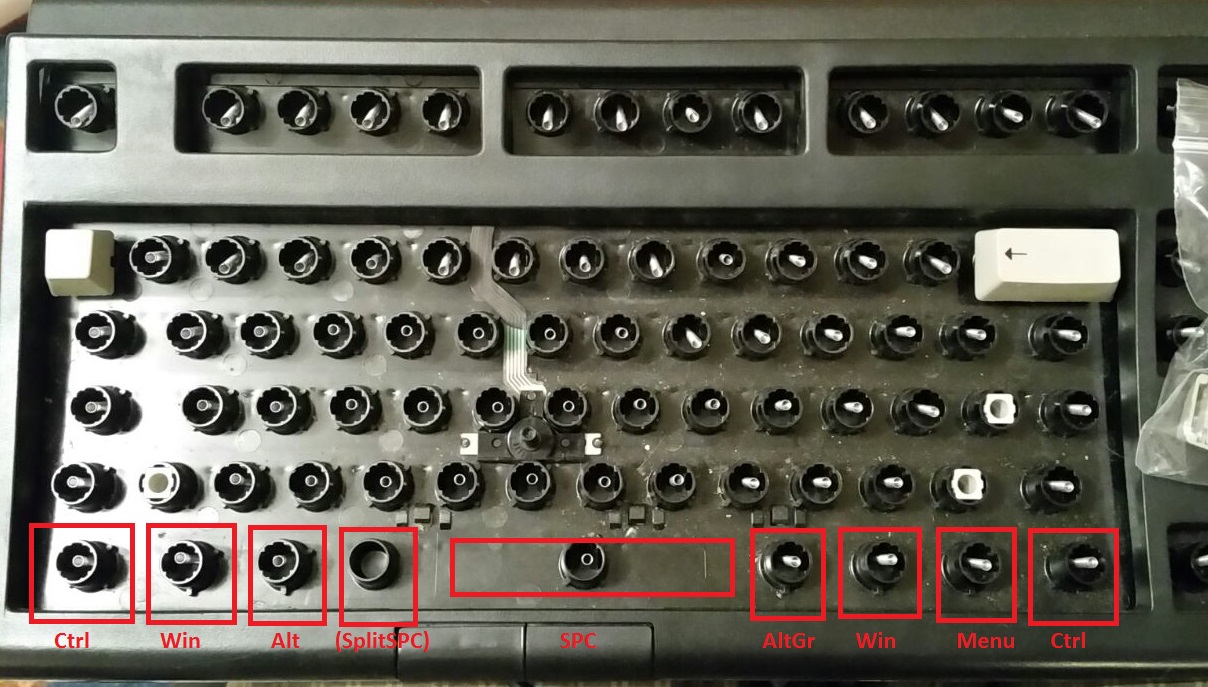

We discussed earlier about the functional stabilizer keys. This is the picture that would try to help show the gaps. Note the only key with the 1.5u in it is the right shift. The other three are left shift, enter, and backspace. Again, it wouldn't be hard to create keys for left shit, right shit, and enter that maintain the outer key profile and eliminate any key gaps (backspace is already perfect at two 1u's). It is certainly something to consider for those that like splits. Backspace is the bottom right (perfect), bottom left is enter (key gap between the splits and slightly on the outside), top right is left shit (again... key gap and slight outside issues), and top left is right shift (only real issue is outside alignment after adding the 1.5u)
EDIT: apologize. The original picture was rotated incorrectly and cropped horribly. It has been corrected

I see.. you're right, and about the split spacebar.. maybe on a FSSKrev2? :)
I think the FSSK anyways has still not the winkeys right? So will need a PCB v2.. ;)
Btw my worry about the bottom line was more because if you look at the unicomp model m which also has winkeys and even menu keys it looks like the following.. and I think they provide for that bottom line all 1.25u keys:
So if I try to use standard 1.5u and 1u on it it looks with a bit of space in between as well:
So my doubt is that if I want to use an FEXT on an unicomp to make use of the winkeys (a metakey left and a fn key right) which I'd really like to have (split spacebar and menu keys are really not a must), then I think that since on a regular M it seems there is almost just space for an 1u key then the FEXT PCB will not really have the right alignment for the 1.25u keys.. ok maybe they still register but this I will only know by trying as soon as I can do the test with a FEXT (hope soon).

Hate being the bearer of bad news, and I should have mentioned in the OP, but the winkeys don't have pads in the original FSSK. I realized after I was clacking away and wondered why they weren't registering. He has in the FEXT, and will have when we finally decide to group buy this stuff. I have all the quotes in except the plastics. I'm still waiting on my "dead beat" lab to give me the makeup of the flippin flipper

yeah that's why I'm having this very bad idea in my mind to take my unicomp m, the FEXT and a hacksaw.. put it together and guess.. ;)))
Posted: 05 Jul 2016, 22:14
by lot_lizard
tentator wrote: So my doubt is that if I want to use an FEXT on an unicomp to make use of the winkeys (a metakey left and a fn key right) which I'd really like to have (split spacebar and menu keys are really not a must), then I think that since on a regular M it seems there is almost just space for an 1u key then the FEXT PCB will not really have the right alignment for the 1.25u keys.. ok maybe they still register but this I will only know by trying as soon as I can do the test with a FEXT (hope soon).
I have the metal already processed for the FEXT. It's next. In version two of the PCB, he will slide the pads over slightly, but I have tested manually, and your v1 PCB will still work. The flippers can have substantially less contact and still register nicely. The v1 FEXT is good to go for winkeys as is. The FSSK will require another run. Keep in mind though, your model M shell will need to be modified to take advantage. There is a reason the outer top shell isn't on in my pics. Everyone was just interested in the winkeys, so I showed the alignment
Posted: 05 Jul 2016, 22:16
by alh84001
tentator wrote: Btw my worry about the bottom line was more because if you look at the unicomp model m which also has winkeys and even menu keys it looks like the following.. and I think they provide for that bottom line all 1.25u keys:
That is the old Unicomp layout, and they eventually abandoned it. I believe that any PCBs i$ makes will just slip a 1U sensing pad, between 1.5U positioned sensing pads for CTRL and ALT.
Edit: Oh, I misunderstood. You have an existing Unicomp that you want to convert.

what do you mean with need to modify my case to take advantage?
well yes I definitely WILL need to modifiy it quite a lot..
maybe you refer to the fact that on the top, where the connector to the xwhatsit should go, it's rather protruding out for unicomp?
Posted: 05 Jul 2016, 22:26
by lot_lizard
tentator wrote: what do you mean with need to modify my case to take advantage?
I didn't follow you were in a Unicomp case until after seeing alh84001's response. You should be fine. Model M's have a portion of the shell filling that winkey void. To use, a Model M top shell would need to be altered to make room for the key. The xWhatsit and PCB have no impact on any configuration
