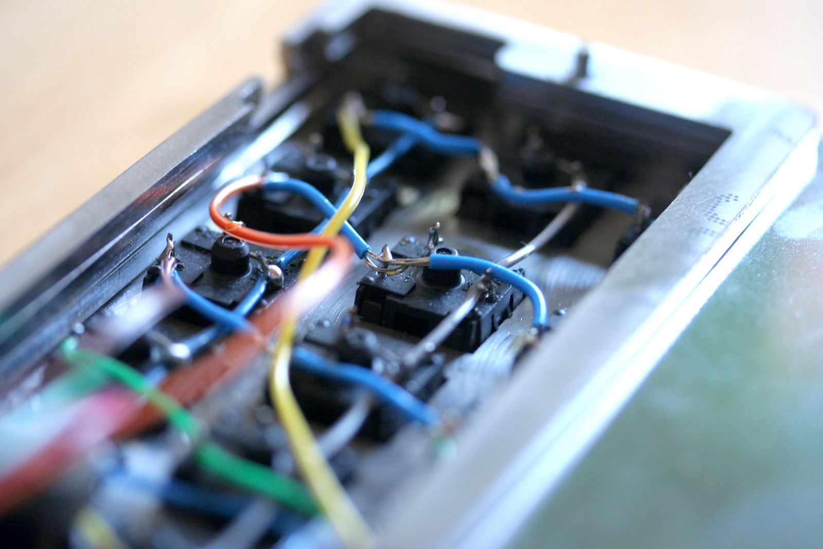

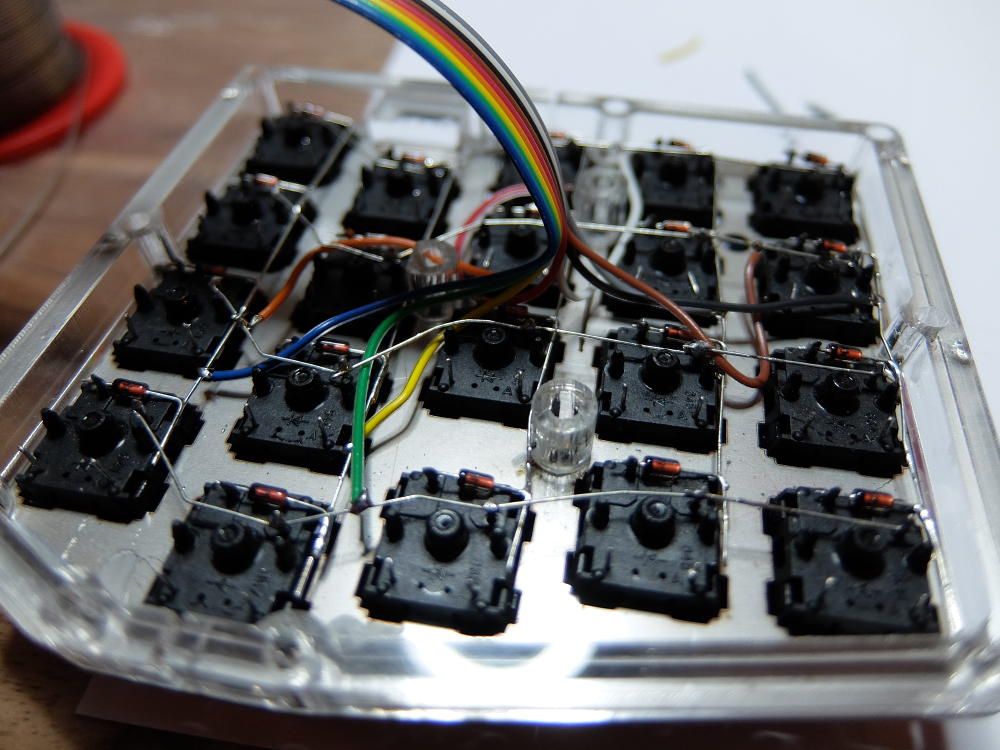

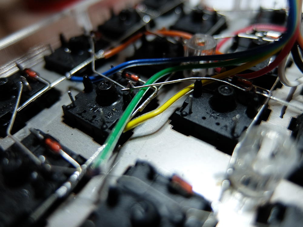

@ħ: Arcing isn't the problem. Stability is. Bare wires like that are very likely to touch at times, as the keyboard flexes with typing, or indeed with construction and closure. Perhaps that sounds a bit far fetched, but I found it very problematic with my stainless steel 60% in a tight, conductive, enclosure. Usually it would work fine, but often enough I'd have entire rows ghosting at once and other showstopping nonsense. So I recently rewired it, double insulated, like this:
I used standard, insulated wires and melted the insulation wherever I wanted to join to a switch.
Okay, so it looks messy under the macro lens! I need to redo some of it anyway. That's late night soldering work for you.

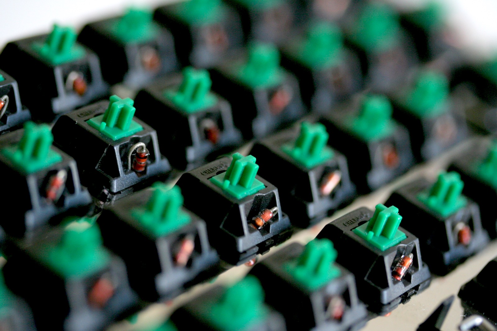

But where are the diodes? Well, I had an idea…
The matrix does work, but there's some dodgy joints. And I still need to house the Teensy and USB port properly. But this definitely saves a lot of space inside.
As for your situation: I'd slide some little pieces of electrical tape in the nodes where the bare wires cross. That should do the trick with the space I think you have.

Arcing was meant as a joke... Nevertheless, my feeling is that my short and rather stiff wires will not cause any trouble, but this is a prototype, and we'll find out sooner or later.
You must have decent ventilation if you voluntarily melted that PVC insulation!
BTW, is there any other kind of soldering apart from late-night soldering? :)

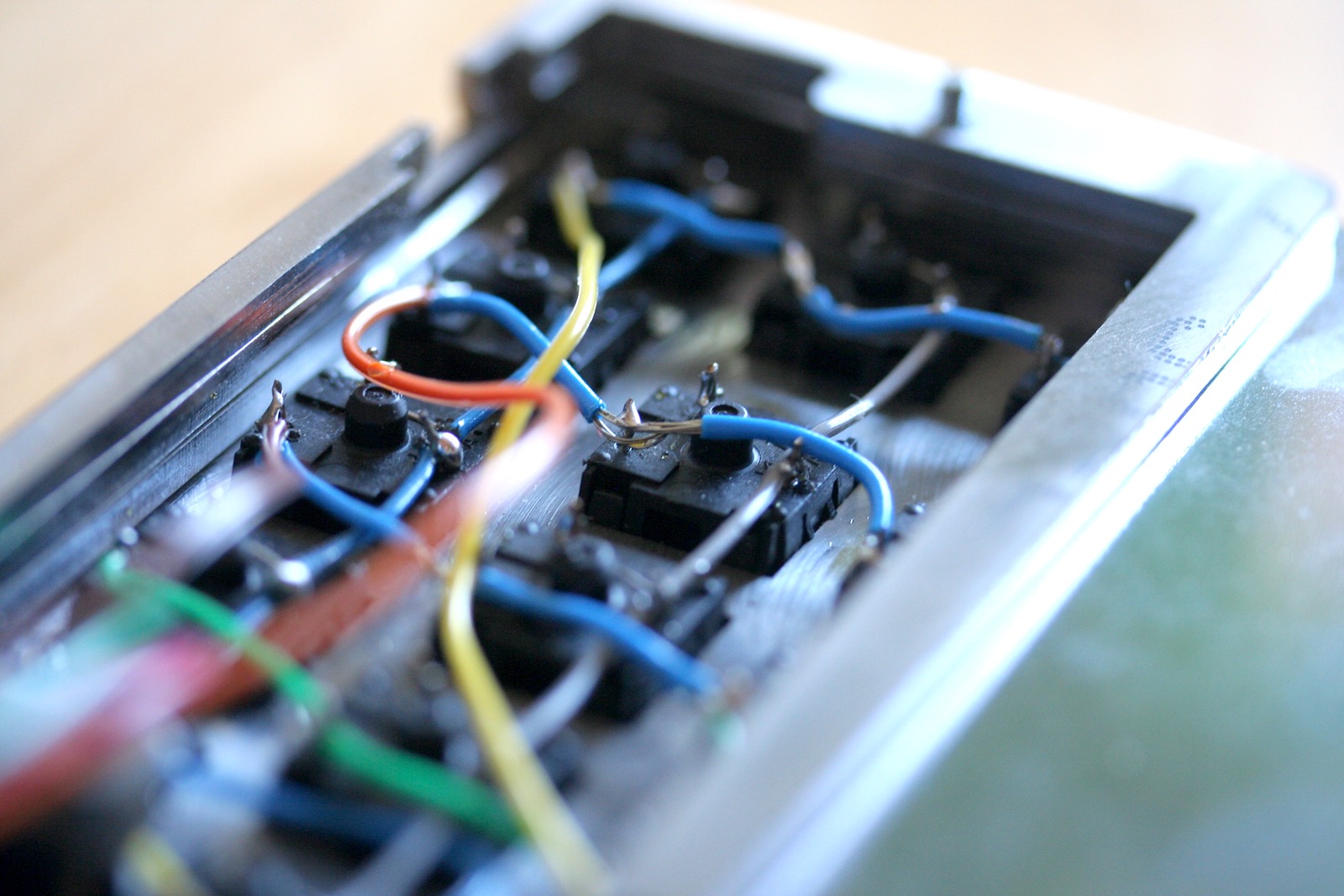

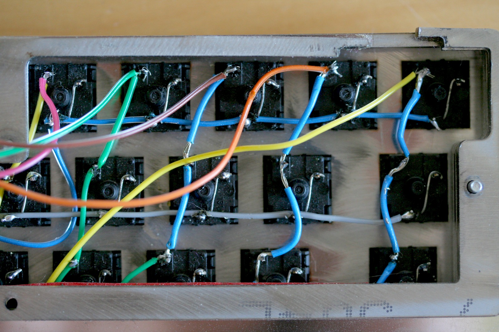

Posted: 10 Sep 2015, 23:00
by hbar
OK, pictures:
No shorts so far. The controller is next.

I doubt you will ever get any shorts if you do not press the wires intentionally.
I used Ø 0.25 mm bare wire for matrix. The space between rows and columns was about 2 mm too. The keyboard did not develop any shorts. I say this technique is safe.

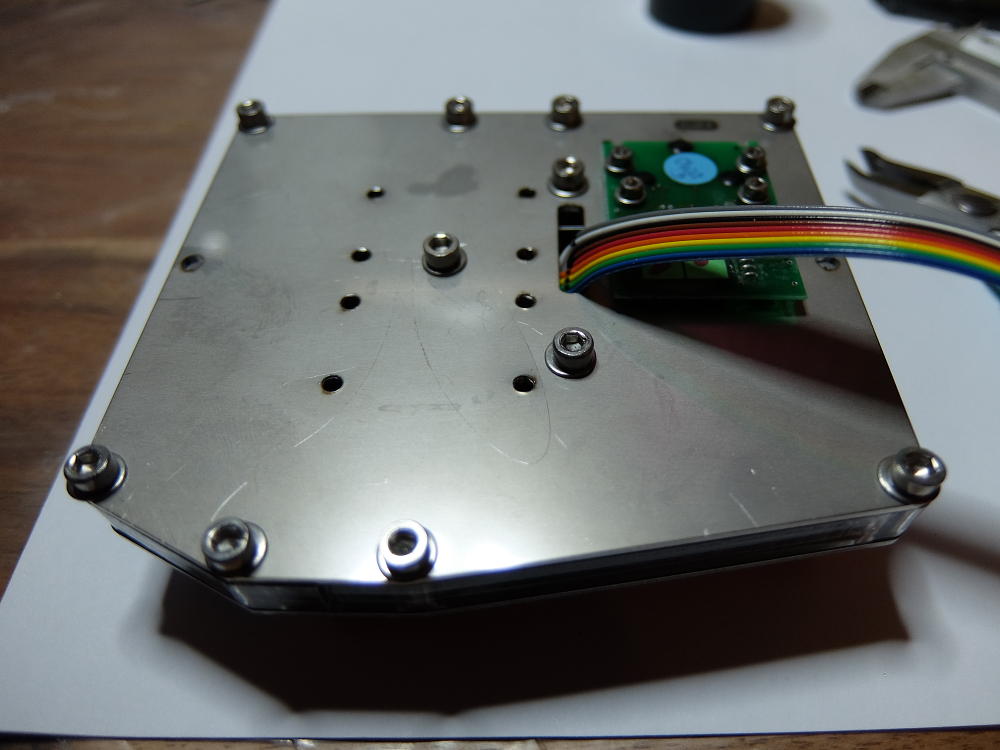

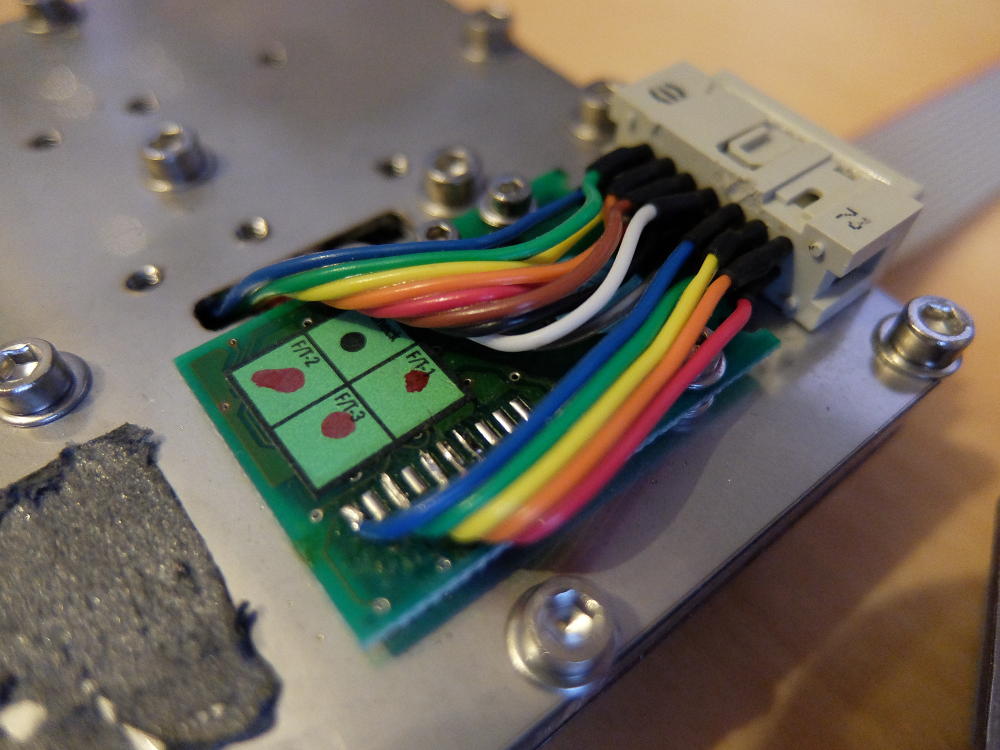

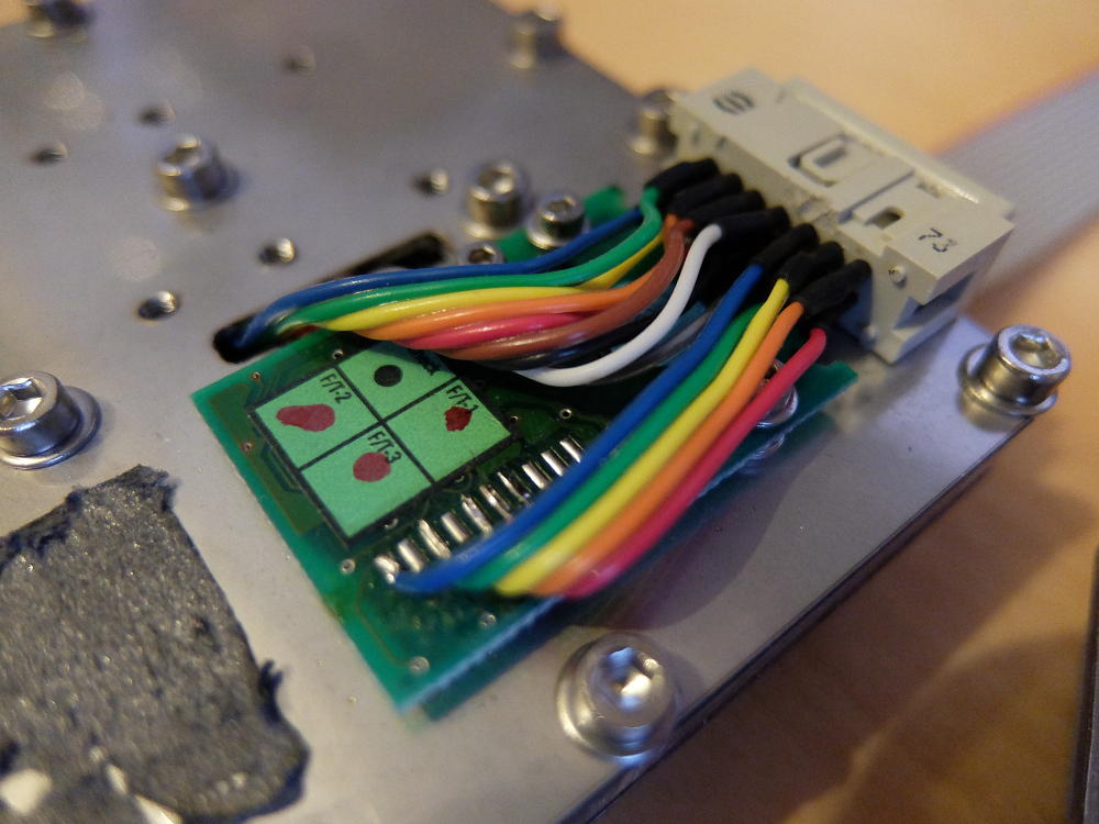

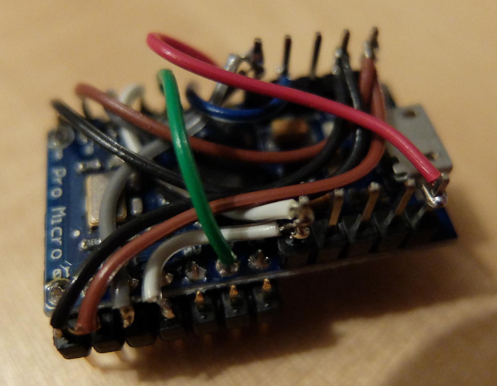

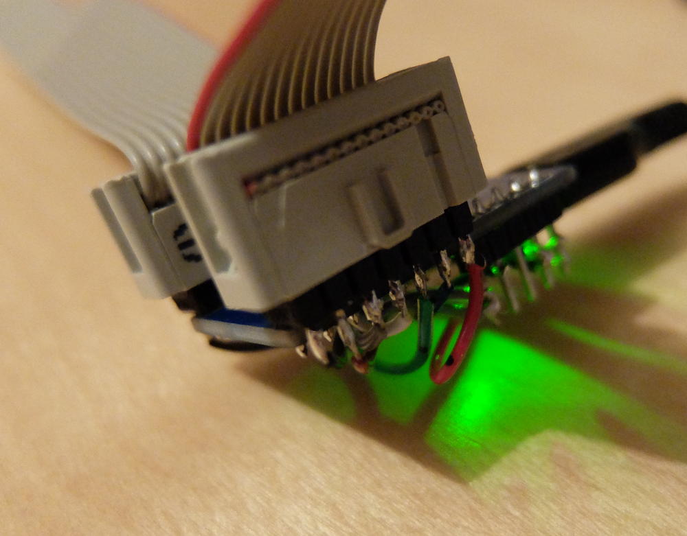

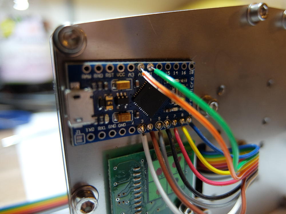

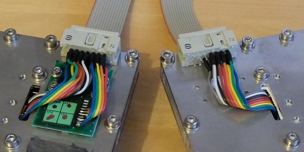

Another update: the controller board glued to the underside of the right half is a dead-end. That micro-USB has already broken off once, so I'm going to replace the cabling altogether soon.

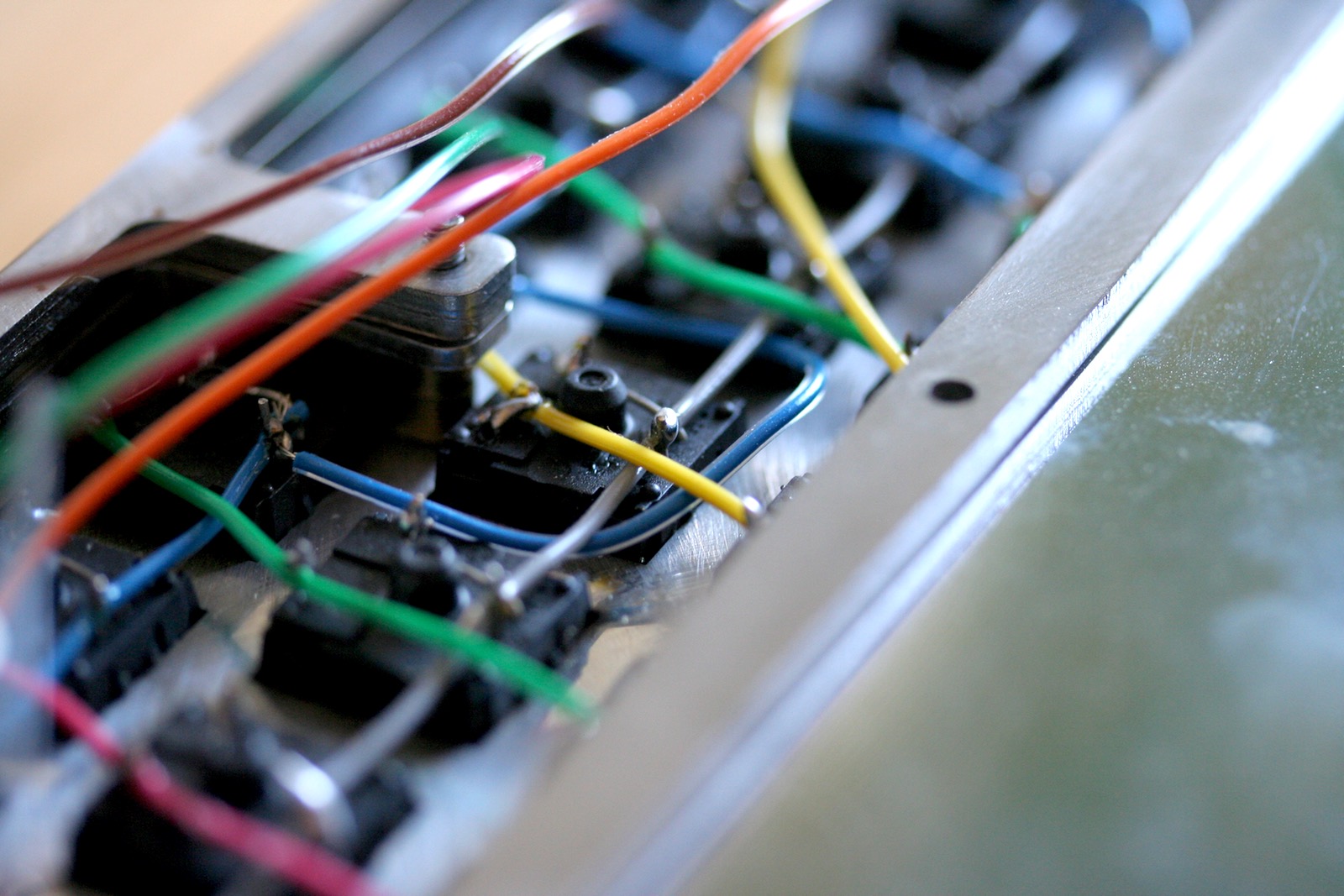

Update with the latest wiring, the nice parts...
and the not-so-nice parts of it:
This is so much better and cleaner, and now the micro-USB socket doesn't get exposed to any stress, thus is much less likely to break off.

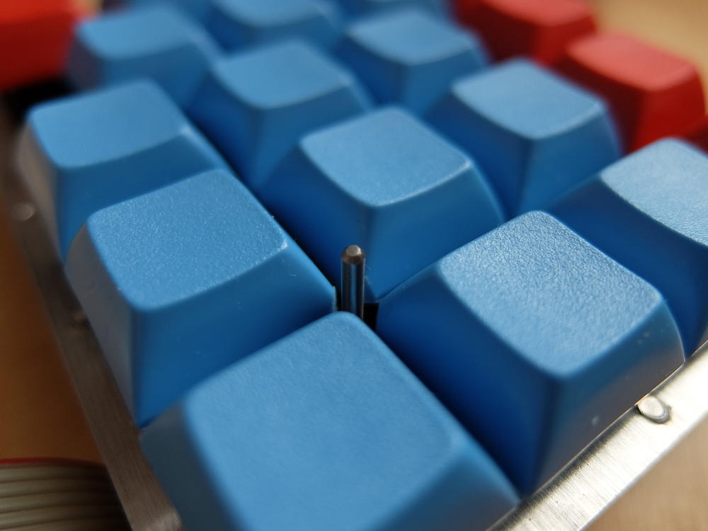

Here is a photo of the trackpoint extension:
This is, in fact, a sawn-off 1.8mm HSS drill bit. As it turns out, the trackpoint has a square hole in it that the bit press-fits into, no further assembly required.

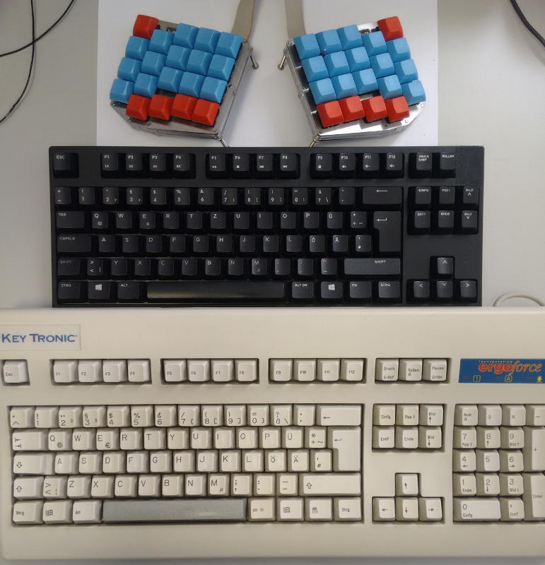

For those who wonder how I get on with the keyboard: getting used to it is painstakingly slow. After practicing on-and-off for a while, I recently decided to give it a try as my main keyboard at work. Here it is, sitting there for size comparison alongside the CM Novatouch TKL and an old Keytronic rubber dome (neither of which is connected):
It's worth mentioning that, of the three, my custom one is the only one with an integrated pointing device.
Typing on it, I tend to be a lot slower than on QWERTY, but I also make fewer mistakes than with QWERTY. Given that the Novatouch keeps sitting on my desk just in case, I sometimes have a very hard time resisting the urge to connect it for some quick typing. Luckily, I don't currently do too much volume typing at work, so I've been able to keep the Novatouch disconnected altogether so far. Fingers crossed, but this keyboard really looks like it's been worth the effort already. It's a shame that wiring it was so much work or I'd be building another one for home use.
Strangely, none of the other people in my office seem to take any notice of it. Yet.
