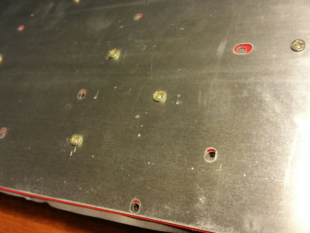

Here are a couple of my pics from yesterday.
Test fitting the plate to the case. I widened the left hole to the right a bit.
Testing some keys.
Keys on the right seem to fit better than keys on the left. A bit confusing, but I guess a bit of a movement to the left is still needed. Also, the barrel frame obstructs the top case on the right a bit. Nothing major, I just need to press the case with hand for the last milimeter. I think that after screwmodding, that will not be an issue.

I have checked again your pictures and realised that you have painted the back plate. Are you sure that the metal is grounded ? You may need to scratch the paint to ensure that there is good contact.
If this is the problem, my recommendation is to test it. To do it, I would scratch the paint in a different place and check for continuity.

I scratched the plate at the point for the grounding screw, I will test what I can do if I have more time, maybe a bad flipper cause the problem.
