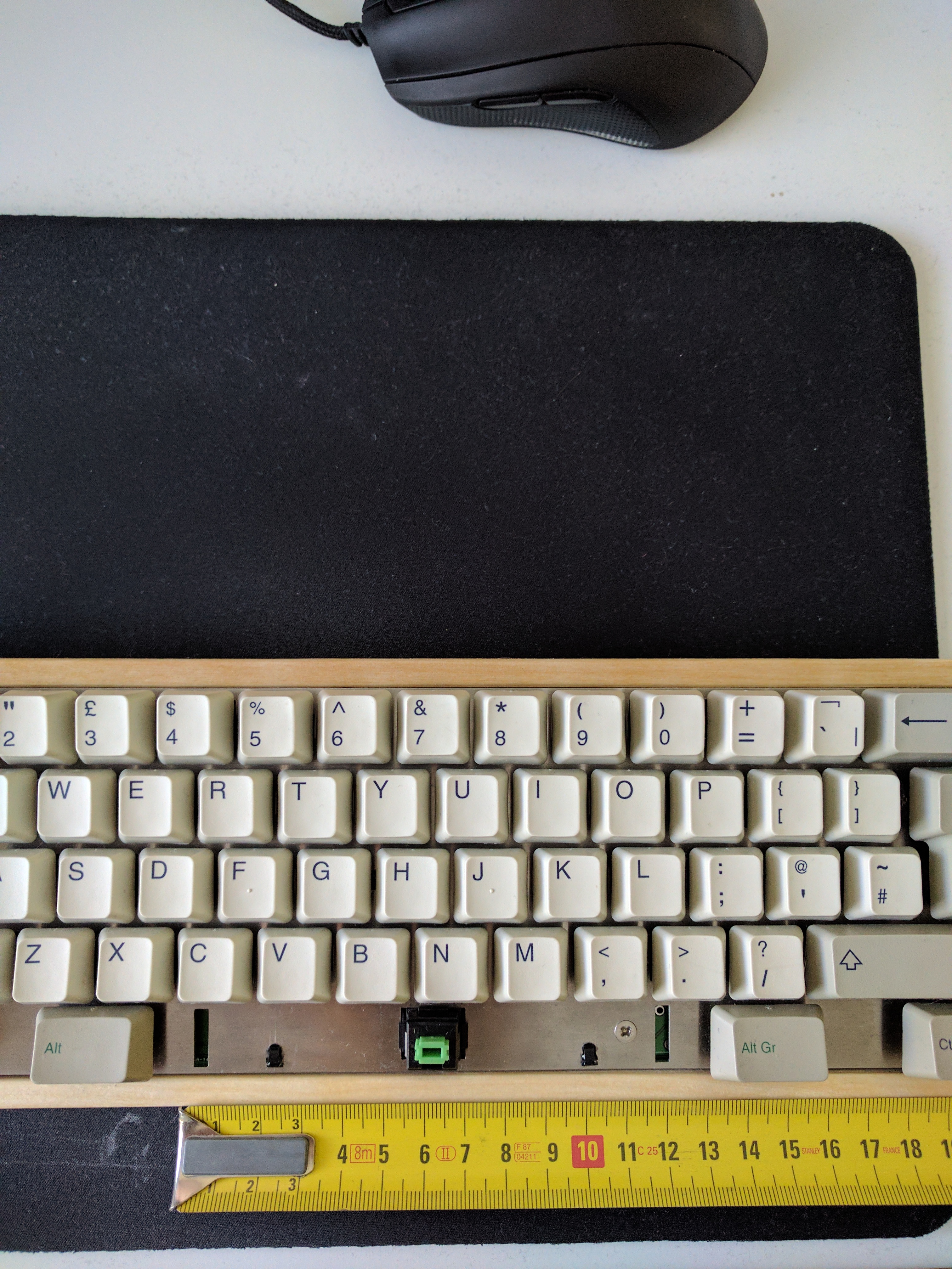

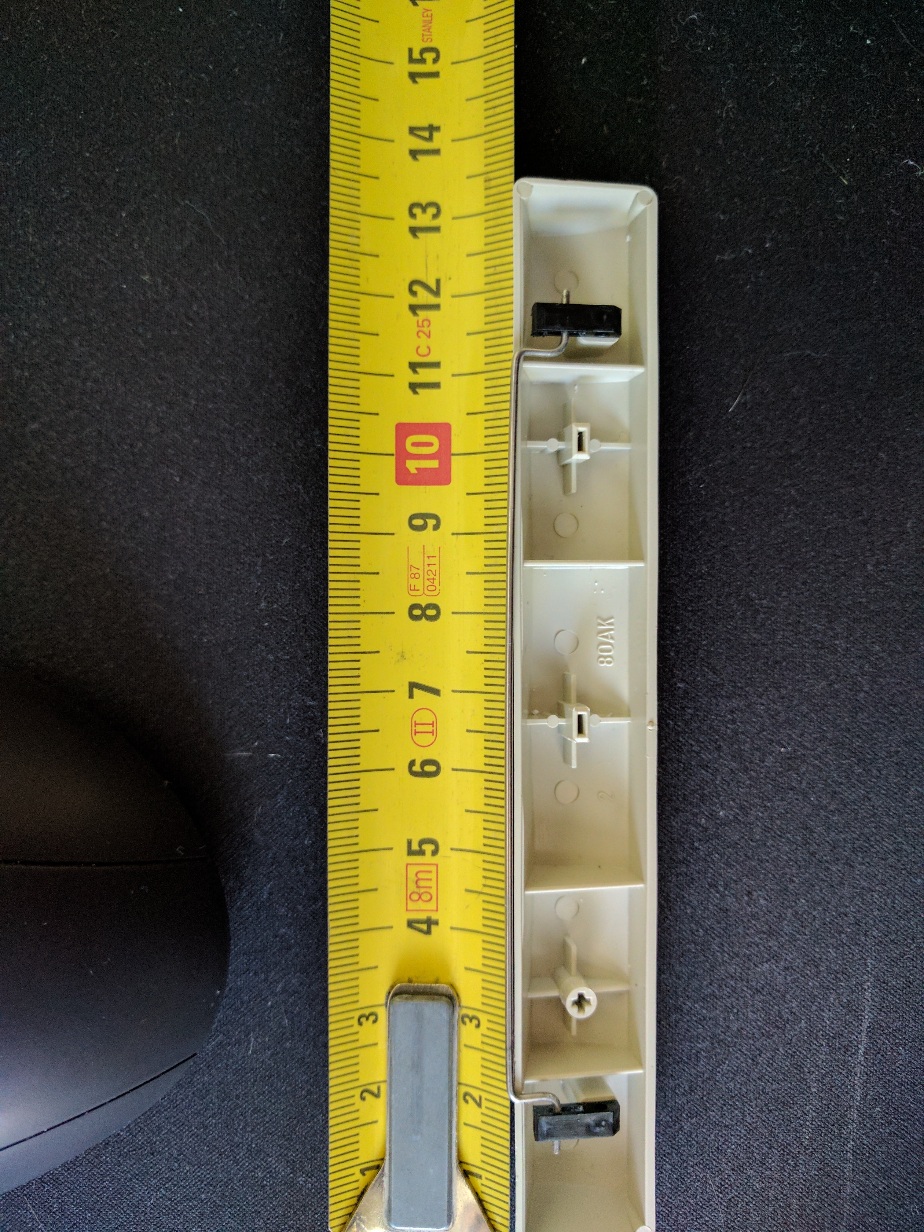

Posted: 18 Jul 2017, 18:34
by pansku
The spacebar should be 7u wide. It is 133mm at the widest point which is the front edge. The used holes for stabs are made by me and are a bit too high up. The non used large cutouts are made by the tool.
Here's a few quick pics with my phone and a measuring tape:
