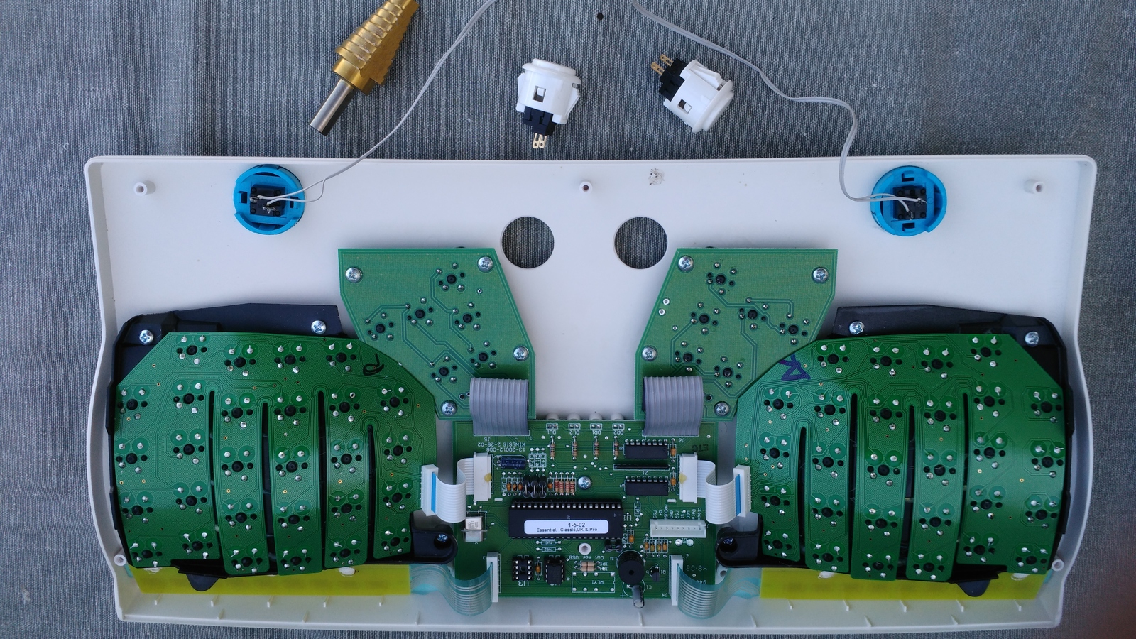

This thread has given me the confidence that I should be able to do the palm key mod to my kinesis! :)
A question though, how often do you use those palm keys? I'm thinking about putting some characters that I use relatively often on the second layer. (å, ä, ö, I'm swedish) Atm I access them with AltGr, and I have AltGr mapped to the bottom left key on the right thumb cluster. Do you think it's easier to press a palm key then to press that AltGr?
I'll probably do the mod in either case, but I'll get to it faster if you recommend the palm keys over AltGr ;)
Posted: 20 Jan 2013, 22:59
by bjarven
Done! It was quite easy with a stepped drill bit.
Unfortunateny I don't have a soldering iron (yet, it's in the mail...) so the cables connecting the buttons were just taped on. They worked for a while but I think they've fallen off now that I've moved the keyboard. So now they're just sitting there looking pretty...
A related question, do you know if it's possible to remap {} and () to the keypad layer? I tried but since they require me pressing shift before pressing the remapped key I ended up remapping shift insead.. Any ideas?

bjarven, congratulations on a fine looking keyboard!
Very happy to see you did the mod, you even put the buttons in a better position than I did!
Let us know how it feels in a few days, after you get used to it. I use both my palm keys for Shift.
Actually, on the keyboard on which I did other mods (extra thumb keys) I use the right palm key as momentary keypad shift, but on my other keyboard, both palm keys act as Shift.

sordna wrote:bjarven, congratulations on a fine looking keyboard!
Thanks! I took your advice on the placement, and put them a little bit further away from the thumb clusters. Today is actually the first day that I have them wired up, so I'll have to wait some more time before getting used to them. But so far they behave very promising! :)
I'm using them for AltGr at the moment, and I have å,ä,ö¸{}, [], () on the AltGr layer. Microsoft Keyboard Layout Creator 1.4 (phew long name) is very useful for creating easily redistributable layouts. As long as you stay on windows I guess...

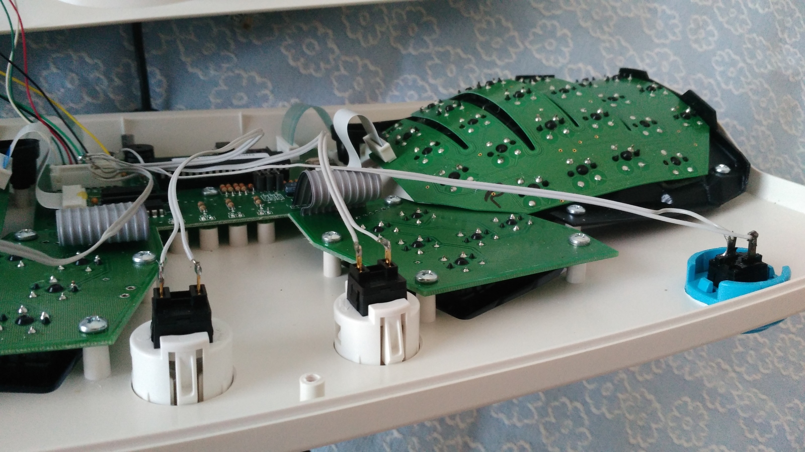

Added couple more arcade buttons to my work keyboard today

My 2 LFs together for comparison.

Did the 4-arcade button mod on my PS/2 Classic too. For the buttons near the middle of the keyboard I used Sanwa OBSF-24. They are smaller in diameter but quite a bit deeper in the case than the Seimitsu PS-15, but thankfully the case at the point I placed them has much more room than the spot where I drilled for the palm buttons.
By the way has anyone used these buttons: http://www.gamerfinger.com/hbfs30.html which take cherry switches inside? These HBFS-30 look cool and seem to be very low profile inside the case.

Posted: 17 Jul 2017, 08:04
by martink
From the Geekhack link, the buttons attach to where the 3 footswitches are connected internally. Looks like the left/right button pairs are mapped to one footswitch each, so you could add up to six buttons.
