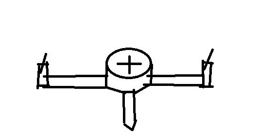

For stabilizers I have now decided on a policy of "only space bar." The beamspring is so robust and side to side stable that basically the only key that needs stabilizers is the spacebar.
This crude drawing is how the rest of my stabilizers will work. I will either cast these parts or 3d print them.
mx stem crude drawing.png (4.3 KiB) Viewed 22417 times

I don't think you need such stabilizers - the switch is under the key center everywhere.
The stabilizer is there so it pulls down the other side of the key when you press off-center. To achieve this, it must be held down at the other end.
Suppose you press the left end of your spacebar. Downforce on the left is converted into stabilizer rotation, which twists the stabilizer stem, and tries to convert that rotation back to downforce. But it needs an anchor there - otherwise the stem will just raise towards the key, not press down on it.
Your scheme has no anchor, so it won't help much there. The only benefit is a bit less bending of the keycap socket - not sure how much of a problem is that. For shitty keycaps it's a big problem I guess.

DMA wrote: 20 Jul 2019, 04:48 I don't think you need such stabilizers - the switch is under the key center everywhere.
Hi this does make sense. The main problem is that for original beamspring switches, the metal stamped stem that the key sits on is very tall, very thick and very sturdy steel. The keycap socket holds onto that stem with thick walls that really brace against rotation. You would only ever break your keycap socket if you used excessive force to rock the keycap sideways when removing it.
The sort of rotating "left down/right down" motion that a stabilizer would correct for basically doesn't happen because of this. It is so strong that the only key on the original with a stabilizer is the spacebar. Even then, you can honestly remove the spacebar stabilizer and they keyboard is still mostly useable.
For cherry mx mount, the stems being plastic, and in this case 3d printed by me, they are in fact much less durable. This is just due to the 3d printing method I have used where the layers go across. So rotational force, can break the stem off while inside the keycap socket.
So the stabilizers I am printing are not actually stabilizers, they are stress relievers. They are designed to relieve stress on the cross of the stem, not the keycap. So that I don't have more keys that end up like
Like this.

I should really try making the dual stem pieces ive mentioned out of metal this time. I think this could make for a sturdier keycap interface for mx keycaps.
I don't think i've posted this image before...?
regardless I will mill some of these in aluminium to see how they work with mx keycaps.
I was thinking of some 1/4 circular pieces that would slide in the plastic stem-tube part to make the metal-stem not rattle a lot. When you pull out the locking metal stem piece, the circle parts would not be held in place anymore and would just fall out.
2 piece and a keycap.JPG (80.55 KiB) Viewed 20815 times
