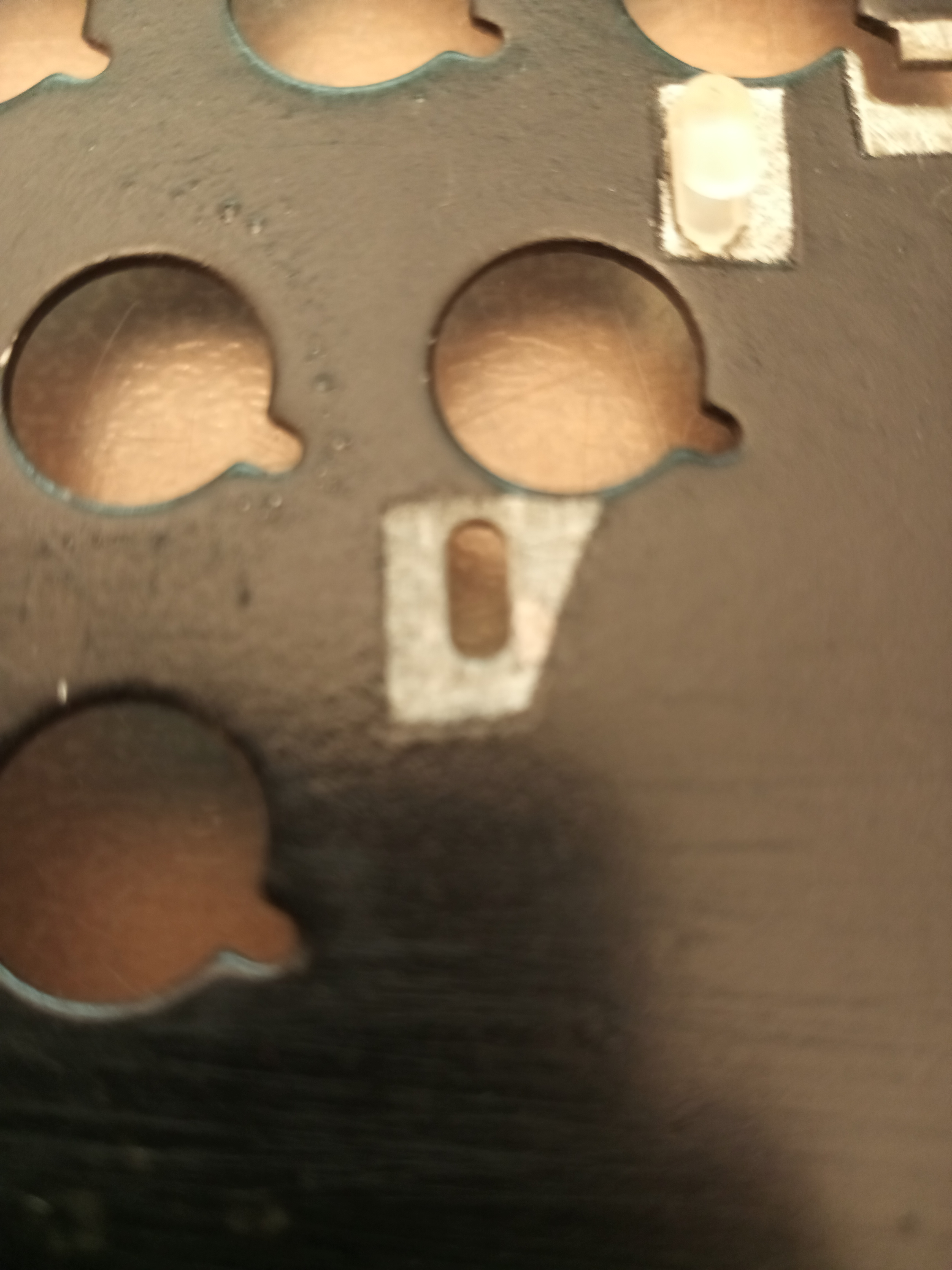

Hi,

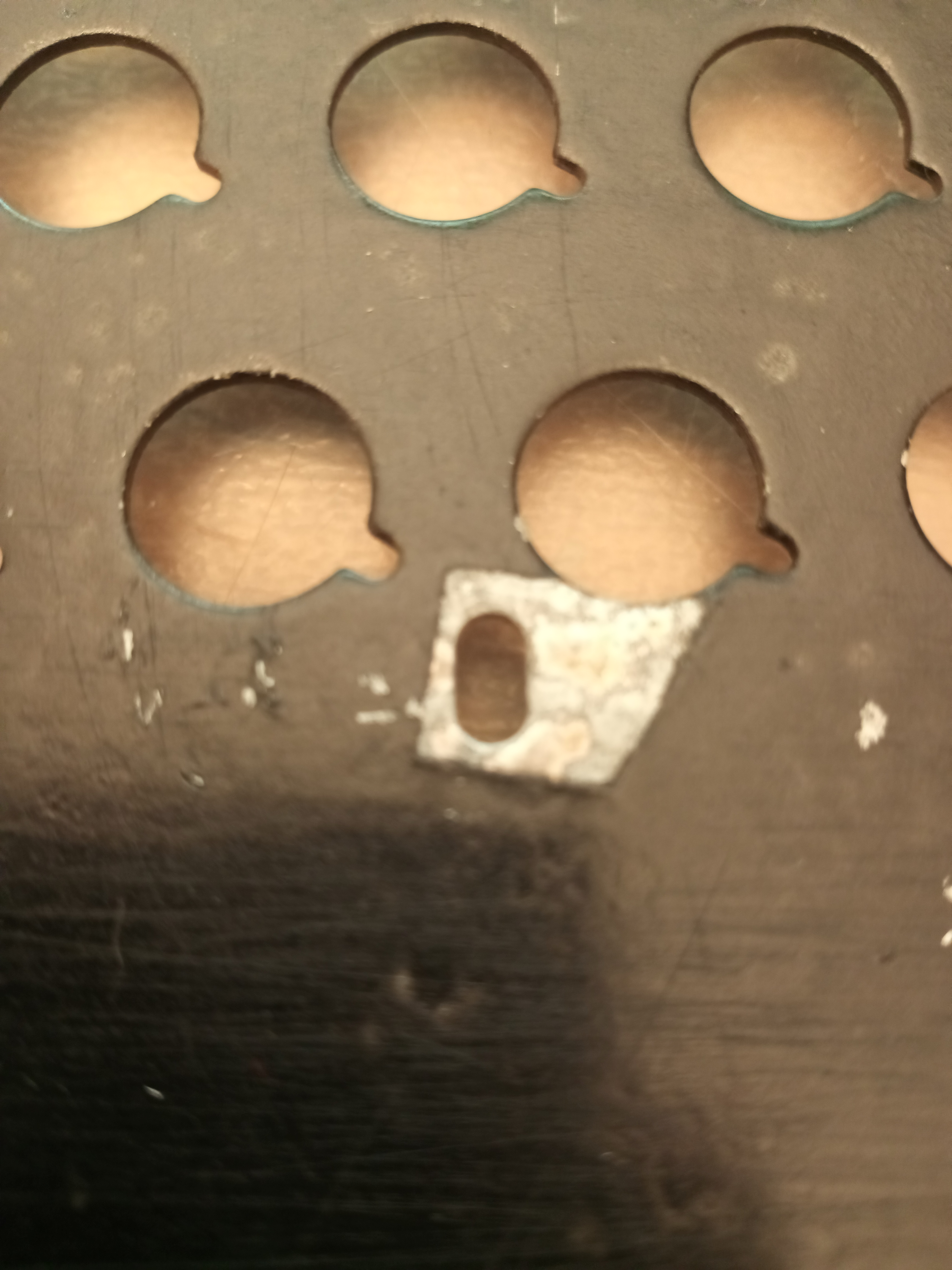

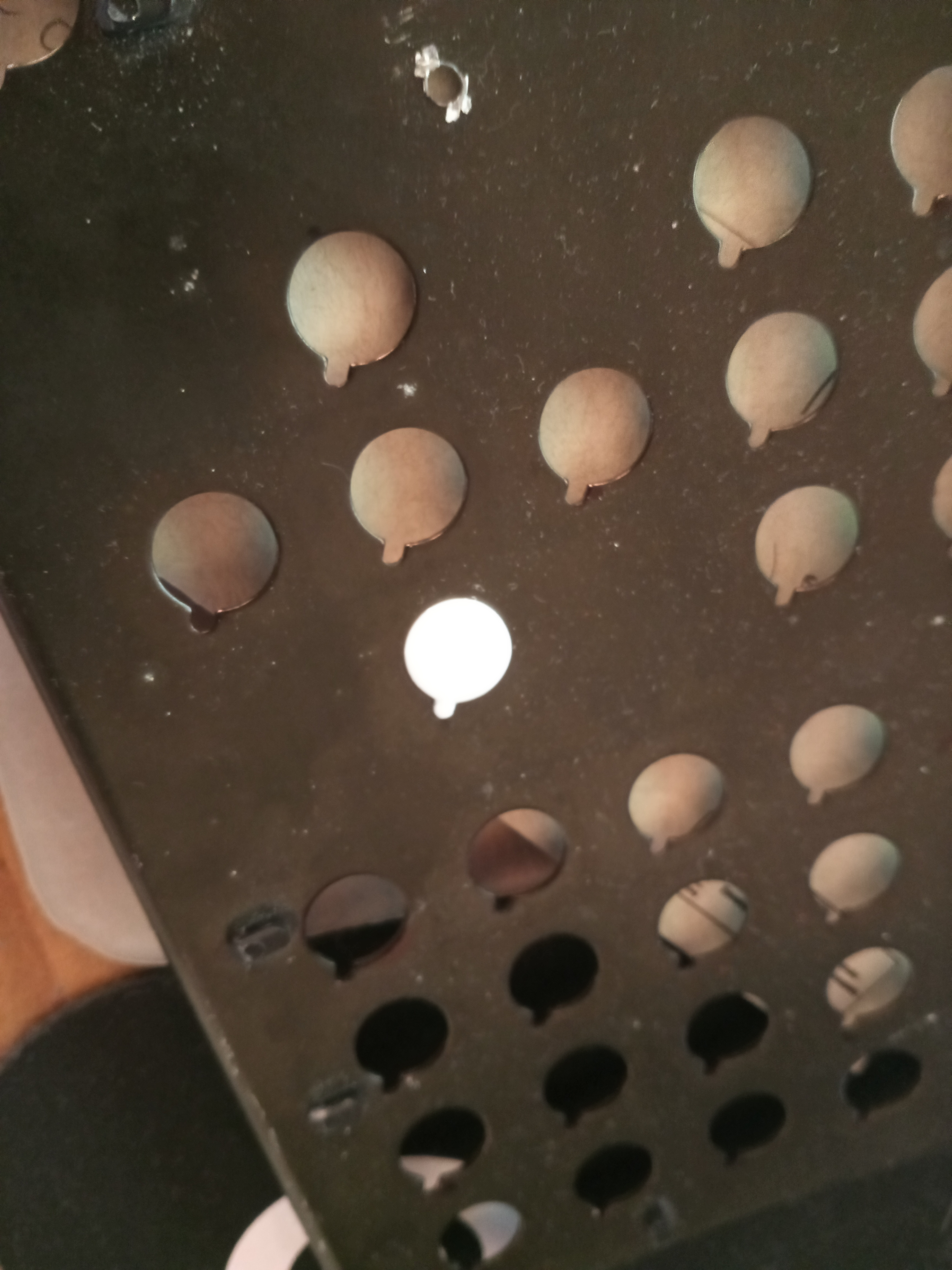

So I printed a model f at/122 plug and it seems to fit and work fine. Super duper. It's a bit tall, but I can fix later.
plug bottom.jpg (2.25 MiB) Viewed 8691 times
plug 1.jpg (2.33 MiB) Viewed 8691 times

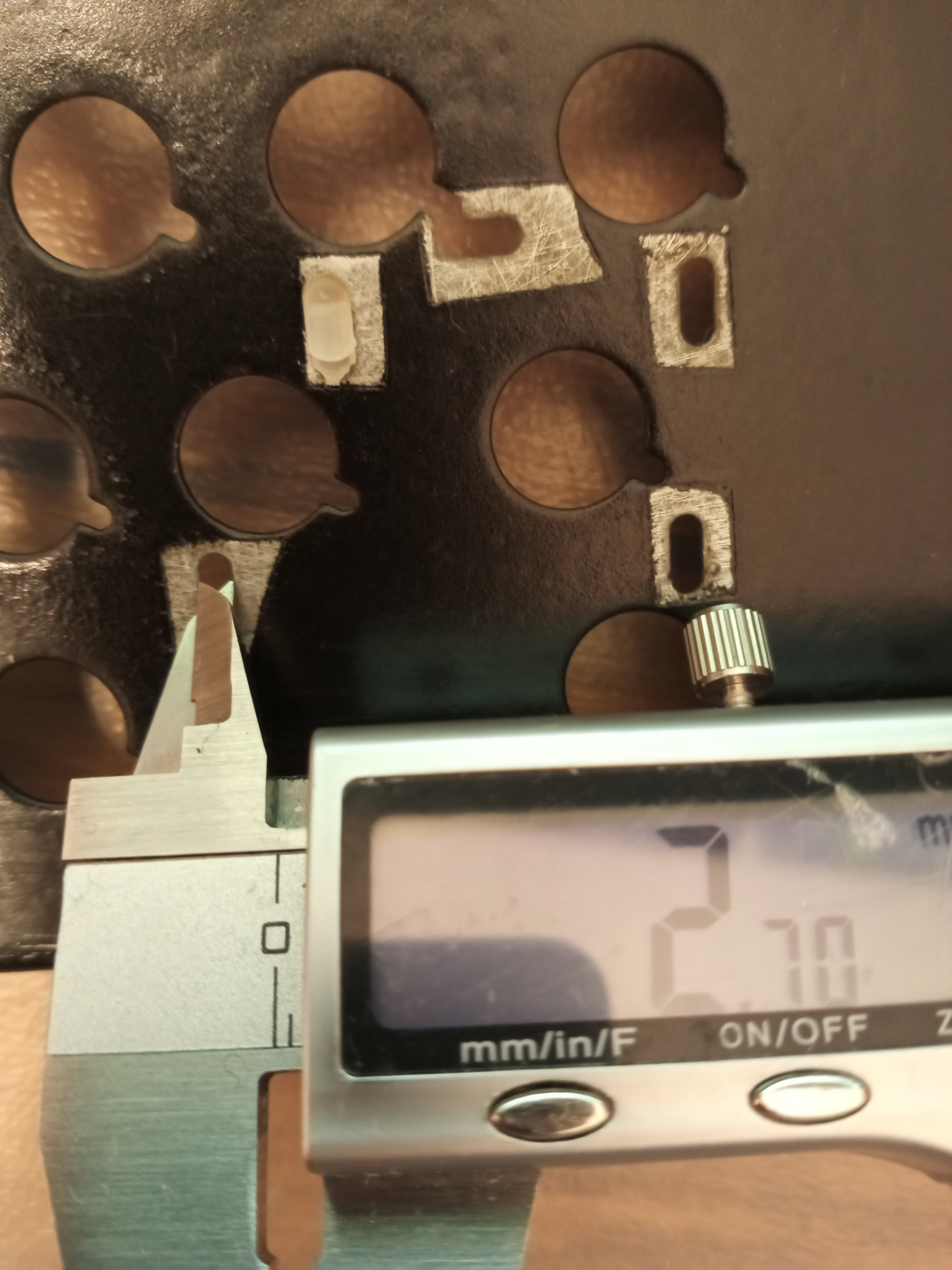

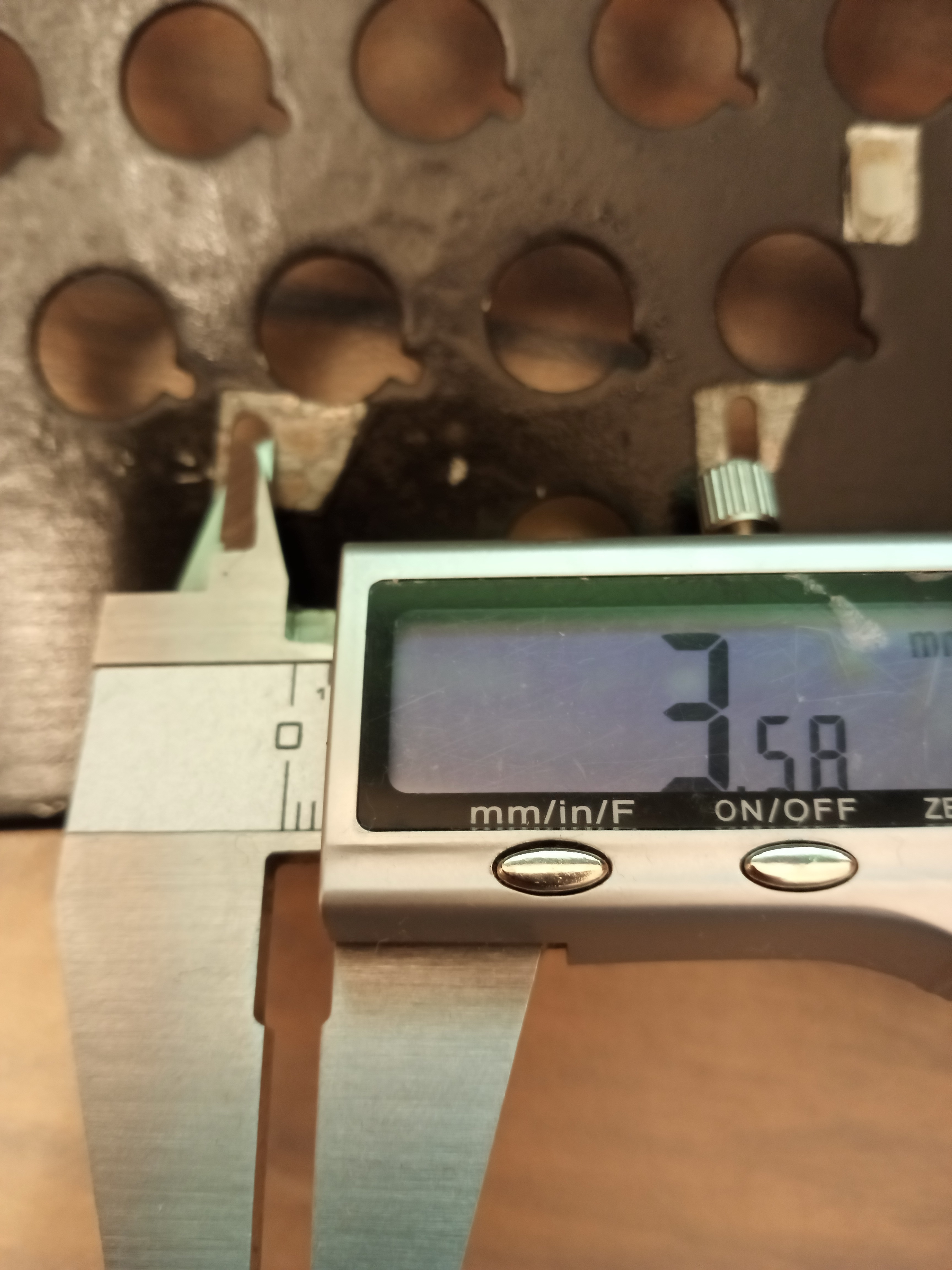

When I was modelling the model f I realized I didn't know how to represent the curvature of the model f. I found that ellipse and manisteinn gave values of about 300m from the backplate.
I wanted to verify this for myself. I printed this attachment thing for a caliper.
https://www.thingiverse.com/thing:2746027
I got a value of about 2.5mm on the tool on the back of the F122 plate. This calculated out to a radius of 301.5625mm.
To me this is close enough and the FDM printing has some variance. So I am happy with the 300mm model f back plate curvature value of 300mm

I thought that you were putting it on top of the plate, to fill the voids between two adjacent keycaps, making it level with the case. Now I see that you put it inside, between the plates, that obviously makes sense because it prevents any kind of dust from entering the assembly. Anyway the opposite could be possible too (top mount I mean), by adding maybe some clips on the stem that goes inside the plate, to prevent it from dislodging.

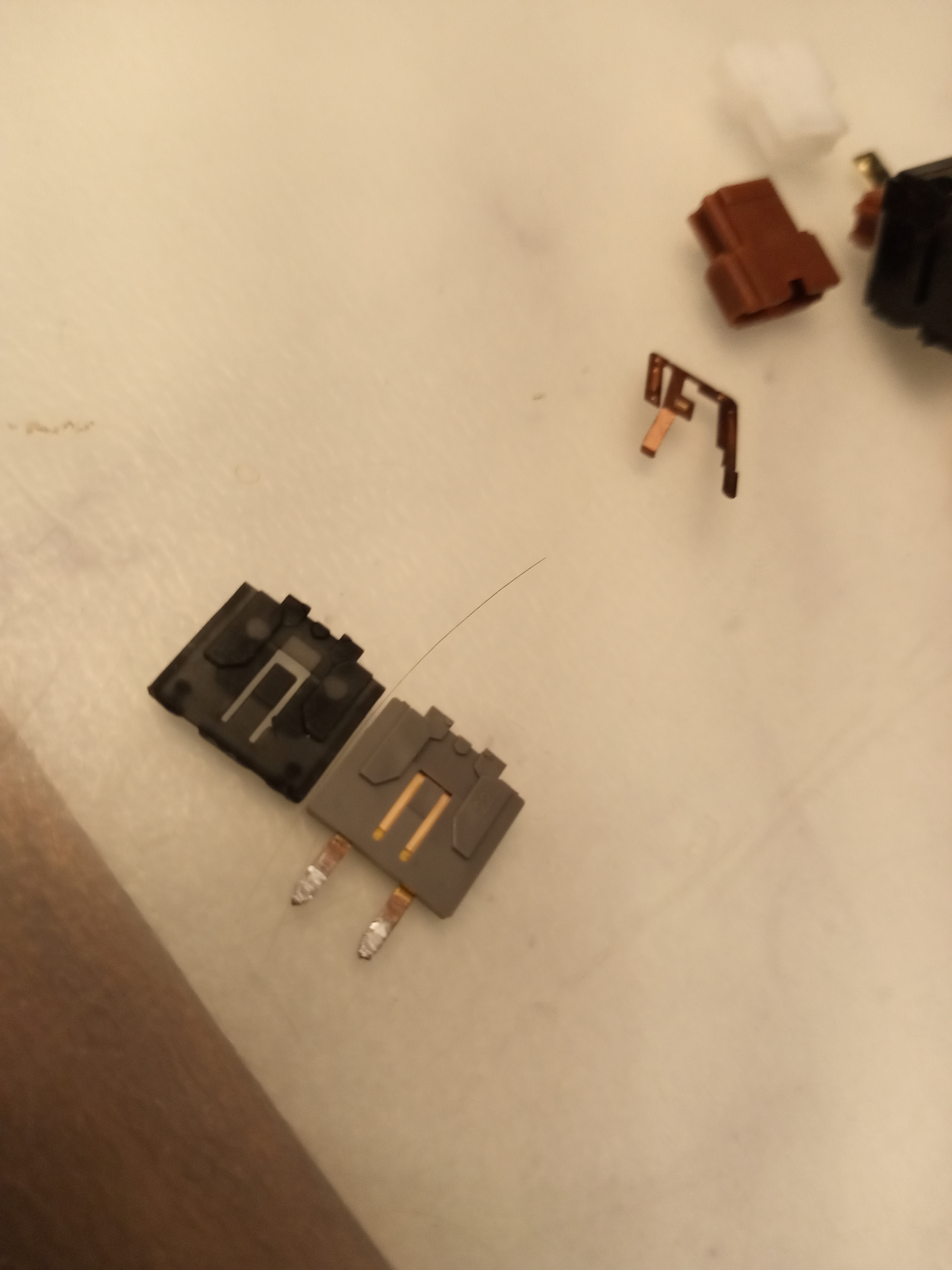

Re: Resin print keyboard parts factory
Posted: 08 Sep 2020, 00:53
by SneakyRobb
Hi,
I will print some more stabs now. Trying to get them to fit a bit better. Previously my prints kept peeling off or not sticking to the plate. I have increased the UV exposure time of the lower levels of the print. I hope this helps.
I am still having issues making the model f flippers click properly. The dimensions and accuracy required a trickey!

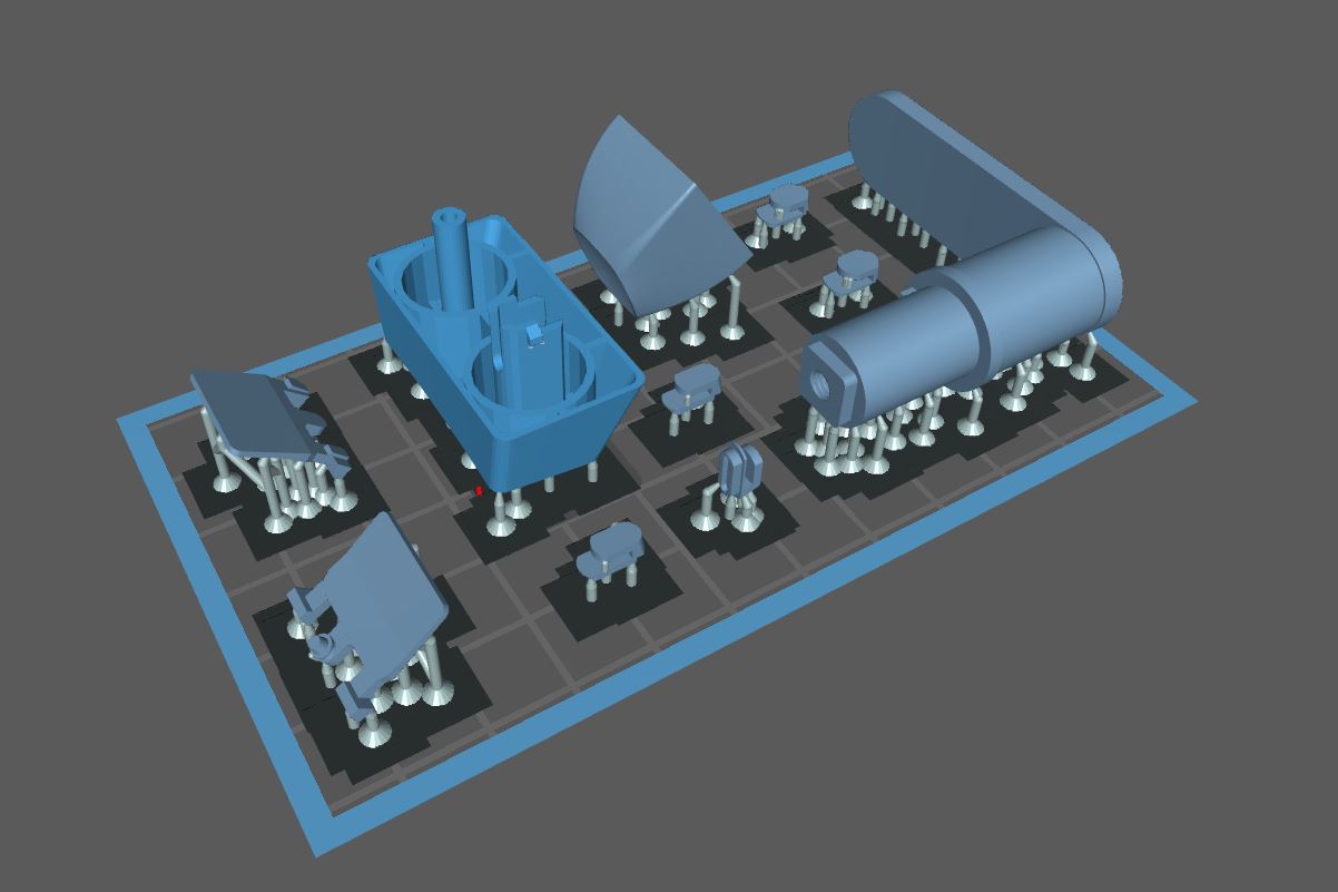

Here are the items I am printing today.
The black resin kept failing while the clear one was very success. I think the UV goes through the clear more easily and the bottom layer adhesion was just better.
I thought it would be fun to print a model m keycap so I added one as well.
I have angled the model f flippers more so that they will not have flat areas where resin drips.
Here is yesterday prints with the stabs

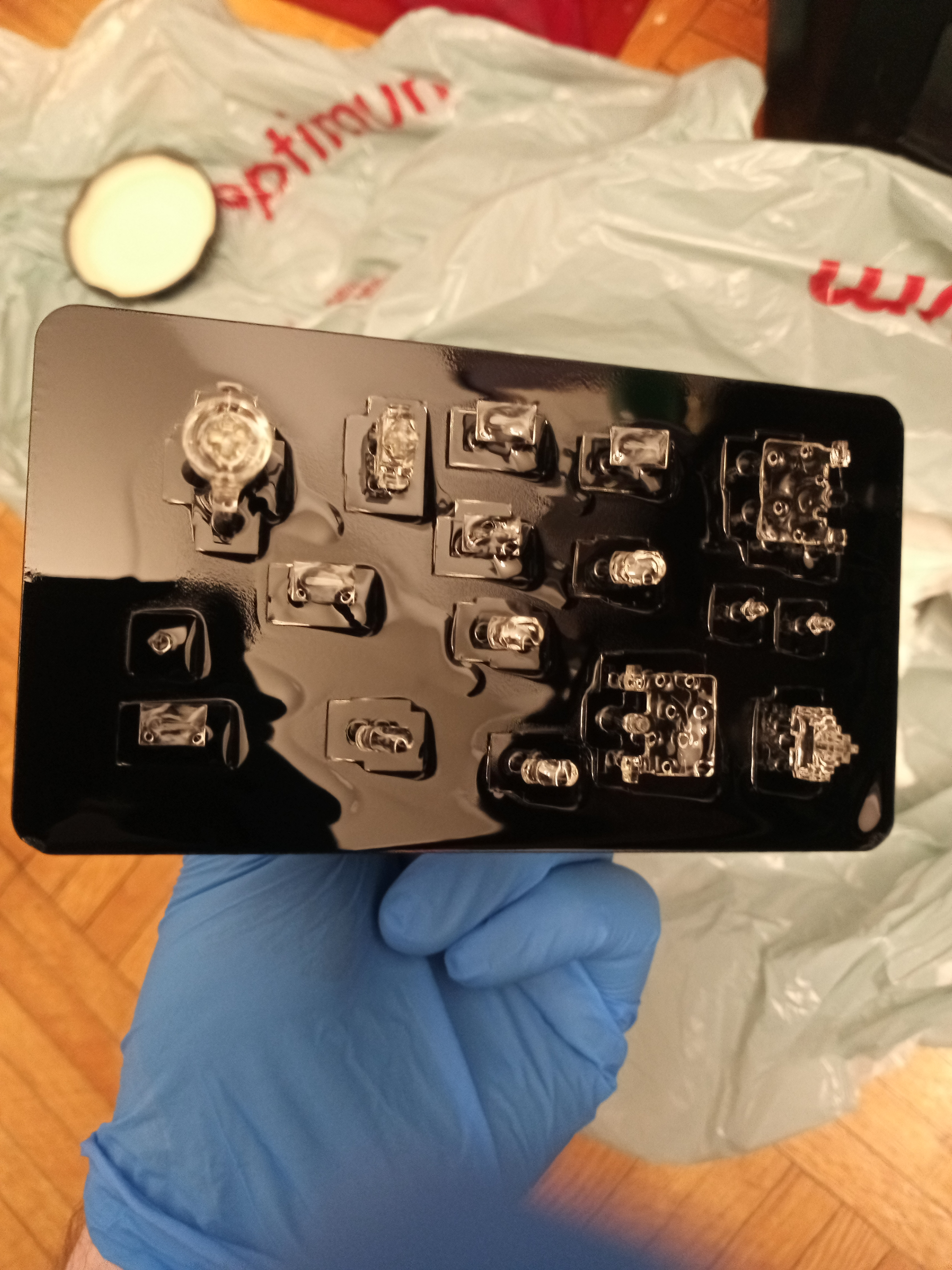

Posted: 08 Sep 2020, 03:07
by SneakyRobb

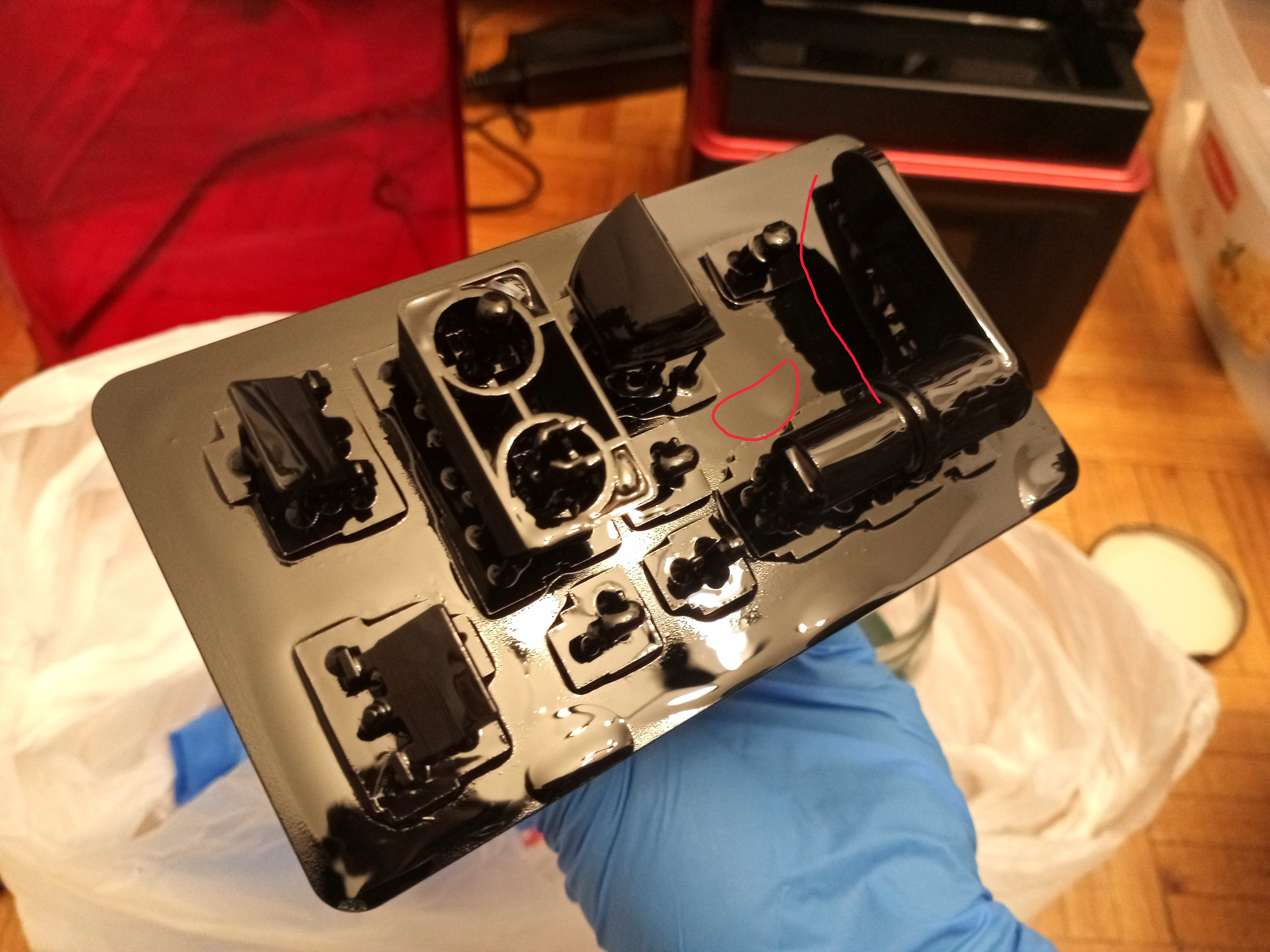

Hi, and here is the print before cleaning. You can see the model m backspace key clearly. Increasing the lower level cure time has worked great.
The print is inside the box currently.
Looks like every item printed correctly. Yes.

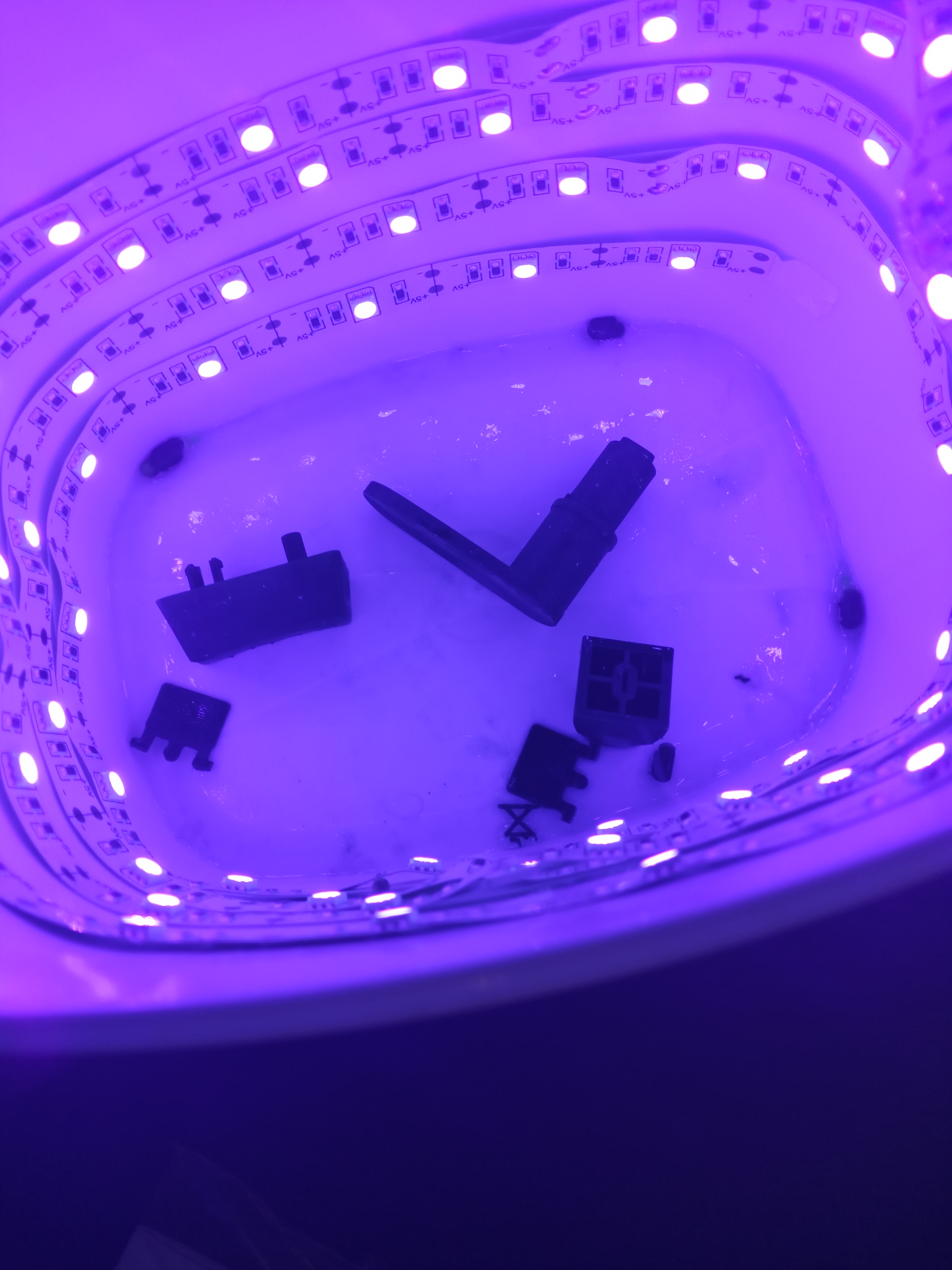

Posted: 08 Sep 2020, 06:05
by SneakyRobb
Hi,
I must bed now but here are the parts in the UV curing thing.
You can see how the model m backspace has some stuff from where the supports were.
Robb

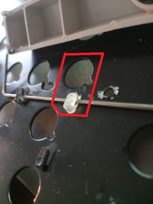

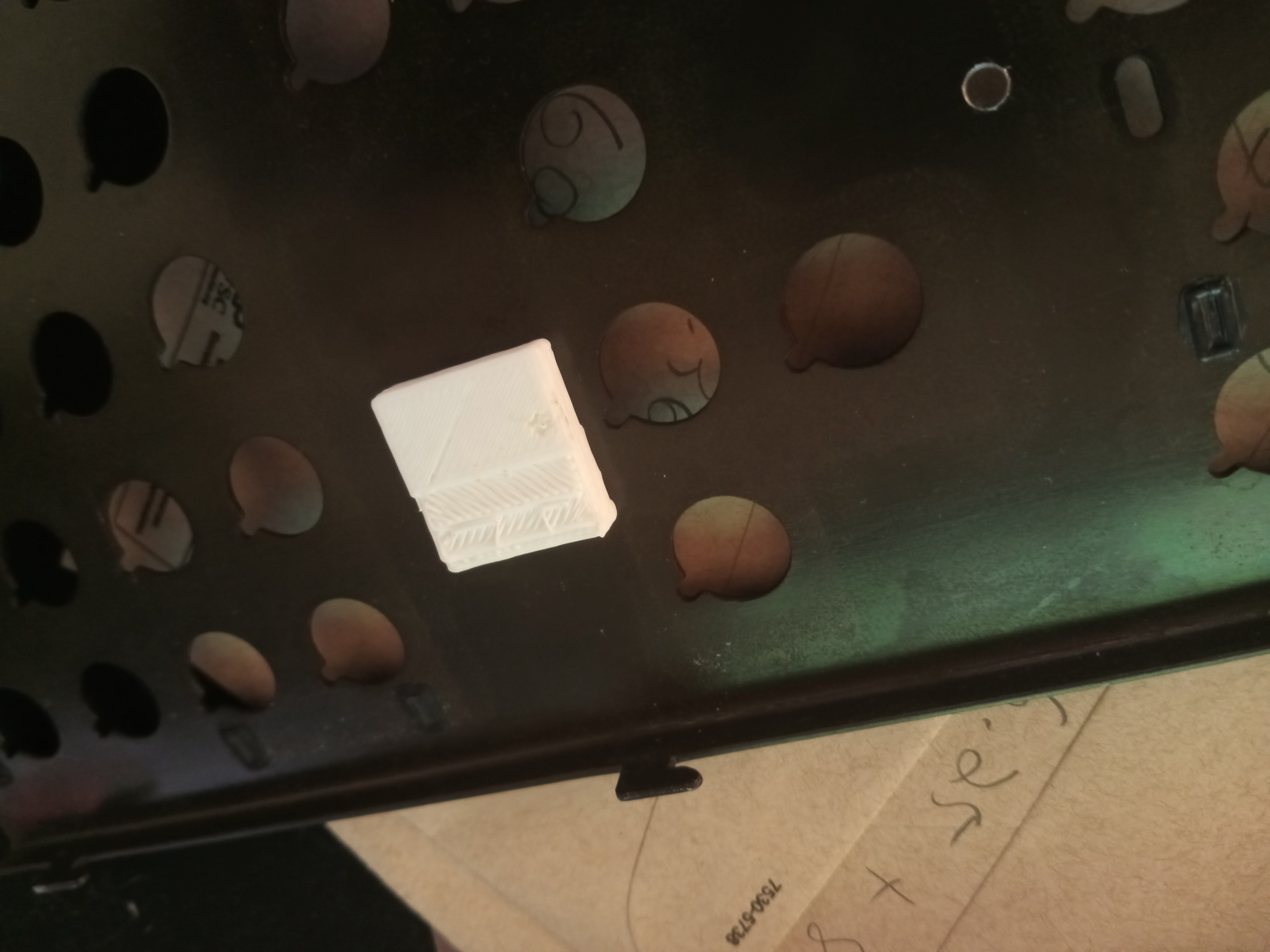

The hole in which the stabilizer must be inserted is very small, so placing a screw to hold it (like I was thinking when I say this problem), seems quite difficult...
You can go the costar way, with a stabilizer simply inserted into the hole without any clip, I don't know if resin is flexible enough to have those little protrusion bend a little to allow the insertion and secure placement, I fear not. And the hole it's too small also for cherry style clips.
Or you could design the stabilizer with a hole in the middle, to allow some flexibility when you insert it (green arrow).
Then you leave an open side where I put the yellow arrow to allow the wire to be inserted.

Or the alternative could be to make a "base plate", with a thickness of 3mm or so (if it doesn't interfere with the bottoming out), with a hole (around the barrel), and a pin (that goes inside the existing hole in thenplate).

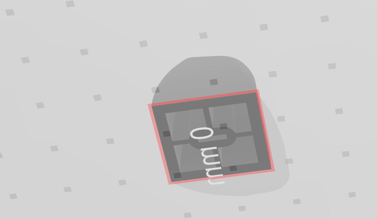

Thanks for your appreciation.
The "plate" doesn't need to be square obiously, it just needs to go around the barrel, like a ring, and the go to the stabilizer's position, with two pins (one near the barrel, and one where there is the stabilizer.
Sorry for the horrible cad, but at home I have only linux, and the pain is real.
$$$Screenshot from 2020-09-09 23-50-46.png (9.29 KiB) Viewed 8299 times

Anyway, going back to the costars, I think that they're not too bad. They can be installed without decoupling the plates, and when you need to remove them, you just cut (first you remove the top piece, and then you cut between the legs).
Please notice that the bridge stands above the plate (colored in red) so it can be cut very easily, and note that the two legs are decoupled so after cutting they become lose and you can extract them without trouble. Furthermore, after the cut they can't fall inside the hole, because the top is larger than the bottom, so the design is foolproof.

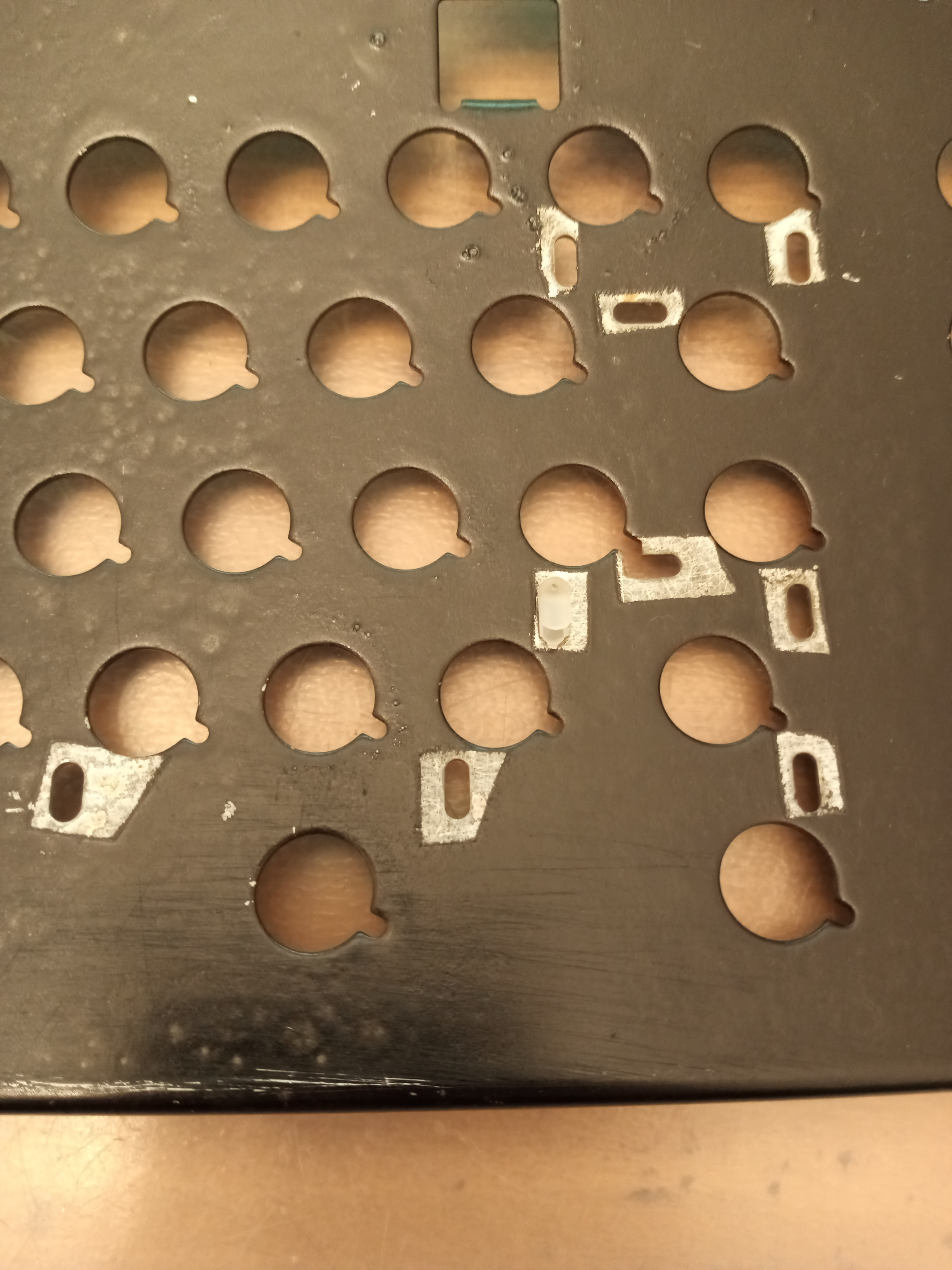

Otherwise. I was trying to help with stabs. User Sturmtiger provided their F122 plate. The reason is that I have not actually seen the F122 spacebar stab hole. All my F122 stabs are intact. The hole.... is actually bigger. Not surprise as the stab is wider!
Regardless. need to adjust model to fit.

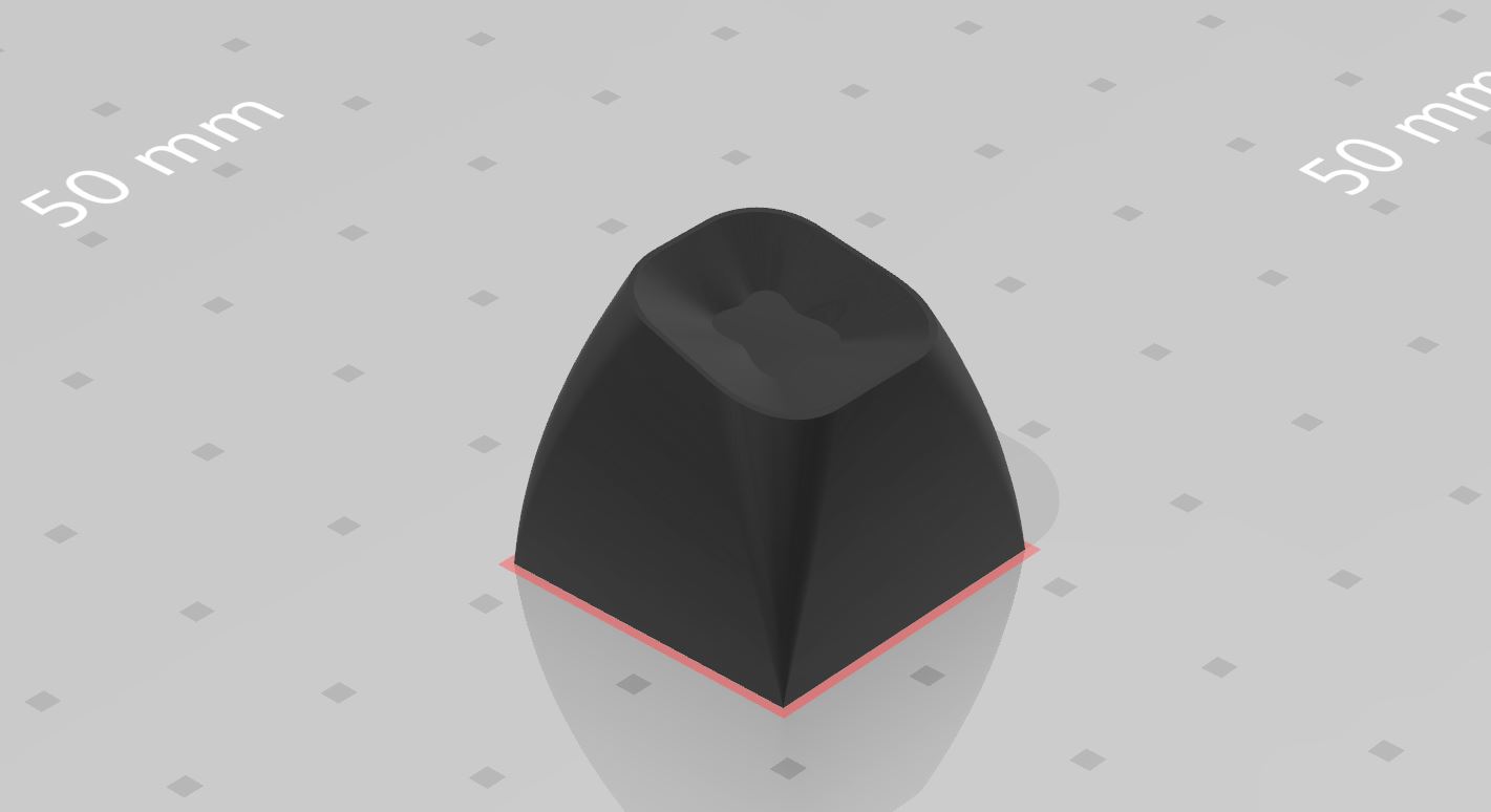

by SneakyRobb
Hi,
I was using the one from the low profile beamspring thread but I have been trying to make my own from the ground up.
viewtopic.php?t=21925
This is the top row version I am with currently trying below. I am still trying to understand the curvature profiles in 3d modelling. 90 deg and circles easier! Grabcad has issue with model, but you should still be able to download.
But it looks like this.
https://grabcad.com/library/beamspring- ... periment-1
Posted: 16 Jan 2021, 00:13
by SneakyRobb
This was the thought process for this key. I think the indent will be adjusted but I am happy with shape to a degree otherwise.
I notice the original one has a more cross pattern and a shallower indent, but I will try this first regardless. I have reduced the filet here and made it more square vs the one above.
The top flat part will be reduced to have a shaper edge like the original

The skcm plate is good and well formed.
