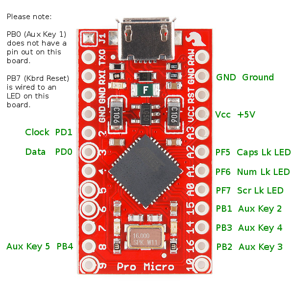

Posted: 31 Aug 2013, 08:40
by BCG
hasu wrote:Looks nice and I like its beautiful layout of components.
But two complains:
1. No reset button on the board.
2. Arduino firmware is not usable from my experience of Leonardo. We'll need to replace it with LUFA firmware.
Hi guys, this is my first post here... hope I'm doing this right.
Anyhow I tried out the Leonardo Pro Micro for Soarer's Converter and it seems to work fine... BTW thanks Soarer, your invention rocks!!!
I didn't use SparkFun's board but rather ordered a clone from China via eBay... I got 5 for $42 delivered to the US so it was significantly cheaper.
As far as I can tell here are the relevant pins for Soarer's Converter (I didn't record all of them because it was taking forever and I'm kind of lazy; I'm sure if you care you can just check the schematic from SparkFun):
pins on Leonardo Pro Micro for Soarer's converter

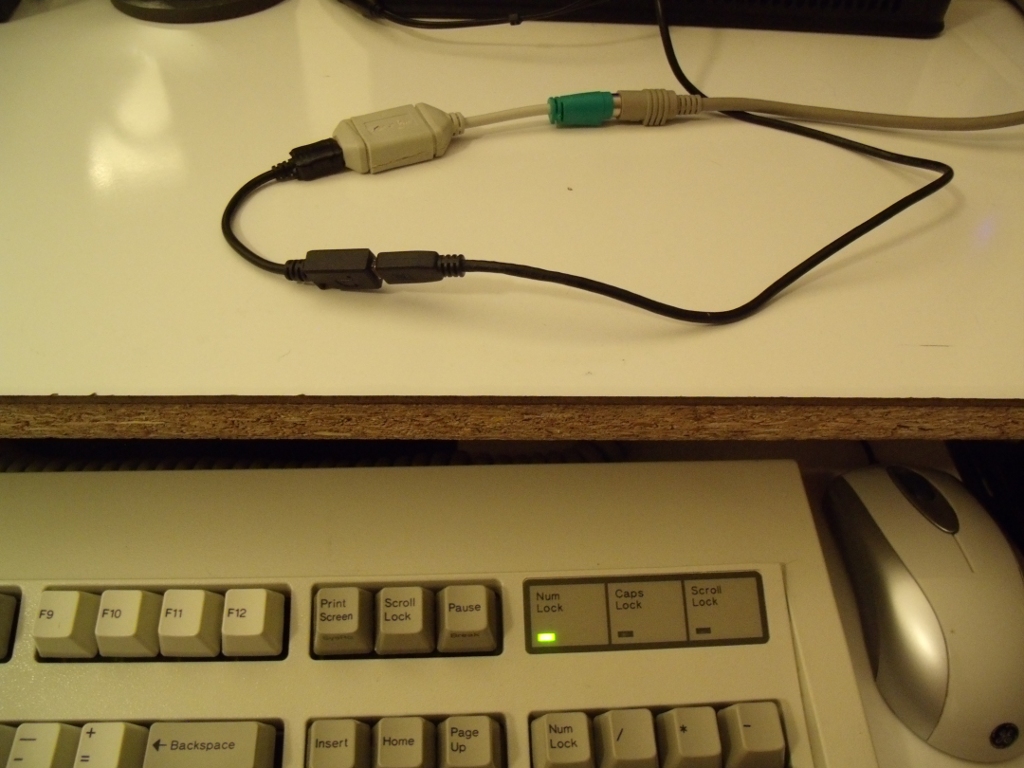

For an enclosure I used one of these:
http://www.ebay.com/itm/USB-to-PS-2-PS2 ... 5d3d4cb70c
As an adapter the thing was total garbage but with a hobby knife and a little persuasion it was able to fit the Pro Micro quite nicely. It is just the right width for a Teensy as well. Added bonus that it has 2 PS/2 connectors and a USB male included as well. Double bonus was that the PCB inside had a legend for the colored wires, making it a breeze to figure out which wire needed to be connected to which terminal.
Came together nicely, in my opinion at least:
Converter after soldering, before enclosing
Completed Soarer's Converter
Next time I might try to remove the micro USB as soarer suggested and replace it with the USB connection from the garbage adapter to make it look nicer and eliminate the need for a separate USB cable. In any case, this costs about $10 to make which is pretty cheap IMO.
Thanks guys for all of your great posts and contributions!!
