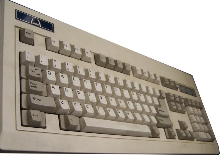

by klikkyklik
It's an old Arche board. Unfortunately I don't see a date on it. Considering that I'm fairly new at the keyboard game and haven't yet removed a space bar, I'll have to do a little research to find out how to do it properly with these Hi-Tek's. I'll see if I can get to it after work today (about 11 hours from now).

Posted: 20 Oct 2014, 20:56
by klikkyklik
Here are some more shots of the switch. There is no evidence of the little white trailing arm gizmo. If anyone would like better (cleaner!) pics for reference, I can try to do that.

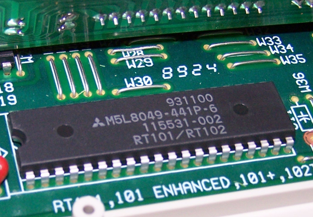

The date is on the PCB itself; it takes the form of four seven-segment digits for YYMM.
Posted: 20 Oct 2014, 22:55
by klikkyklik
No worries!
According to this it'd be 1989, but ... 24 for MM?

by chzel
klikkyklik wrote: No worries!
Could it be YYWW?
24th week of 1989?
Posted: 21 Oct 2014, 00:15
by Daniel Beardsmore
Argh. I keep writing MM instead of WW. Must have got a bit of 002 stuck in me ........
Yes, week. This should help Sandy's NBM Hi-Tek switch cataloguing efforts. It's useful to get the date, as in most cases we don't have that data, and it would give us a clearer idea of the history of the different variants.
(Interestingly there's nothing on the chip that represents that date.)
