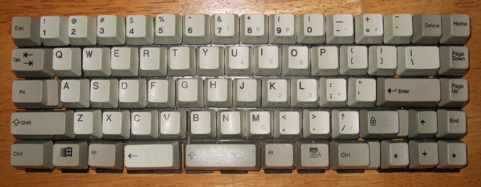

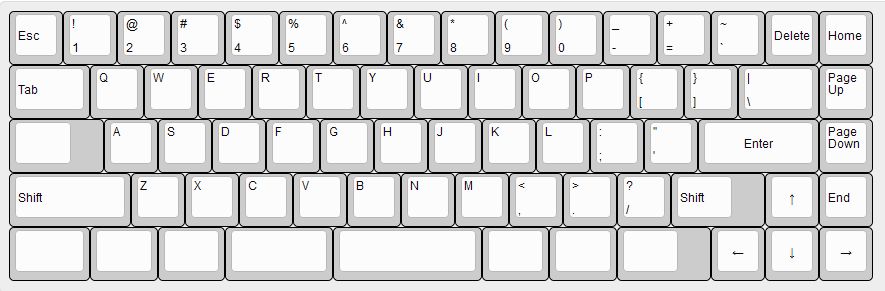

The key cap legends are just there for visualization - all of these designs would be fully programmable. Some folks like the middle left key as a Caps Lock, other like it as a Ctrl, but I like that spot for Fn. All of my Fn chords seem to be on the right side of the board; I use Fn+RShift for caps lock, Fn+Delete for Insert, Fn+P for Print Screen, Fn+arrows for media functions, Fn+N to toggle the embedded number pad layer. I use 1.75 unit stepped caps to make it easy to find the arrow cluster by feel. The bottom row is 1.5, 1.25, 1.25, 2, 2.75, 1.25, 1.25, 1.75(stepped), 1, 1, 1. You could use a blank or standard printed backspace for the erase-eaze and a blank right shift for the space. And because of IBM's great switch this is easy to convert between ISO and ANSI. We could build a prototype without the curve using sandwich layered case design for simplicity.

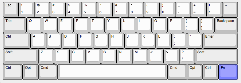

by Hypersphere
My choice would be the HHKB Pro 2 layout. I've adjusted the bottom row for a 7.00x spacebar and mods at 1.50x and 1.00x.
If necessary, the short Right Shift with 1.00x Fn key could be replaced by a standard Right Shift, and the bottom row adjusted to place a Fn key to the far right.
Possible alternatives for me would be a couple of different versions of a modified TKL layout -- to be posted later.

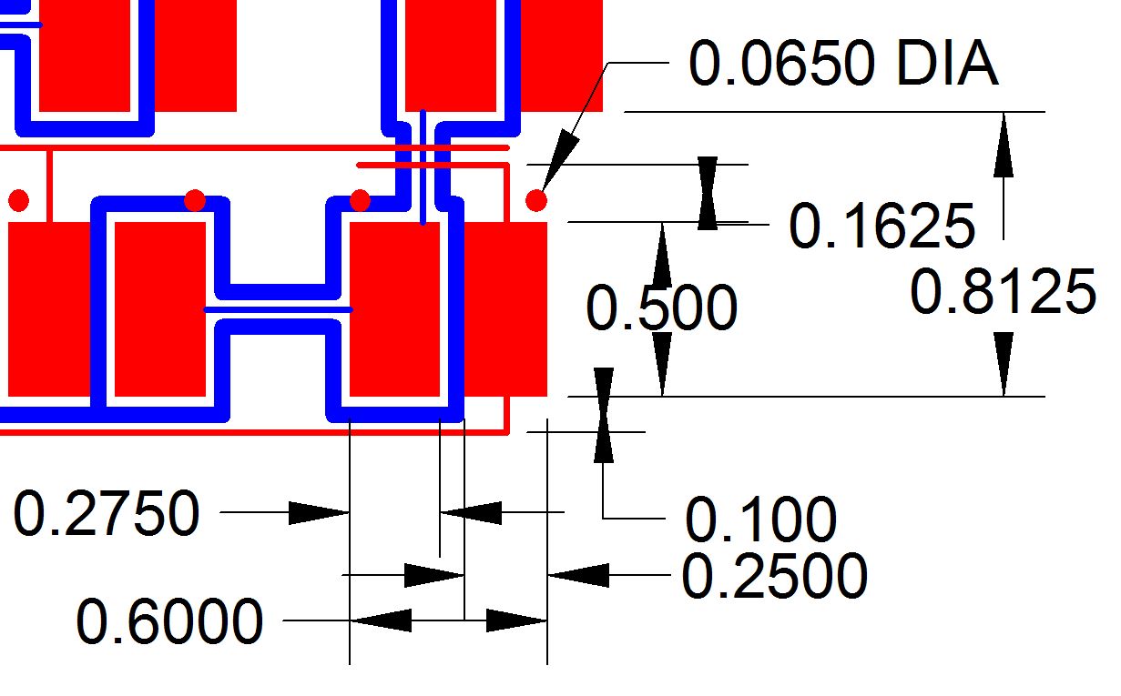

Posted: 06 Dec 2014, 20:44
by wcass
I do most of my PCB design work in DeltaCAD then import that into DipTrace. KiCAD doesn't import complex DXF files very well.
Design rules:
  • all rows must cross all columns exactly one time. This can lead to some curious traces
    all column and row traces are 0.020" thick
    all column pads and traces have a parallel ground trace - 0.050" thick, 0.025" gap

by 0100010
Hypersphere wrote: My choice would be the HHKB Pro 2 layout. I've adjusted the bottom row for a 7.00x spacebar and mods at 1.50x and 1.00x.
If you can deal with swapping the short right shift and the 1x function keys, that layout would work on the Kishsaver (if you add in bottom outside corner 1.5x mods).

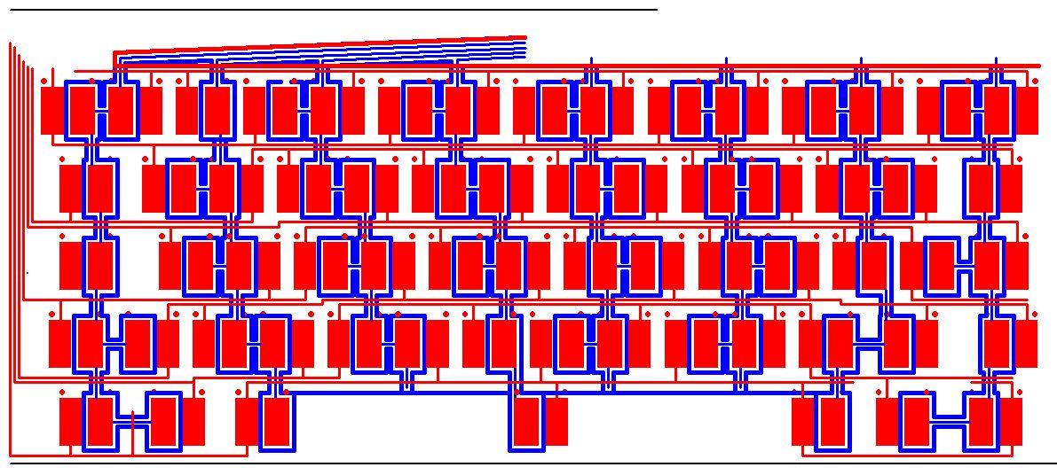

by wcass
Below is what i have so far for a 60% (64 actual capacitive pads set up in an 8x8 array). There should be room to put xwhatsit's controller on the matrix PCB. It would support Hypersphere's and 0100010's preferred key layouts - the only difference being the top layer of the sandwich on Hypershere's would not have holes for the bottom corner keys.

by Hypersphere
wcass wrote: Below is what i have so far for a 60% (64 actual capacitive pads set up in an 8x8 array). There should be room to put xwhatsit's controller on the matrix PCB. It would support Hypersphere's and 0100010's preferred key layouts - the only difference being the top layer of the sandwich on Hypershere's would not have holes for the bottom corner keys.
<snip>
Looking good! Would it be possible to include additional optional pads on the HHKB layout in case I wanted to add barrels later on, or would I need to commit to a specific PCB? If you are able to make a new PCB with a standard HHKB layout, this would be great. The only reason I can think of deviating from this is if it is not possible for some reason to do the short Right Shift with a 1x Fn key on its right side. But if you are making the PCB from scratch, I suppose this would not be an issue.
Looking ahead to physical production, how difficult would it be to make a curved barrel plate (along with the curved back plate)? Alternatively, how expensive would it be to have curved plates made?

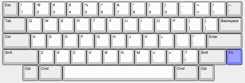

by Hypersphere
Okay, if it would be problematic to have a short Right Shift with a 1x Fn key to its right, here is a revised layout that should enable standard-size IBM/Unicomp keys to be used:
Posted: 07 Dec 2014, 05:27
by wcass
A stepped right shift + 1x Fn key on the right would not be a problem, it just means that a "standard" right shift would not be an option. But I'm not hearing from anyone (here anyway) that wants a standard right shift. Also, extra pads are not a problem - ISO, ANSI, and 2x backspace all have two capacitive pad sets under them. But the holes in the top plate for the "optional" barrels might be an issue. Maybe have a layer on top of the barrel frame made from a material easier to work with - acrylic, wood, or even leather.

Posted: 07 Dec 2014, 15:52
by Hypersphere
I am fine with either a Kishsaver clone (with a standard Enter/Return key and Fn on the bottom row) or a HHKB clone. The bottom row on the Kishsave clone could be as depicted in my layout above (1.25, 1.00, 1.25, 7,00, 1.25, 1.00, 1.00, 1.25) or as it is on the actual Kishsaver (1.50, 1.00, 1.50, 7.00, 1.50, 1.00, 1.50).
It would be nice, however, if we could avoid having to use stepped 1.75x keys, except perhaps for the customary CapsLock position. Although the traditional Right Shift seems like a waste of space with its ridiculous 2.75x units, I would prefer having a normal key there rather than a stepped key.

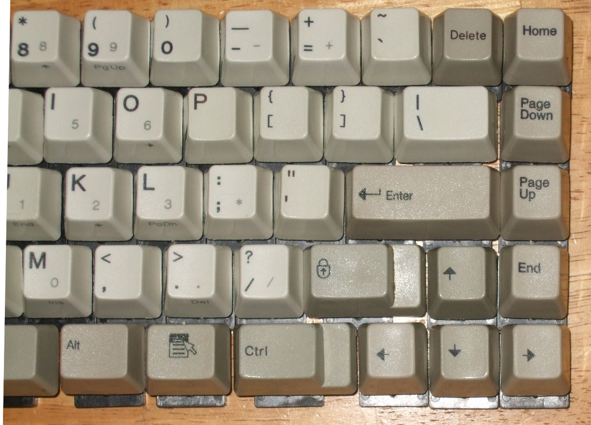

by 0100010
Unfortunately, non stepped 1.75x BS keys are a rare thing. I do recall some discussion of cutting down a 2.75x right shift, using some kind of resin or epoxy to fill in the step, or one could purchase a Japanese key set from Unicomp to get its short non stepped right shift (but last I checked they didn't have many left - and I am not willing to A, spend that much to get one key and B, deplete their stocks of that key just for this).
Posted: 07 Dec 2014, 21:18
by scottc
It might make more sense to have 1.5 + 1.25 instead of 1.75 + 1.0. It's not a perfect HHKB, but it works.

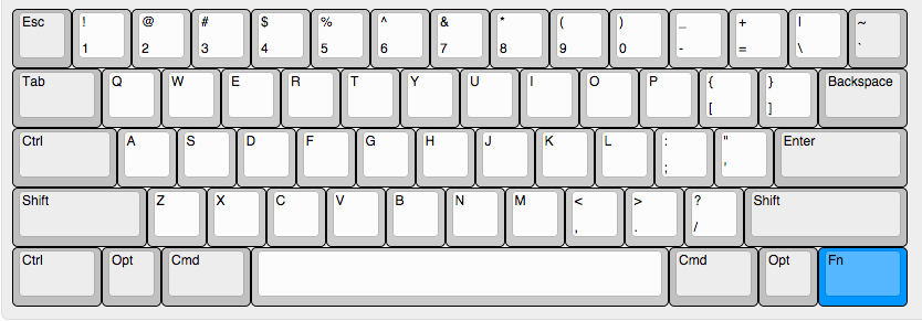

Posted: 07 Dec 2014, 21:26
by Hypersphere
To minimize the need for 1.75x keys, I would be happy with Revision 1 of the HHKB layout above, or with Revision 2, shown below:

Posted: 07 Dec 2014, 21:54
by Hypersphere
Muirium wrote: No HHKB pinkie Fn = no HHKB.
Yes, I know that Fn is ideally placed to the right of a 1.75x Right Shift, but because of the system constraints, I am willing to compromise (a word that always sticks in my throat!) and move Fn to the lower right-hand corner of the keyboard. This is the placement I use on all my "standard" keyboards, such as my RF 87ub 55g. And I still use my pinky. This arrangement is actually slightly more comfortable for me than the Fn placement on the true HHKB because it is slightly less cramped. I've tried putting Fn a bit more to the left in the bottom row and this doesn't work for me at all -- far too cramped.
Posted: 07 Dec 2014, 22:59
by andrewjoy
Unicomp need to make the caps lock sized cap without the step in it. Don't they know all the problems they are causing ? We know the mould exists somewhere as we have seen a key that size.

Posted: 08 Dec 2014, 00:01
by andrewjoy
i think so yes you could just have it fit over a cap like control or alt do on a model m
it may be worth asking unicomp what it would cost for them to tool up for them i know many people would want them jsut for standard boards as well, i would like one with control on it for my 122 for example.
