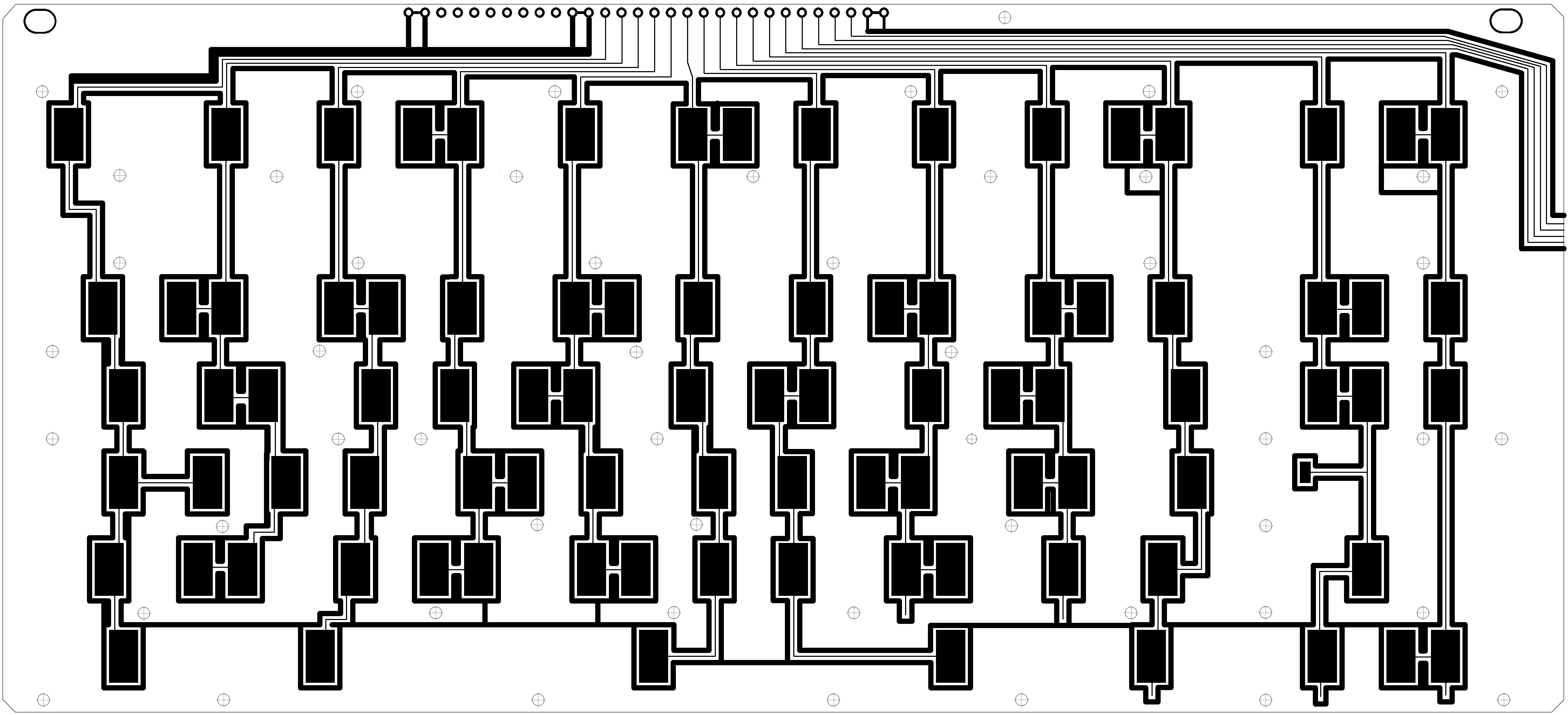

Posted: 03 Jan 2016, 22:25
by wcass
What thickness PCB are you planning on using?
I didn't see any rivet holes in your final design.
Left Alt looks like it is not connected top-side.
Posted: 03 Jan 2016, 22:32
by idollar
Thanks !!!
wcass wrote: What thickness PCB are you planning on using?
0.8mm.
I have considered them in the design. but they are not painted in the version that I have posted for two reasons:
1) I plan to print the pcb before placing the order to ensure that they are in the correct place.
2) I plan to drill the holes when I receive the PCB, using the back plate as template. This will ensure that they are exactly in the right place.
They are painted in the drawing below
If you are talking about this (in red)
EDIT: what you see is a screen-dump.
There is no flipper on top. It is just one of the space barrels.
Posted: 03 Jan 2016, 22:38
by chzel
wcass means the pair of the L alt, which is not connected on the TOP layer. If you open just the top.gbr you'll see it.
Posted: 03 Jan 2016, 22:40
by idollar
Regarding the picture above, the rows-columns puzzle did not allow to give the non-used barrel a bottom column.
So instead of deleting it, I just left it unused.
Column 3 could have another row, it only has 7 out of 8. But the unused one is in the third row (green 6). It will mean to redesign all of it to gain nothing as the barrel will be empty.
Posted: 03 Jan 2016, 22:41
by idollar
chzel wrote: wcass means the pair of the L alt, which is not connected on the TOP layer. If you open just the top.gbr you'll see it.
Let me check it ...
Posted: 03 Jan 2016, 22:43
by idollar
Yes !
Posted: 03 Jan 2016, 22:59
by wcass
Let the PCB fab do the rivet holes. The fab will drill the holes before the traces are plated so that there is no chance that the nearby traces will break due to cut or vibration.
Posted: 03 Jan 2016, 23:01
by ramnes
So we're already at version 1.0? Yay, it already works! :mrgreen:
Posted: 03 Jan 2016, 23:03
by chzel
If exact placement is an issue, make them a bit oversized, I believe the pressure of the sandwich will keep them in place.
Also, maybe a thinner PCB (0.6mm?) would be better? I worry that 0.8mm will stress the barrel plate too much. We are dealing with potentially brittle plastic, not the metal plate of a Model F.
Posted: 03 Jan 2016, 23:06
by idollar
wcass wrote: Let the PCB fab do the rivet holes. The fab will drill the holes before the traces are plated so that there is no chance that the nearby traces will break due to cut or vibration.
The problem is the precision of the design. I am not 100% sure that they are exactly in their place.
Perhaps I can fine tune the position with a printed version, but I still have a problem with the calibration of the printer.
I note your comment/advice. I will think about it.
I actually just realized on the following conflict ! Shit !
I may need to do all these traces again ... they are not used in the FSSK but the FEXT use them !
Knowing myself, I will do it again.
Posted: 03 Jan 2016, 23:07
by idollar
chzel wrote: If exact placement is an issue, make them a bit oversized, I believe the pressure of the sandwich will keep them in place.
Another comment to think. Yes, it seems like a sensible thing to do.
Thanks !
Posted: 03 Jan 2016, 23:29
by idollar
I will post tomorrow a new version with the following corrections:
* L-ALT missing connection
* Hole conflicting with the right bottom traces
* Connector / Ground comment
I will print the pcb in paper and check again the position of the holes
I will also think about the 0.6 mm PCB
Thanks for all the comments. I am enjoying the team work.
Posted: 04 Jan 2016, 00:55
by wcass
Home printers are not known for their dimensional accuracy. Use the expensive printer at a specialty shop for your final check.
Use the holes on the membranes as a guide on how they should be on the PCB. The hole near the semicolon is uniformly round and small; all of the others are wider. That hole near the semicolon anchors the PCB position left/right/front/back. Other holes on the home row are wider but close to the same height allowing some wiggle room left and right, but not front/back. Off of the home row, holes need to be taller to compensate for mounting the PCB into a curve.
To check hole/pad alignment; use a well worn "top" membrane. You will see that each flipper makes 3 marks; two from the "ears" and one for the "beak". The "ears" need to be on top of the two dots above each key. Try to NOT route any top traces length-wise too near the dots or the "ears" might make it register as a down key.
Consider using the two holes at the top of the back plate (no membrane there) to ground the back plate vs leaving it to "float". The connection for the controller, will there be lumps of wire and solder sandwiched between PCB and back plate? I think i would use FFC and 3 connectors or Z conductive tape - depending on available space.
http://www.digikey.com/product-detail/e ... ND/1002980
http://www.digikey.com/product-detail/e ... ND/4427130
Posted: 04 Jan 2016, 08:14
by idollar
wcass wrote: Home printers are not known for their dimensional accuracy. Use the expensive printer at a specialty shop for your final check.
I plan to use a professional printer with a "painted ruler" along the complete printout, both dimensions, to control the calibration.
I remember the small hole that you have mentioned. I did not think that I could use this as a calibration unit. I will.
My membrane is well worn :-) I have used it as you have mentioned.
The real problem is to avoid routing close to the ears. I have tried but the traces won't fit.
The holes that I have painted are over-dimensioned. I used a conservative approach. I used an Unicomp replacement membrane that I have, which has been checked to be compatible with the original M. The holes in the membrane are much bigger than the originals. The paper check that we will do today may help to reduce them, and perhaps improve the routing over the "ears".
I was also afraid of having two top traces too close. After porting the design to Diptrace, I realised that it can be done.
Also, I am keeping the top traces outside the bottom perimeter between ground lines at the same time that the crossing is still perpendicular. Additional, one has to find the right combination of rows and columns, which makes the design even more interesting ;-)
All those contains are difficult to maintain. I do not know how may times I have changed the row/columns allocations. And each time, one have to mirror the top contact and re-draw the bottom layer. A nightmare. In one of these processes I missed the L-ALT contact that you mentioned, probably using the "line square" function. This is why I appreciate so much another set of eyes looking at the PCB.
I planned to cable the ground of the xwhatsit controller to the back plate, as in the original setup. This will link the ground of the PCB to the back plate through the controller.
I also planned to check with the paper copy if there is an option to ground the PCB directly as you said.
I was already aligned with you :-)
The connector worries me a lot. It must be mounted on top of the back plate. Thus the soldering may be short-circuited with the metal contact with the back plate. There is not option to leave the connection floating. My solution was to use the original membrane under the PCB. On the one hand, it will raise the plate and help with the isolation (isolation tape), on the other it will soft the sandwich contact that otherwise will be just rigid.
We will see the result, again this afternoon with the printout.
Thanks a lot for all your very useful advice/comments. I keep on thanking you in my posts. It is well deserved :-)
Posted: 04 Jan 2016, 18:33
by idollar
all,
Attached the version of today for checking and, if no errors found, production.
The changes include what was agreed yesterday, holes, and mounting holes in the case (they were missing).
FSSK - Diptrace v41 - both.jpg (980.51 KiB) Viewed 8396 times
FSSK - Diptrace v41 - bottom.jpg (816.4 KiB) Viewed 8396 times
FSSK - Diptrace v41 - top.jpg (673.24 KiB) Viewed 8396 times

EDIT- updated version 0.41 tested holes and quote requeted.
I am eager to read your comments, errors, corrections ... whatever.

Is there room for the case bolts? The two rectangular cutouts at the top/back of the back plate.
Immersion gold is probably overkill.
