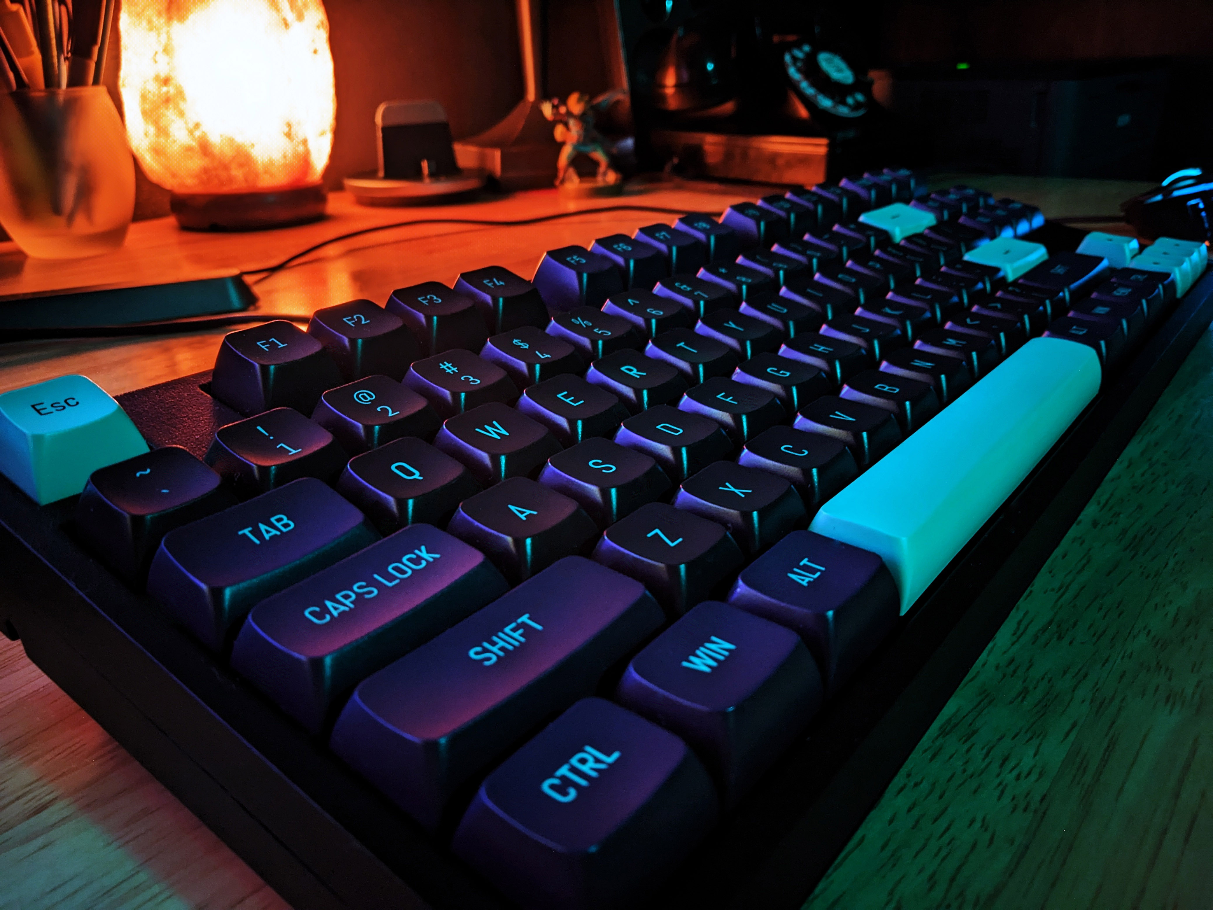

I'm really enjoying these PBT's I picked up. I really like the rounded bowl shaped type keycaps a bit more than the traditional shape now.

Sphericals have the look, for sure.
But I must be honest: I prefer typing on cylindricals. They have the feel, for me.

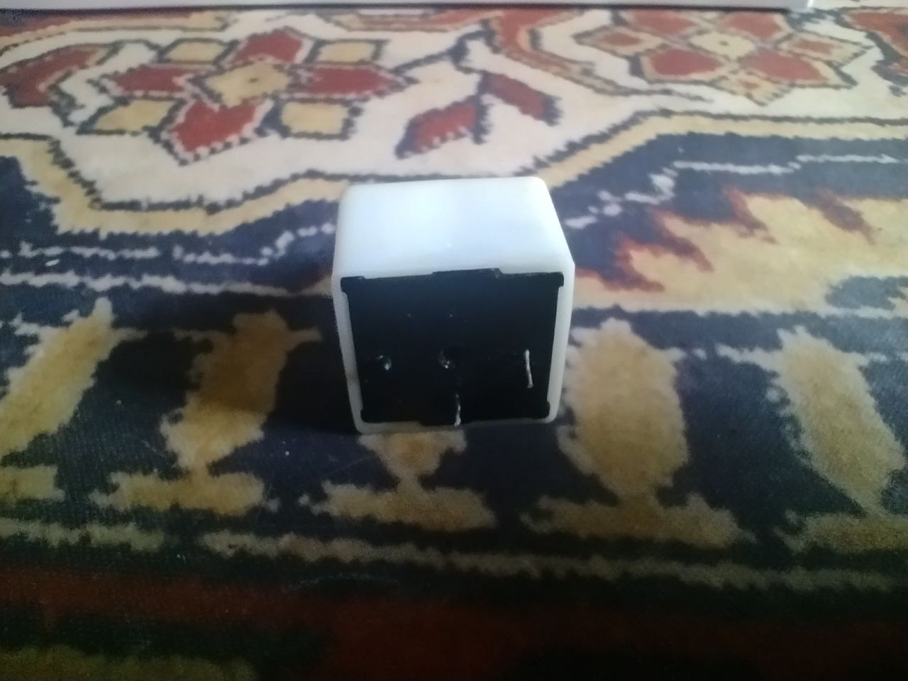

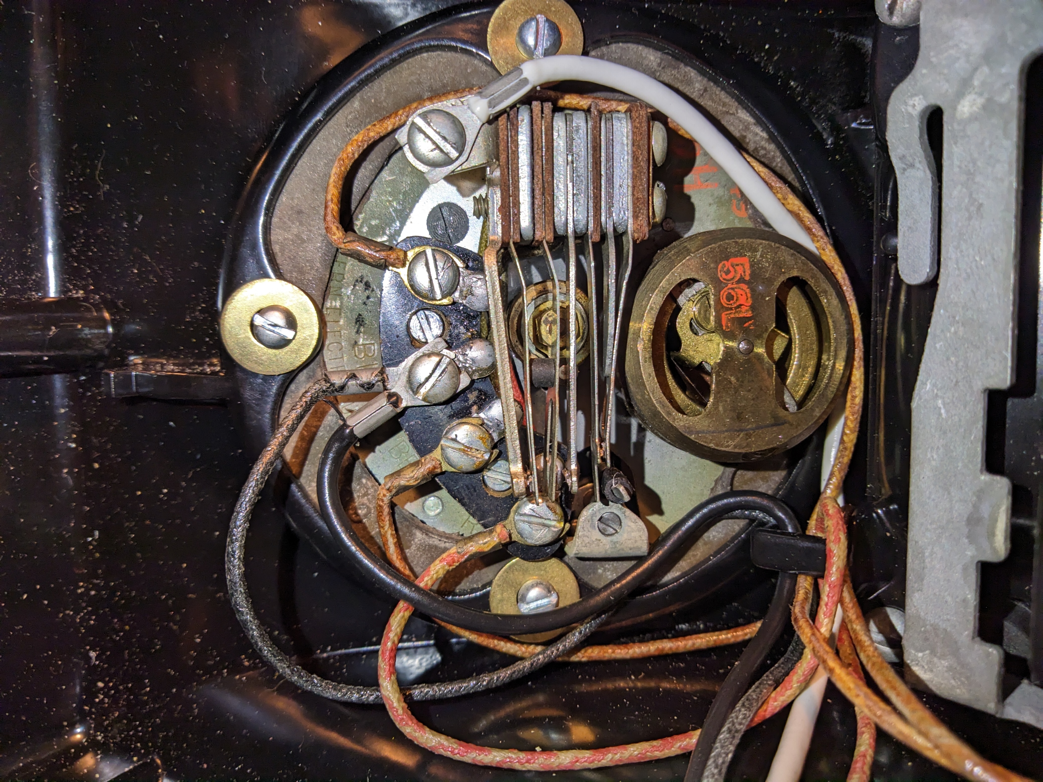

These kinds :P . One that mutes the headset entirely by shunting it when the dial is pulled back, and the other that flashes the hook switch off and on when returning.

They look almost linear. :lol:
Thanks for the picture. Love this kind of antique technical stuff. 8-)

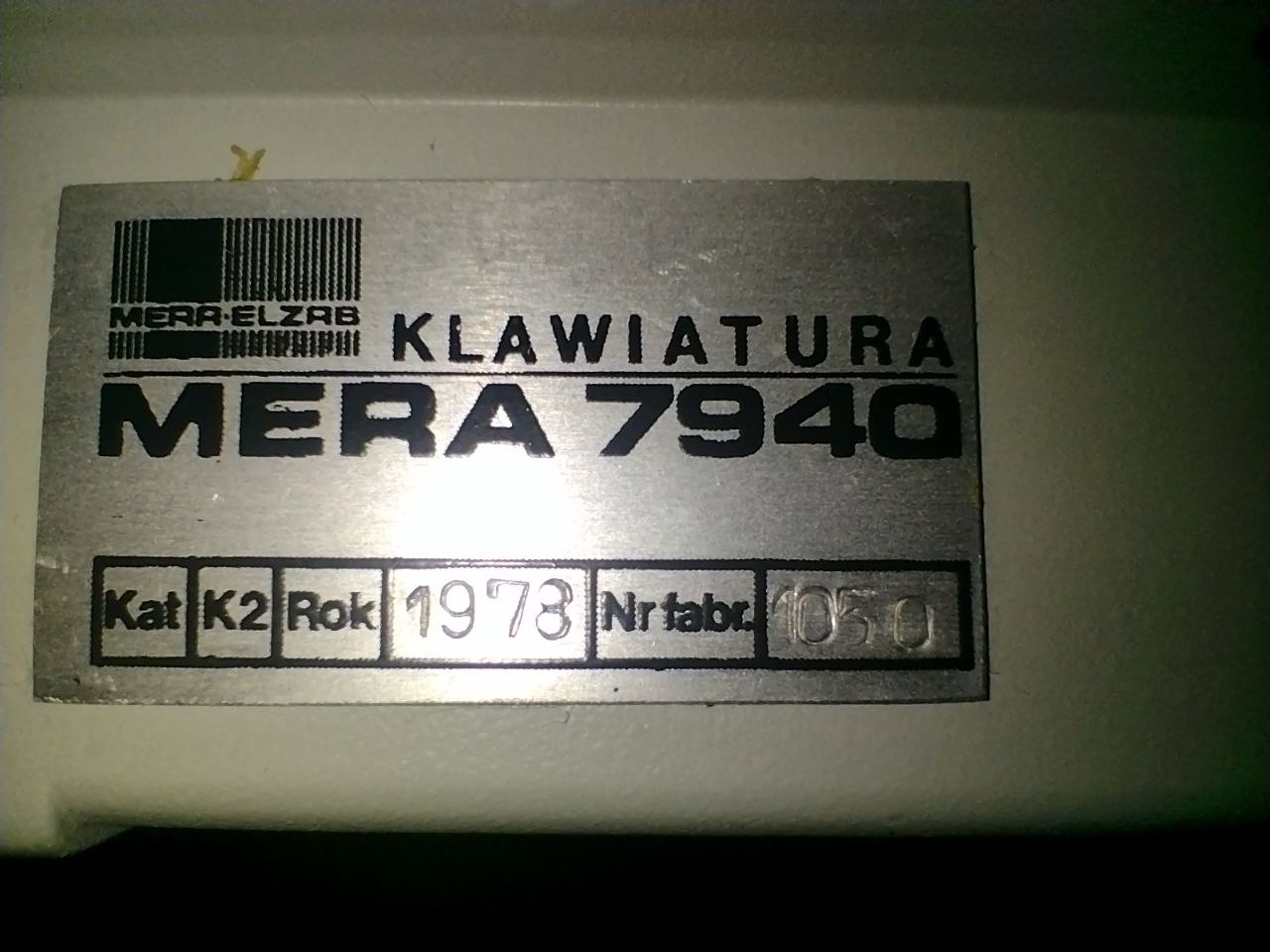

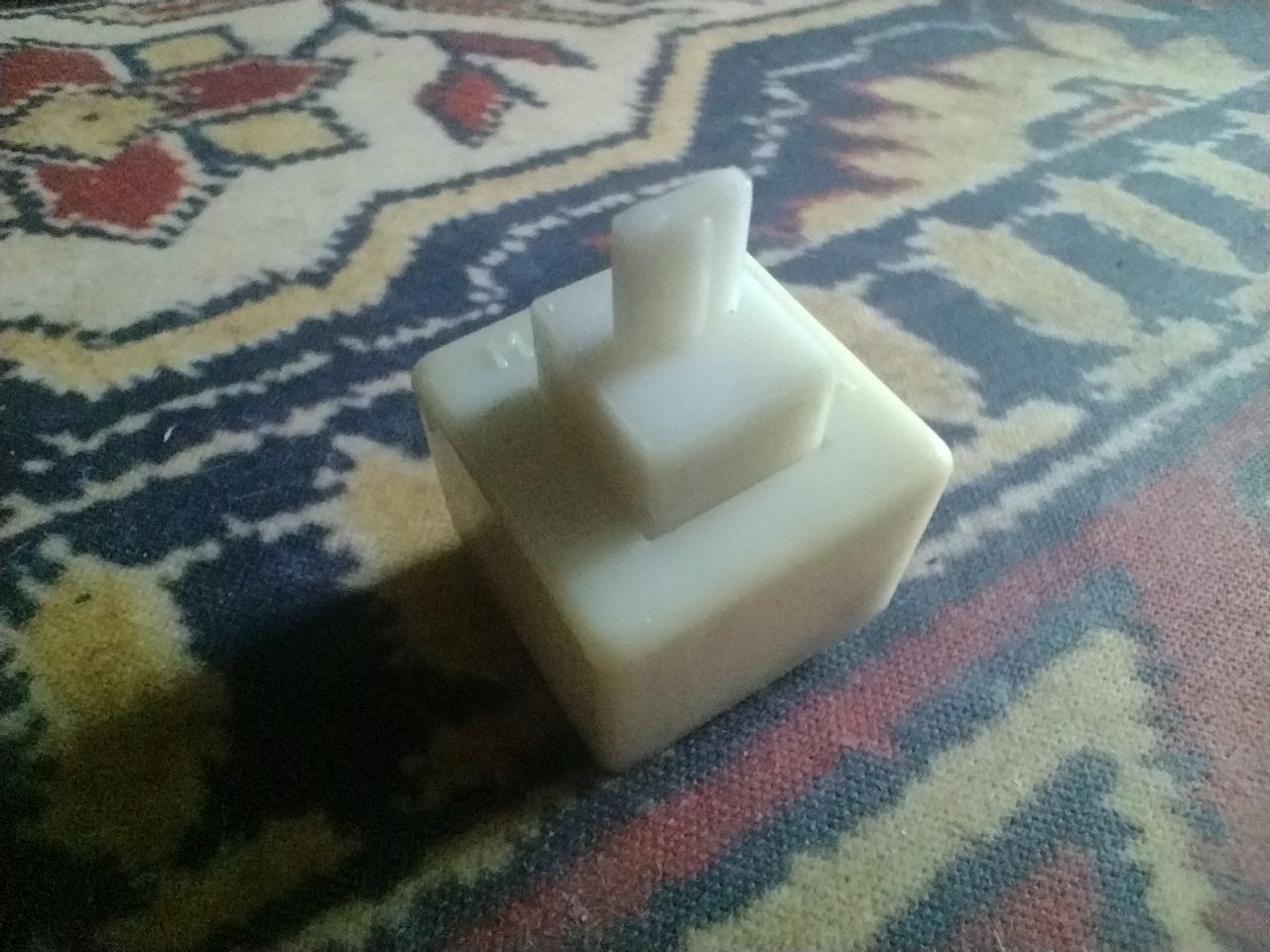

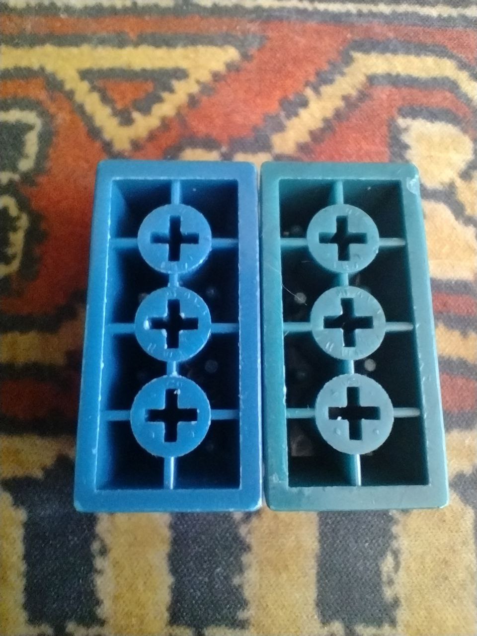

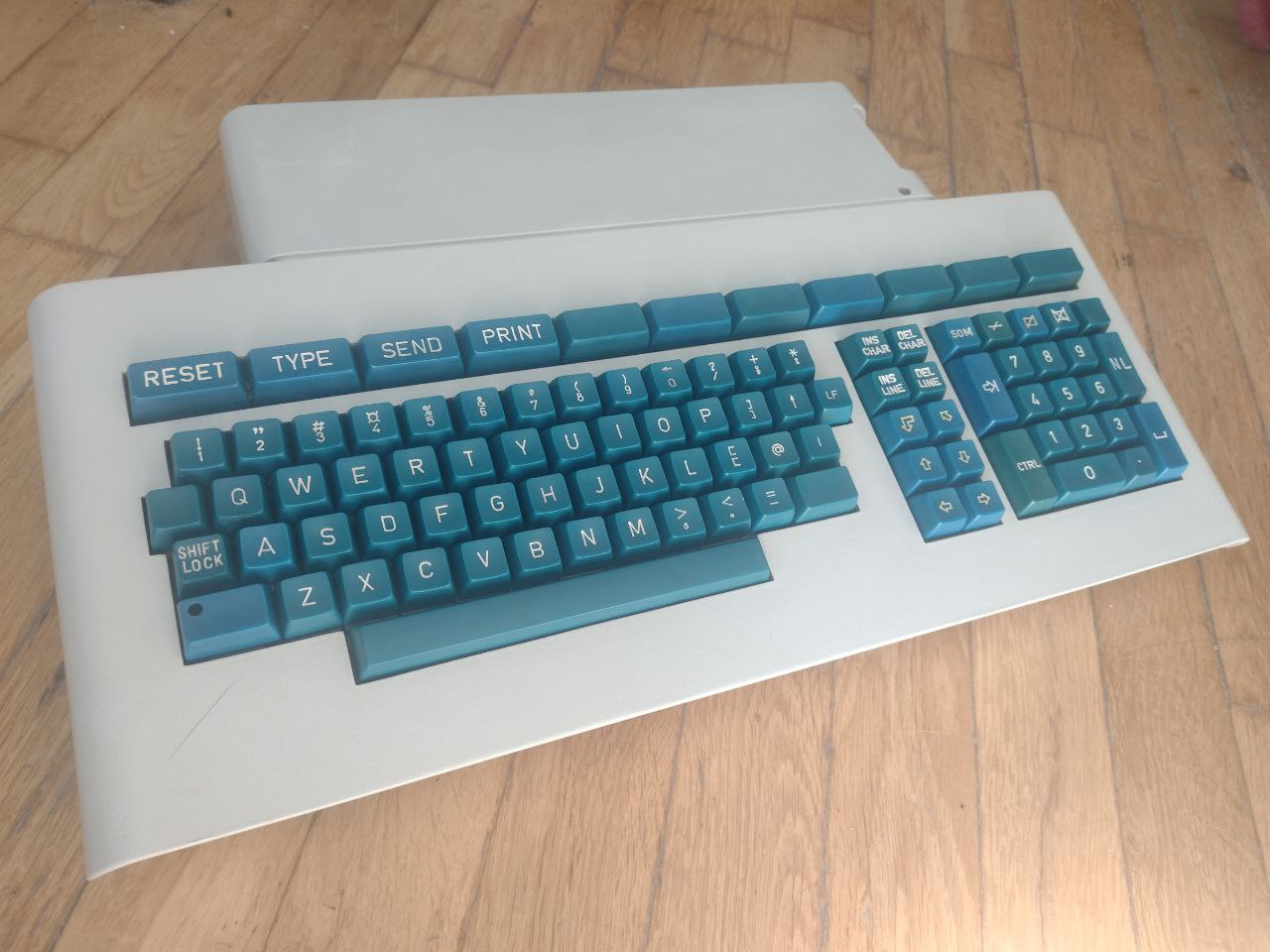

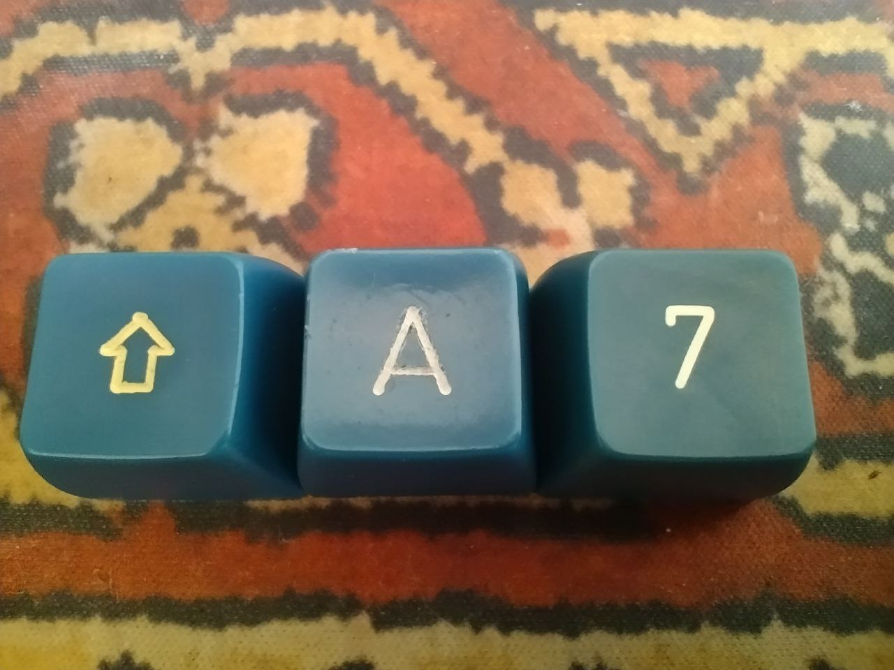

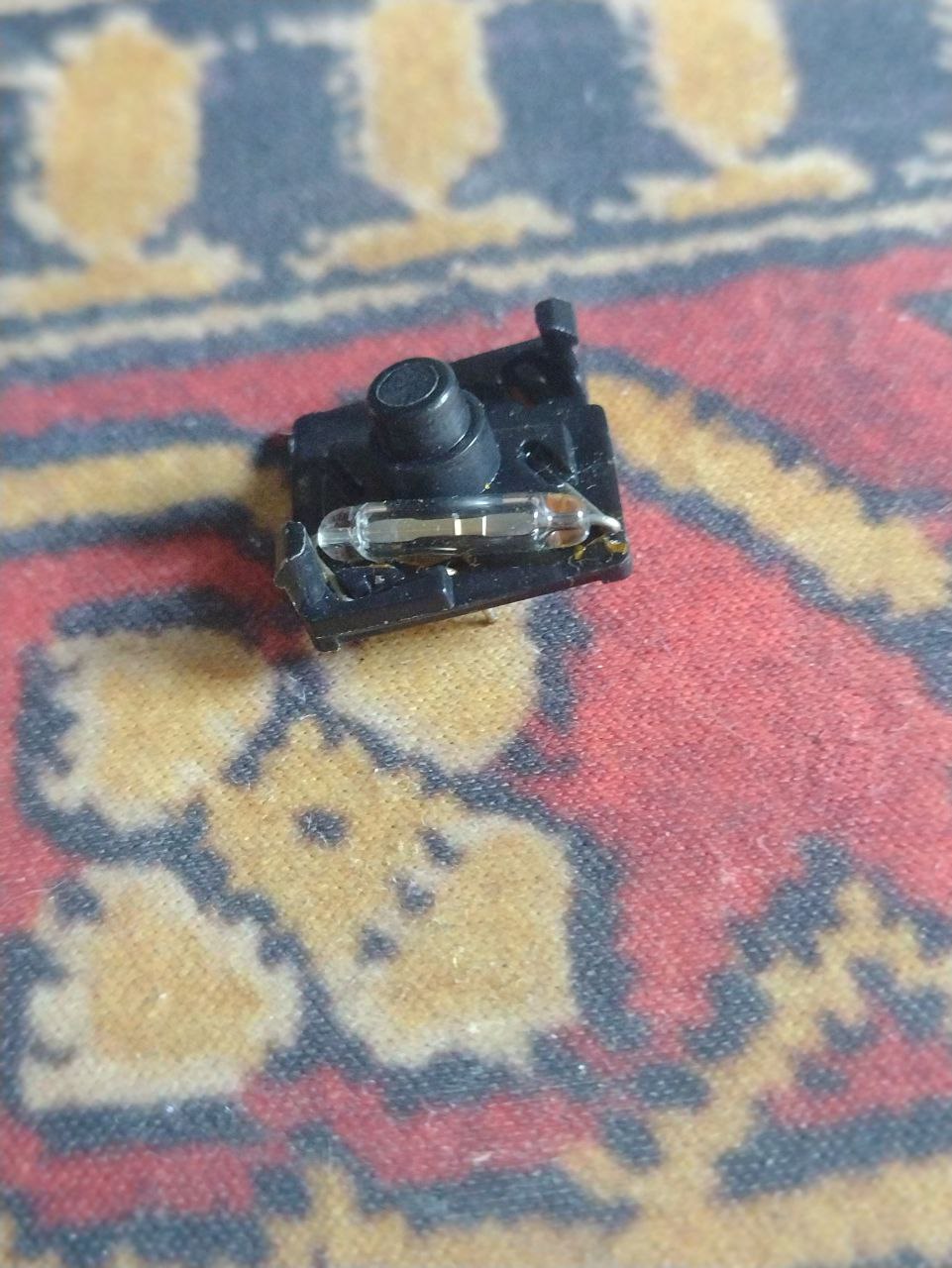

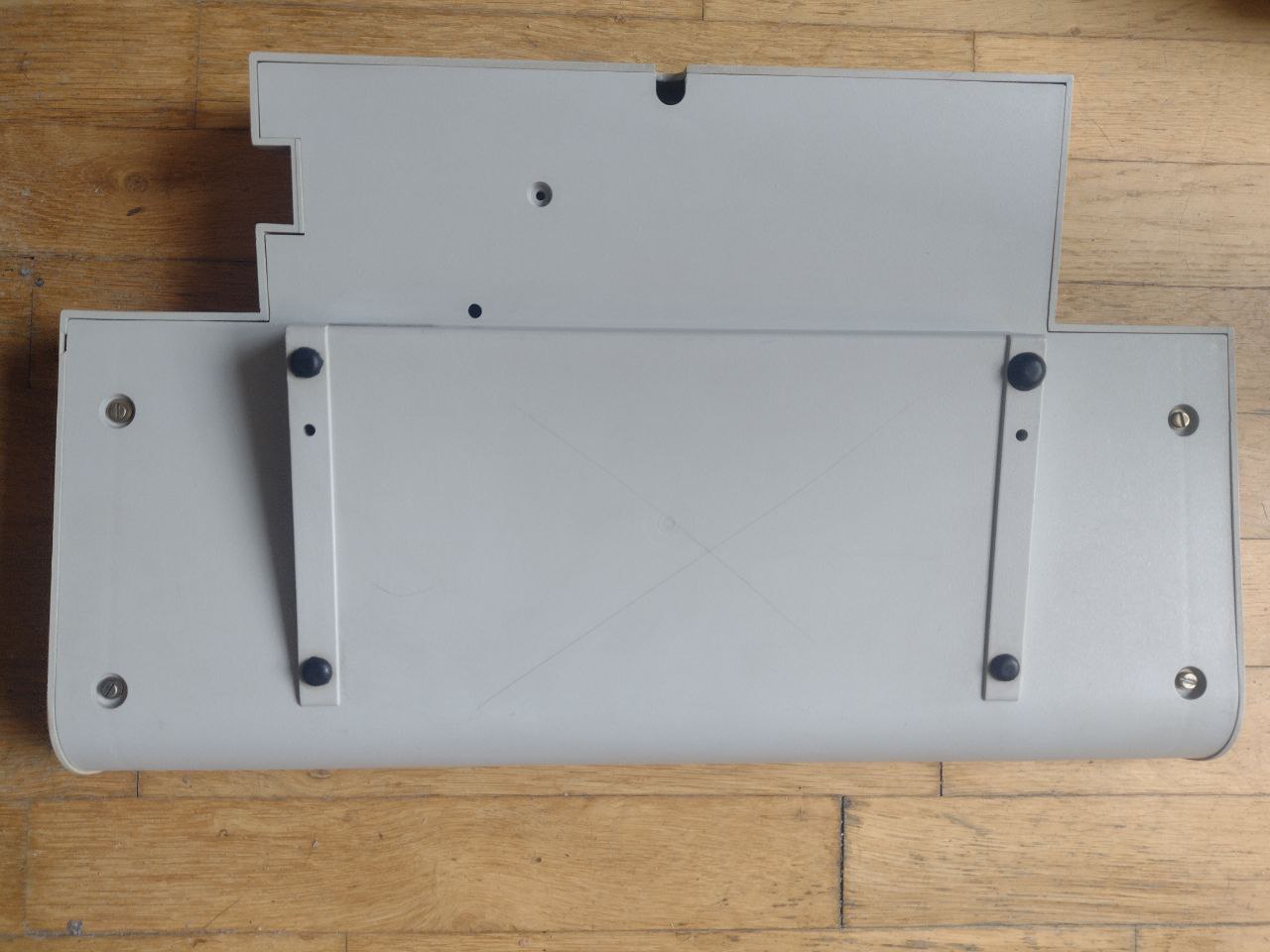

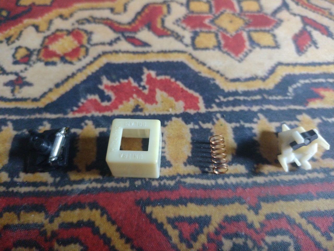

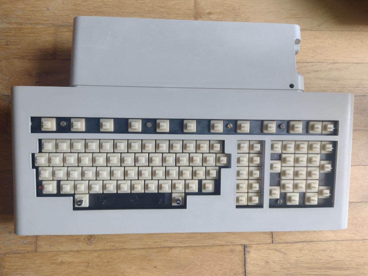

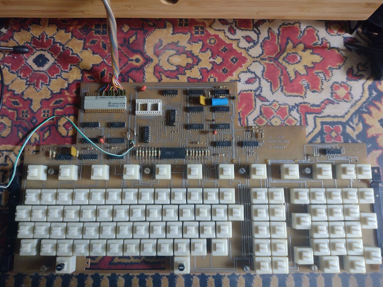

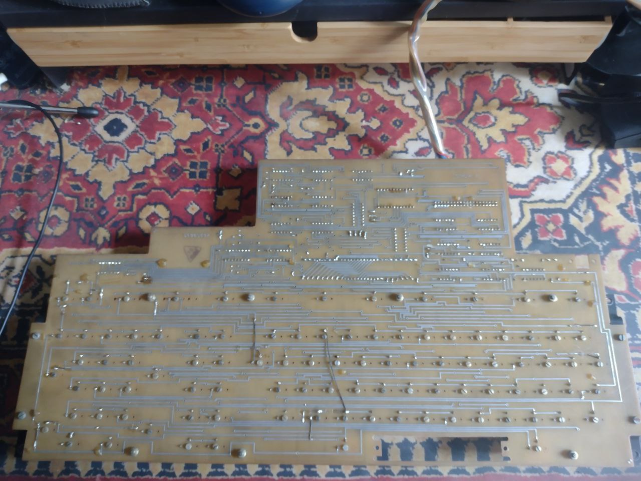

On todays east bloc exhibit we have the MERA ELZAB 7940, manufactured in 1978, in Zabrze, south west Poland:
The keycaps are 1970s thick double shot, im assuming ABS, however the manufacturing process leaves a lot to be desired, with some keycaps being perfectly smooth and sharp legends, while others arent properly filled at all. some legends are yellow, most are white, the choice seems pretty arbitrary, likewise with the shade of colour of the keycaps themselves, some are a deep blue, some are aquamarine:
The switches themselves are M-24-112 magnetic reed switches, manufactured by Unitra Dolam in Wrocław/Breslau, not much too them other than the enclosed housing, four rails which are ungodly bindy, the spring, the magnet and the reed switch itself:

The keycap colour is quite atractive.

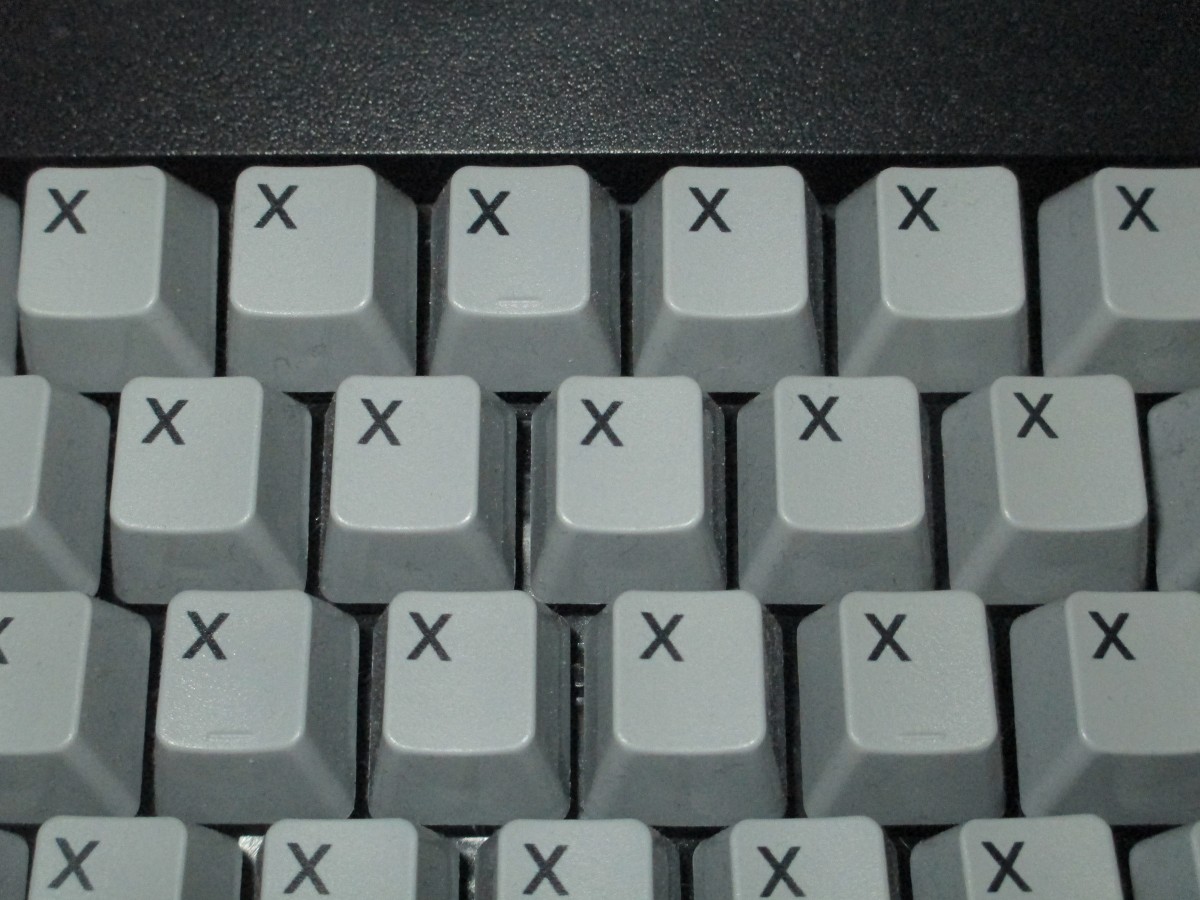

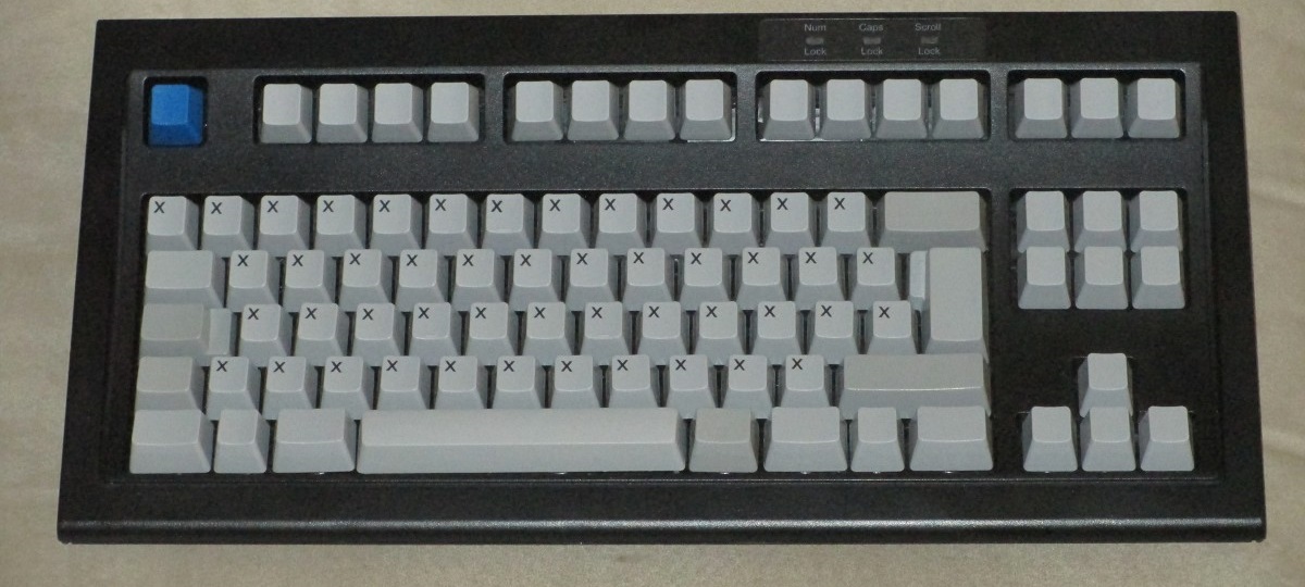

depletedvespene wrote: 10 Jun 2018, 15:11 Whenever I am trying out a new national layout or (or customizing one), this is the keyboard I test it out with:
The XXK is not alone anymore.
Unicomp Mini-X.
Unicomp Mini-X.
Indeed, this is a Unicomp Mini-M. I replaced the buttons with blanks and a large batch of X keys (all by Unicomp).
As is by now my standard practice, which I opine should become an actual standard for everyone, the 6 key in the number row has a HRI bar. On numpadless keyboards (TKL and smaller), this has proven to be very useful when inputting numbers.
Three HRI buttons.
Three HRI buttons.
Initially, I wanted all alphas to be gray and all mods to be blue. Sadly, Unicomp does not provide blue for all the non-1U buttons, so I went with only the Esc key (Fn, actually, as Esc is on the home row) to be the accent.

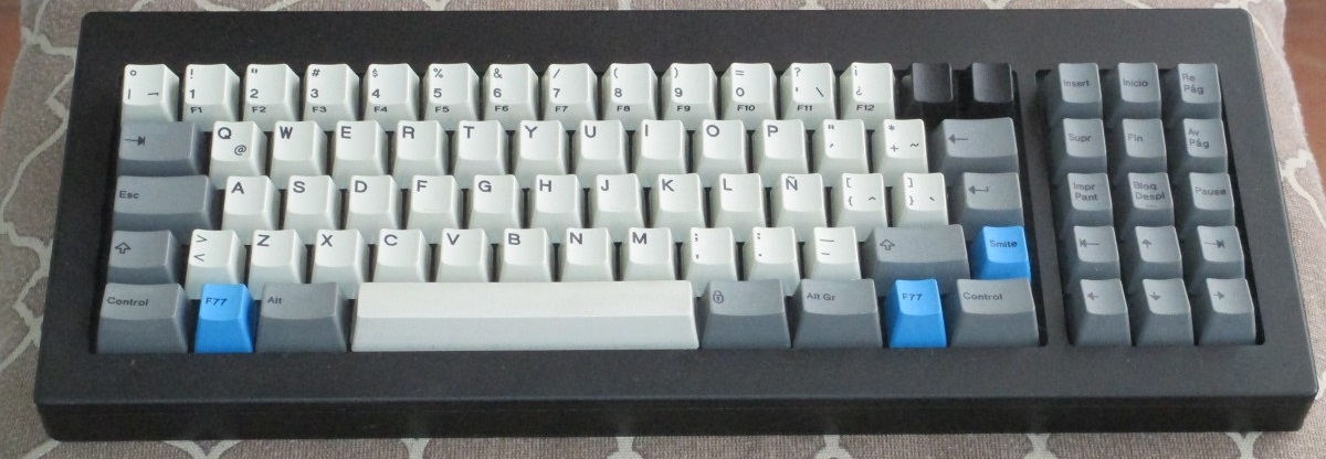

So I finally got off my lazy ass and replaced the blanks in my F77 with Ellipse's es-LA keycap sets. I mixed the cream alphas from one set with the dark gray modifiers (plus three blue ones, and two black unprinted keys for ${REASON}).
F77, esLA layout.
F77, esLA layout.
Looks great, but I would love to have gray alphas instead. This is good for now. ;)
Note the placement of the Esc key. The "Caps Lock vs. Ctrl on the home row" holy war is over, and both sides have lost. Esc on the home row is the way to go; vi forever.

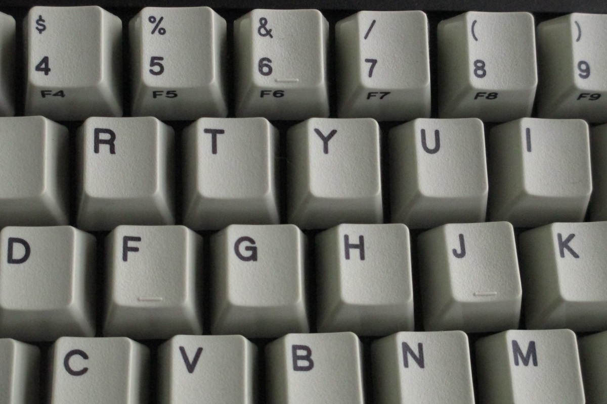

HRI keys: F, J, 6.
HRI keys: F, J, 6.
In keeping with my whi... practice, the F77 also has an HRI 6& key.

depletedvespene wrote: 25 Oct 2023, 16:31 So I finally got off my lazy ass and replaced the blanks in my F77
Aren't those blacks still blanks? Or are you paying homage to Topre's black on black legends? Even they aren't quite that invisible.
That's the cost of pulling Escape down from the number row, where it should be, just as Control must be left of A. I do agree with you on Backspace though. ;)
Re: Post your keyboard/keycaps!
Posted: 25 Oct 2023, 17:11
by depletedvespene
Muirium wrote: 25 Oct 2023, 17:00
Those two black keys are still blanks. I'm not using either key, as muscle memory is a b◉tch and that area can only be Backspace. For now, I am perfectly happy with a TIE Enter and an "HHKB-style" Backspace, but once Ellipse has started to produce ISO Enter keys I might do the unthinkable and open up the F77 to take out one flipper and put one stab in.
Far from being a cost, Esc on the home row actually SOLVES the problem of Esc and `~ (|°¬ in the pictured keyboard) clashing on a keyboard with no F row, which in turns avoids the problem of splitting or moving the Backspace key. As I said, the home row war is over and Esc is the winner. :mrgreen:
Posted: 25 Oct 2023, 17:26
by Muirium
Muscle memory can be a female canine indeed, though oddly enough I've never found all my frequent switching between backspace types—simply because of different keyboards—to cause me any problem. Most of my favourite keyboards have 1.5u backspace right of ], where I like it best, but the others all have it up where you usually find it, leaving \ or even our old friend ISO Return down there.
ISO's inexcusably shortened left Shift does throw me off from time to time, but Backspace never seems to be a problem. Might I perhaps suggest: make fewer errors? ;)
Kidding. I use Backspace plenty, as I so often edit things around when I’m (re)writing them. But honestly, it's a nice big key even at 1.5u and causes me no problem. I do highly recommend mapping Shift ⌫ Backspace to ⌦ Delete. If that's missing on a system, then I’m more likely to start cursing while mid-edit.
Posted: 25 Oct 2023, 17:33
by depletedvespene
Muirium wrote: 25 Oct 2023, 17:26 Kidding. I use Backspace plenty, as I so often edit things around when I’m (re)writing them. But honestly, it's a nice big key even at 1.5u and causes me no problem. I do highly recommend mapping Shift + Backspace to Delete. If that's missing on a system, then I’m more likely to start cursing while mid-edit.
No, no, no, no. Delete has to be its own key as well. Of course, if it were for me, the keys and would be on either side of the keyboard (on B00 and B14), and both 1.5U in size. Or, at least, 1.25U and 1.75U, respectively. Then you'd probably quiet down the complaints about "inexcusably shortened left Shift" keys as well.
Posted: 25 Oct 2023, 17:40
by depletedvespene
BTW...
Muirium wrote: 25 Oct 2023, 17:00 ... just as Control must be left of A.
¿And to the right of what, as well? All modifiers should be on either side of the keyboard... and if we follow the basic rule of symmetry of the modifiers placements, that means that RCTRL should be where {ANSI | the lower half of ISO} Enter is. Which would imply, as well, a return to the old R2 Return keys.
Replace "Caps" with "Ctrl" on the home row.
Posted: 25 Oct 2023, 18:08
by kbdfr
depletedvespene wrote: 25 Oct 2023, 17:40 […] All modifiers should be on either side of the keyboard […]
Unconditionally agree.
That is one of the reasons I love my programmable XXXL Tipro, which allows me to use e.g. Esc or Enter or the arrow keys with either hand..
