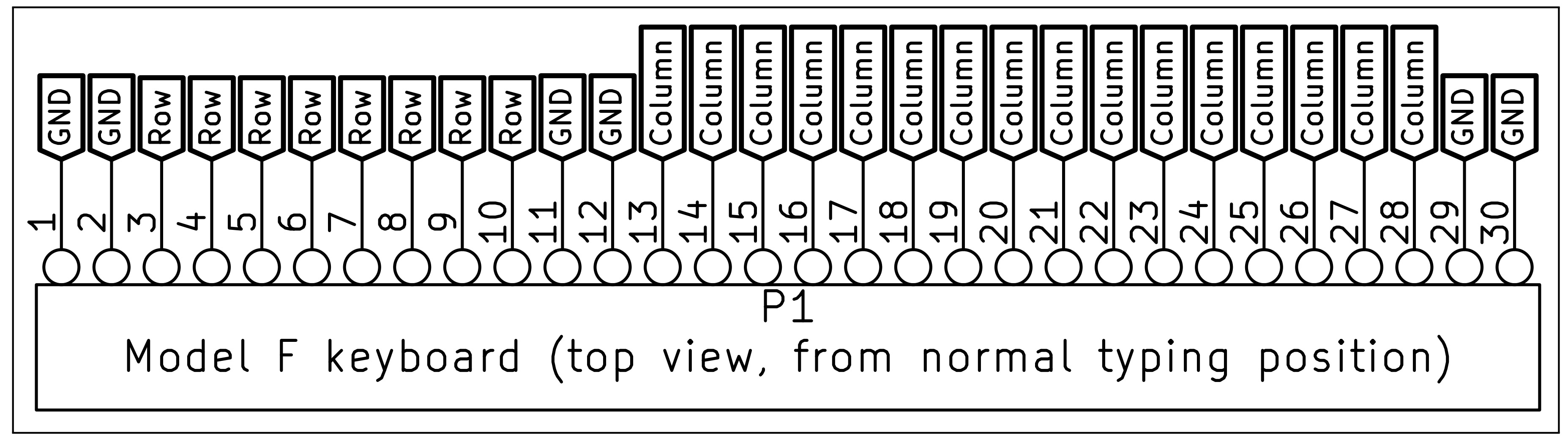

Here's a puzzler, I got my F62 today (woo!), it appears to have the QMK flashed, and right off the bat the column for 56tghb (and space) wasn't working.
The soldering was pretty rough; on the board side half the pins had no visible solder and on the controller side they had gobs of it, including a blob that was probably not bridging anything, but I cleared it anyway.
Reassemble, still nothing. Disassemble, all the keys work! Ok, so it probably wasn't the solder. Thinking it might be a short, I added some electrical tape to the lower case and there's obviously some clearance issues:
I trimmed the pins sticking out of the controller board, added another layer of electrical tape, and gave a gentle bend to the controller's mounting tabs to add a bit of clearance. If there ever was electrical contact before there definitely isn't any now yet still: tighten case, lose column. But if I loosen the case just enough, it works. At this point I'm out of ideas so I'm just running it loose.

@numist, can you post a picture of both ends of the soldering? Sometimes just a little bend / pressure can cause a column not to register if the soldering has a flaw. I had this with my self modified keyboards.

darkcruix wrote: 11 Sep 2020, 14:35 @numist, can you post a picture of both ends of the soldering? Sometimes just a little bend / pressure can cause a column not to register if the soldering has a flaw. I had this with my self modified keyboards.
I neglected to take any pictures of the solder job when it arrived, but here's how it looks now:

OK, your column 4 (when starting to count from 1) has an issue. Your Y - key should also have problems.
I don't see any obvious shorts or cuts. I don't think the pinout has changed compared to the original controller. Find below the column location (Pin 16 if I am not mistaken):

Also pin 12 from the left (GND) doesn’t look so hot.

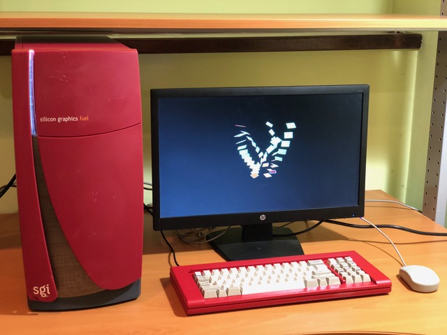

Dye sublimation update - the trial of the dye sublimation jig is set to be completed this week.
Second container shipment update - the factory is wrapping up the repairs and expects the shipment to go out before the end of October. In order to continue mailing out keyboards upon request, they will not be holding up the second container shipment for the dye sublimation to finish.
This is the first test of a full jig as opposed to previous tests of small jigs to work out how to achieve the tolerances, so it took a few weeks longer than previous test jigs.
I wanted to share (with permission) a great photo from a customer matching a True Red F77 with an SGI (Silicon Graphics) Fuel computer. A great setup!
SGI Fuel.jpg (93.99 KiB) Viewed 11844 times
Re: F62+F77 orders now open! New Kishsaver+Industrial Model F Keyboards
Posted: 23 Sep 2020, 03:00
by depletedvespene
Jaw, meet the floor.
Posted: 23 Sep 2020, 03:39
by Redmaus
That looks pretty dang clean!
