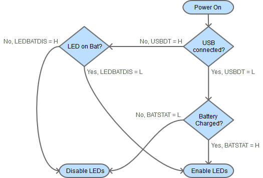

Posted: 22 Mar 2016, 14:12
by mohitgarg
Why do you have the slide switch? I'm still lost to it's purpose.
Here is what my current plan for the USB Charging looks like. By default, the device will charge the battery at 300mA (slow), and when on fast charge at 1A, like the example you provided, this would simply be done using a transistor to "enable" another resistor in parallel to increase the charge rate. I'm using MCP73833. No need for the complicated voltage reference and logic level shifting IMO.
Slightly related, here is the flowchart for automatically turning on the backlight and RGB LEDs once the charging is done and to toggle them when on battery. USBDT, LEDBATDIS, BATSTAT are all interrupts to the AT90USB1286, so a change in USB state, switch toggle and battery status will automatically trigger the MCU to check whether to enable the LEDs or not. LEDs disable means 0% duty on PWM for backlight and black color on RGB LEDs.

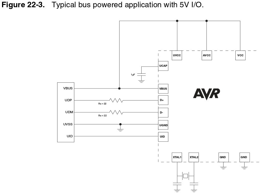

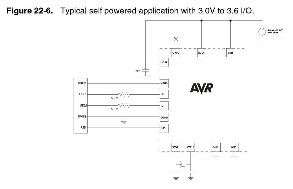

Posted: 30 Mar 2016, 10:30
by phosphorglow
@flabbergast
Yup, 1uF on UCap like the datasheet says, regardless of 3.3V or 5V operation. However, in 3.3V self-powered applications they say to also connect the externally regulated voltage to UCap. And to disconnect UVcc, but it works either way (for example the Teensy).
1286-self powered.jpeg (37.25 KiB) Viewed 7932 times
1286-bus powered.jpeg (41.53 KiB) Viewed 7932 times
As far as "flashing" I mean putting the controller into DFU mode and flashing a .hex to it.
I'm using stock Atmel DFU and fuse settings on a 1286.
At 3.3V operation as connected in the datasheet, I cannot flash a hex using a 16MHz XTAL. hasu tried the same thing on a USBKEY with a 1287 (also Atmel DFU) and got the same result. 8MHz XTAL at 3.3V flashes just fine though.

Posted: 30 Mar 2016, 11:19

Posted: 30 Mar 2016, 12:41
by phosphorglow
In the self powered example, UVCC is disconnected. It measures 3.25V.
When it's connected, it feeds that voltage to VBUS.
...which pulls my USB detection input high.
