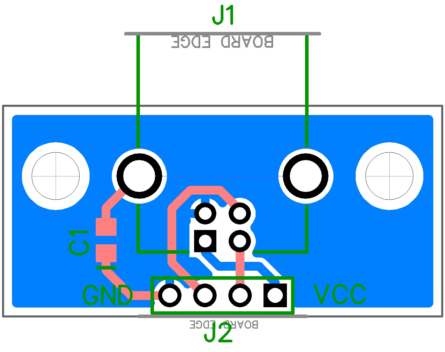

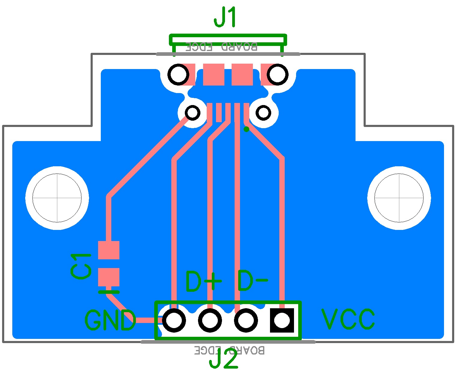

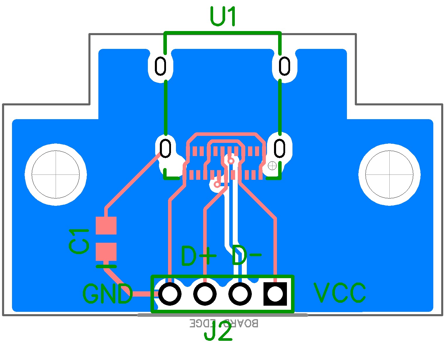

We were just about ready to start testing the mini xWhatsit, so his timing is perfect for the specific improvements to our project. Again, this all needs to be proven with testing and tweaks, but the general idea (
all WCass) is to have the connection between the PCB and the controller be a connector similar to that of the beamspring xWhatsit, but inverted so that the controller sits behind the curved plate. Net... the new mini xWhatsit would slip right onto the PCB.
Then a short header cable over to the USB connector board that would slip over the pegs of the Model M's lower shell at cable exit. He had the idea of offering various USB connector board options. Then if you would like to change to a different connector later, you would just need to swap out (no impact on the mini xWhatsit). The following is a render of the USB-C version of the connector board.
- Capture.PNG (72.27 KiB) Viewed 7521 times
My meager contribution would be to make a retainer/cover modeled after the retainer clip that Techno sent me from a terminal M. The clip would be connector specific (potentially a single core component with the ability to adapt... chewing on), that would cradle the USB female connector itself on all sides, cover the exit hole, and help hold the board steady. The following is the picture of the original clip to get an idea.

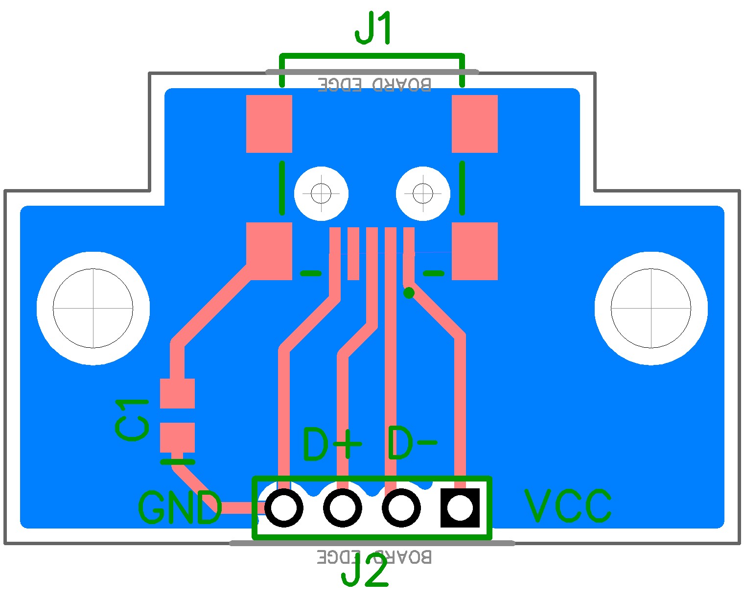

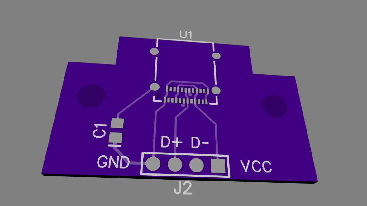

I have ordered the following four USB connector boards for testing from OshPark:
There are several advantages to this component driven approach. Below are some links and images to help visualize the concept.
- Example of PCB to controller connector
- USB-C connector PCB (alternative design has round holes)
- C.jpg (169.02 KiB) Viewed 7449 times
- USB-B connector PCB
- B.jpg (172.19 KiB) Viewed 7449 times
- USB-Micro connector PCB
- micro.jpg (171.6 KiB) Viewed 7449 times
- USB-Mini connector PCB
- mini.jpg (162.73 KiB) Viewed 7449 times

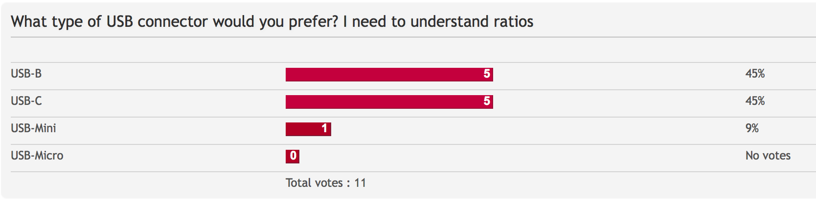

Sorry for another poll, but braided USB-B cables are not going to be realistic (the others will be). I need to get an idea of ratios here so that I can pick up what we are projected to need from Cindy's contact while the USB-B cables are as cheap as they are (he has a limited supply that won't be replenished). Please vote, and sooner rather than later to give me an idea
Posted: 02 Aug 2016, 15:57
by fohat
My preference would be a standard large USB-B cable at least 2 meters (6 feet) long, NON-COILED!, matching case color or slightly darker, if possible. Braided is generally irrelevant but might be cool.
Posted: 02 Aug 2016, 16:53
by andrewjoy
My preference is for type C but anything thats not mini or micro is good for me
Posted: 02 Aug 2016, 18:40
by giokkk
Standard large USB-B cable in a dark color.
Posted: 02 Aug 2016, 22:59

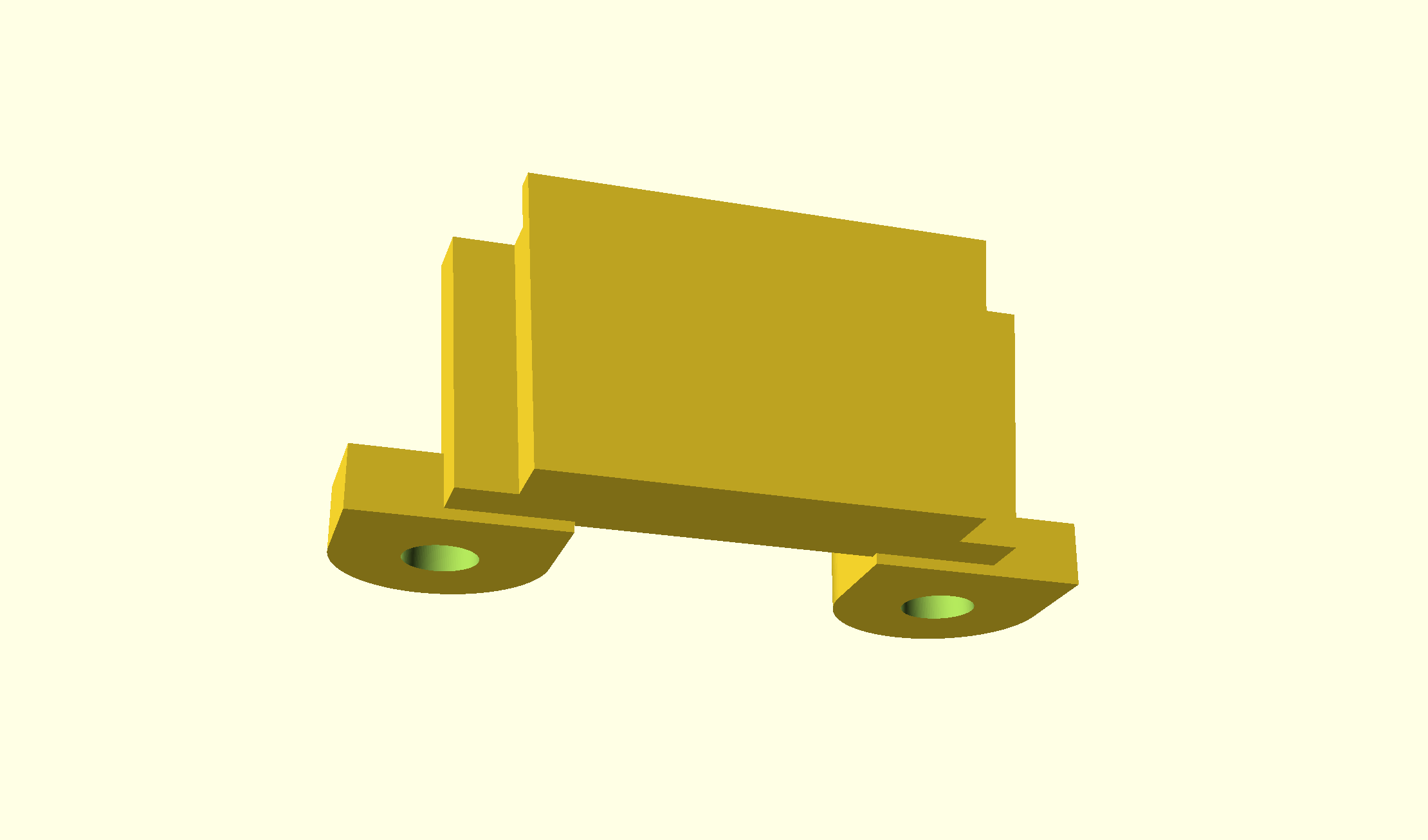

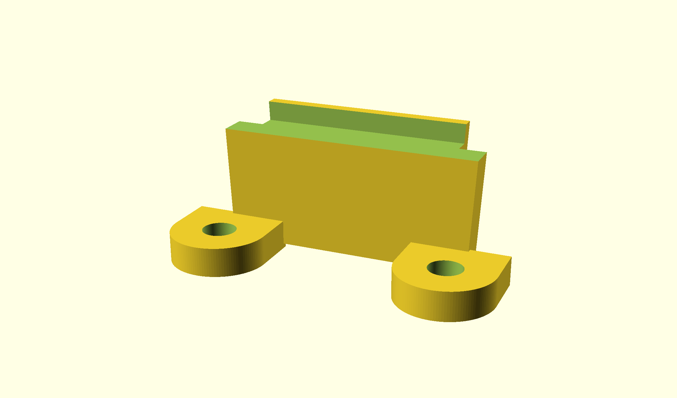

And we have a retainer clip... it's not too much to look at, but would be an identical copy of the one Techno Trousers sent me (image a few posts back). We still need to add housings for the USB female ports, but the gist. Once we add the female USB's, we will build a frame around the 4 back sides (controller itself being the 5th) to help secure the port itself.
- Front
- Model MF Retainer Clip Front.png (18.08 KiB) Viewed 7395 times
- Back with retainer clips for Model M case controller pegs
- Model MF Retainer Clip Back.png (23.49 KiB) Viewed 7395 times
Including the OpenSCAD code if it is interesting to some. Gives a sneak peak what all this about. Eventually once it is ready for group buy, all (a LOT) will be released. Keep in mind this is all one big eco-system of code, and will likely take a while to fully digest. If there are ever questions, I would be happy to translate (I don't do comments
). All numbers are in mm.

lot_lizard wrote:And we have a retainer clip... it's not too much to look at, but would be an identical copy of the one Techno Trousers sent me (image a few posts back).
Nice! Sometimes I have trouble visualizing everything together. So, in my mind's eye... Your description of the planned controller mount said it would slip into a slot on the back of the back plate, and there would be a cable to the little daughter card that is port-specific. It also said the daughter card will make use of the case controller pegs. Will the port blanks also be able to make use of those pegs (if the daughter card PCB is thin enough), or are you planning that the port blanks will not have peg holes at all, and be held in place by tension top and bottom from the sandwiching action of the case and abutting the port mounting point on the daughter card?
Edit: actually, after rereading I see you mentioned port-specific framing at the back of the blanks. So that should make the port blank sit nice and snug around each type of port for a professional fit and appearance. Awesome!
Posted: 02 Aug 2016, 23:49
by lot_lizard
Techno Trousers wrote: Edit: actually, after rereading I see you mentioned port-specific framing at the back of the blanks. So that should make the port blank sit nice and snug around each type of port for a professional fit and appearance. Awesome!
Exactly... this is just a blank for now until we get each of the USB controllers in. As you say, these controllers will be a daughter board to the mini-xWhatsit. So the mini-xWhatsit will be universal and fit directly onto the PCB using the integrated connection (like the xWhatsit Beamspring). Then a simple header cable runs from the xWhatsit to the USB daughter board. We will have 4 USB daughter board options (USB B,C,Mini,Micro), and there will be a unique retainer clip to fit each female USB adapter perfectly. Once we get all the daughter boards created, we will modify this blank I previously posted to securely hold each one. I have a feeling the mini/micro's won't be desirable, but I will mock-up the .STL files anyway in case someone would like to have later.

Regarding USB connectors, I have no overwhelming preference. Most of the keyboards in my active rotation are mini-USB, and so I keep a mini-USB cable connected to my hub for easy exchange of keyboards.
On the other hand, when I installed Soarer's converter in my XT, I went with a USB-B connector, which seemed better suited to the scale of the XT than a mini or micro connector.
My understanding is that the new standard is USB-C, so going this route would "future proof" the new FSSK.
Nice to know there will be a choice among the 4 connector types. I will try to make up my mind before the GB begins!
Posted: 03 Aug 2016, 00:05
by drevyek
For me, the biggest concern is durability. B and C will have available connectors for years, so finding replacement cables won't be a problem, but resoldering the connectors will be. I'm not sure the durability or shock-resistance of B vs C, but whichever one lets the board take the most abuse is the one I would vote for.
I'm not really talking about # of insertions though. I'm much more worried about someone (aka, not me) yanking at the cord, or stepping on it, or _____. Insertions isn't a problem: 5k insertions vs 10k isn't important if you only swap cables once per month.
Posted: 03 Aug 2016, 00:21
by lot_lizard
drevyek wrote: B and C will have available connectors for years, so finding replacement cables won't be a problem, but resoldering the connectors will be.
Just to be more clear... at the time of group buy, we will offer all 4 USB connection types. I am just taking a poll now so I can understand the ratio of USB-B to every thing that we will need so I can pre-buy all of the cables (non-braided) from Cindy's contact since the price is so cheap. The C/mini/micro types would be braided cables purchased later. Again... all will be available options.

Thanks for voting... I have what I need to capture the USB-B order count with Cindy's contact.

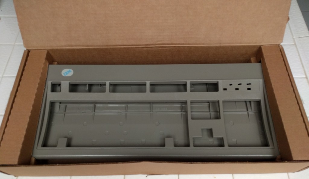

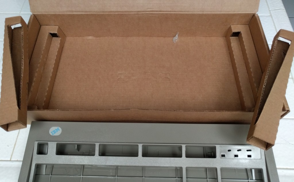

Okay, here's an idea about storage boxes now that the connector issues are answered (I think the vast majority of us who are upgrading bare M and SSK keyboards don't have the original IBM boxes). This may be outside the scope of the project, which I'd totally understand.
Looking at my individually shipped industrial case, I saw that the packaging would make a great long-term storage box for that particular FEXT once I have built it (see pictures below). It's nowhere near the luxury of the custom box and inner foam that ellipse is creating for his project, but it would meet my needs, and perhaps be more environmentally friendly without Styrofoam inside. I was thinking about taking apart and reverse engineering the box and standoffs to manually cut and glue together my own new boxes out of extra heavy duty cardboard or other material (FEXT and FSSK sized). But if it's an option to have something like that done by professionals, that might be even better.
What do you think, lizard? Have you given storage any thought?
- box1.jpg (98.44 KiB) Viewed 7241 times
- box2.jpg (129.94 KiB) Viewed 7241 times

Techno Trousers wrote: Have you given storage any thought?
Minimal amounts at best. I planned on shipping the PCB shipped between the top and bottom plate since the radial bend would be identical. For the few that grabbed an industrial case as part of the tiny group buy, we would put the whole assembly in there... but that is the extent.
It is an appropriate time to consider this though. We are probably within a month before the group buy (eventual marketplace thread) will start. I am assuming half the orders will be overseas (wild a$$ guess), and will be shipped as 1-2 pallets of pre-packaged boxes. The smaller the better (while still being secure). We have the luxury of shipping steel plates with the delicate parts sandwiched (almost everyone will need both plates and the PCB).
Because we will be taking a different approach than Ellipse and having a Euro proxy, we can get away with more minimal packaging to achieve the same end result. I will start checking around (must confess... cardboard boxes are something I know little about)
Posted: 03 Aug 2016, 23:16
by E TwentyNine
I think you can probably use the USPS game boxes and some spare cardboard (like another game box) to achieve the same result as that case box. Such a simple approach.
Posted: 03 Aug 2016, 23:43
by Techno Trousers
E TwentyNine wrote: I think you can probably use the USPS game boxes and some spare cardboard (like another game box) to achieve the same result as that case box. Such a simple approach.
Yeah, it'll definitely be pretty simple to cut these parts myself. One nice thing about the Unicomp box is that it's a "presentation" style box, so when the top swings down there are tabs that go into slots in the front of the box to close and secure it. It's much nicer to get things in and out of than the USPS game boxes are.
Posted: 04 Aug 2016, 00:03
by pyrelink
Maybe its just what I have ordered but Unicomps boxes and packaging is always pretty great. I think I have kept and repurposed every box they have sent me. I am not a huge fan of gameboxes for shipping heavy keyboards, but they might work in this case. Don't want to go crazy (cost wise) on shipping materials, but something reusable for storage would be nice.
But the chance of me removing my FSSK from my desk is quite low so storage might not be needed,
