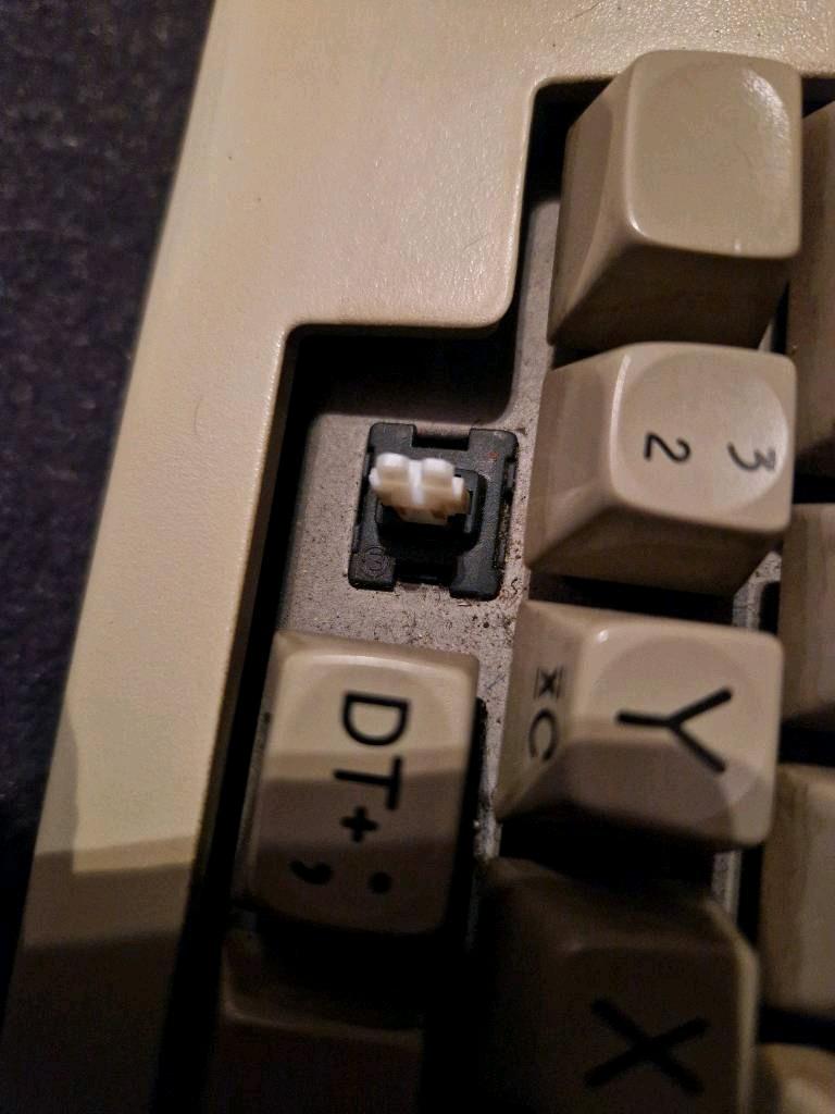

Any ideas on what this is?
Here's a similar keyboard, but it seems to have the mounts broken off.
The keyboard also seems to have the exact same layout as this other post here (But with different switches)
EibeAxxt wrote: 19 Dec 2021, 18:48 I got this retro pc from a flea market (2$) called "GALAKSIJA" - which means galaxy. The keyboard that i have is a commercial use, that was used in schools, etc. The problem is i don't know what switch this is. Someone told me it's a Cherry m7, but i really can't tell if it's a clone or not. What do you think? Thank you!Image
Any help is appreciated.
Re: IDENTIFY THE KEYSWITCH thread
Posted: 17 Oct 2022, 02:42
by hellothere
I don't think Cherry M7 or M9. Those have "Cherry" on the upper housing and the switches in the keyboard(s) above don't. Looks close to Mitsumi Standard Mechanical.
Posted: 17 Oct 2022, 06:59
by John Doe
Siemens ST switch.
wiki/Siemens_ST

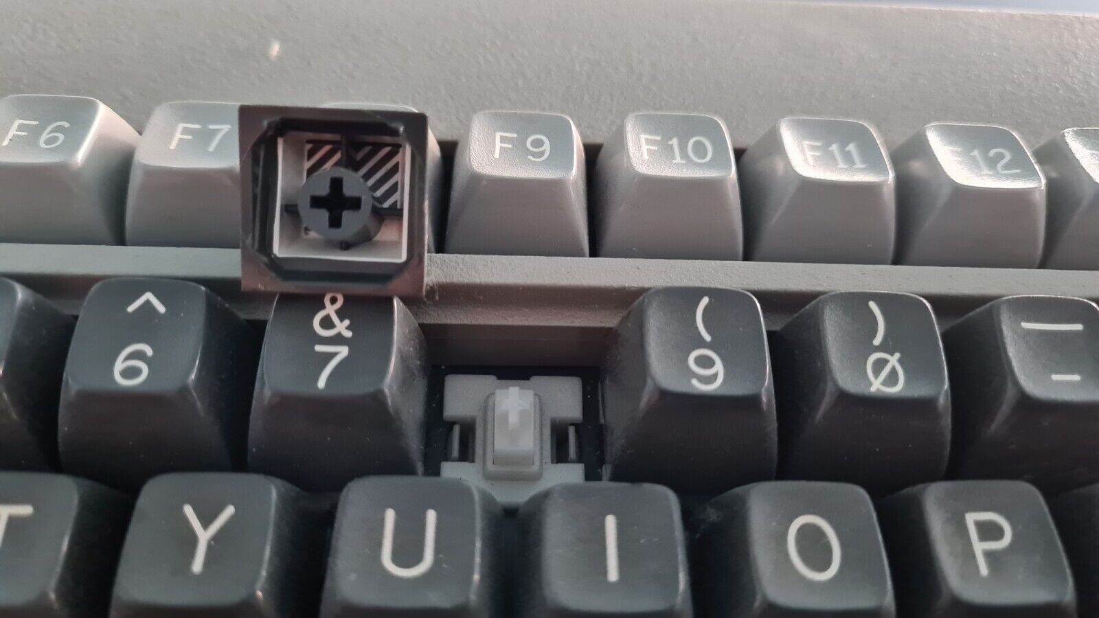

Found in an Olympia Standard 200 Typewriter.
wiki/Marquardt_Butterfly ?? :?:

guidemetothelight wrote: 08 Nov 2022, 13:36 index.jpg
Looks like it. It's got that "M in a circle" mark on it, too.
Posted: 09 Nov 2022, 10:00
by guidemetothelight
hellothere wrote: 09 Nov 2022, 03:03 Looks like it. It's got that "M in a circle" mark on it, too.
The user Inozenz actually knew the correct one:
wiki/Marquardt_Two_Fingers_Typewriter_switch

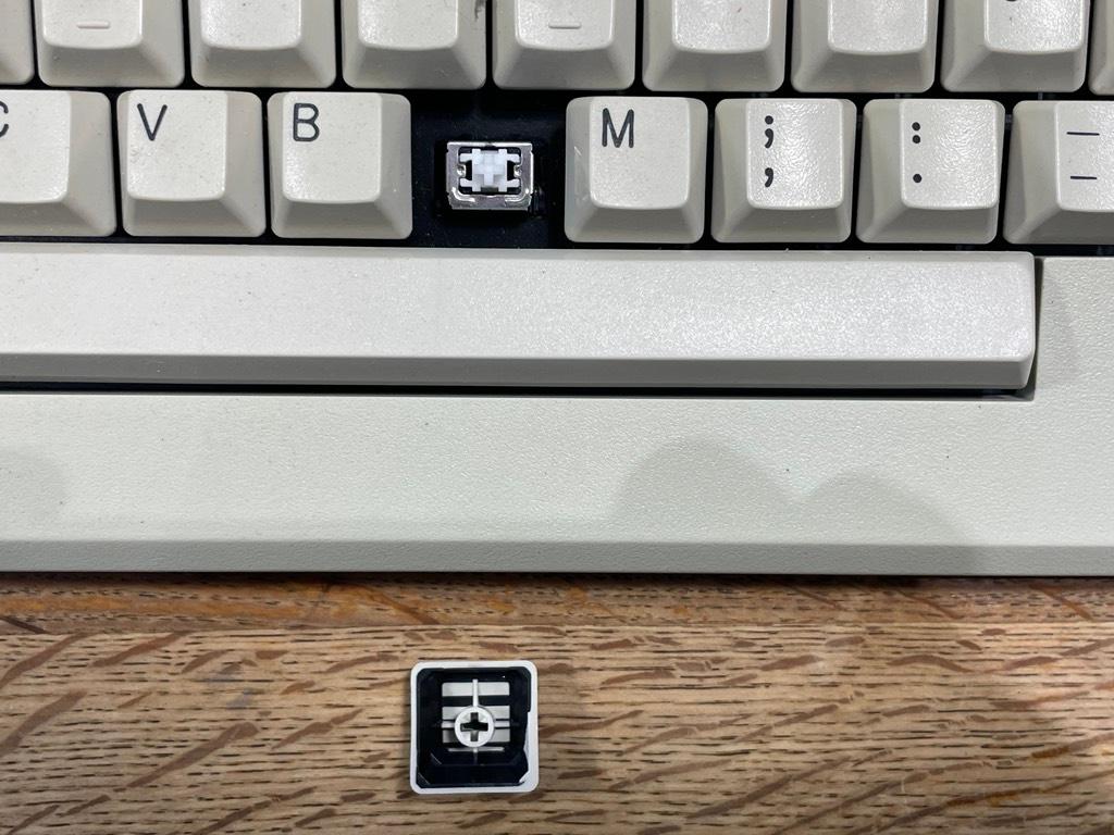

Somebody can identify them ? :)
Posted: 19 Nov 2022, 12:06
by John Doe
guidemetothelight wrote: 19 Nov 2022, 12:02 switches.jpg
wiki/Mitsumi_miniature_mechanical

John Doe wrote: 19 Nov 2022, 12:06
If you want to get one of these keyboards, check the forum. There are older reviews saying that they're not that great of switches, but if you use some sort of (spray?) lube, they turn into "not bad" switches.
Don't confuse them with Mitsumi Standard Mechanical switches, which were most commonly found on Apple Extended Keyboard IIs. I've also got a typewriter with them.
