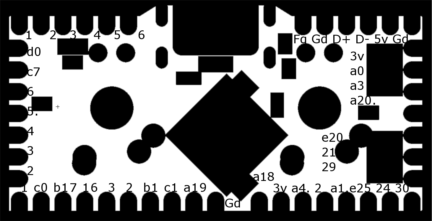

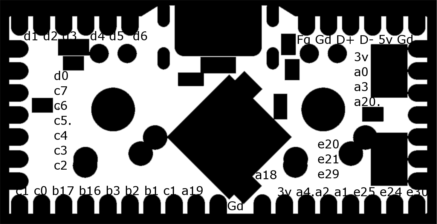

Can we use a smaller font for the silk screen and avoid to use PT to describe the pins name?
Posted: 15 Dec 2016, 16:17
by pomk
We can't really go smaller with the font, maybe by 25% but that is not enough. In any case there are components in the way to make it even more difficult. An X to state that this pin should not be used and a paper card or something describing the pin functions to go with the board should be fine I guess.
Posted: 15 Dec 2016, 16:26
by tentator
Maybe using callout lines towards less busy areas? Also would have been nice if we could have pins also for the 2x2 puns of the two switches also on the perimeter but seems the real estate is insufficient unless we make it bigger (three switches maybe?)
Posted: 15 Dec 2016, 16:40
by pomk

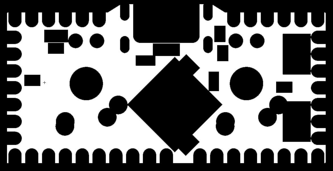

It really is impossible to fit even just pin numbers on the component side even with callout lines and smallest possible font. I can make a png showing the real estate so you can play with it to see for yourself. I don't want to grow this to three switches, as I don't see the point of it. You can easily connect the switches to the board edges with some spare metal from a diode leg or something.
Here it is: don't use a font smaller than 40pt, as that is approximately what we can manage.
Posted: 16 Dec 2016, 00:39
by tentator
uh 40pt?
maybe with 32pt I could have a chance but 40 no way you where right.. sorry.. even putting the X can be challenging as you can see below.. :)
but if you tell me where to put the x I can do that :) or you do not want them in png? I was using now inkscape anyway.

Posted: 16 Dec 2016, 09:00
by pomk
I can add the X's myself, don't worry about it. You have to remember that this is a very small board even if the picture does not seem like it (height of 18mm). :)
You can still try with 32, maybe it'll still be printable.
Posted: 17 Dec 2016, 01:11
by tentator
ok I managed to do something with 32pt.. surely very ugly but maybe still one would like to have it instead of nothing and needing to look on the screen/paper? (or maybe not?? :))
But maybe it's not clear to me what dpi and resolution I should use for that image (I see raster pixels) and what is actually the dpi resolution of the printer of the silkscreen to better adapt to it...

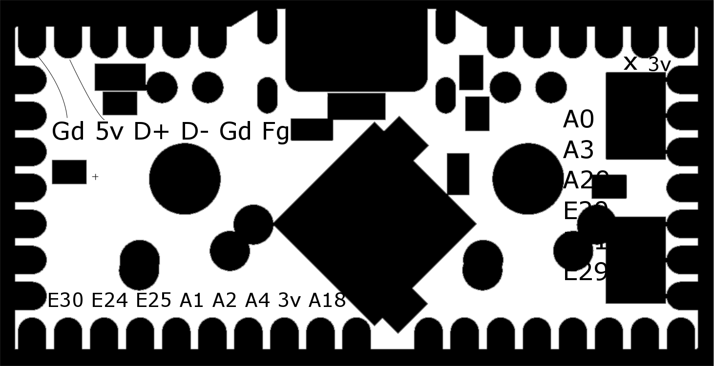

by matt3o
I don't think we need to repeat all the letters and label 100% of the pads. I mean in the picture made by tentator we can remove for example "D3", of course that pad is D3.
I mean something like this:

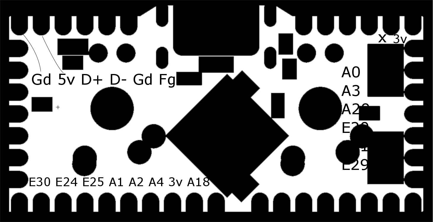

by pomk

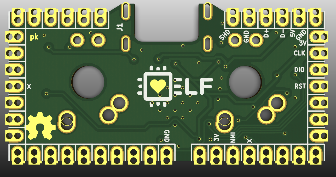

I'm not sure if they all are in a neat order like that, and there is no room for re-routing the order. I think that a running numbering, with X for pins that you should think about before using, and a card that has a picture of the board and the pin functions written out. I'll edit a picture here of an example.
edit: for example the mbed development boards come with a card with the following picture on them:
Posted: 17 Dec 2016, 11:46
by matt3o
pomk wrote: I think that a running numbering, with X for pins that you should think about before using, and a card that has a picture of the board and the pin functions written out. I'll edit a picture here of an example.
that is totally fine for me

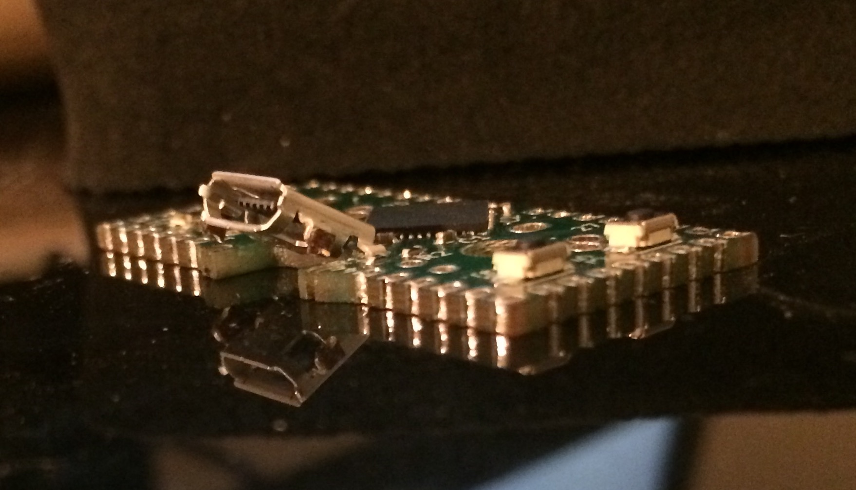

Finally had the time to finalize things on the PCB side. From my torture testing I can conclude that:
1. The PCB quality is not the best, as the USB connectors plated slots rip out before the USB plug breaks. This did require some force, but optimally the cable should break before the connector.
2. The chip does not fry when the regulator output is shorted to ground. Instead the chip does not start at all, but continues to work properly after the short is removed.
Point 1 is hard to fix without changing the manufacturer/PCB quality, also the cuts at the front of the plated slots may contribute to the weakness of the connector. By adding one millimeter to the PCB size, we could have the plated slots fully on the board which would make it probably more resilient to physical abuse. Point 2 is just as expected and what I hoped for, as it means that an additional fuse does not seem to be needed.

by pomk
I'll edit some pictures here of the abused boards.

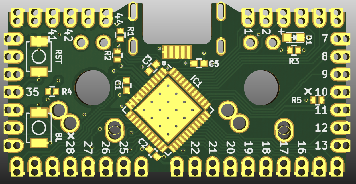

Last word before submit to matt3o for production.
R4 & R5 have been added because of the bootloader problem.
Posted: 10 Jan 2017, 15:38
by matt3o
it's just so beautiful!
what is "pk"?

Vanity from my part. Always sign your work.

pomk wrote: Vanity from my part. Always sign your work.
oooh, okay, please remove, you'll be credited elsewhere :)

wow looks gorgeous.. !!

Posted: 11 Jan 2017, 21:09
by pomk
I just submitted the files to matt3o. Here is the picture of how the connector will break if forced to open:
As you can see, the amount of solder is not the issue at all, rather the forward plated through holes rip out completely. The force required was quite large though and should not be an issue at all.
Edit: it does still work btw.
