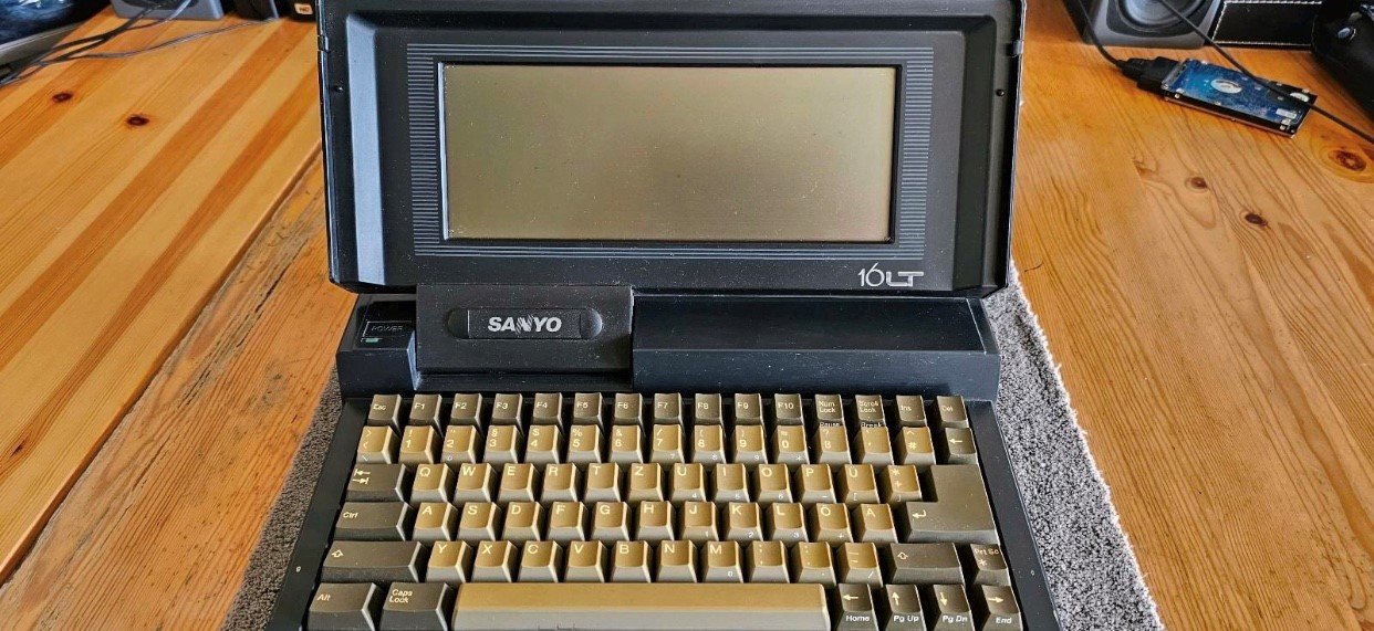

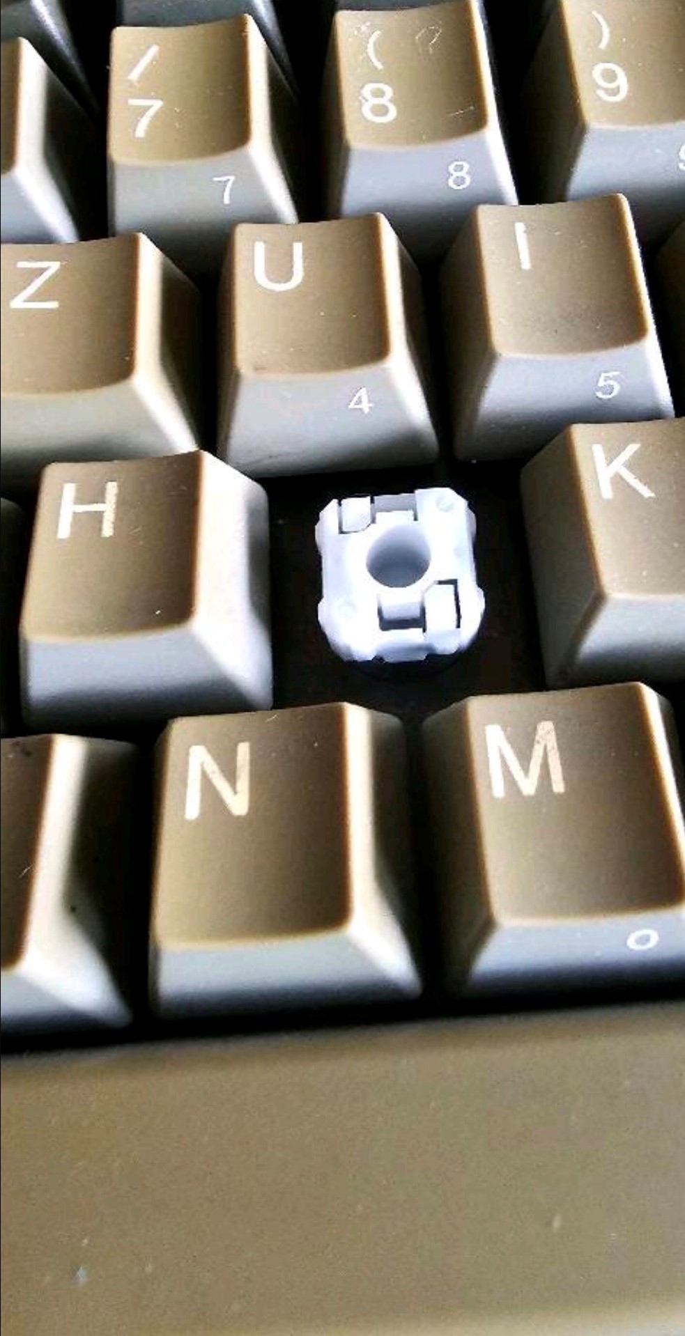

by guidemetothelight
Somebody has a clue ?
At first I thought wiki/Fujitsu_Peerless but it doesnt look like that at second glance
Model: Sanyo MBC-16LT

guidemetothelight wrote: 15 May 2023, 10:15 Somebody has a clue ?
leafe spring, got that keyboard aswell

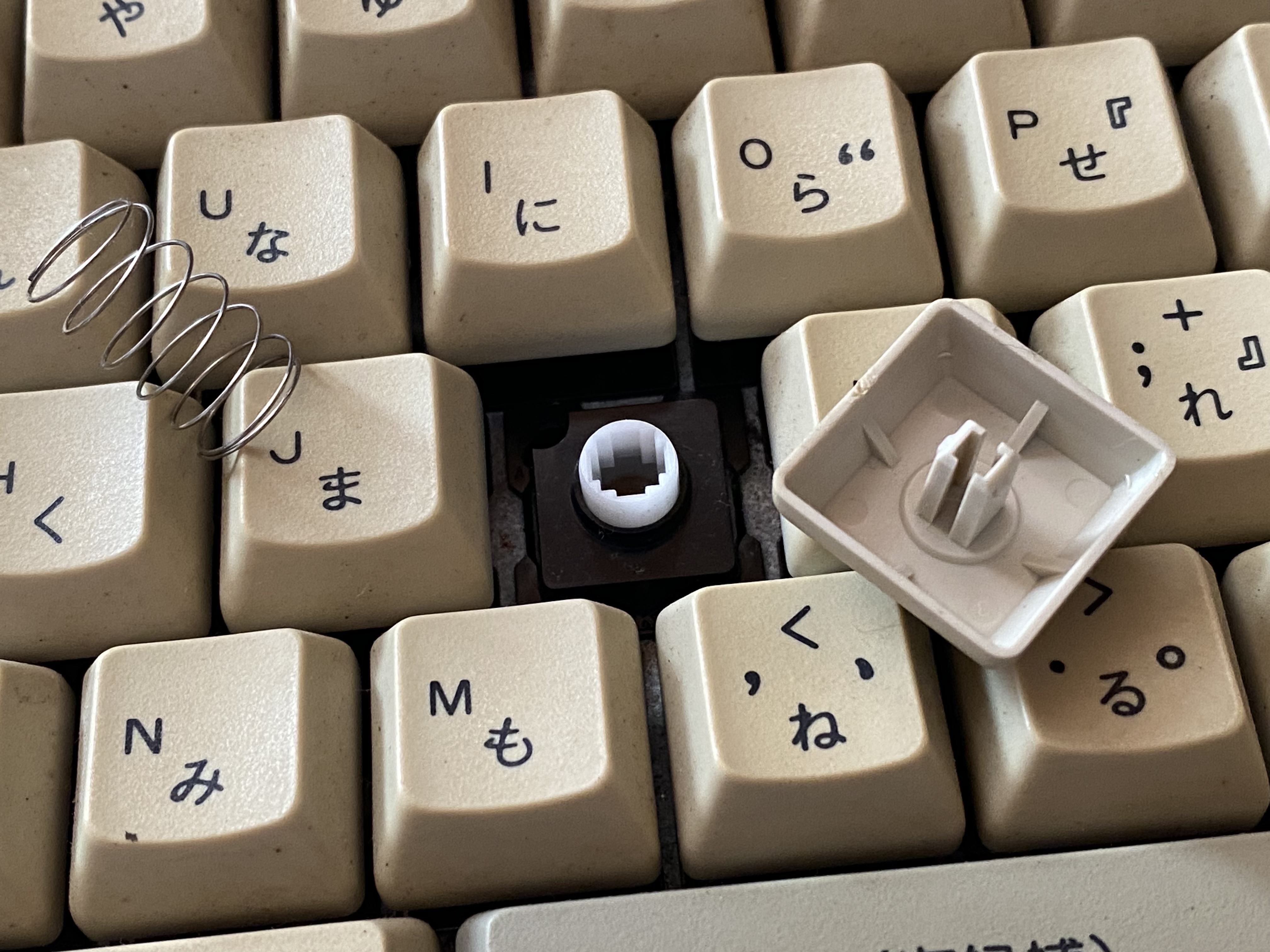

by akkk44
It was found on a Copam K-455 keyboard, but according to my search, K-455 should have dome and slider switches and not this kind of switch.
I have also looked into the Alps clone list but didn't find anything similar.
Does anyone has any clue what this switch is?

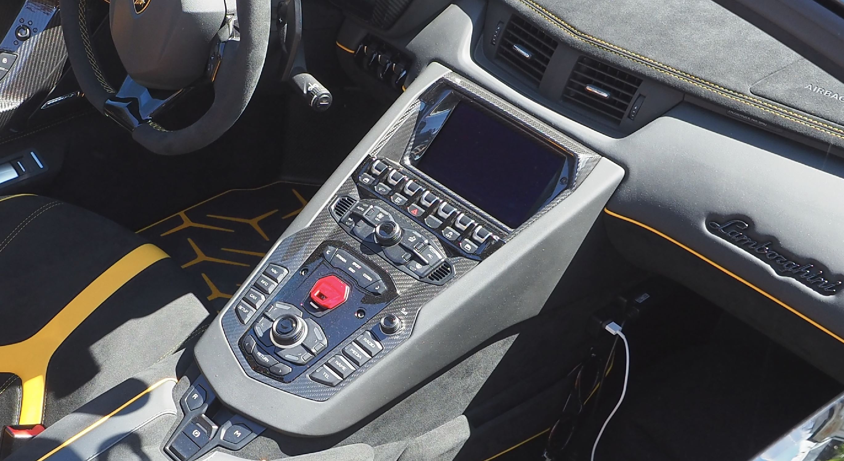

What key switches use Lambos? after all.... even these are keypads, aren't they?

I have Omron switches in my trackball.
If there's a repair manual out there for Lambo cars, not Lambo tractors, it might list the part numbers and manufacturer.

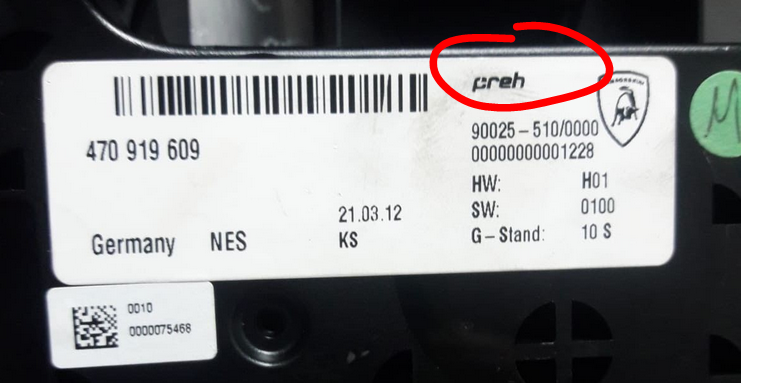

dcopellino wrote: 03 Jun 2024, 19:40 What key switches use Lambos? after all.... even these are keypads, aren't they?
Based on this sticker they're made by Preh which indeed make keyboards. I have an old one kicking around; certainly unique construction.

I know we have a Preh evangelist somewhere ...
