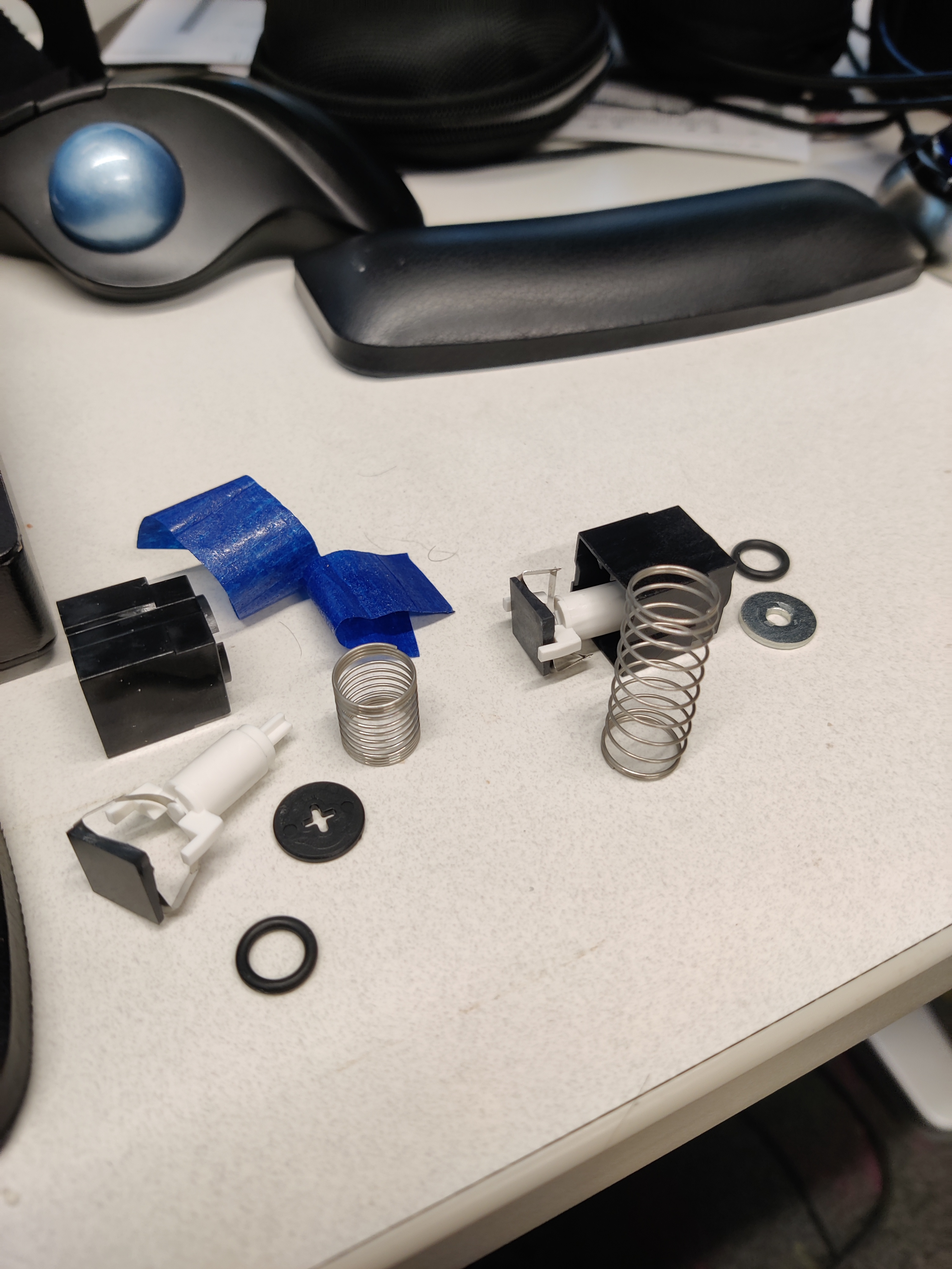

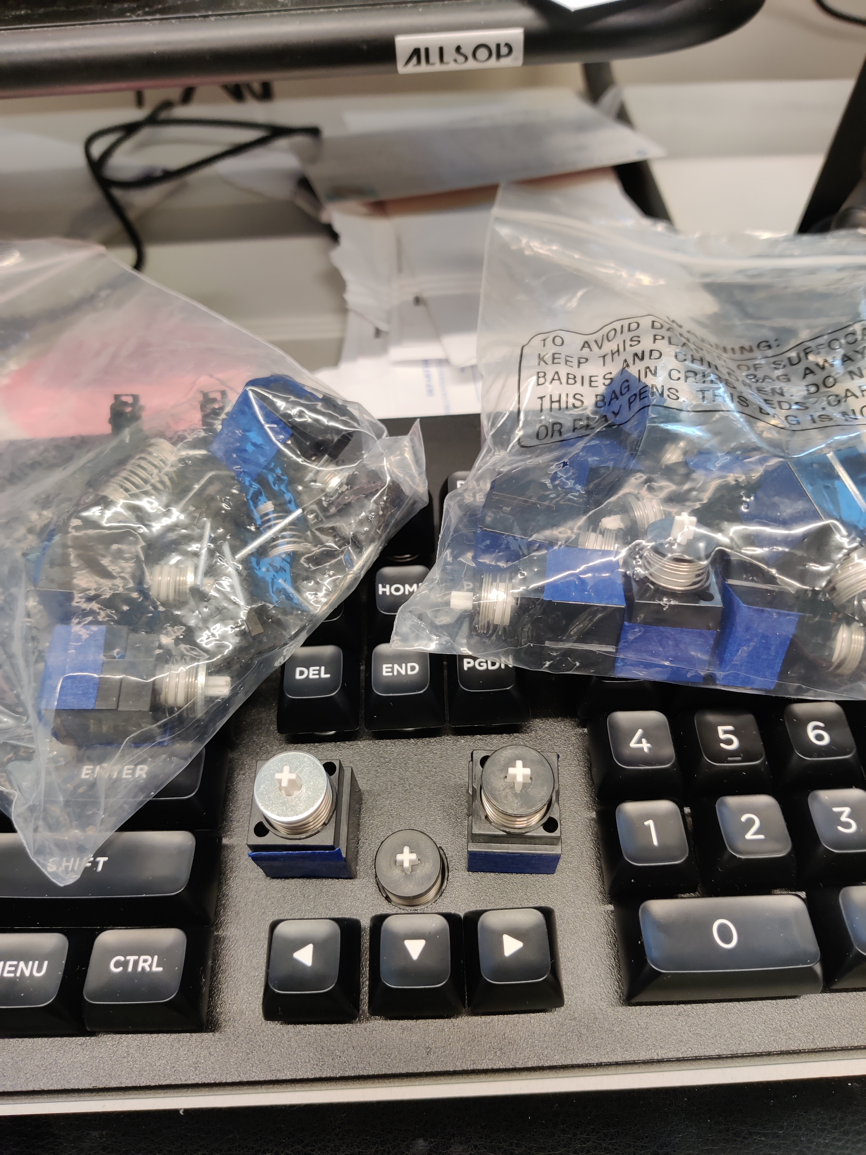

My round 1 B104 keyboard had arrived a good while ago, but due to a busy life I haven’t had much time to get it fixed up.
Gave it another go today after some new first aid kits arrived.
Unfortunately for me, this has been a frustrating endeavour.
Keyboard came with a couple of broken switches, unfortunately including the space bar where the white stem had snapped in two.
Removing some switches from the plate, they refused to go back in no matter what I tried. Several keys stick out more than others, several rattling springs.
Trying the new switches (with the plastic washers), they do actually fit and stay stuck on the plate unlike the originals I was fighting with so I’m guessing something went wrong with the production here. (Tried several original switches on the same spot on the plate, so I’m assuming the problem sits with the plate. Maybe the “gap” on the new switches is a tiny bit larger? Just guessing at this point)
Unfortunately the new switches feel significantly different from the originals with the metal washer, much lighter. Different in both feel and sound.
Not sure if I’ll ever get to completing the repair of this board. For me at least, this is getting to a level of finicky, frustration and unpleasant surprises I didn’t expect. But then in all fairness, some changes in my day to day have allowed me very little time to spend on keyboards.
I’d sell it off but since the store price dropped…
Oh well. Hope round 2 goes better! And wishing you the best with the rest of the project!

caiko I will note that there are a couple hundred new beam spring boards out there now and generally they are all up and running for those who have time to complete the setup. The vast majority of the feedback of the new beam spring keyboards is positive but privately emailed to me while the criticism is public, but that is how it goes!
Everyone who is willing to go through the full setup process will not be left without a working keyboard. I have plenty of extras of beam barrel parts A and B if any do not function beyond the included 4. Please email me when it comes down to the final total of what you need of each part and I will send it over.
It was disclosed on the product page that it is expected that everyone needs to repair modules to get things up and running. It sounds like just a couple of switches were broken from what you are noting, which is completely normal.
Did you follow the latest manual on the project web site? If you are having trouble installing modules, you may not have seen how they should be installed. The spacebar and its module are tricky to reinstall and the video details how to safely install it. Since the spacebar's module is trimmed you cannot replace it with an entirely new spare module; instead you should transfer the contents of one of the spare modules while reusing the original part A (beam module housing). Otherwise the spacebar wire will not have space to move freely. This may be why you are having trouble reinstalling a module.
The modules should not have issues fitting the top plate, but if you force a module and accidentally bend the top lip of the module, then it will have issues and may no longer be usable.
If the part B's have broken you should not be using them; please replace them. If a key is sticking up too much, the beam module probably broke even though it still may function. As noted in the manual, you should not be pressing too hard when installing the keys.
Some of the original assembly switches may have been slightly heavier because of the factory assembly error described on the page, where they pressed the "ears" inwards too much. If you are extra particular with the press force of each key, the manual describes how you can adjust each module's ears nondestructively; it is not required to break the metal washers.
Rattling springs can often be improved by separating them from the washer by hand and/or by rotating them around so the spring end is in a different position.
