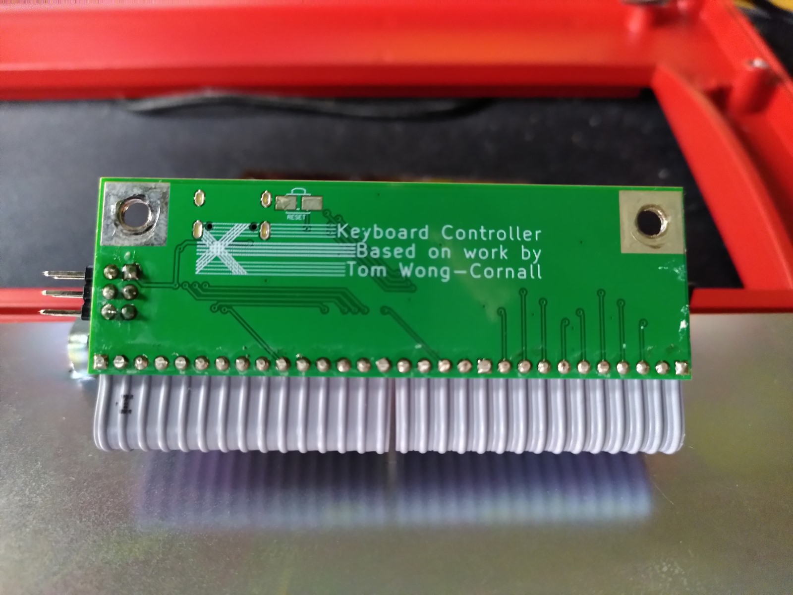

Hey! While trying to figure out why my computer doesn't like the keyboard from time to time i did a firmware write using Atmel Flip with the file "Via F77 - ANSI-ISO - PrintScr.hex". Now I can't in any way manage to get the keyboard to get into bootloader mode, so I can't reprogram it. I should note that I didn't use the pandrew utility to do a EEPROM erase before I loaded the above file using ATMEL FLIP, maybe that screwed something up?
I remember the FN key default being bound to the lower right CTRL, though if I press lower-right CTRL+SPACEBAR+R, it doesn't enter boot loader mode. Tested leftshift+rightshift+b as well, to no avail.
Any ideas what I can do? Is there any other way to enter boot loader mode so that I can just do a clean eeprom-flash?

I opened the keyboard, and though I didn't find any reset pads, I found the PROG-pads. I followed this manual: https://www.modelfkeyboards.com/manual/
It says you should short the PROG pads and not any reset-pads.
I've tried this for over half an hour now, and it still doesn't enter boot loader mode.
What I do is:
- Short the pads with a tweezer (while keyboard is unplugged)
- Plug the USB-cable in
- Remove the tweezers (here I've tested to do it for various times, from instant to waiting a few seconds).
The keyboard doesn't go into boot-loader mode but it's still a normal keyboard in Windows.
Any suggestions?

Keyboard is in bootloader mode! You REALLY need to apply force with the tweezers on the pads for it to work.
The good news is that it doesn't seem to matter how much time it goes before removing the tweezers. What I did was:
- unplug keyboard
- Short-circuit the pads (uzing tweezers with quite a lot of force)
- Plug the keyboard in
- Wait for 1-2 seconds
Then it went to bootloader mode.
Thank you all!

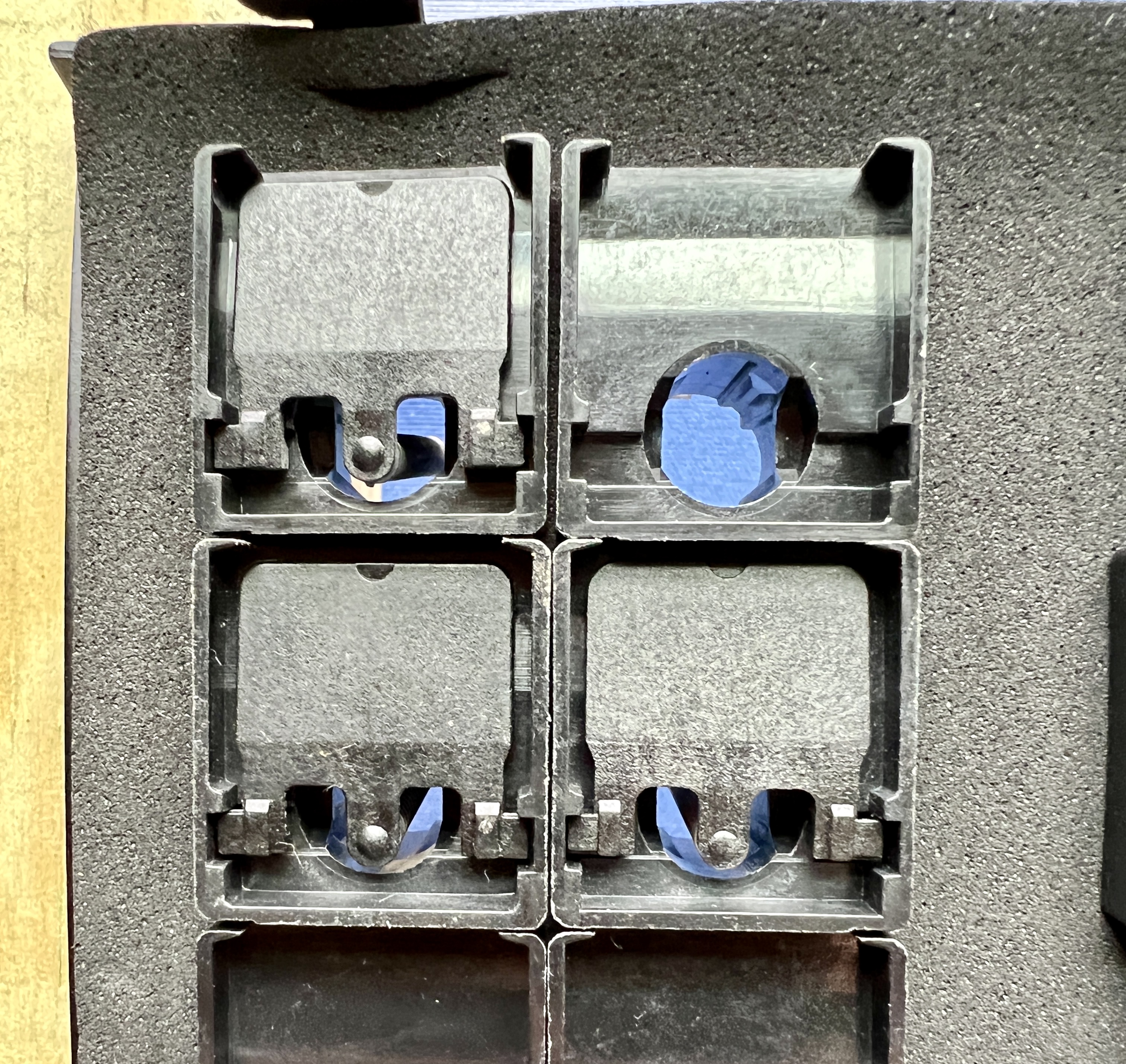

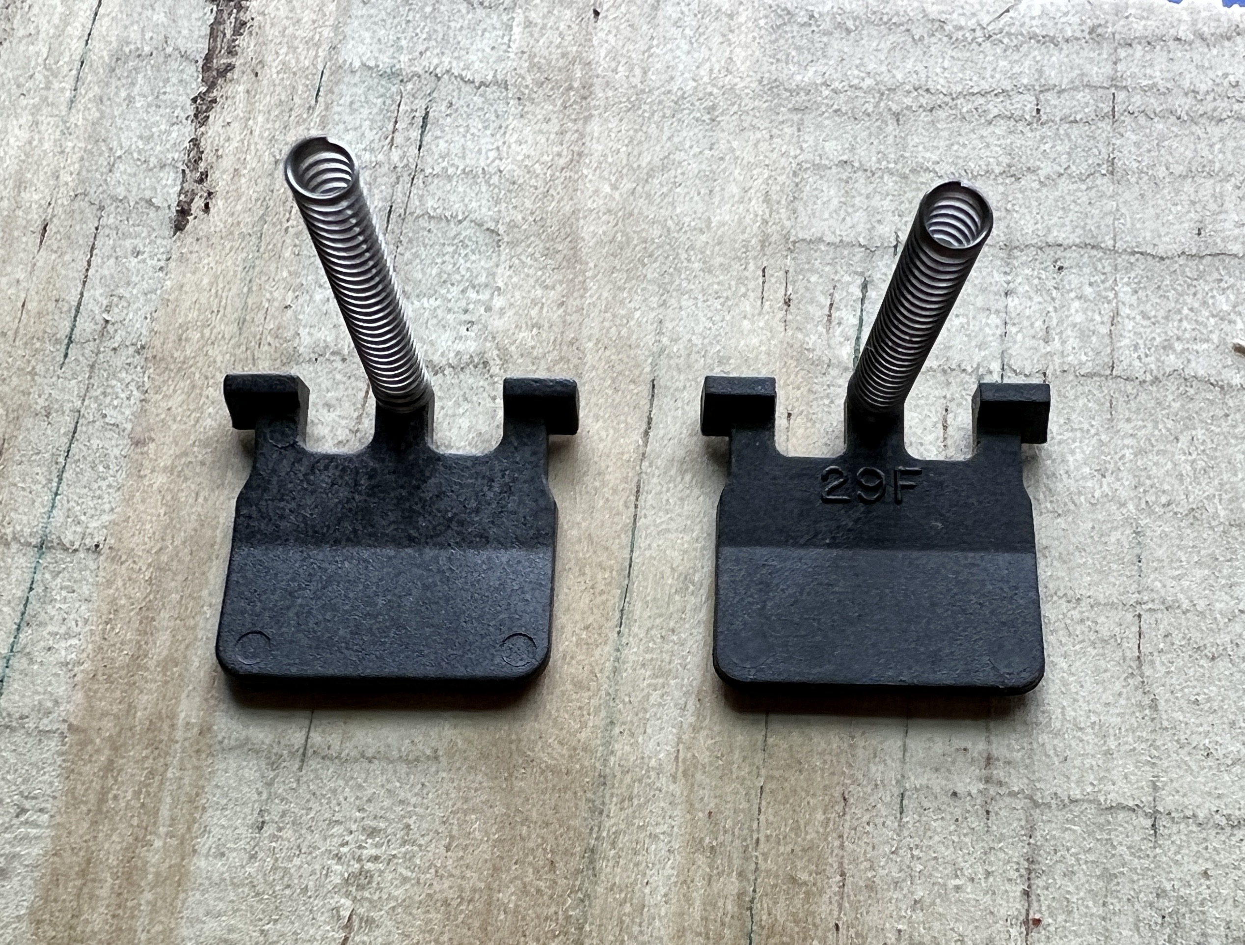

Random question, but are the springs and/or flippers compatible between these new Model F keyboards and the vintage ones, e.g., XT and AT?
Re: F62+F77 orders now open! New Kishsaver+Industrial Model F Keyboards
Posted: 23 Aug 2022, 22:06
by thefarside
Arkku wrote: 23 Aug 2022, 21:27 Random question, but are the springs and/or flippers compatible between these new Model F keyboards and the vintage ones, e.g., XT and AT?
Yes they are. In the picture below the bottom right flipper is a reproduction and the two on the left are original IBM.
On this picture the one on the left is a reproduction and the right is original IBM:
Hope this helps!
Also, I heard there are some flippers (XT maybe?) that have angled edges and might not be compatible with AT and 4704 style flippers. I can’t speak from experience and maybe someone who knows better can chime in. I know the reproductions are AT and 4704 style.

It is my understanding that all Model F flippers are compatible with all Model F keyboards. Nice photo comparison!
