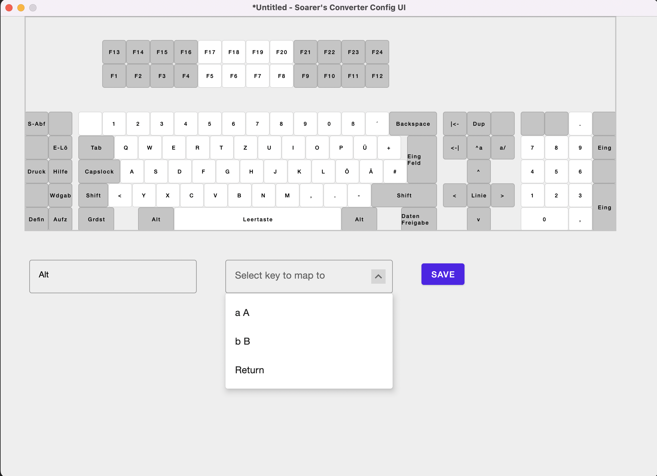

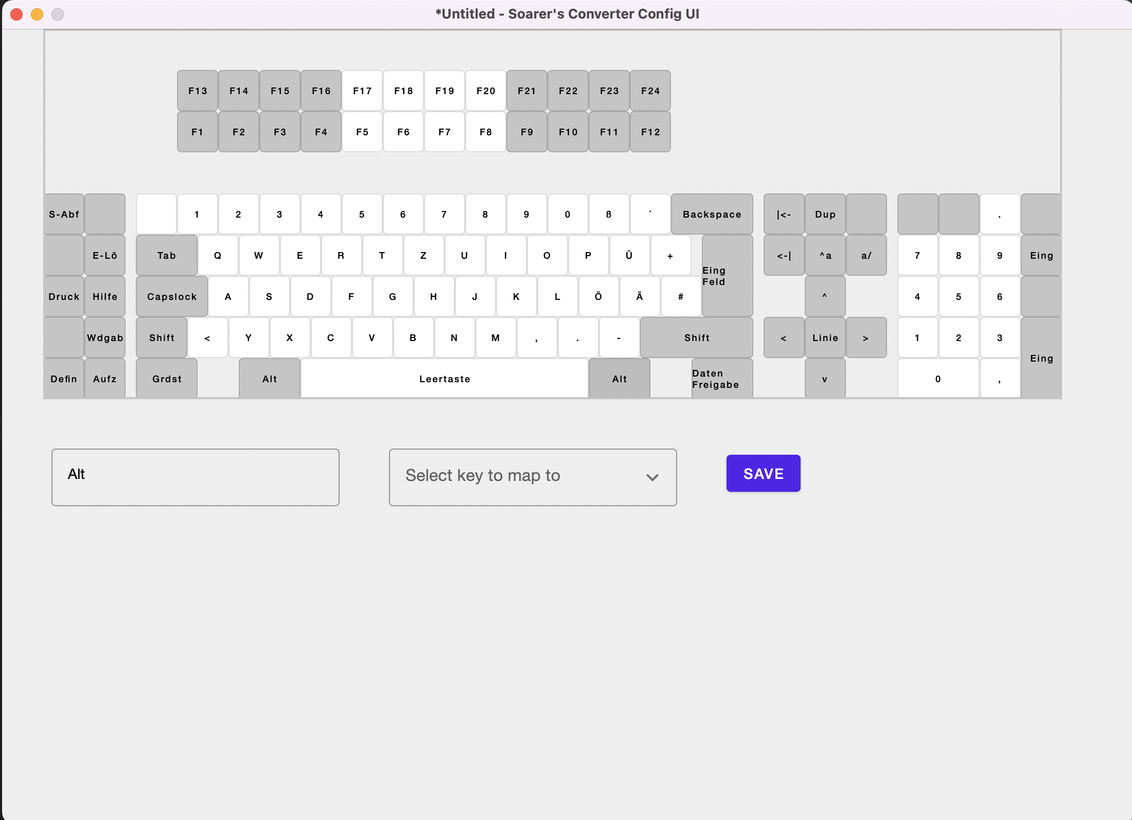

Hi,
I restored a few Model M 122 key terminal keyboards and also used the Soarer's Converter to flash Arduino Pro Micros with.
The way to write your config files and flash them to the converter is fairly easy if you done similar things before. But when you did not, it may be a bit difficult. That's why I tried to make a UI for the Soarer's Converter.
With this very early version you can see your keyboard and click an a key (right ALT in this example).
Screenshot_2022-09-03 20.43.28_aYDWuw.png (646.29 KiB) Viewed 27291 times
You can then select a key to remap to (I only entered 3 keys for testing).
Screenshot_2022-09-03 20.43.37_JCHm7a.png (722.6 KiB) Viewed 27291 times

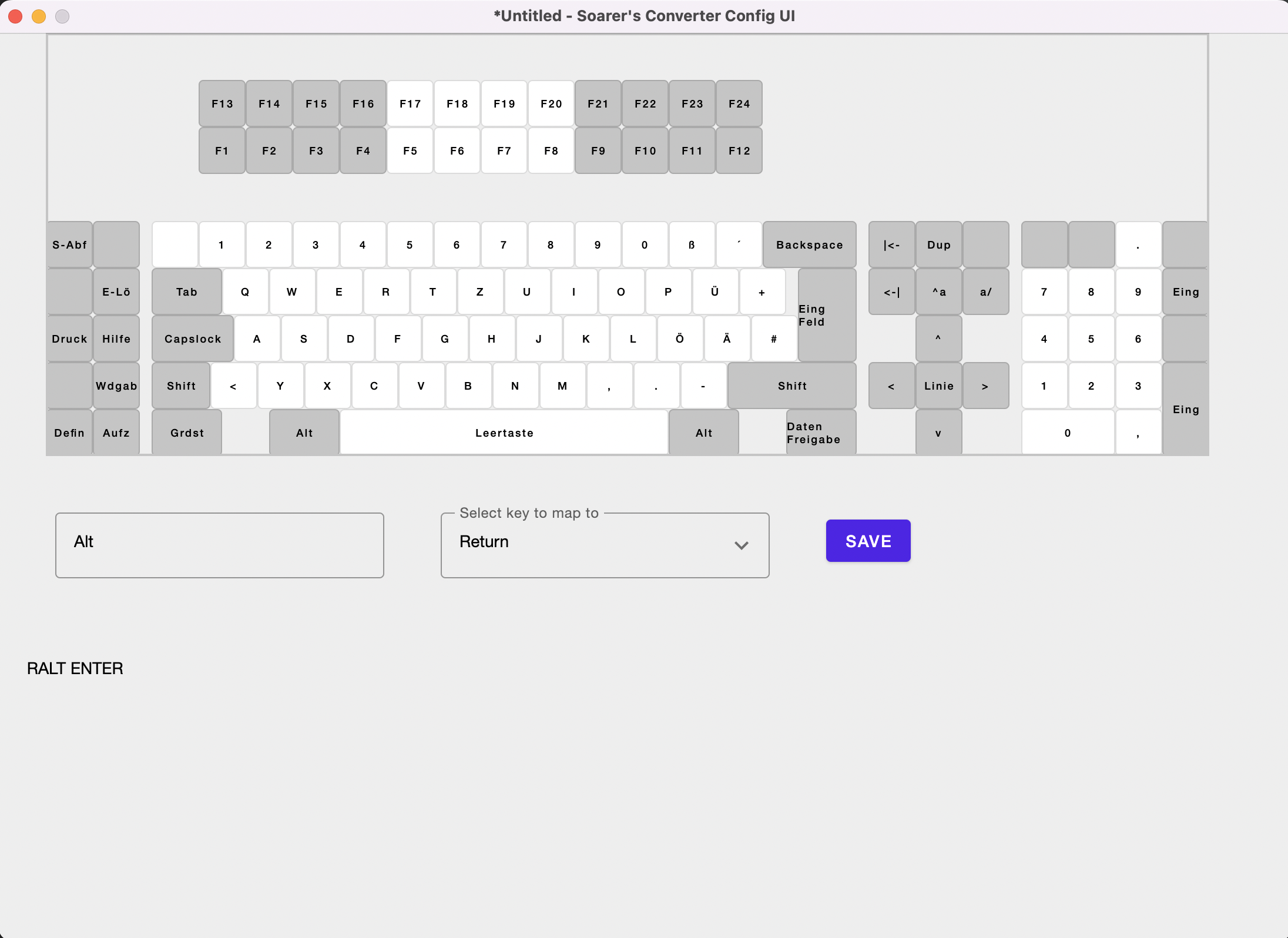

And then you see the mapping below.
Screenshot_2022-09-03 20.43.45_sD9J43.png (623.84 KiB) Viewed 27291 times
Of course there are many features still missing, e.g. switching to another keyboard layout, macros, layers, read and write configs to the converter directly etc.
But do you think this could be interesting to continue as a tool for beginners?

Interesting. I see a Mac window. What are you building this with?
As for handing it to the masses: even (and especially) newbs have finicky requests for very particular things they’re trying to do. You’ll wind up with one almighty todo list of a project! ;)
Re: XT/AT/PS2/Terminal to USB Converter with NKRO
Posted: 04 Sep 2022, 16:07
by AngryCockroach
I am using Kotlin and Compose for Desktop. So I can build it for MacOS, Windows and Linux with the same code (but I need to build it on all three OSes separately…)
Well, since it is a hobby, it should not be finished soon anyway :D
And also some people may help…
As soon as I implemented the flashing within the app I will build it and it can be tested.
But I need some more different keyboard layouts. So feel free to paste the hid code layout for other keyboards.
