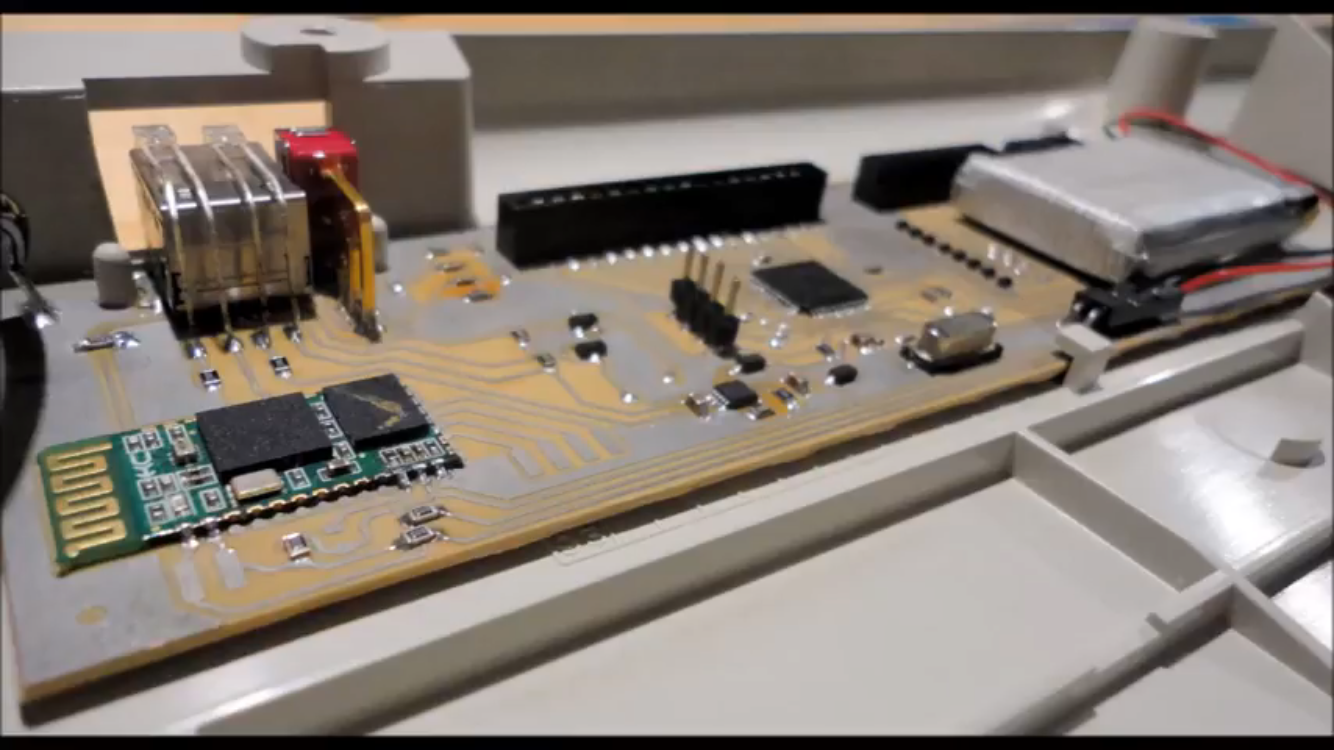

Seeing
mind_prepared's Bluetooth Model M in the Great Finds thread makes me wish we could slap BT in this.
If someone wants a MASSIVE gold star, the daughter board that WCass put together is begging for BT (as soon as I saw it, it's immediately where my mind went). Its the perfect spot for it, but trickier than normal because it is already in USB protocol by the time it hits the board. So you would need to firmware it differently than a conventional HID key mapping. I did reach out to mind_prepared about it because I was impressed by his approach, but he doesn't have the "tools necessary to write a custom firmware for the BC417". He's bright btw based on his response if anyone ever needs help in that space.
To back up beyond this project, if someone did make the daughter board BT enabled,
you would actually be creating something that could BT enable any xWhatsit currently around (or any USB keyboard for that matter) assuming there was room in the case for the board and battery. It would only potentially require minor tweaks in the firmware and connection considerations. That is the genius of this modular approach WCass came up with (software folks should appreciate the abstraction of controller vs comm). If we ever do dream up a better connection (BT, XBee, whatever), it only takes swapping the daughter board out. The trickiness of the xWhatsit remains untouched as the actual controller, and can receive comm upgrades over time without impact.
- 440723_orig.jpg (67.77 KiB) Viewed 8490 times
Posted: 28 Aug 2016, 01:10
by phosphorglow
Welllllllll...
Basic functionality would likely be possible. The 32U2 only has two unused pins (B3 and C2) which could probably be swapped to free up D3 and D2 for UART. But then no pins are left to check for battery level, flow control, and other useful related control (depending on the BT module used).
The expansion header could be removed to free up another four pins, but no room left for LEDs or solenoid. Or redesign it again with the '1286. Also, everything will have to be stepped up to 5V running from a battery. Battery life will likely be awful. Throw a big 'ol battery in there, though...
Then it's a matter of adding a serial protocol to the firmware.
Certainly some very clever people around here can do this. Bluetooth Model Fs and Beamsprings really need to happen. Just because.

phosphorglow wrote: Also, everything will have to be stepped up to 5V running from a battery. Battery life will likely be awful. Throw a big 'ol battery in there, though...
The 5.5v would be because of solenoid charging of the driver and the LED? The solenoid we could say is a no-go with BT (deal with it). The LEDs... how do other boards handle that now? I could certainly live without it (I rely on the OS or PC side firmware to yell at me if the capslock is on (which it RARELY is))
Posted: 28 Aug 2016, 01:45
by phosphorglow
Ooooh, there's some heavy forward thinking! Definitely beyond my current understanding of things, but I LOVE modular designs and that sounds keen.
For the sake of relative simplicity, using the AT90USB1286 in a future revision would leave ample amounts of expansion at an increased cost of about $6 and a larger footprint. Modifying the firmware *should* be simple enough for someone who knows what they're doing.

Posted: 28 Aug 2016, 17:06
by wcass
what he is using is
this plus a USB battery (for charging a USB charge device) with an adapter between the two. As this is a kit that needs assembly, it would be easy to connect everything direct to pin instead of the actual USB connectors.

wcass wrote: what he is using is
It is certainly cleaner than an Ada + separate arduino. The only downside is it looks like the actual BT receiver is not included... Or am I reading that wrong (from the phone)? Certainly slick though, even if pricey.
If we can go direct to pin easy enough, does it make sense to just do that with mind_prepared's approach, and have everything (BT/USB) live on the daughter?

I didn't know I was working on something that - with some adjustments and actual brains put into it - could give everyone a hardon.
