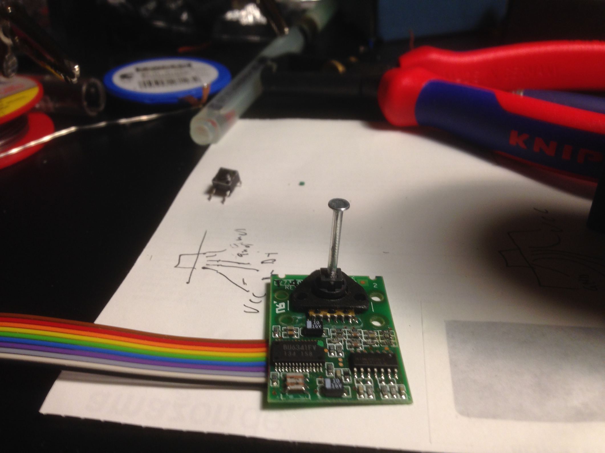

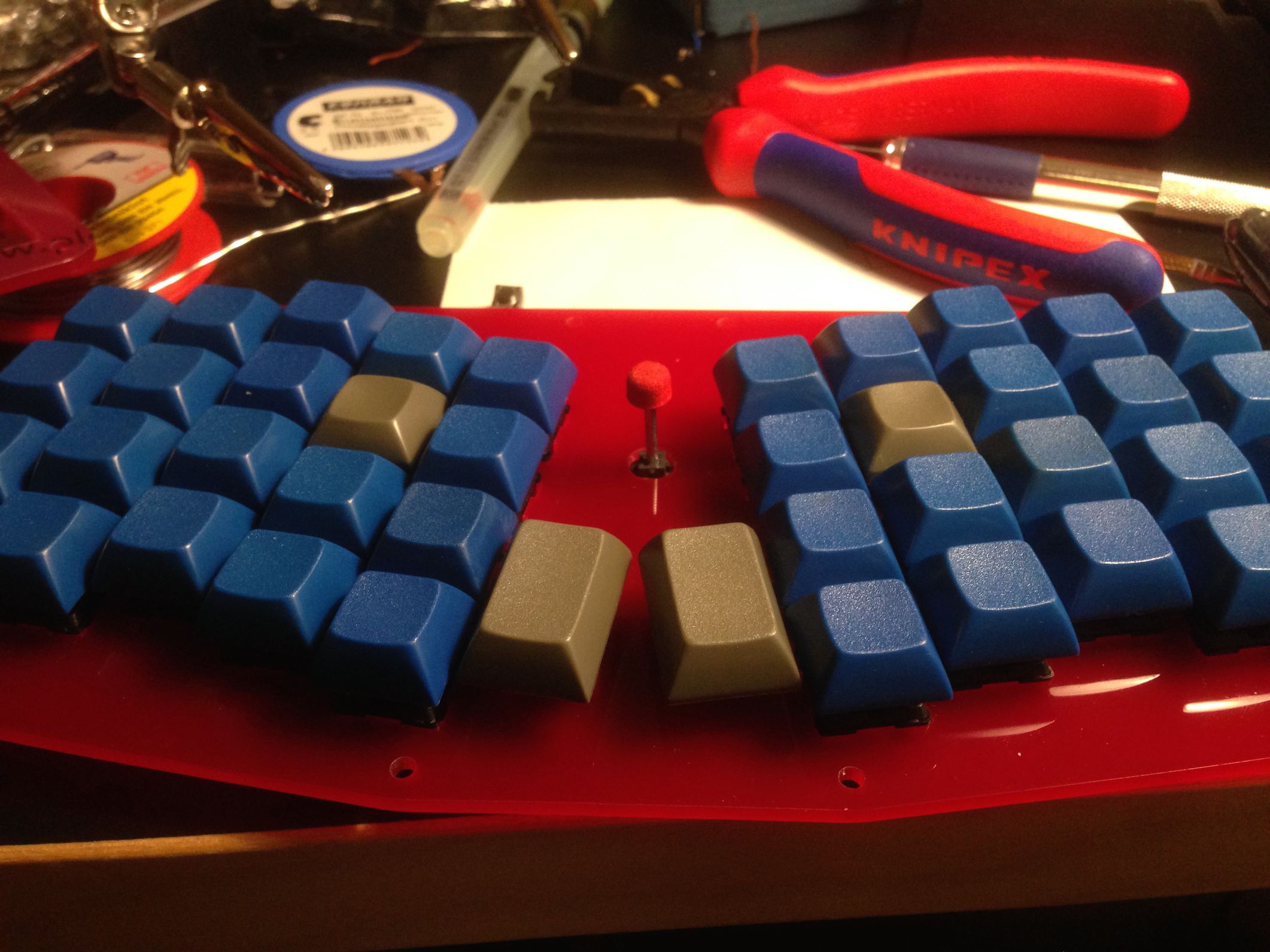

I'm currently of building an Atreus with a trackpoint and I extended the stem by drilling a hole and putting a nail into it.
The cap even fits the head of the nail exactly.
Now I'm thinking about where to put the mouse buttons…
