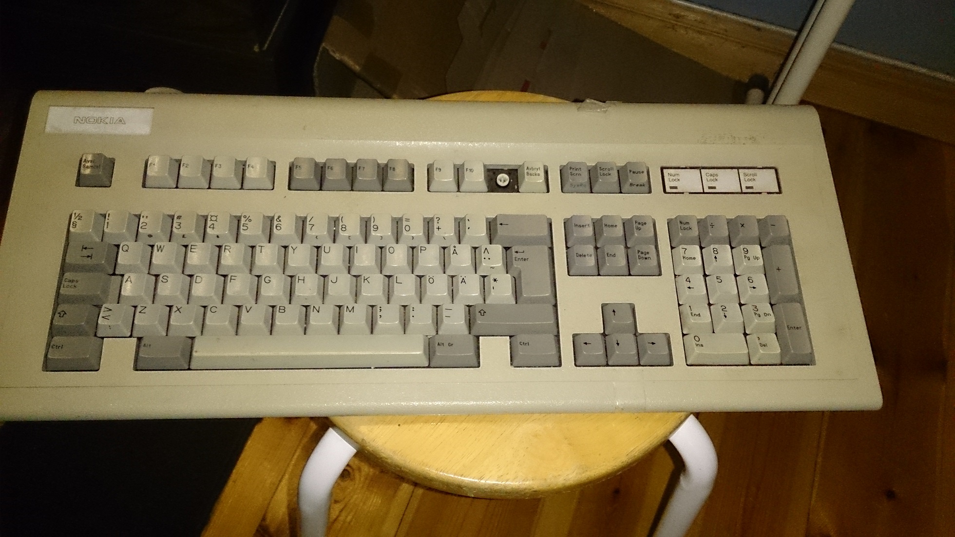

ok, i recently acquired this nokia branded Keytronic board which i think (going by the extra keys (one's missing)),was used in one of their old Telephone switches.
The problem though comes when i try to plug it in, my computer goes haywire since (as far as i can understand) it seems to be trying to activate every key at once. And the only way to regain control is to pull it out again.

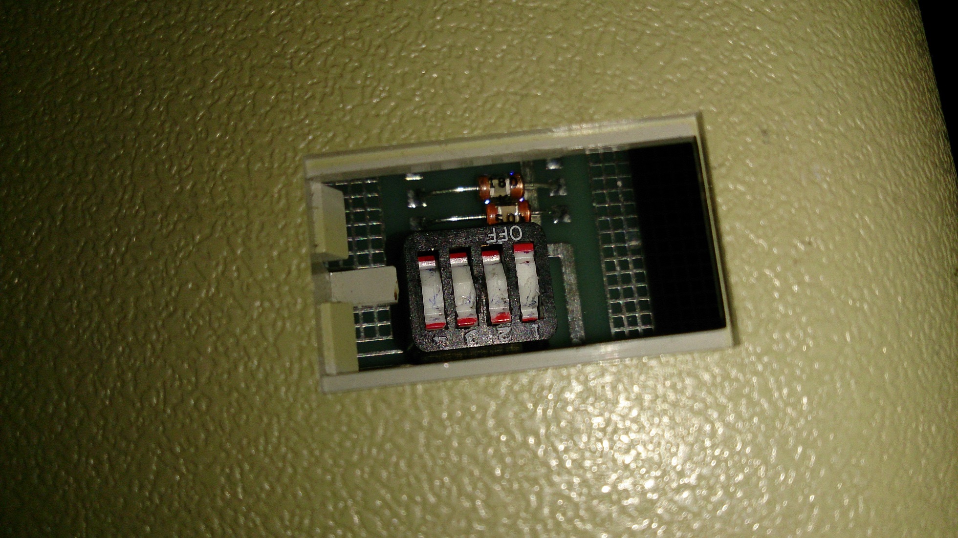

There are four DIP switches under a hatch on the back, but they don't seem to help much.
I am pretty sure i have already tried every configuration and the result is either the same chaos-effect or the computer simply fails to recognize the board.
Any ideas what the problem might be?

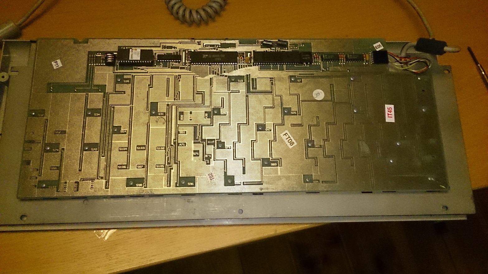

Ok, i did as you said and removed the shell but then i found something else: A big steel plate screwed onto the pcb.
I cant tell from your video if your's had one to, so should i remove it? (That's a lot of screws) :?
Posted: 20 Dec 2015, 22:38
by Chyros
That's the mounting plate. My Key Tronic was built the same way (and it had what looked like the exact same PCB). You can't really remove the steel plate, but if you remove all the little screws from the PCB you can see right inside all the switches.
Posted: 20 Dec 2015, 23:10
by Jimi14
Ok, i have fully opened it now and i cant see any problems with the foam/foil pads.
what i can see though is the pcb itself. The contact points are all dirty, scratched up and some seems to even have eroded somewhat.
Some alcohol rubbing maybe?
