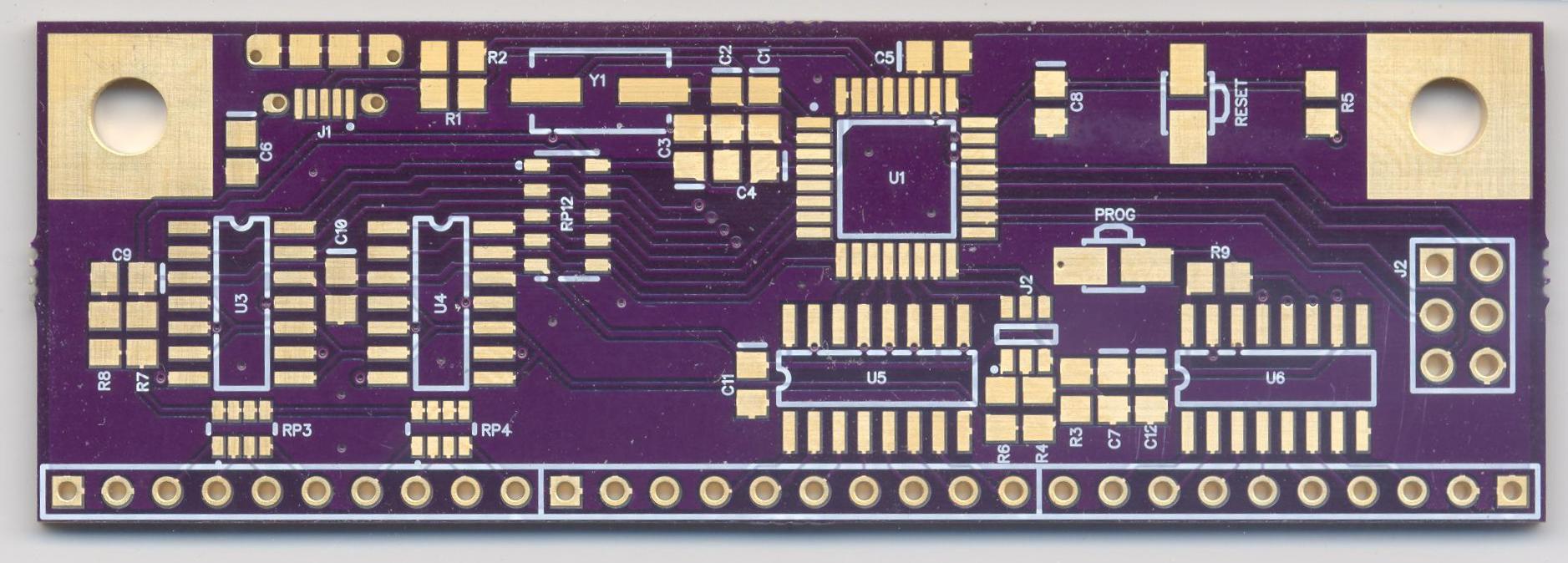

I have been a hobby draftsman for about 30 years and have a fairly good understanding of plumbing, so I thought I could rearrange Xwhatsit’s Model F controller to make it more convenient to use in new capacitive keyboards; this despite having no electronics experience or training at all. I tried a bunch of EDA software and … let me just say that, IMHO DipTrace is vastly superior to KiCAD and is free for hobbyists (up to 300 pins).
Lucky for me, when I started this, Red had just published a DipTrace redesign version of Xwhatsit’s and I started with his schematic. Red had designed for 0.05” pitch ribbon cable; I considered that to be too fine for normal folks (like me) to hand solder, so my design goals were 0.1” pitch ribbon (easy to source) all in-line, expansion header on left or right side, and convenient mount holes – all in a nice small package so as to easily fit in small places.
Like Xwhatsit and Red, resistors and capacitors are 0805 (except for resistor packs). Red chose to replace the ultra fine pitch surface mount component shift register that Xwhatsit used with a larger (but functionally equivalent) footprint and that seemed like a reasonable replacement to me. I changed RP1 and RP2 for a single bussed resistor pack (RP12) and went for a much smaller crystal to save space. Changing the crystal meant that I had to change the value of the load capacitors slightly. I made a few assumptions that I believe to be true; the big one being that row order do not make any difference at all. This allows me to route the row traces with a little more freedom. The design I came up with is this …
I ordered PCBs from OshPark ($15 for 3 copies), a stencil from OshStencils ($7), and components for 3 copies from Digikey ($50). The stencil and components came quickly, the PCB took two weeks.
Notice the USB connector? Those holes are supposed to be slots (compare to design). Something that I missed when ordering the PCBs is that OshPark does not do slots and because of that, the connector side tabs don’t fit. The back tabs fit (but are off center), so I just bend the side tabs up, solder away, and hope that the pins solder OK.

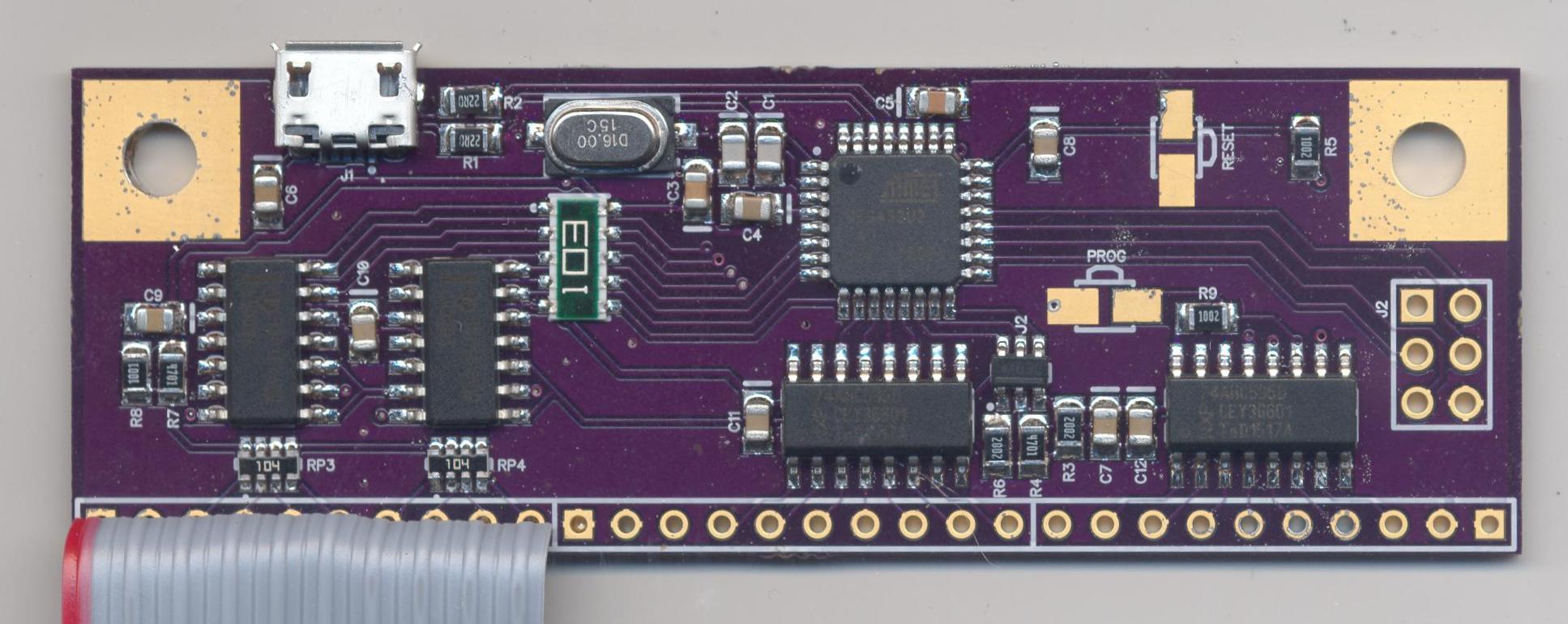

Anyway, this is what I ended up with. The problem is ... it is not working. When I connect a USB cable, it does not detect a new device, so I can't program the processor. It might just be the USB connector, but i'm not sure. Suggestions would be welcomed.

OS detects nothing when i plug it in. I was hoping that the macro picture would show a bridge somewhere or a flipped component. if there is one, i can't find it.
Posted: 06 Apr 2016, 05:27
by Engicoder
It looks like there is a via in the VCC line off the connector that goes to the ground plane on the back, but I may be mis-interpreting it.

Engicoder wrote: It looks like there is a via in the VCC line off the connector that goes to the ground plane on the back, but I may be mis-interpreting it.
Thanks for looking Engicoder.
that is a silkscreen layer (green) dot to mark pin 1. sorry, the picture is not clearer.

Yes, it is preprogrammed with the Atmel flavor DFU bootloader. According to Sections 25.2 and 23.6.3 of the datasheet, the HWBE (Hardware Boot Enable) fuse is programmed from the factory so that the bootloader can be hardware triggered by holding PD7 low on reset.
Posted: 06 Apr 2016, 11:39
by vvp
If you can get to ISP leads then you can try to connect it to a programmer. I think (but I'm not sure) that the programmer will find the chip even if the external oscillator/crystal does not work. The communication with the programmer should happen before the chip switches to the external clock source. The only thing actually required to get the part recognized by the programmer is the power source for the chip. On the other side, USB requires the external oscillator working.
Posted: 06 Apr 2016, 12:28
by flabbergast
I also think that if you can get an AVR ISP programmer connected, the crystal and fuses should not matter. However you've made some unusual choices in routing - 2x3 connectors looking like that are usually connected to the pins that allow you to hook up an ISP there; in your case they go to some random pins. Hooking up an ISP would require you to solder wires directly to MCU pins.
Crystal - I thought that the load caps should be physically as close to the crystal pins as possible (not sure how much does that matter - I guess the issue could be the traces' capacitance). Don't know whether this could be a problem.
If the bootloader is there (which I think it is - it seems to me that almost noone in the KB world ever flashes a bootloader, including hasu and bpiphany who do 32u2 MCUs), then I think it will run regardless of the HWBE fuse/HWB pin status, because the rest of the flash is blank. However you might want to pull HWB low just to be on the safe side.

If you look from the back edge of the USB connector - do the pins look like they are all in contact with the board? I've been staring at your layout and the populated PCB pics for a while now - I don't see anything wrong with it. I can't see what is under the USB connector though.
I am curious if your combining RP1 and RP2 will be OK from a capacitive scanning POV - but that wouldn't be affecting the USB to controller side of the circuit.

Just a note for when you order a revised version of this board: it's generally a bad idea to put vias inside of or directly adjacent to pads. Since they're plated-through holes, they'll get filled with solder, making you use more than you need to.

I'm using __red__'s schematic with just the 3 changes already listed (crystal, RP12, rearranged rows).
crystal is 535-12830-1-ND with caps at 30pF. did is miscalculate that value?
I'm going to swap the USB connector for one with no pins to see if that helps.

I couldnn't find __red__'s schematic with my quick search. But assuming that __red__'s design were already confirmed and your skillet soldering works well(yes, it looks good to me) the changes you made seem to be first suspect to be examined.
From your PCB pics it seems your are using other smaller crystal thatn 535-12830-1-ND. Anyway, if you are actually using 30pF capacitors in your design it sounds to me too much for the cyrstal's load capacitance. From my experience, if you use wrong capacitors X'tal cannot oscillate and MCU doesn't boot sometime. If you have decent oscilloscope check if your X'tal really oscillates.
You can refer this note to understand Xtal's load capacitance. (To be honest I can't understand this thoroughly :D)

Both C1 and C2 are 30pF? If yes and assuming the PCB has a stray capacitance of 4pF gives:
CL = (C1 * C2) / (C1 + C2) + Cstray
((30*30)/(30+30))+4 = 19CL [close to the 18CL specified]
C1, C2 = 2*CL – 2*Cstray
Or, (2*18)-(2*4) = 28pF [close to the 30pF caps used]
If CS=3, then the 30pF and 18CL values are spot on
If CS=5, then you get 26pF and 20CL

Without a scope to see what the rate is; I would just swag it.
You have a pair of 30pF caps now (C1=C2), and it appears not to be working (or in other words if CS was 3, then your 30pF should be good for an 18CL on the crystal). So I think we can ASS-U-ME that the CS =/= 3.
If we go with a CS=4, then since your C1=C2, and you have 18CL target :
CL = ((C1xC2)/(C1+C2))+CS
Since C1=C2 then the equation becomes:
CL=((C1xC1)/(2xC1)+CS
CL=(C1/2)+CS
Rearranging:
C1=2(CL-CS)
The crystal load capacitance is 18pF, and assuming CS=4pF, then:
C1=C2 = 2(18pF - 4pF) = 28pF
Said all that to say - can you try a pair of 0805 28pF caps? :D
