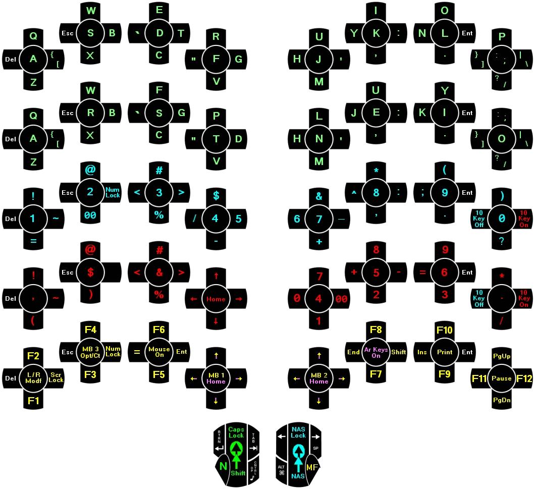

There are three different aspects in learning the DataHand.
The first, the initial learning curve is surprisingly simple. It may look alien, but in fact the layout feels very much like ordinary QWERTY (or Colemak in my case).
Consider the layout of the DataHand. The different rows are different layers accessed by shift/toggle modes on the thumb keys. Except the second row, which is my Colemak version of the first row. Check the first row. If you place your fingers on the Datahand, it's the same as placing your fingers on the homerow of a keyboard. If you want to hit R, for example, instead of moving your finger one row up, you move your fingertip to press the up key on the DataHand. This part is easy.
Then there's the part that this is not a keyboard you type on like an ordinary keyboard, but one where you wiggle your fingers and kindly tap the keys. You need to learn not to put force in this input device and just relax. Sounds a bit silly and I adjusted quickly, but your muscle memory is defined by normal keyboards.
Last part is the most difficult one, or better, the most time-consuming. Yes, it's easy to learn the layout, but then there's true muscle memory where everything goes naturally and you reach the same speed as with ordinary keyboards and beyond. This process takes at least half a year.
