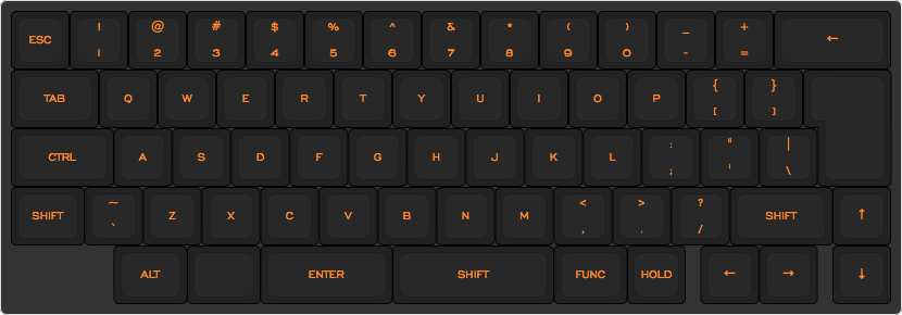

It seems a shame to waste the ISO Return key, so I have been trying to come up with a Mac-friendly ISO format with arrow keys that will fit a 60% case. Here’s what I have come up with so far:
The split space bar is oddly labelled ENTER/SHIFT because it is made from the available key caps of size 2.25u and 2.75u: the ANSI Enter key and the right shift key. As it happens, these are the keys that Devlin can’t manage in Q-Series so will be in the slightly sloped QS series. Which might work out nicely.
I can’t quite manage to create a T-shaped cursor block without removing the right shift key altogether so I have compromised with an upside-down L. The gaps between the arrow keys are supposed to help with navigation.

The holes in the bottom row don't quite convince me.

Not completely sure about the gaps in the bottom row either. The obvious alternative is a ½-unit gap and a contiguous L-shaped navigation. My thinking was that the little gap would make fumbling for the L-shaped cursor keys by touch less random—but until I have something to play with I don't know whether I'll like it or hate it! Maybe I can try some kind of throwaway prototypes in plywood or something to see how they feel in practice.
Funny thing about the layout is that I started with something more different from standard and as I fiddle with it and think about the details it has changed little by little to be more like the standard Apple-flavoured ISO-like layout. Much like last time I tried designing a crazy new 65% layout and after a few iterations I discovered I had reinvented the True Fox. :-)

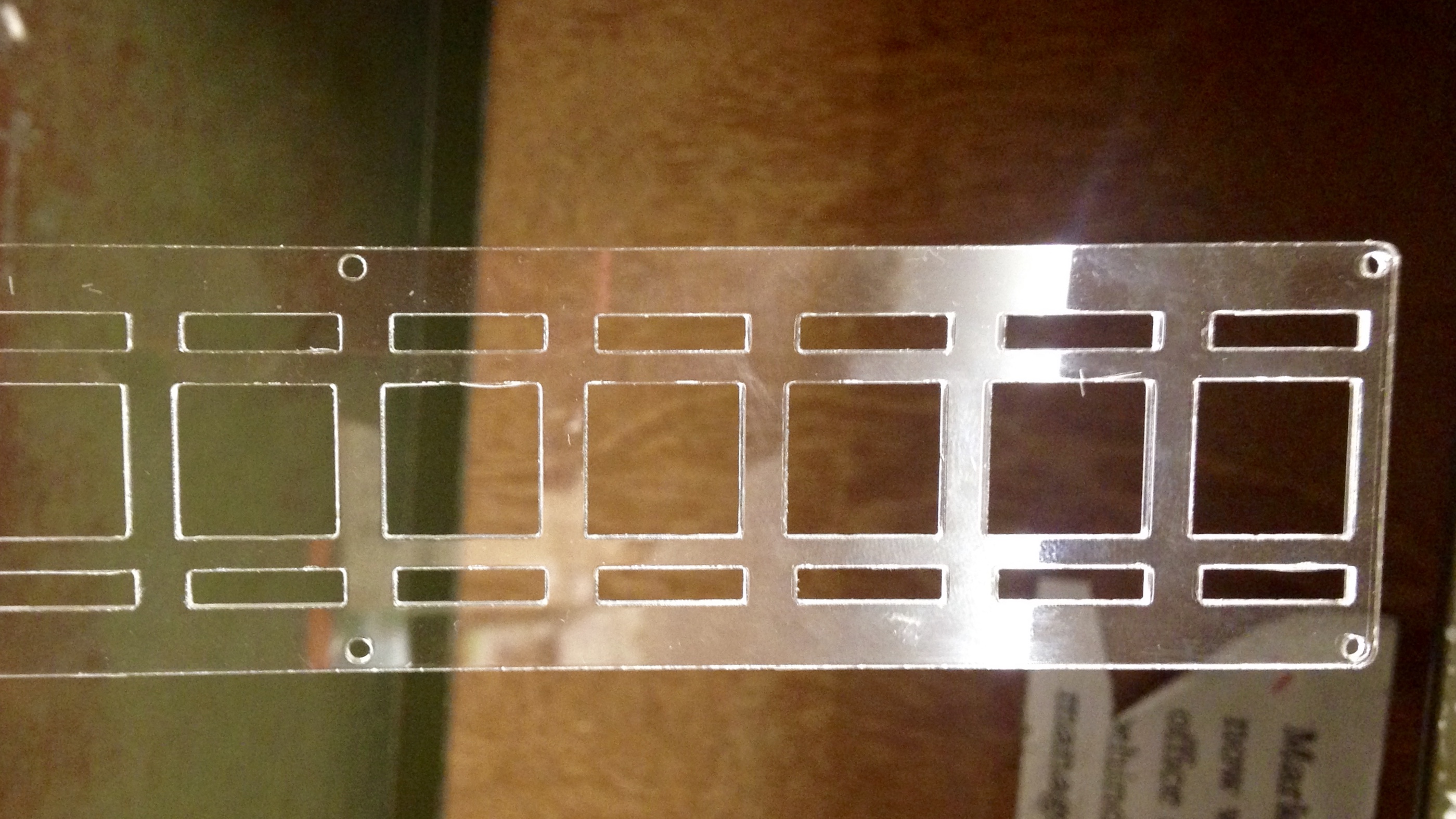

Today’s lesson is about tolerance. Specifically, that the tolerances on sheet acrylic are less stringent than the tolerances on Cherry MX switch and Co-Star stabiliser clips.
I have cut a test piece with the assist of Jared at Oxford Hackspace:
I made a thing!
I made a thing!
The idea here was to make lots of different-sized holes and choose the ones that fit best:
Trying out with some switches
Turns out I can jam the switch in and have it held by friction but it does not click in to place and the stabiliser holder is slightly twisted, making the stabilised key bind most of the time. The plate is just a smidgen thicker than the 1.5mm. I think the difference in thickness is tiny—less than a quarter of a millimetre by eye—but it makes enough of a difference.
I think the obvious things to consider next are (a) find out whether it will be possible to machine down parts of the plate to closer to the exact thickness, pretty much following the pattern of my ‘under plate’, or (b) revert to a thicker single piece and just jam the switches in and glue them in place. With option (b) I am not sure how I would get the stabiliser clips to sit nicely though.

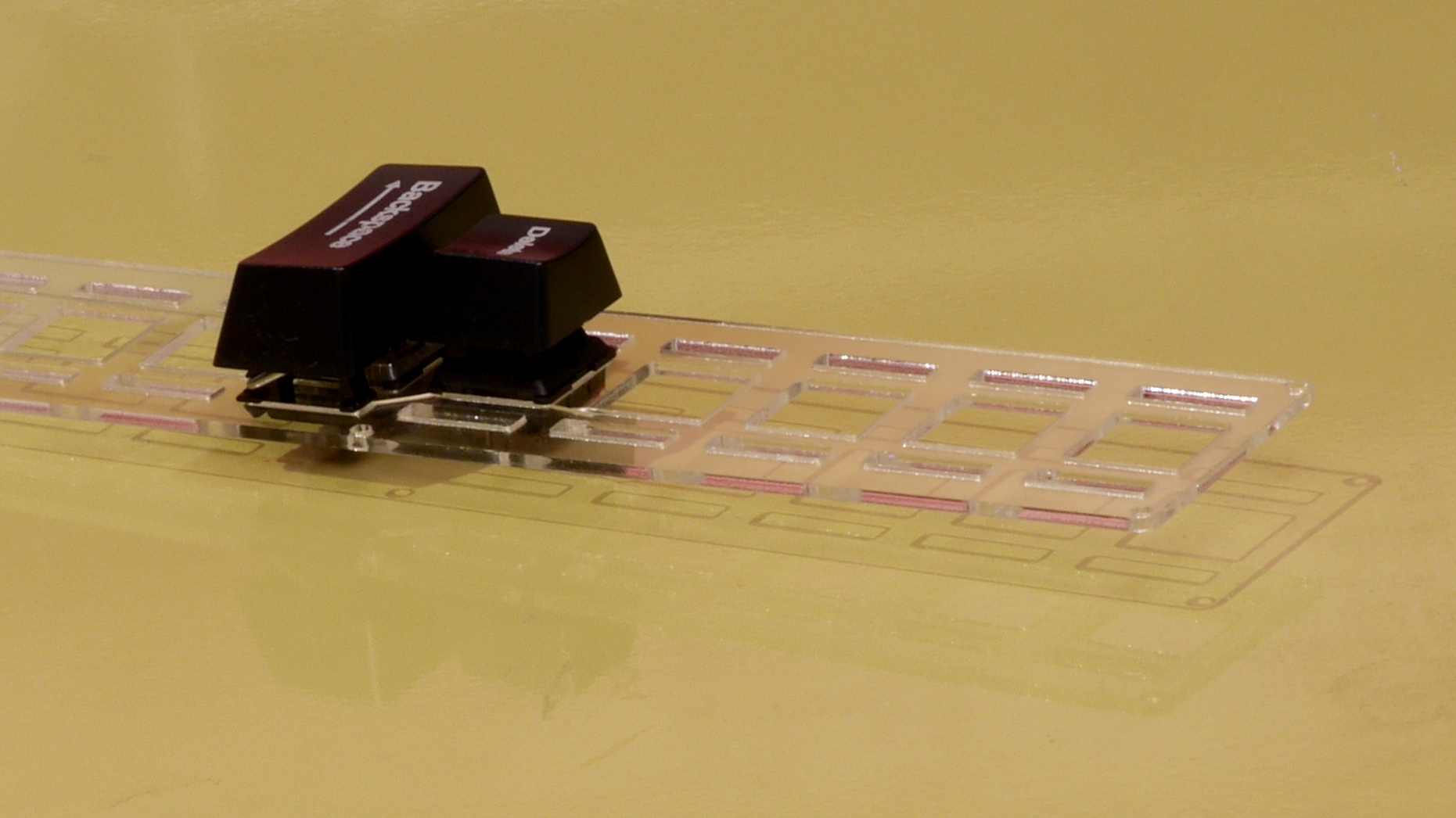

Here is an approach to thick acrylic backplates that turned up on Reddit using the laser cutter to engrave the shapes rather than a router to rout them.

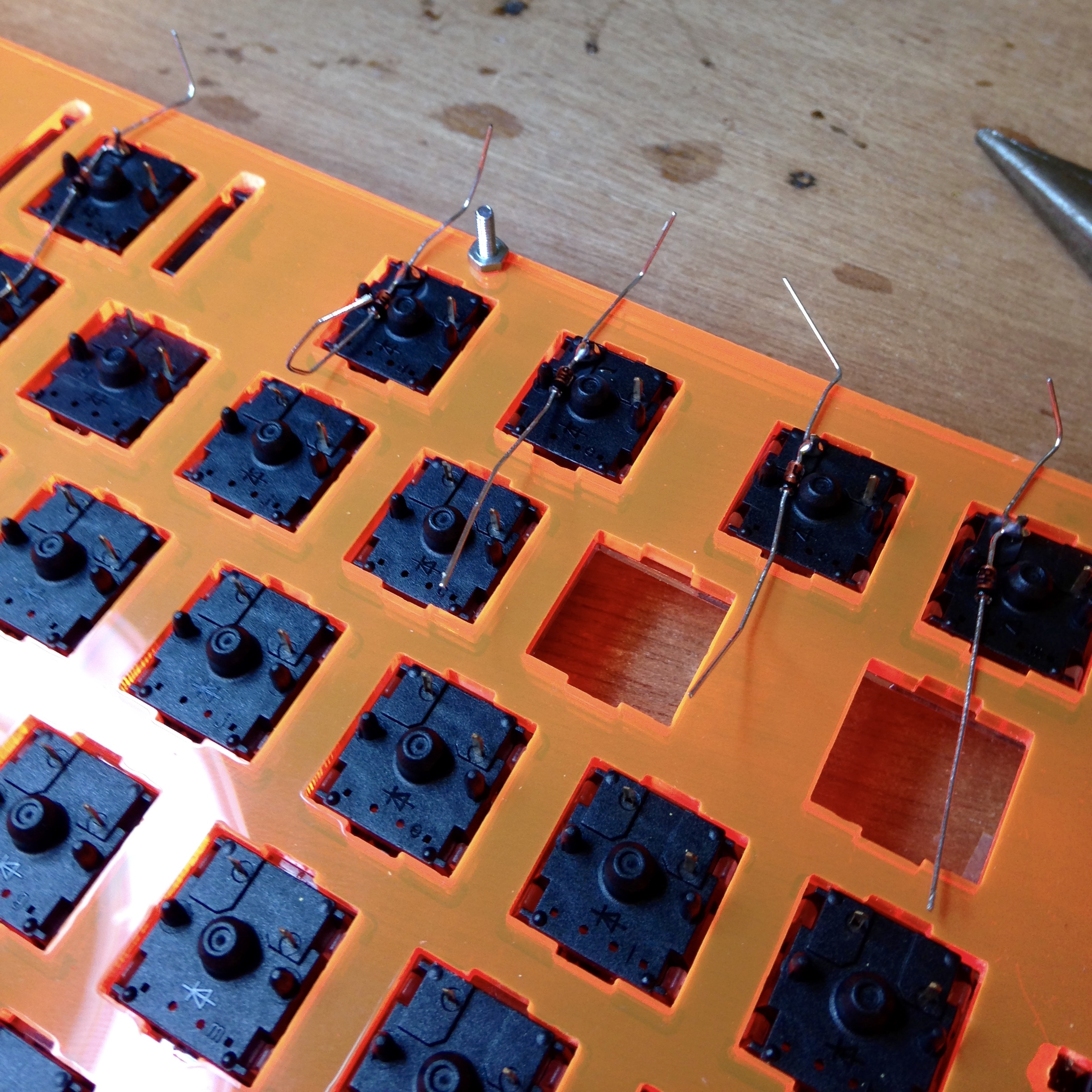

Started soldering the diodes to the switches—first time with a soldering iron since I was a child—but the ease with which I am popping switches out makes me think I need to consider gluing them in after all.

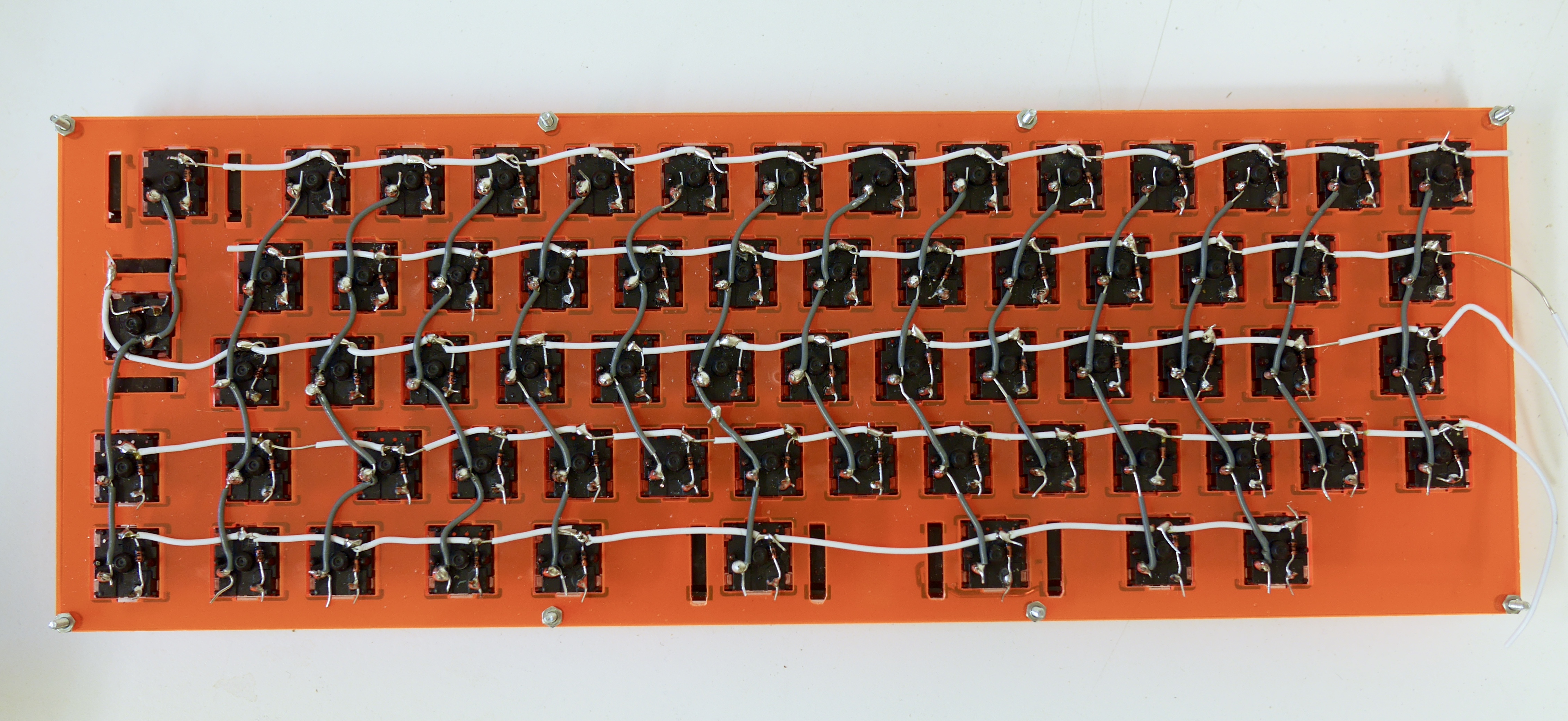

After several sessions in the Hackspace tronics room I have soldered on the diodes, row and column rails.
Lots of wires
Lots of wires
There is still the small matter of wiring these to the micro controller and programming it. Also the case needs some sides and a bottom—for which I need to work out how to have the right-sized niches in the case sides to support the controller board and USB plug.

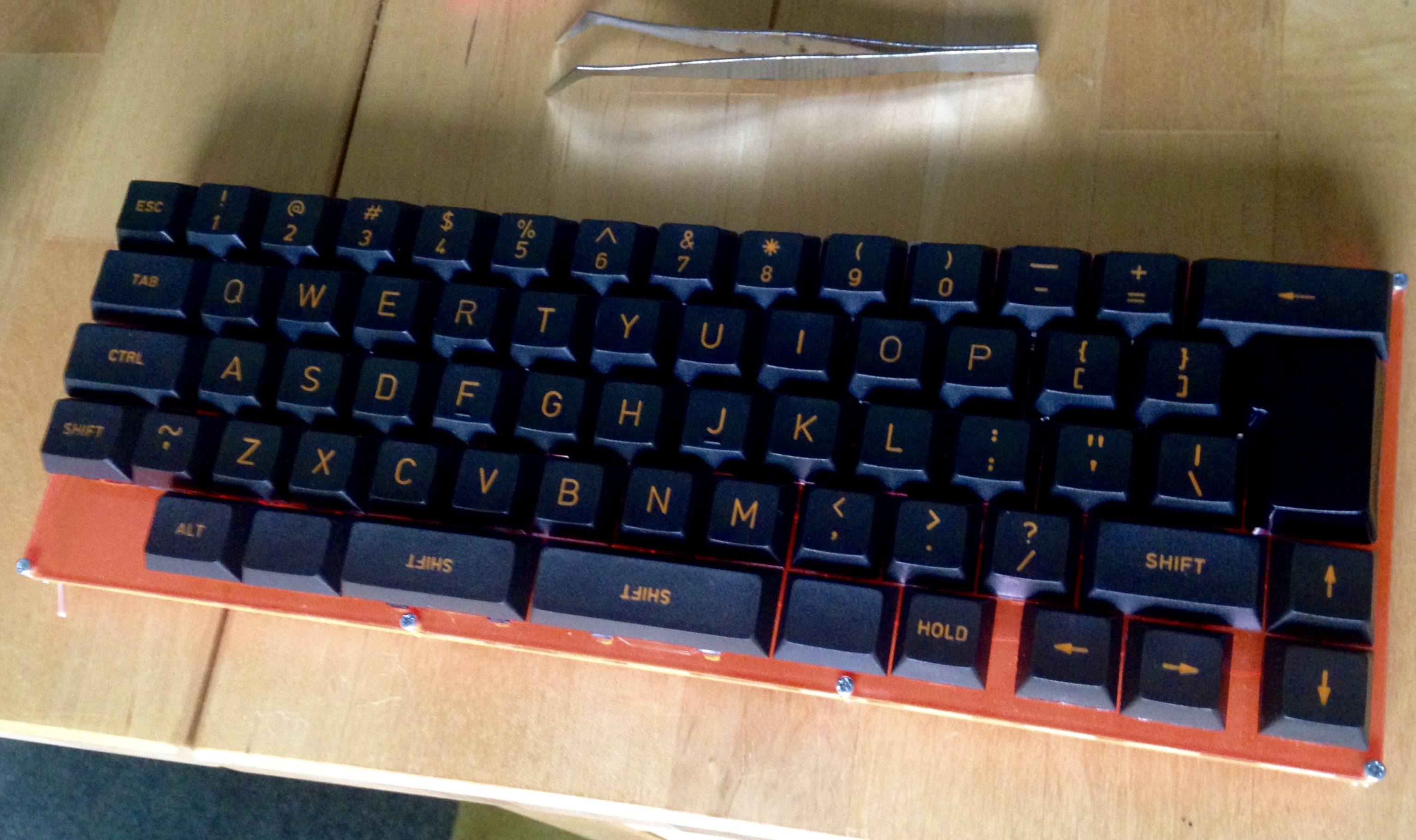

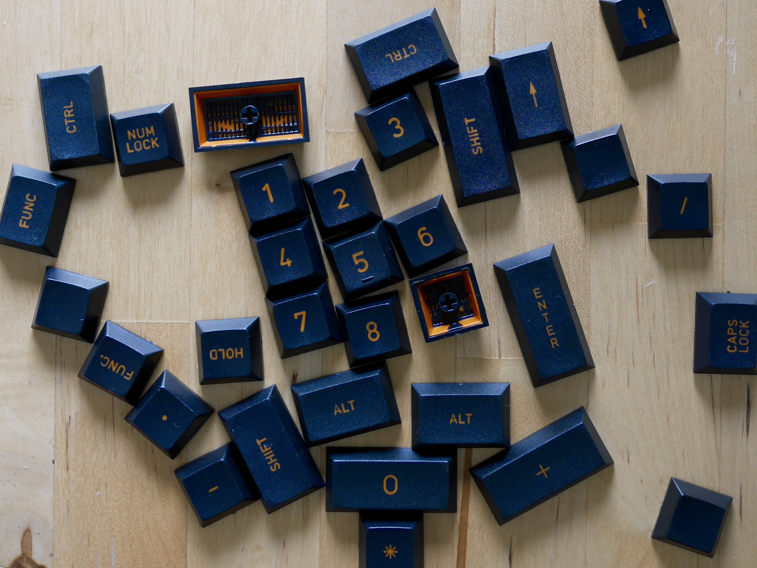

The keycaps from Devlin via UKKeycaps arrived this week.
Caps off
Caps off
After much fiddling with fiddly stabilisers I have populated my key switches and can pretend to type on my poor brainless keyboard.
Caps on
Caps on
Next task: make it a brain.

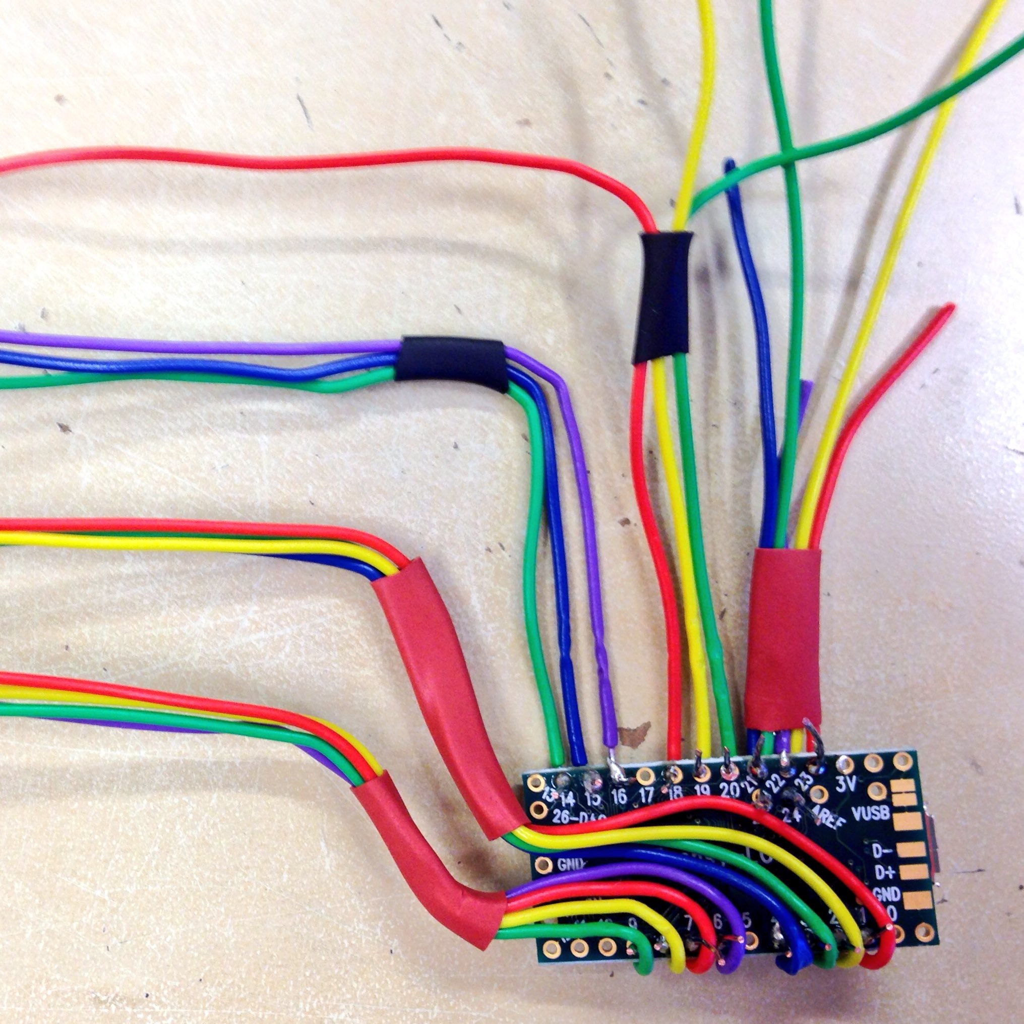

After procrastinating for a while I have soldered wires on to my Teensy LC board which I plan to solder to the rest of the keyboard next.
The combination of controller and wires is not as flat as I would like and so far it does not look like it will fit in the height of the case I had planned. Luckily I have not built that case yet so there will be time to change this if necessary, though I would like to keep the profile as low as possible.
