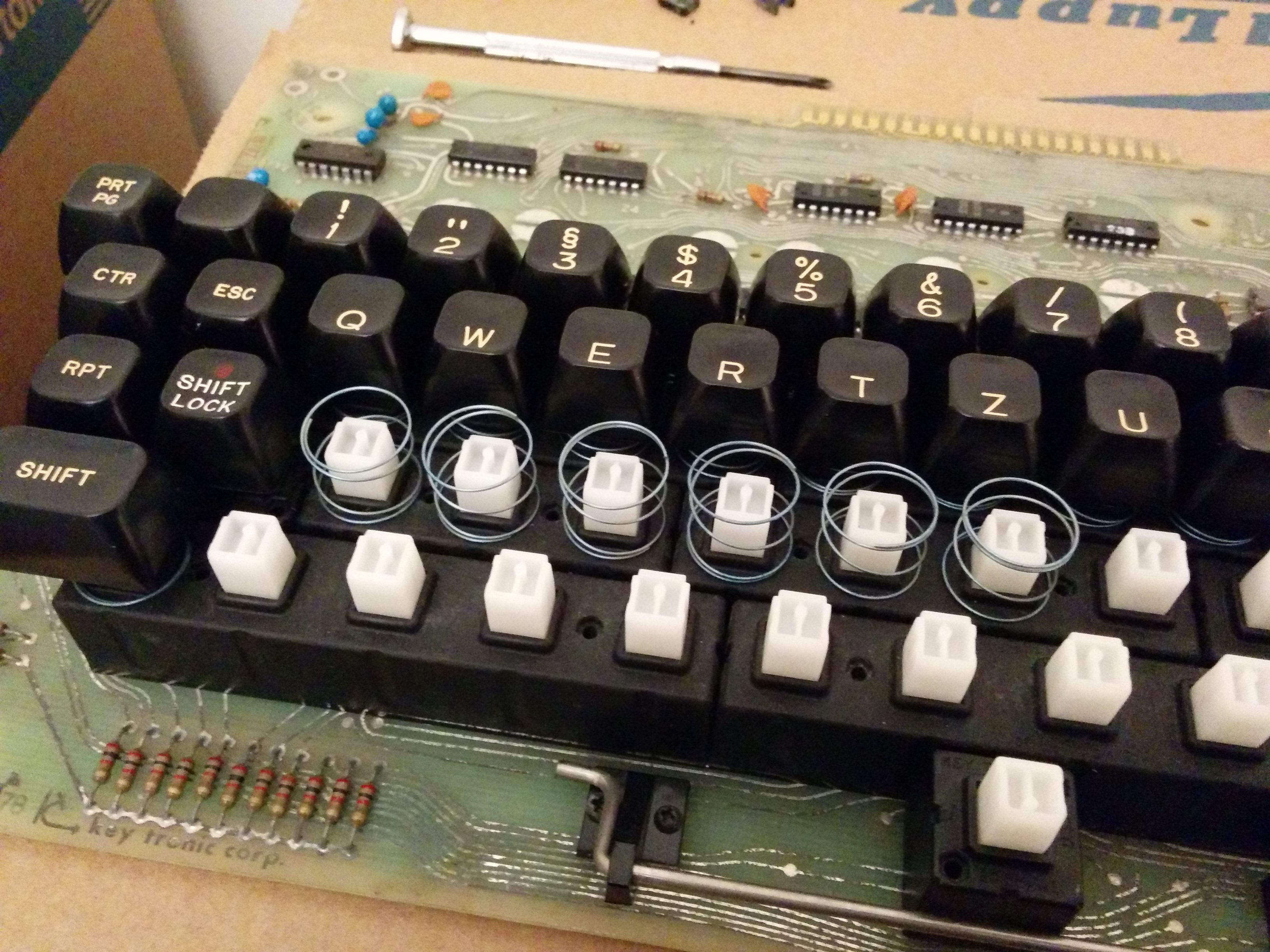

I only have one keyboard that fits that description, [wiki]Oriental Tech OK-100 series[/wiki] (OK-100M).
I don't really understand how the spring forces work, but it's progressive rate. It feels interesting (maybe lighter than MX Red), but it's absolute rubbish and totally unusable (stupid key weights, ghosting or transposition, and a key that gets stuck).
Other switches with a non-standard feel are [wiki]Tokai MM9 series[/wiki] (stepped progressive rate) and illuminated RAFI RS 76 M (progressive rate with knee). I have these switch types, but not in a keyboard.

Right, the "linear" ones in my old heavy Key Tronic aren't "linear" in the sense I would call them linear but I don't know what to call them. One of those switches where a video might not do much good in conveying it either if you ask me, HaaTa's force gauge might help.
Daniel Beardsmore wrote: Progressive rate, I presume. Should be progressive rate with knee as there is a specific point where the foam starts contributing to the force.
Right. I have not typed on those for ages but if I recall the progressive rate is "delicate".
