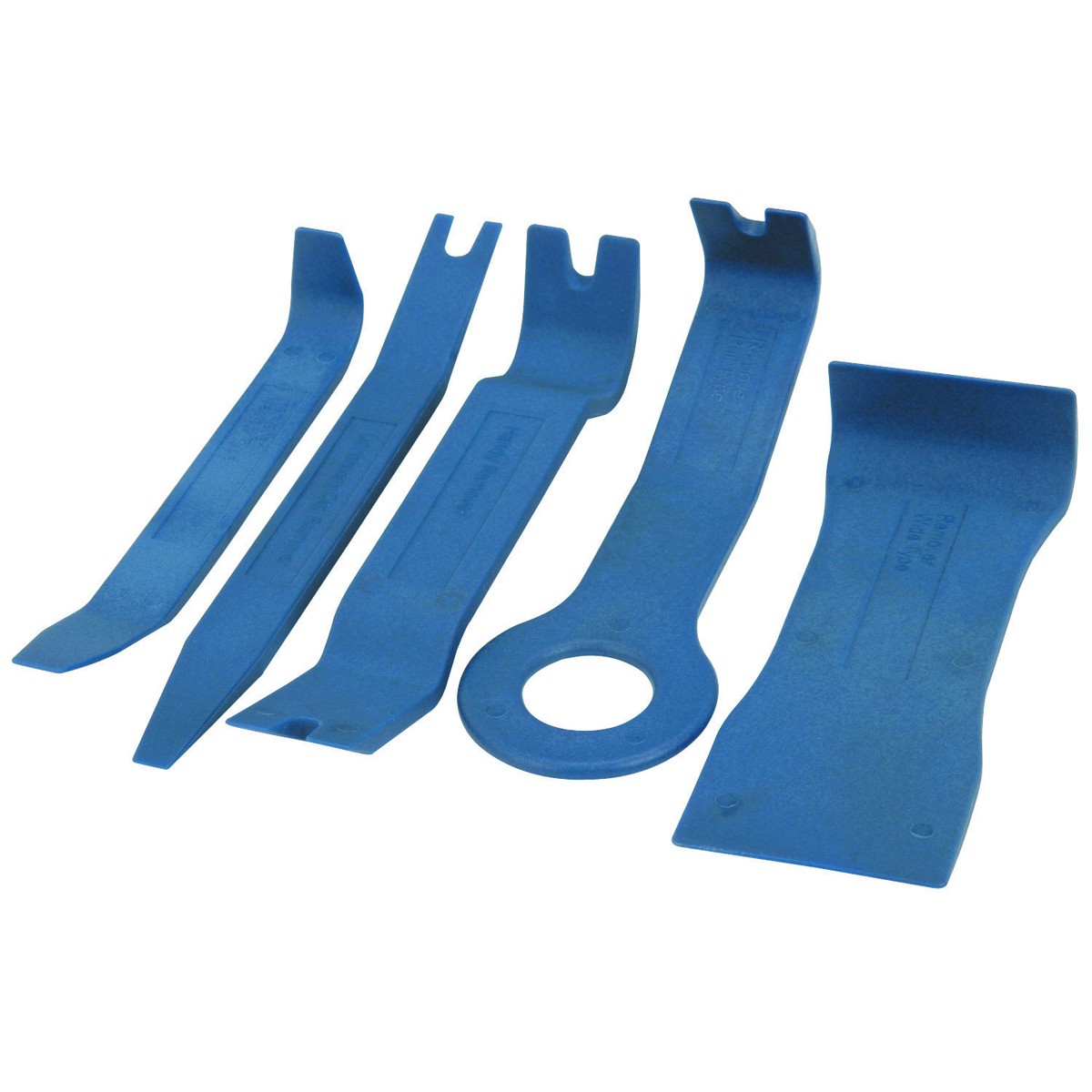

by XMIT
I'd get something like this: a nylon automotive trim tool set, something like $10 at a local import store:
https://www.harborfreight.com/5-piece-a ... 67021.html
The goal is to separate two pieces of plastic held together with plastic clips, without damaging the plastic. Metal tools damage plastic really easily. The same technique is needed for many Costar boards, the Novatouch, etc.
Nylon trim tools.
Nylon trim tools.
