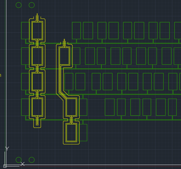

The goal here is just to recreate the PCB/pad card of the full-sized IBM 3277 but with an edge connector so it can accept slip-on Xwhatsit and CommonSense (hopefully at some point!) controllers. It's only relatively straightforward thanks to the previous work of wcass and i$ with the Xtant and FSSK/FEXT projects.
I plan to release all design files into the public domain once I have a working PCB.

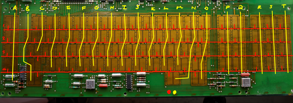

The proposed matrix:
The row and column arrangement of early beam spring keyboards are a little obtuse so this redesign will incorporate a layout similar to that of late beam springs and capacitive buckling spring keyboards.
Row and column pad measurements:
Any critiques or comments would be much appreciated!
Updates:
- 6/26/17: Initial drawing of top pads completed, updated row pad measurements: workshop-f7/xwhatsit-cs-compatible-ibm- ... ml#p377420
- 6/26/17: Added matrix spreadsheet screenshot.
- 6/30/17: Updated column pad measurements: workshop-f7/xwhatsit-cs-compatible-ibm- ... ml#p377924
- 7/2/17: Initial drawing of bottom pads completed: workshop-f7/xwhatsit-cs-compatible-ibm- ... ml#p378039
- 7/4/17: Updated key spacing measurements, again. Initial drawing of 30-pin edge connector completed: workshop-f7/xwhatsit-cs-compatible-ibm- ... ml#p378307
- 7/6/17: Initial trace routing completed: workshop-f7/xwhatsit-cs-compatible-ibm- ... ml#p378590
- 7/9/17: Ground fills added: workshop-f7/xwhatsit-cs-compatible-ibm- ... ml#p378821
- 7/12/17: Successfully imported 78-key PCB into Diptrace and exported to gerber files: workshop-f7/xwhatsit-cs-compatible-ibm- ... ml#p379133
- 7/12/17: Initial drawing of 66-key PCB completed: workshop-f7/xwhatsit-cs-compatible-ibm- ... ml#p379134
- 7/13/17: Final adjustments to Rev. 1 of 78-key PCB, order made: workshop-f7/xwhatsit-cs-compatible-ibm- ... ml#p379215
- 7/20/17: The 78-key PCB works!! workshop-f7/xwhatsit-cs-compatible-ibm- ... ml#p379976
- 7/30/17: 66-key PCB variants completed: workshop-f7/xwhatsit-cs-compatible-ibm- ... ml#p381145

Wcass gave me the measurements of your 5251 beam spring and I used some of those measurements for my CAD drawing.
There are enough owners of 78-key 3277s that I can run a GB for at least 5 PCBs through PCBWay or EasyEDA so finding people is not an issue. I was planning to take the risk of the PCBs not working myself; I would be happy to do things the other way around and produce the 78-key version first.
Also, one thing I need right now are measurements of the edge connector (of a 5251 ideally, since that has a contiguous connector I believe?) as well as its general distance from the top row of pads. That is the only thing I am pretty uncertain of (particularly in regards to an appropriate amount of ground fill) since I do not have a beam spring keyboard with detachable controller. If you or anyone else could provide those measurements I would greatly appreciate it!
Posted: 27 Jun 2017, 03:45
by emdude
I have completed an initial drawing for the top row pads as well as the bolt holes and attached a full-sized SVG and PDF. If anyone with a 3277 would like to print out and test the drawing, I would appreciate the extra feedback.
I also updated the row/column key spacing, using a 19.125mm spacing now. This should be pretty close or it, but a more accurate measurement would be great.
A note that I forgot to add to the OP: Once I get a working PCB made, I plan to release the design files into the public domain.

emdude wrote: I have completed an initial drawing for the top row pads as well as the bolt holes and attached a full-sized SVG and PDF. If anyone with a 3277 would like to print out and test the drawing, I would appreciate the extra feedback.
This is remarkable. I printed the pdf and the holes and pads line perfectly with my pcb. Great work! 8-)

Small update: I don't think the column "shield" should be overlapping the row pads, at least from what I can tell from other beam spring and capacitive buckling spring keyboards... Might lead to unwanted capacitive coupling or something (not an EE, clearly)? May have to take another look at the column pad measurements.
EDIT: Ah, I think I see now that the purpose of the shield/guard is to prevent that. I'll probably change the width of the ground trace to be safe.

Finally got some time from work to clean up my split space 3277. I took some photos and hope to comment on the documentation on a separate post. Here are some relevant photos that may help in the PCB design. Please excuse that fact that I do not have any calipers for fine measurements, but please let me know if you need more details and I am happy to take some more in case you need it.
edit: I will sort my photos soon so apologies for the mess in the album.
Posted: 01 Jul 2017, 11:36
by emdude
Thanks a bunch for the photos!! Very interesting that this version of the PCB features not one, but three extra pads! Makes me wonder what the other variants of the 3277 look like. :)
Fortunately, from a glance, it seems that set of four pads appear to be spaced 1u apart, so placing them will not be difficult. I will work on a new version and post it this weekend; when I do, please print it out and compare it with your PCB!
It looks like I'll have two extra pads that I'll have to do something about. I could try to fit one into B1 but that might require rethinking the matrix or trying to finagle a sense line around pads to reach that area, this would probably lead me to squeeze two traces in the same row--would probably lead to crosstalk (wouldn't mean the PCB would not work, but I'd like to avoid it), from what I've read from previous projects. I'll probably assign two pairs of pads to the same key for two keys.
Also, I've taken some time to look at a PCB from a 5291 Bigfoot that I trashed some time ago. I've updated the column pad measurements with what I got from that. I'll be using this, going forward:

emdude: Yeah I was totally surprised but the amount of extra pads there. I wonder what other permutations of the bottom row were released on the 3277. As for the spacing, it does look like the are spaced apart by 1u increments there. And it looks like the 0 key is actuated on the second pad from the right in the cluster of 4. I am more than happy to print it out to see if it fits. So excited to have this board in working condition.
Slom: more than happy to provide the entire album. I was pleasantly surprised at how clean everything was under the contamination film. Barely any rust at all. I am sorting all the photos out since I took quite a lot. And that imgur tends to unsort it. Will keep you posted! :)

@ipreferpie, here's a 1:1 scale PDF of the new PCB. I think we've hit a snag; it appears that the distance between the Enter key pad and the rightmost pad of the set of four is smaller than on the full-sized 3277.
This might be a problem, I'll need to see more pictures/measurements of another 66-key 3277 at some point.

No, the photos with your industrial ruler look fine. Please check the PCB with a printout of the PDF when you can though. It seems that the distance between the two pads differ by at least a millimeter. Based on my PCB, the center-to-center distance should be 35mm.
Depending on whether the other 66-key 3277s share the same pad placement, I may have to make the 66-key PCB a separate, modified design. I was really hoping that this PCB would be "universal", as far as pad placement was concerned. For now, I've omitted those extra pads for the 78-key PCB.
Anyhow, I've more or less finished the column pads. I'll check a few things and then move on to completing the rest of the drawing, including the edge connector, ground fill, etc. Note that I've added a calibration pad at matrix location B1. My understanding is that this pad should help the Xwhatsit auto-set the voltage threshold. Pics of the columns alone and w/ rows:
Getting there...

A small update: I tested the PCB measurements with more printouts and discovered I was in error in regards to the key spacing. The 19mm measurement that wcass provided me is the most accurate one. I have corrected the horizontal and vertical key spacing and uploaded a PDF. If you guys could print it out and test it against your PCB again, I would greatly appreciate it. The hole and column pad placement has been adjusted to match.
The PDF also includes a drawing for the 30-pin edge connector that is just floating above the pads. That is not the final placement, of course, just had it in there to compare to the edge connector on my Model F PCB. It looks fine, but feel free to check that too.
If anyone is curious about how I'm testing these drawings - I print them on vellum paper and overlay them on the switch mounting plate as well as the PCB.
