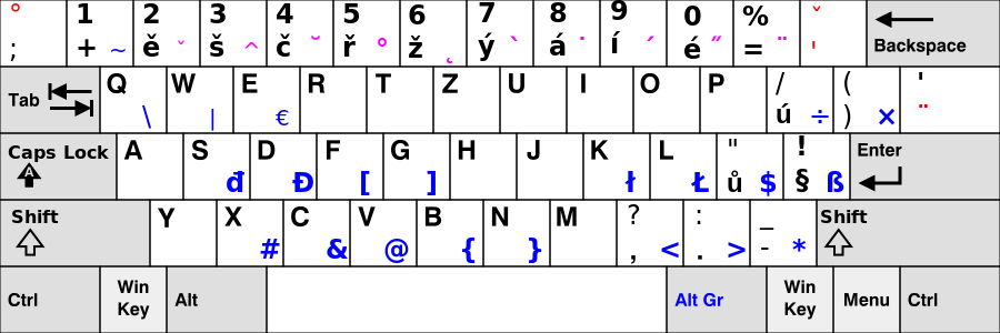

E3E wrote: Oh, beautiful! I've never seen an AT101 with sub legends before. I'm really liking this one. It's interesting that it has an ANSI configuration but suited for typing in Derman. ANSI DE? That's pretty awesome.
Thanks, it's not a German layout that's for sure. I think it's some varaint of Czech QWERTZ:
https://en.wikipedia.org/wiki/QWERTZ
- Keyboard_layout_Czech.svg.png (32.38 KiB) Viewed 10529 times

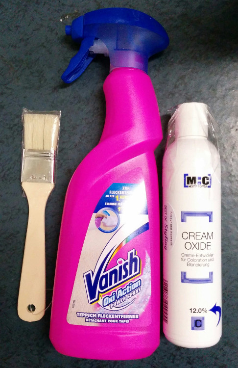

E3E wrote: I've used liquid H2O2 + Distilled Water + Liquid Oxygen bleach to thin out the creme.
I'll try that thanks. I've invested in some retrobright materials but stil need to get some more supplies to get setup in the bath properly:
- IMG_20170721_185400.jpg (664.79 KiB) Viewed 10409 times

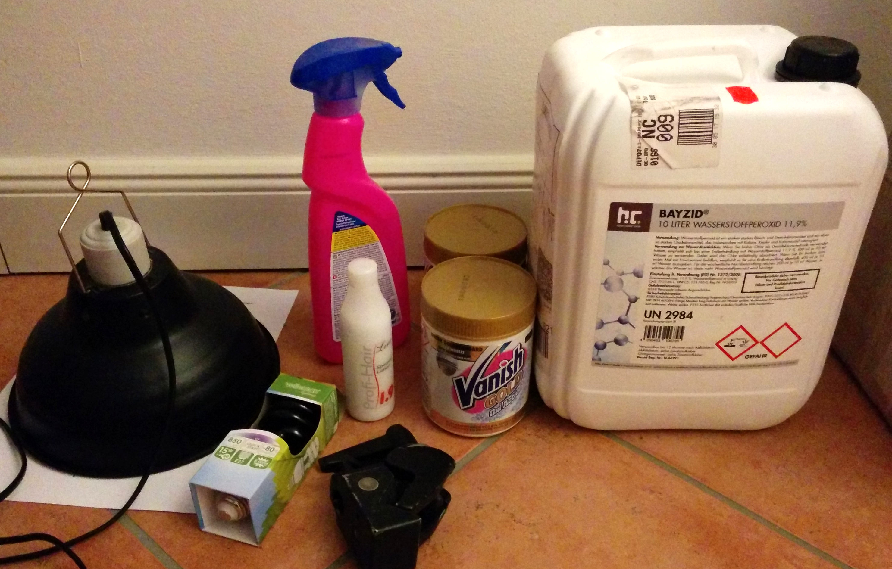

I've had good experiences with this cream but I never tried the powder sofar:
- IMG_20160420_193133.jpg (125.26 KiB) Viewed 10409 times
