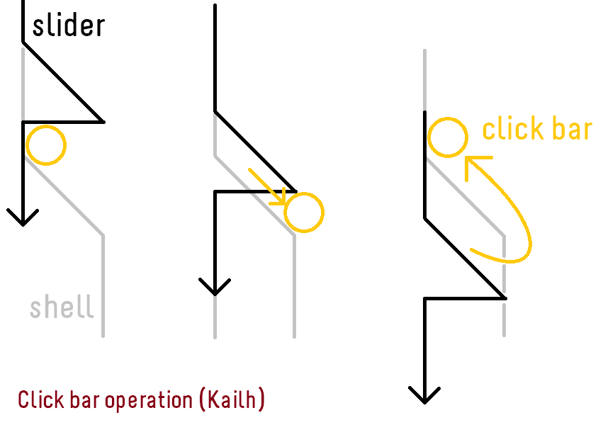

I looked at the cam that operates the click bar and I did wonder how it could possibly be that shape. Now I finally understand: there's a ramp on the shell that pushes the click bar outwards around the cam so that it can snap back up to the top.
Click bar operation.png (16.7 KiB) Viewed 15832 times
Hence the unidirectional cam on the slider: the slider provides the shift cam for upstroke but on the downstroke the shell is used.
Quite ingenious actually. It will be interesting to see how this holds up long-term, as it's always good to see genuine innovation. Maybe not perfect, but a good start. Indeed the click bar could do with being a bit thicker — that heavy clicker, light return spring balance is in part what makes blue Alps so good (the longer lead-in also helps).
