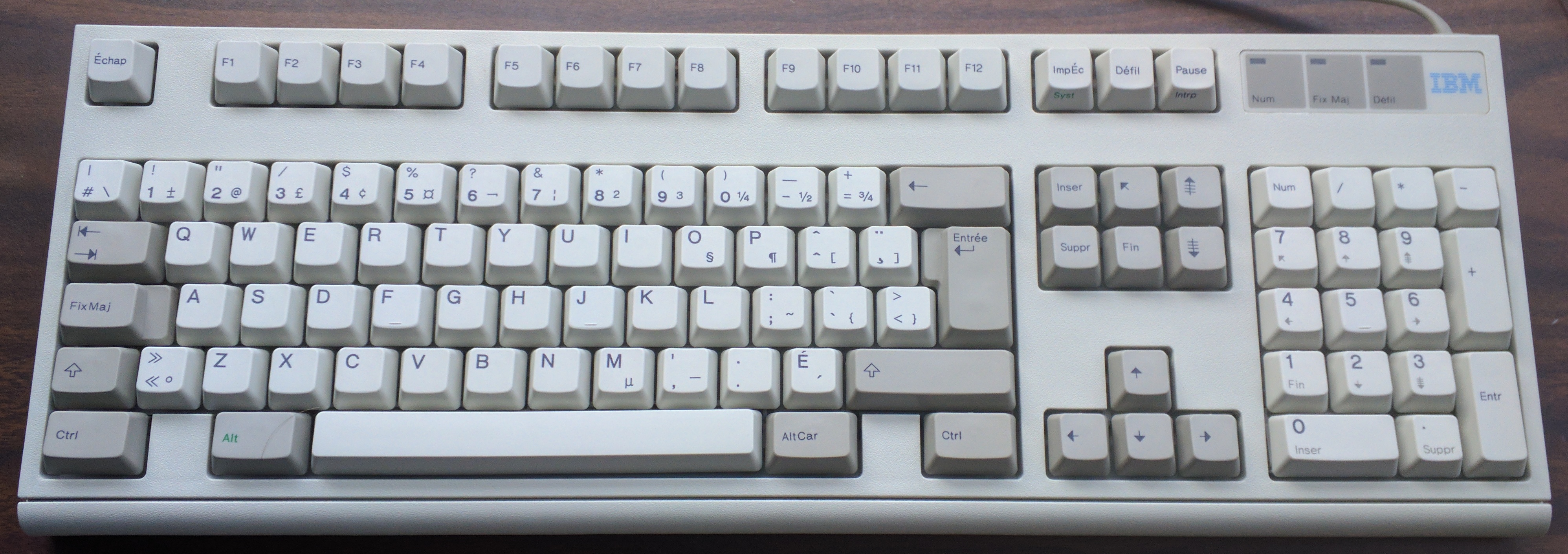

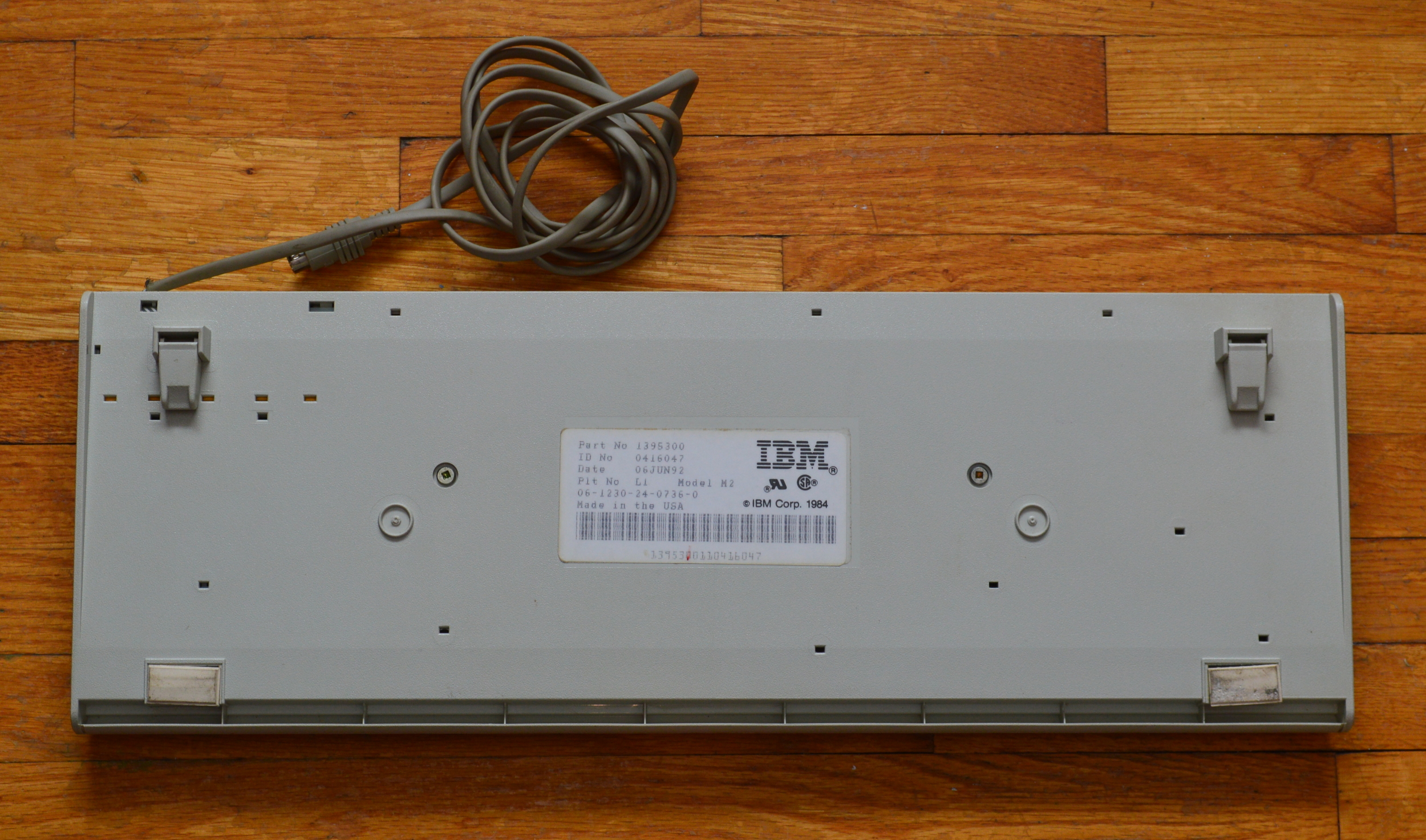

Front and back shots
The keyboard was dirty as hell.

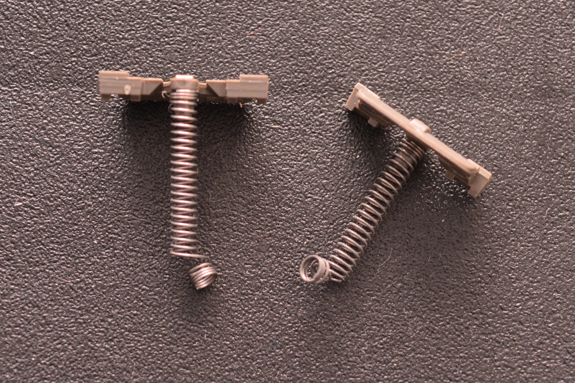

Two springs are stretched

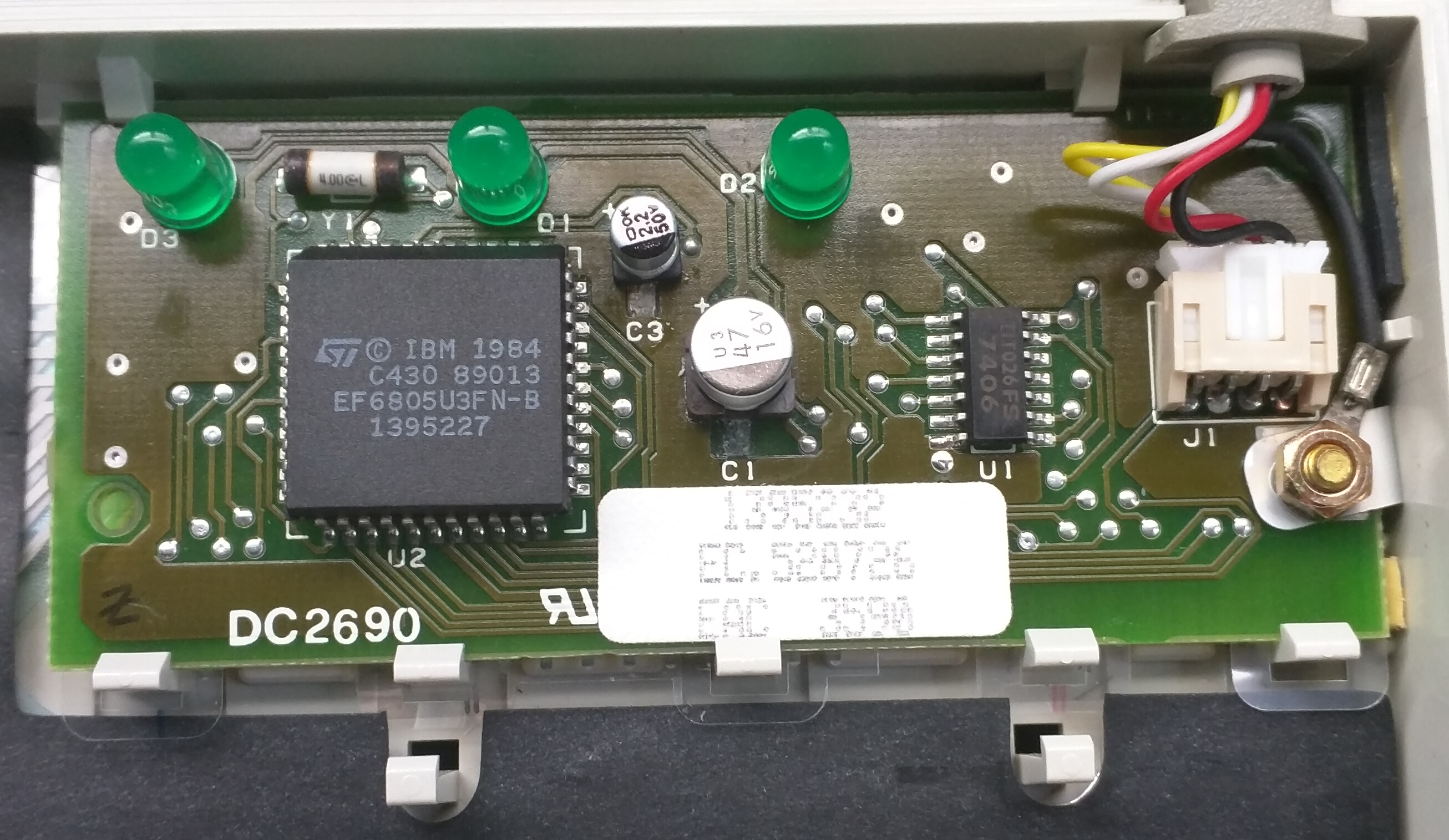

And of course, the capacitors on the PCB need to be replaced (C1 and C3)

There are a total of 13 on the keyboard and 5 of those are broken.
The top case was still firmly attached to the bottom case so I'm wondering if I should replace them or not.
If I do, some kind of bolt mod is a better idea than trying to put back the original tabs (with crazy glue, hot glue, melting the plastic around, ...)
The holes in the bottom case are not aligned with the ones in the top case but this can be fixed.
Obviously I am not touching the broken tab in the middle of the keyboard because it is right above the precious label. :D

Fixing the capacitors
I replaced the two faulty capacitors.
  • C1 requires a 47uF 16v capacitor.
  • C3 requires a 2.2uF 50v capacitor.
Removed the old capacitors
I simply pulled the capacitors with pliers while applying heat to the pads and they easily came off.
The polarity of each capacitor is clearly indicated on the PCB (the + sign for the anode) so it difficult to make a mistake when installing the new ones.
Soldered the new capacitors
That's not the best soldering job but it will do.
I plugged the keyboard and pressed on the matrix membranes and it works!

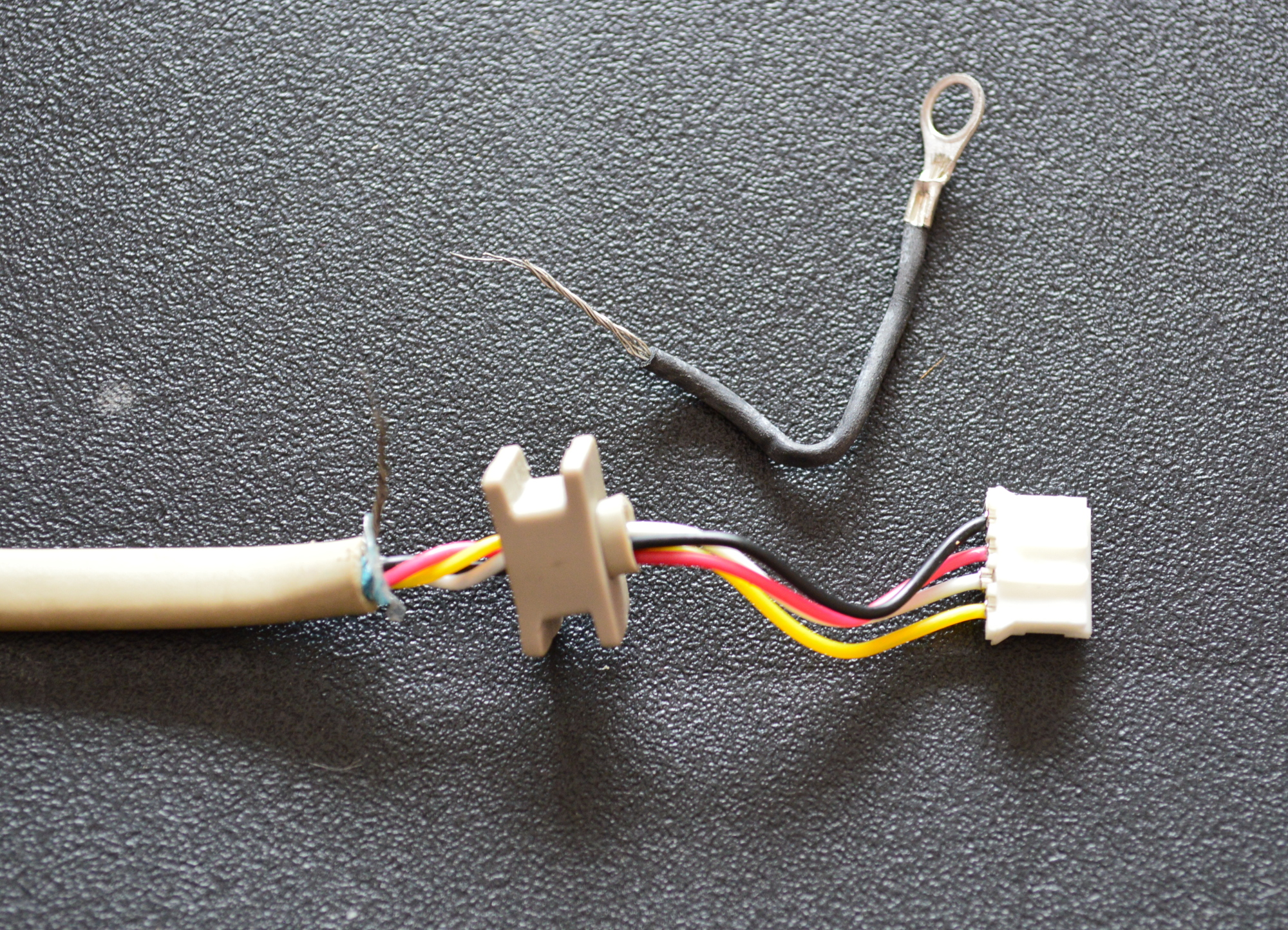

Fixing the cable
How it looks like before the fix
Close up on the issues
As you can see:
  • The ground cable is cut in half.
  • Part of the cable sleeve is stuck in the holder.
Cleaning the holder... oops.

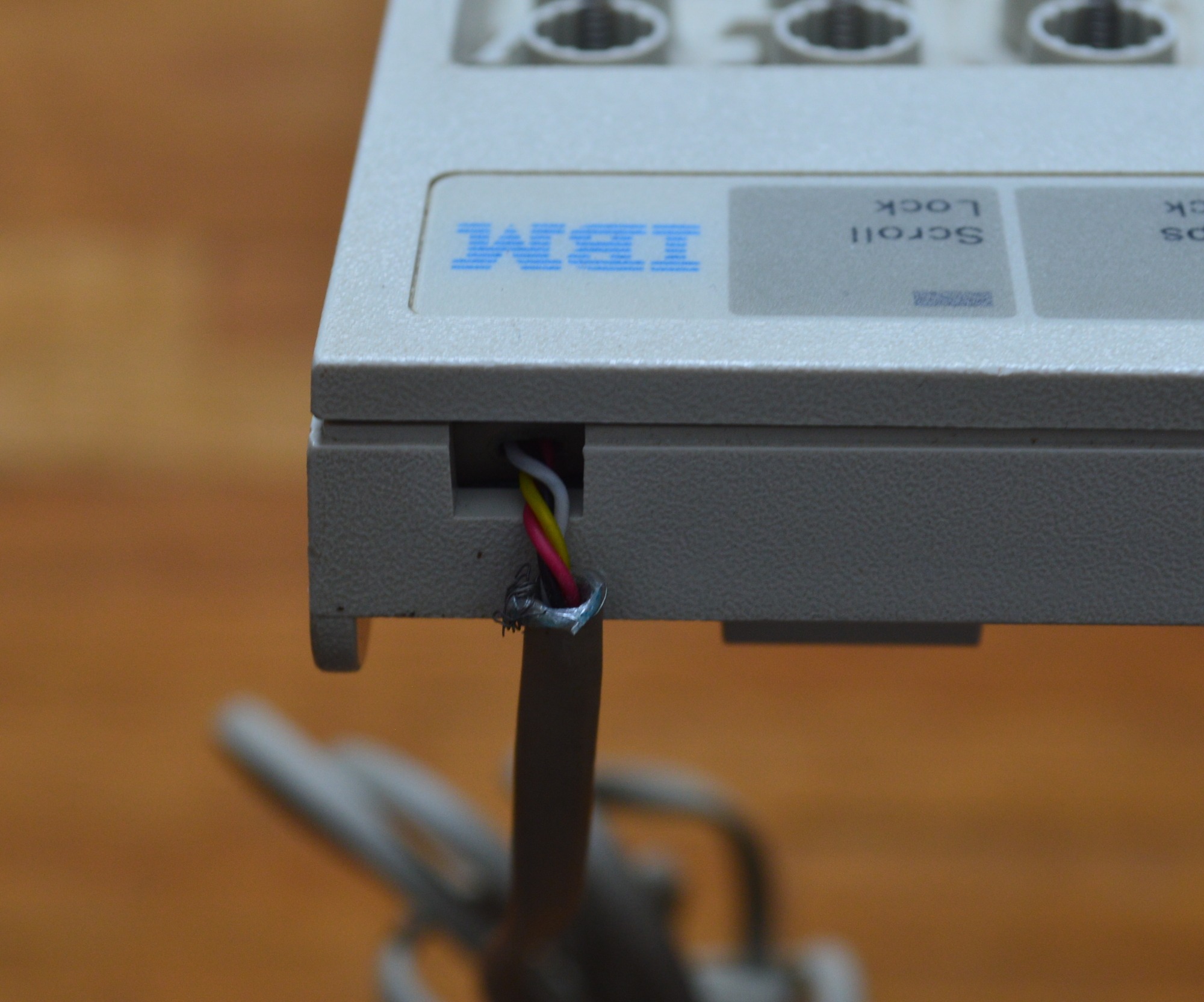

I made a cut in the holder (is it the proper name of this thing by the way?) because for a moment I thought the holder was simply not large enough to accomodate the cable sleeve.
That's when I realized a chunk of the cable sleeve was simply stuck inside it, so I removed it with an exacto.
Cable fixed!
  • I reattached the ground cable and added a shrinking tube to securize it.
  • I hot glued the holder onto the cable sleeve so it is more resistant to a pull on the cable.
Cable installed on the PCB

Fixing the springs
I won't be able to fix the springs and I will need to replace them.
Unfortunately I don't have spare ones so my temporary solution is to move those springs to the Scroll Lock and Pause keys that I never use. :(
Wrapping up for now
Until I find replacements for the springs, I decided to close the keyboard.
Closing the M2 by putting the springs in the top case
