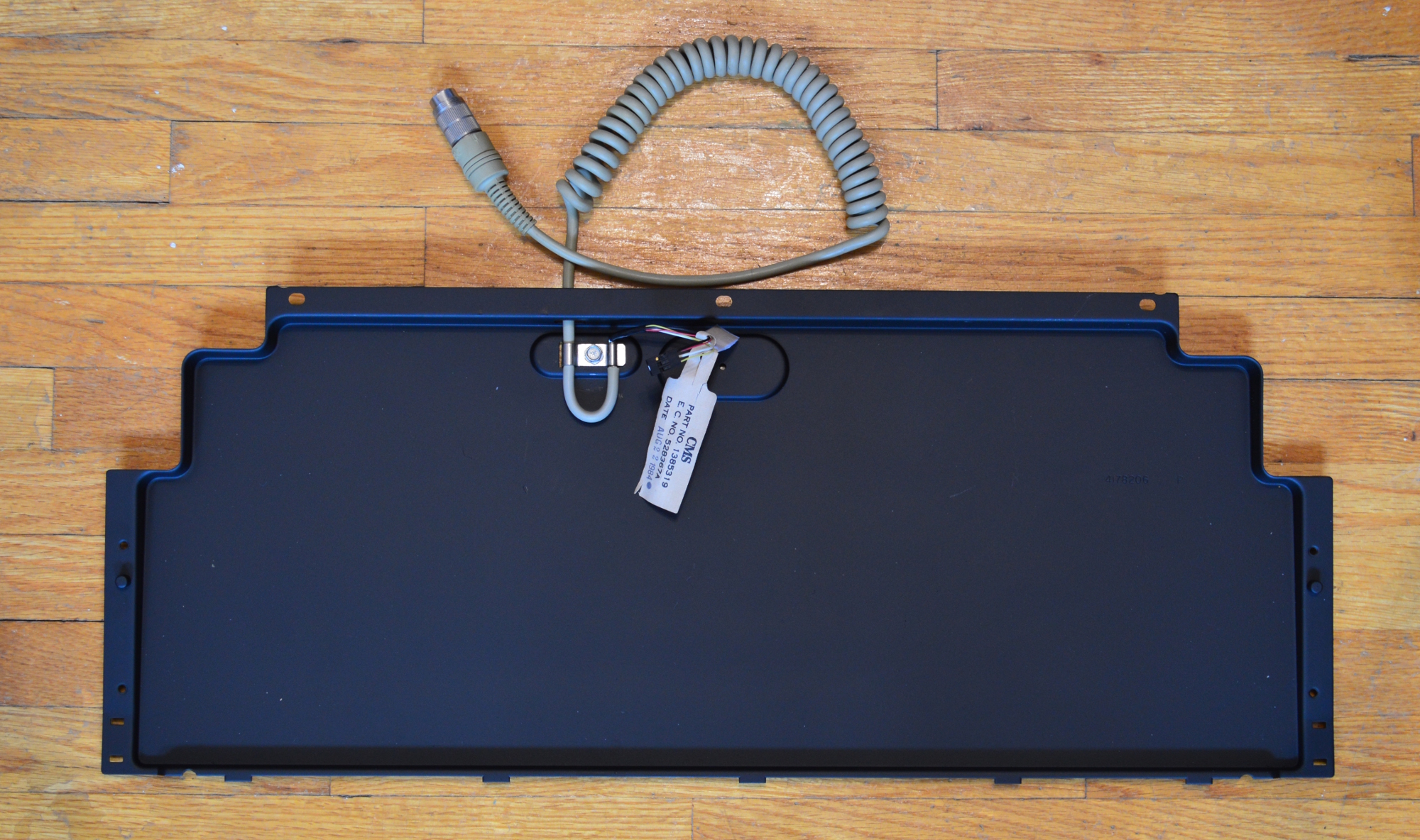

De-rusted and painted the inside of the back plate
No before picture, unfortunately. I applied 3 layers of Tremclad flat black rust paint after removing the rust with a dremel. BTW, Tremclad is another brand of Rustoleum.

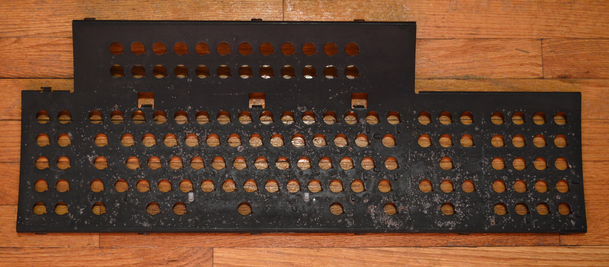

Rusted barrel plate

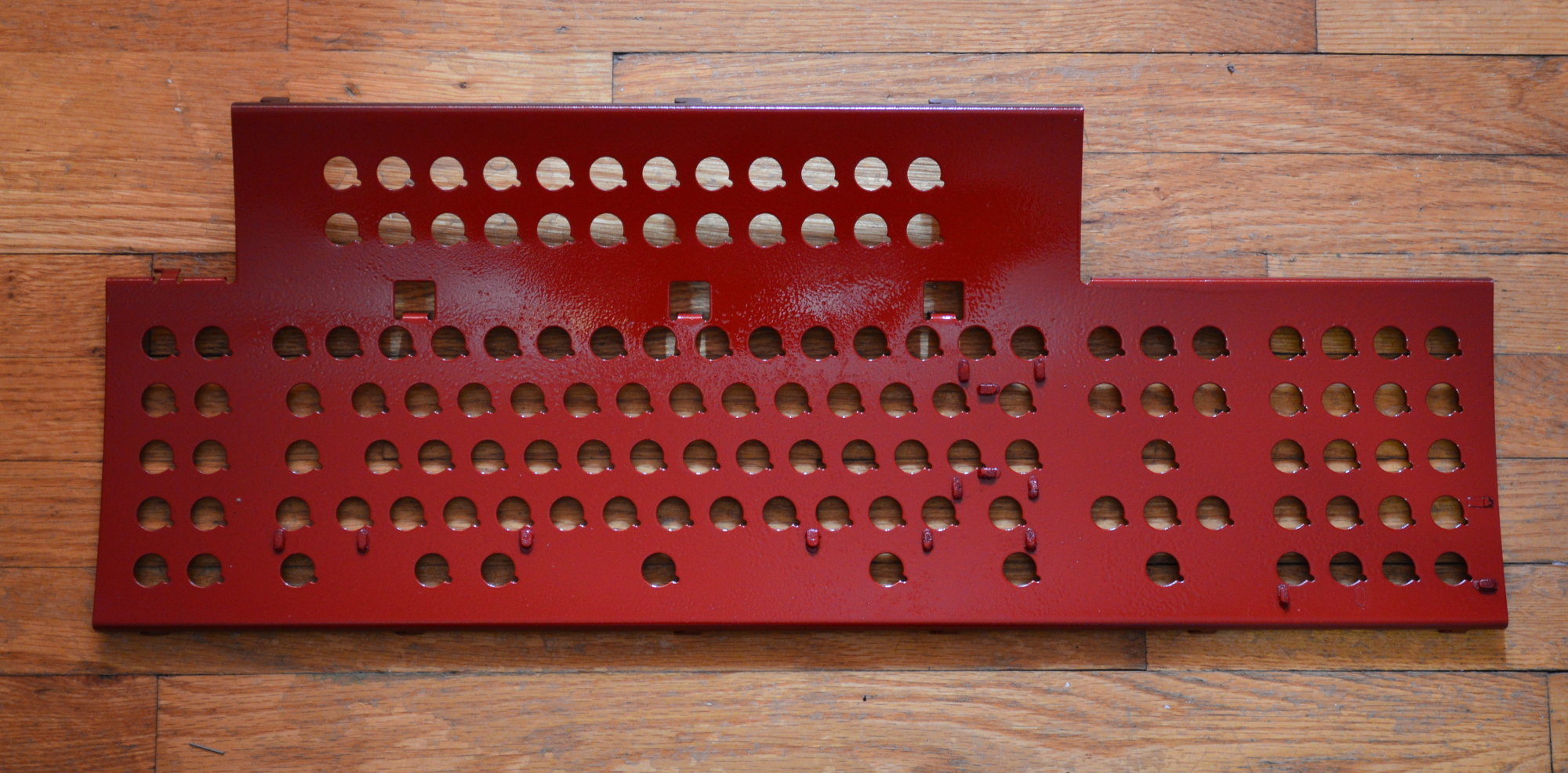

De-rusted and painted the barrel plate
Same job as the back plate but this time I applied 3 layers of Tremclad regal red rust paint. I wanted to give it a little red selectric vibe but as you will see, it doesn't matter, you can barely see the barrel plate with the top cover on.

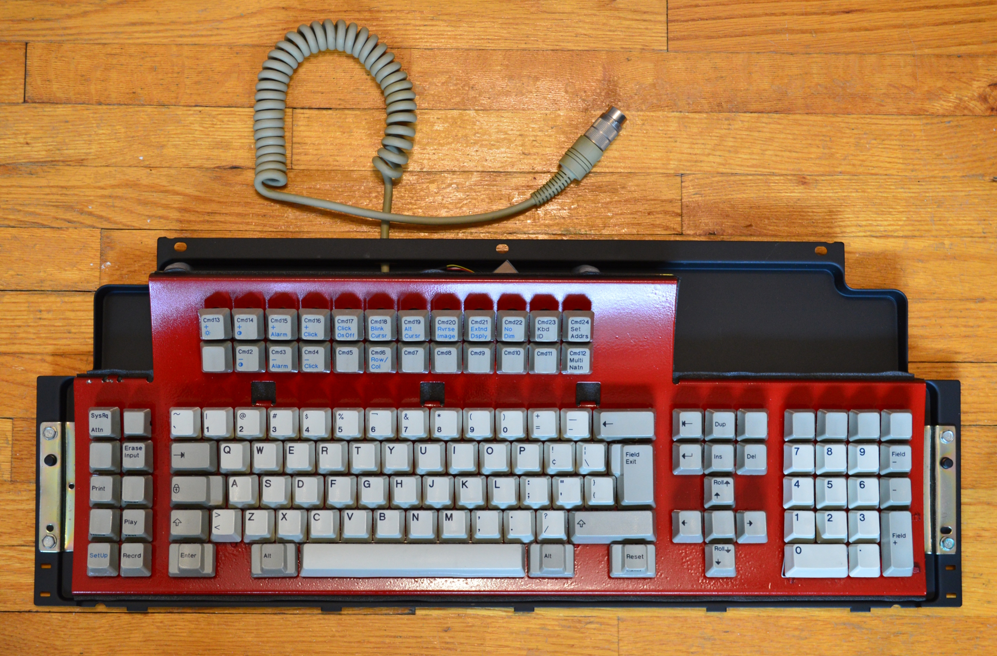

Mostly assembled
Again, I lost most of the pictures but I cleaned every layer of this thing and I kept the original foam for now because it was in good condition. I chipped a little bit of the red paint along the way.

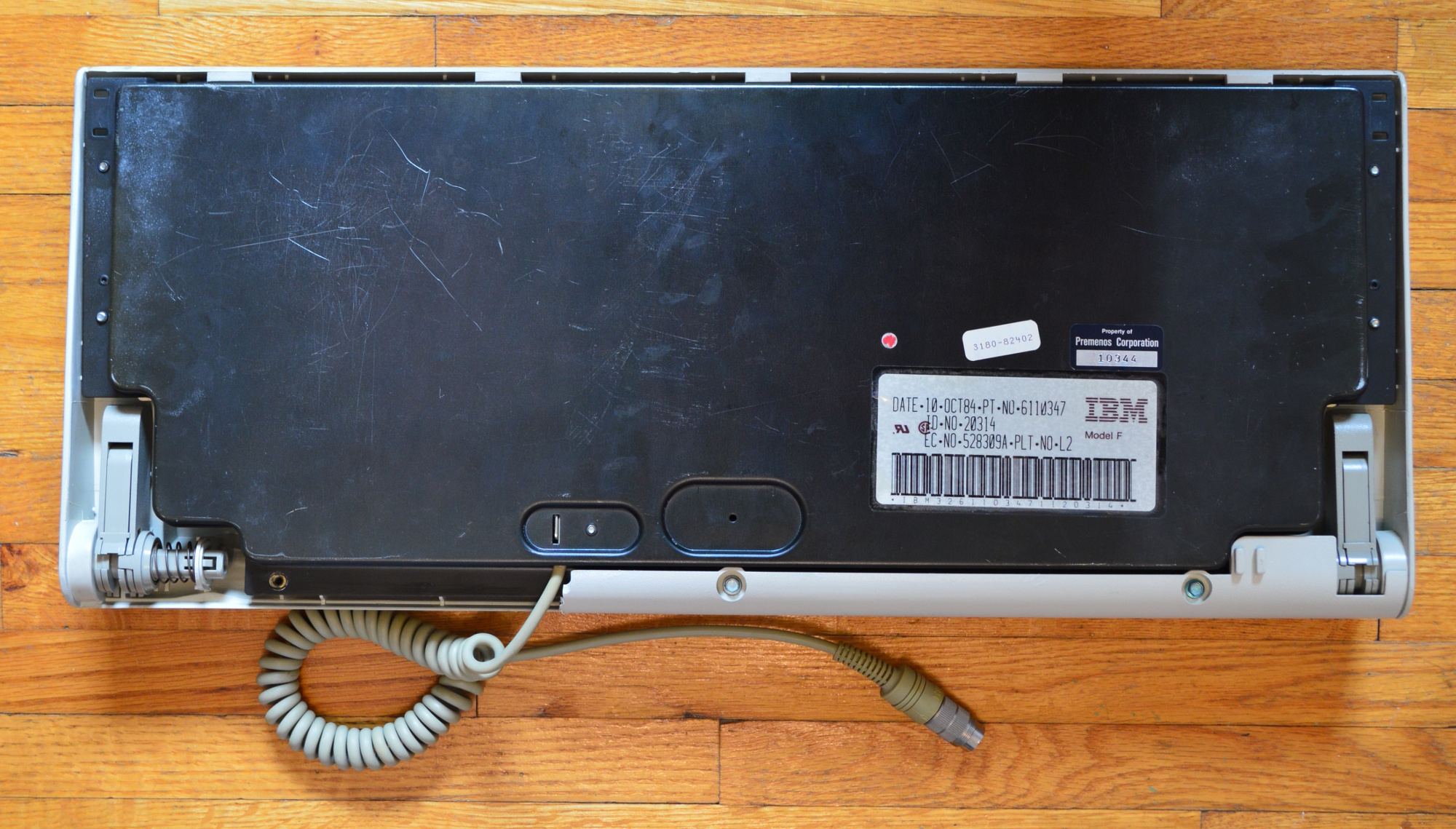

View of the back with the case on
I did not paint the exterior of the back plate but I feel like I should. However, I don't want to risk painting over the label.
Also, as you can see, there is a broken plastic part and a screw is missing.

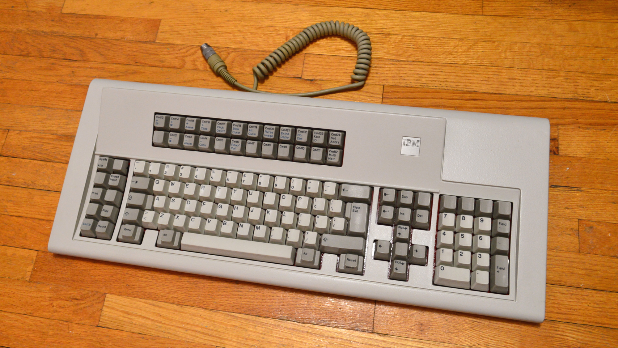

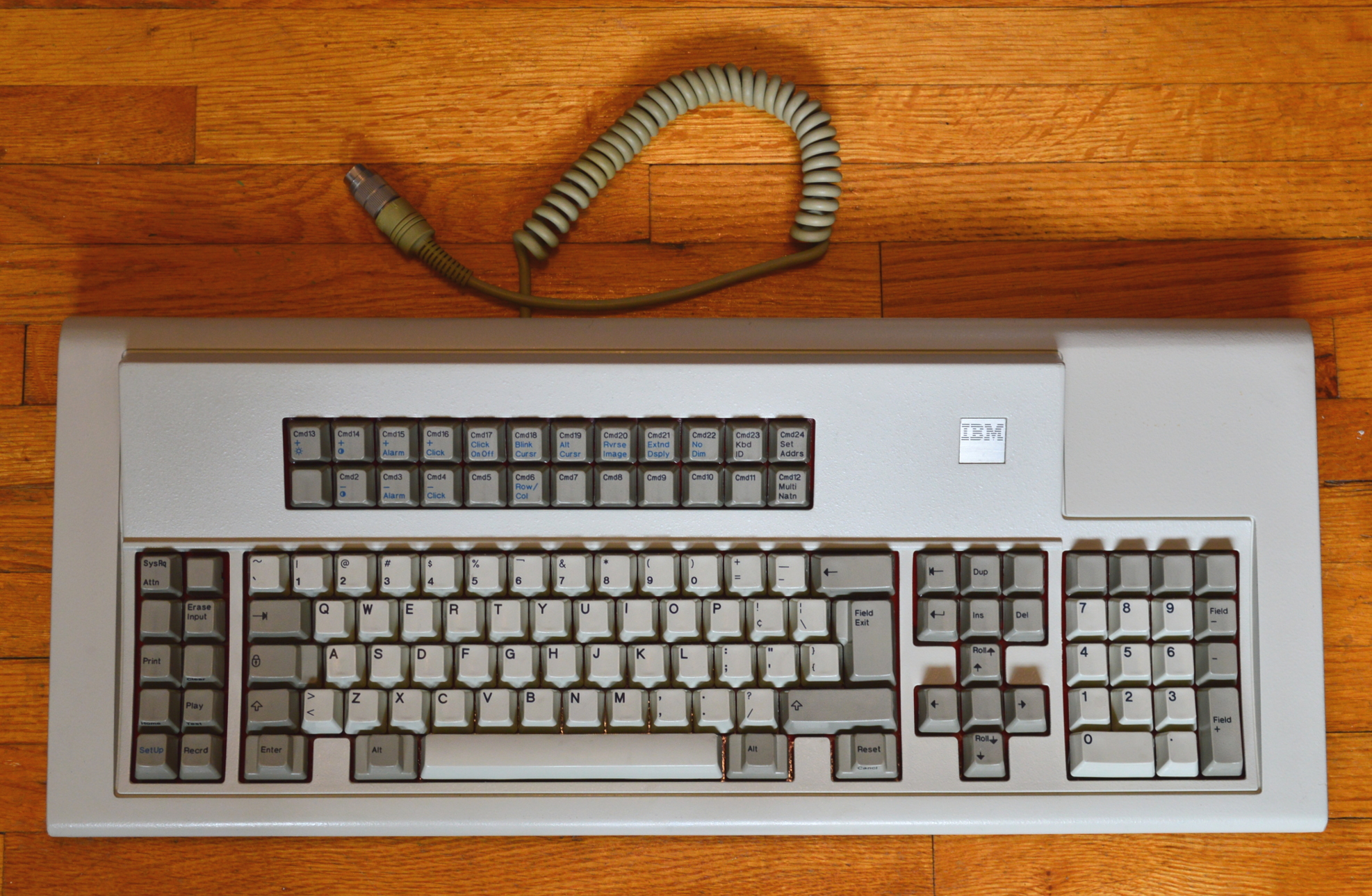

Glamour shot #1
Glamour shot #2
That's it! I am done with the keyboard for now but the restoration is not completed yet.

* Find a screw for the back plate.
* Find a replacement for the broken plastic bar. Does someone has a spare one?
* Find replacements for the broken plastic wire stabilizers on the barrel plate (good candidate for a 3D print job).
* Repaint the back plate if I find an effective way to cover the important parts (ex: label).

For the label, if you are set on removing it to paint the back, I'd suggest trying and remove it with some heat and a lot of careful efforts, but I'd practice on a Model M first since you only get one chance. The other option is just taking a lot of care to mask over it and spray in very thin coats so it doesn't wick under the masking tape. Or not painting it at all and leaving it stock.
I can't remember if the early M122's have the separate plastic bar there or not, but I'd suspect that that is specific to the F122 and it's going to be hens teeth to find. Kind of like back when F122s were nearly worthless if they didn't have spacebar because the only other spacebar that would fit was from another F122.
IIRC, those screws are different from a Model M as well, but it's been years since I opened my last remaining F122.
[Edit: yep. the M122's got a complete plastic bottom. You might be able to dremel out the plastic bit in the back, though]

Why would you want to remove the label? Ask elecplus if she has one of those plastic bars.

I'd assume it's going to be replaced after painting.

Cindy may well have one of those back splines. You can replace screws but the heads will probably be different, Philips-head is easiest. Fs have metal sleeve inserts and use machine screws, while Ms have screws that are more like wood screws with aggressive threads.
I have painted the backs using a mask made of clear plastic and clear plastic tape so that I could get it as small as possible and position it exactly.

Only thing I might have done differently on the restore is to take the plastic wire stabilizers out prior to painting and then put them back in once painted, but that's just a personal preference. Looks nice!

Aer Fixus wrote:The other option is just taking a lot of care to mask over it and spray in very thin coats so it doesn't wick under the masking tape.
Yes this is probably the only viable solution and not hard to accomplish / succeed.
I like your idea of taking the plastic bar on a M122 if I cannot find one for the F122.
seebart wrote:Ask elecplus if she has one of those plastic bars.
PM sent :)
orihalcon wrote:Only thing I might have done differently on the restore is to take the plastic wire stabilizers out prior to painting and then put them back in once painted
I totally forgot to talk about that in my post... I learned the hard way that those stabilizers are 1) made of plastic and 2) removable. So obviously I used my dremel on them and I succeed to break two or three. :oops:
I'll edit my post to add this in my TODO list, I must find some replacements. For now I am lucky enough that each key that requires a stabilizer have at least one plastic wire but that's not ideal.

Nice restore, j0d1. I also learned the hard way regarding the plastic stabilizers. After being informed of the fact that they were actually removable, I think I broke 2 or 3. Managed to salvage them with a few drops of epoxy or gorilla glue, something like that.

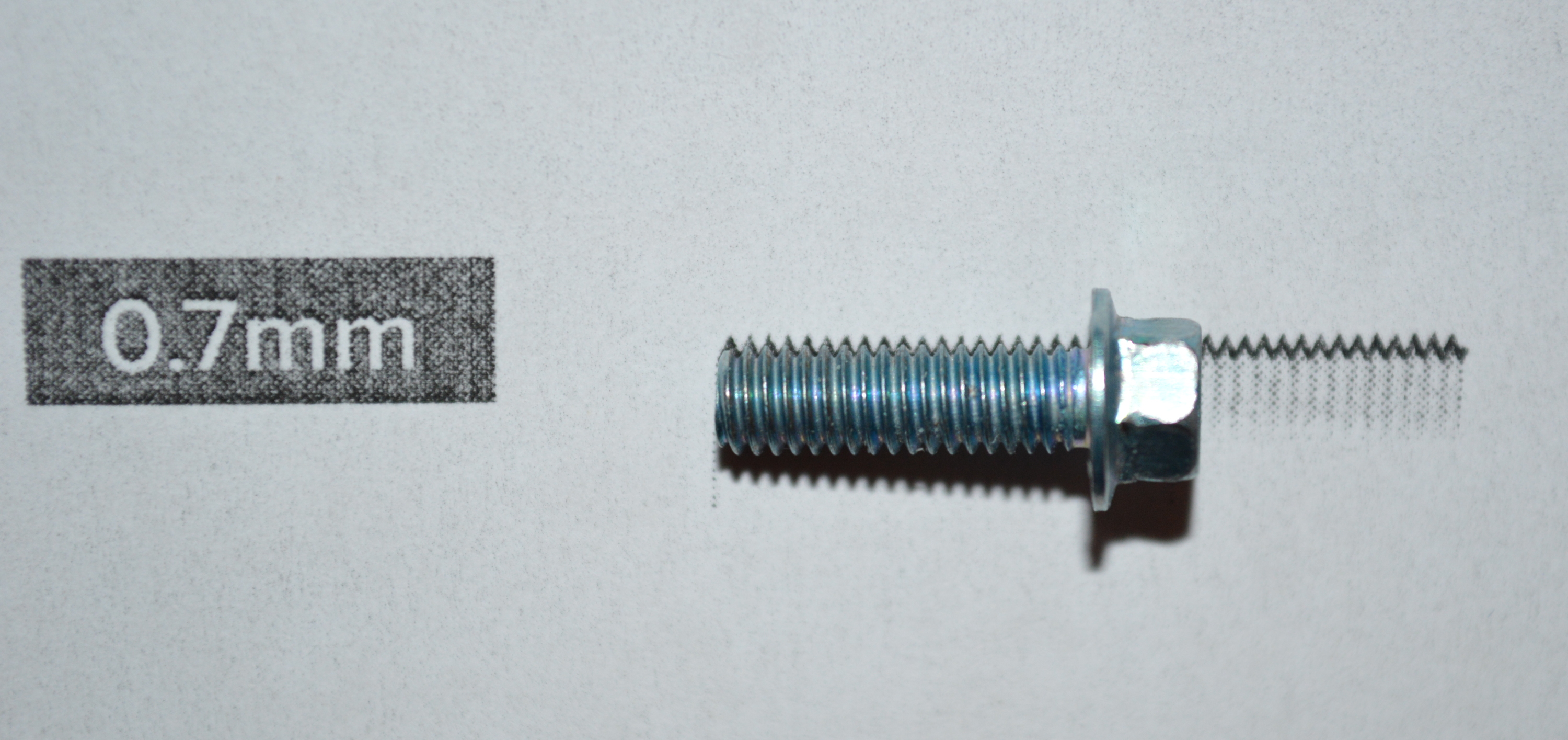

by j0d1
fohat wrote:You can replace screws but the heads will probably be different, Philips-head is easiest. Fs have metal sleeve inserts and use machine screws, while Ms have screws that are more like wood screws with aggressive threads.
I will try to find a perfect match for the screws:
  • Machine screw
  • 5.5 mm (7/32 inches) hex head
  • 17 mm long (including the head)
  • 7 mm pitch
I remove them by pushing them straight out from back to front with a small flat-head screwdriver. This strips off part of the "flange" or "skirt" but usually less than half of it.
I replace them by putting a large flat-head screwdriver into the "mouth" of the tab and pressing it straight down from front to back with the shaft of the screwdriver parallel to the surface of the plate (it takes some firm pressure). I do it while the final coat of paint is dry to the touch but not yet cured, in hopes that the paint will help "glue" them in place without making them silly hard to get back out.

So how did you go about derusting it? How do you know that there isn't rust further beneath the surface? I'm not questioning the quality of your work, just asking for my own current restoration project. :)
Vinegar will stop the oxidation but remember that the exposed metal is then even more susceptible to rust until you get something on it. Sandpaper or steel wool will remove surface rust, maybe a bit of grinding if it is really bad.
In the US some "Rustoleum" paint is specifically formulated to paint over rust and stop it (it will say something to that effect on the can). I use multiple light coats of primer and paint.

Vinegar and protective paint, got it. I've never done anything in terms of rust treatment before, but from my understanding it seems that soaking it in vinegar will remove parts of the metal entirely if they are rusted all the way through; is there a way to know if something has rusted that deep? And is there a way to stop it from just disintegrating during the deoxidisation process?
Posted: 23 Apr 2018, 14:32
by codemonkeymike
@DeChief I use Evapo-Rust, it is expensive but only attacks rust (mostly). Vinegar will induce some additional rusting if you introduce too much air into the mix, not a large concern if you only leave it for a day or so but would be an issue if you left it longer. If something has rusted deep then any sort of removal of rust will make the metal more brittle then before. I think if you are worried about something being rusted deep and it falling apart I would go with Evapo-rust and don't do any sanding, just bondo up the pits. My opinion on he matter.
If it is anything similar to the photo shown, that is no big deal. Most of the 122s that I have rehabbed have been at least that bad. I would recommend a quick sanding with a fine grit and then priming shortly thereafter, there is little need for more.

andrewjoy wrote: So how did you go about derusting it?
In my case, I used a dremel with a P80 grit sandpaper.
It took care of removing the rust and the original coating.
I have a big dremel so I had to manually sand some parts of the case that were unreachable otherwise.
In the future I want to acquire a smaller dremel with a steel wire wheel brushe, which should do a better / faster job.
After the sanding, I removed all particles with a wet cloth and let everything dry for a moment before applying the paint.
