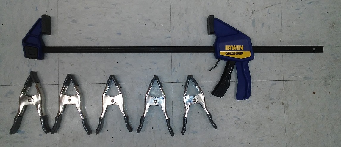

If you have gone to the trouble to repaint your plate, the sliding is likely to scrape under the clamp feet unless you pad them with fabric or cardboard. My guess is that you are looking at 3mm-4mm sideways.
The spring clamps that I show in my 122 ANSI guide have the advantage of spring pressure rather than absolute clamping.

As far as board reassembly - I did my first XT board "by hand" with hand pressure and a rubber mallet to align the plates - it was a major pain in the butt! Then I wised up and read more on DT and GH about rebuilding these boards and learned about clamps - as others have mentioned on this thread. My subsequent reassembles have been WAY easier! I've been using spring clamps and a bar clamp, like these:
I can't remember whose post I read about this on , and can't seem to find it right now, but with the spring clamps holding the plates together, I've found the bar clamp pops them back in position very easily!

I'll get a few more hand clamps. I only have 4 right now.
The one member advised using C-Clamps, but fohat recommended against it for reasons that seem quite sensible to someone who's never done it yet.

.... with the spring clamps holding the plates together, I've found the bar clamp pops them back in position very easily!
Thanks for this advice! I've started to prepare my tool kit. I'll proceed carefully to be sure I don't break anything.
