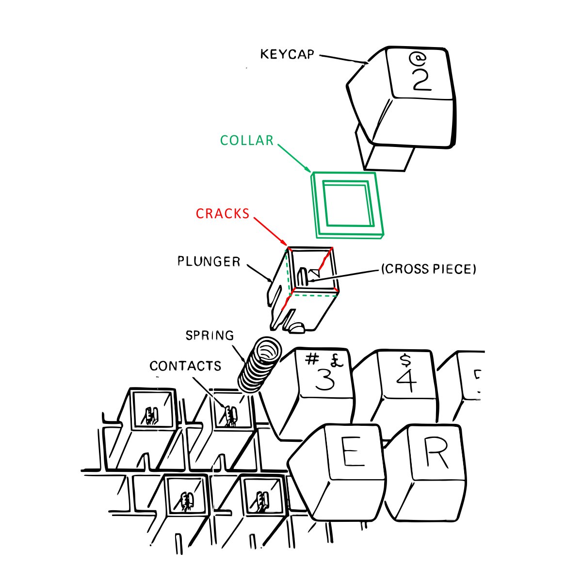

I'm restoring my Hazeltine terminal, which has Hi-Tek High Profile keys which are known to be fragile. And I think I've found a good solution on making these cracked keys work with a small modification.
Here I posted my illustrated story on how to fix them: https://imgur.com/gallery/lgZZZJ5

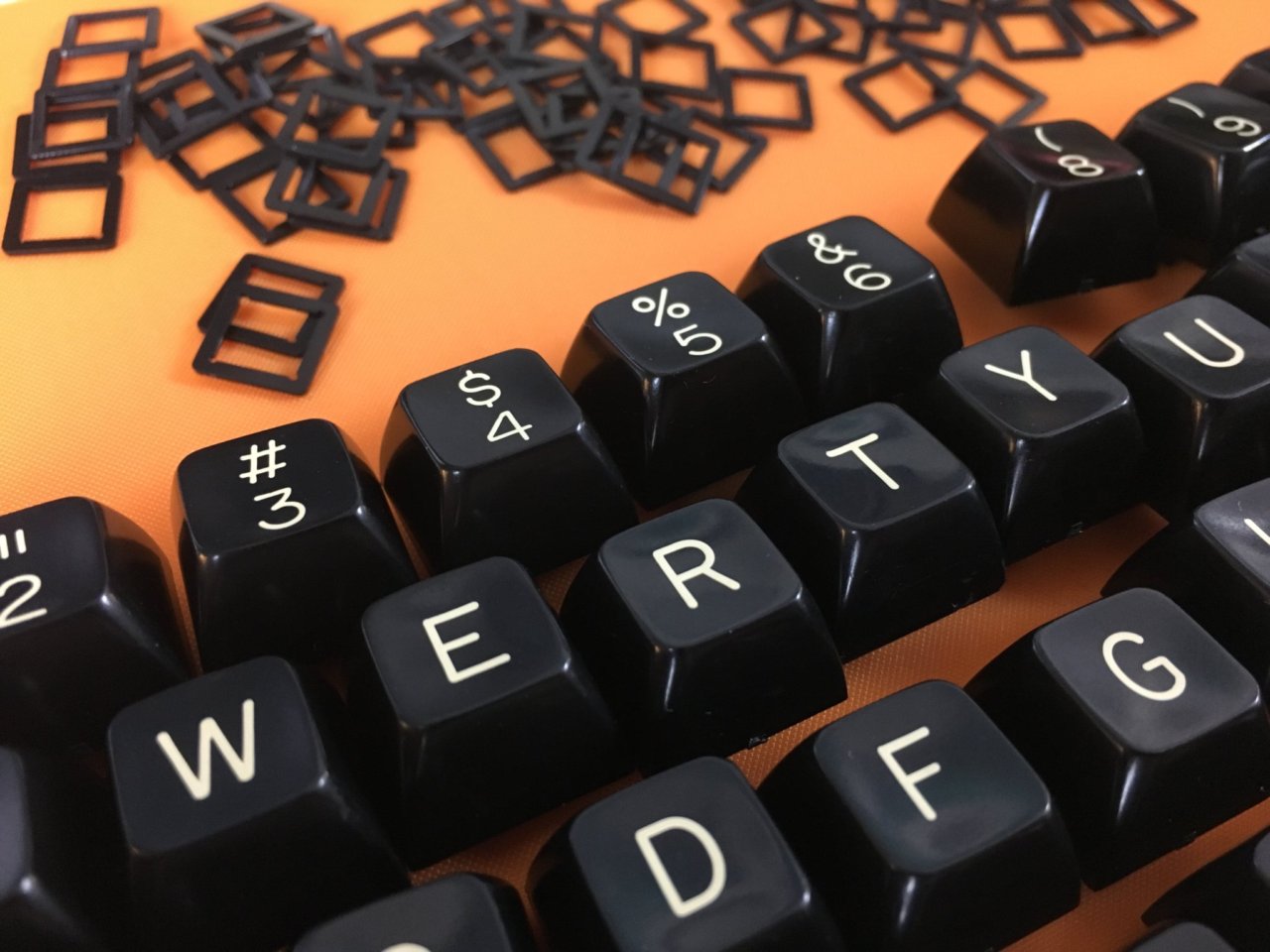

Designs I made are suitable to be printed on ponoko.com. When printing, choose either white or black Delrin plastic, 0.8mm thick, P1 size sheet (181x181mm).
Option 1: 64 collars on one 181x181mm sheet:
https://www.dropbox.com/s/zj1z1xpnik11j ... 4.eps?dl=0
Making them on Ponoko will cost you $16.10 + shipping.
Option 2: 144 collars on one 181x181mm sheet:
https://www.dropbox.com/s/ag78jvzme8mrj ... 4.eps?dl=0
Making them on Ponoko will cost you $30.63 + shipping.
You can also edit the file and leave just the right number of pieces on the sheet, which can shave off a few dollars from your order.

Just a quick update: after picking the right size, I ordered a full set of laser-cut collars for all the keys, and had the keyboard fully restored. The process of installing keycaps and collars turned out to be a very easy one, and I was spending just 10 seconds per key (to put the collar and install the keycap). I did have to remove the top part of the shell to work with the keyboard and then put it back on.
The keyboard now works flawlessly. I'm very pleased with the result and with the fact that you can fix even severely cracked key sliders with no keyboard disassembly and without using any donor keys.

caseybea, just measure one side of the rectangle (the stem) with a caliper, and make the collars with the same size of the opening. In my case, the outer size of the stem was 8.2x8.2mm on each side, and this is exactly how the inner rectangle hole of the collar measures for me. You may want to find one non-cracked switch to get a better measurement. When you put these collars, they are not really a snug fit, they fit pretty easily on top and require almost no pressure. But they for sure don't fall down the stem. As you put the key cap on top, it will try to push the sides of the stem outwards, thus securing the collars. It may take a bit of practice to put them on. Feel free to post pictures (here or in a private message) of it doesn't work, since your key caps / stems might just be different.
Also, if you're 3d-printing the collars, its actual dimensions might be a bit off from the original design. If so, adjust your design to account for this. In my case, I made the collars laser-cut, so they all have exact dimensions, and clean edges.

The dec VT100 hitek posts (white, main keyboard) seem to be averaging 8.1mm
The black hitek posts (keypad) seem to be averaging 8.2mm
The inner width of my collars seems to be about 8.25mm
Looks like I have to glue them.
There appears to be some variance in the hi-tek posts (white vs black).
The collars are not a tight fit (they should be in my opinion?)
Re: A solution for cracked Hi-Tek switches (VT100, Hazeltine, HP, etc.)
Posted: 07 Feb 2019, 06:38
by afan
I experimented with different options, and found that the best fit is when the sizes match exactly. So in your case you'd need collars with 8.1x8.1mm opening for the keyboard and 8.2x8.2mm for the keypad. Making them a tighter fit will just result in keycaps being too hard to put onto the stem.

I ended up just gluing the collars in the proper position with loctite plastic bonding system. A pain to do, but it actually did work. While the collars weren't exactly perfect for some keys, once held in place they still do the job keeping the crack from opening, and voila- no sticky keys.
I actually like the reduced travel of the keys, makes for easier typing on the vt100 keyboard.

All of the collars were too large with a center opening of 8.6 mm
I then had them remade using the default drawing size of 172.84 mm and got the correct 8.2 mm opening.
It turns out that the size of the part is scaled by the size you specify for the paper.
I guess I should have known but I am new to this.
Specifying 175 mm will get 8.3 mm, 177 mm will get 8.4 mm, 179.1 will get 8.5 mm etc.

A while back I remade this design in Autodesk Inventor and had them cut from 316 stainless with Laserboost. Price ended up at about $0.23/piece shipped. They work great but they're insanely loud. I chose 1mm thickness which has noticeably less travel. If anyone's planning on doing the same I'd recommend choosing a bit thinner material. I went with 8.07mm which ended up very snug but they still fit the particular variants I have.
There were a few that came out a bit weird but the vast majority of them were fine. Pretty sure LB sent me extras anyways.
