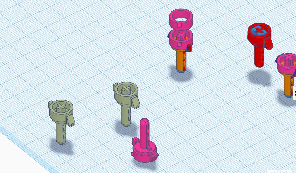

by SneakyRobb
Hi,
I need to update my 3d models as I am still learning FreeCad, but you basically can just print/mold a new stem out of plastic/resin.
Then insert it into the slider part.
- stems.JPG (160.96 KiB) Viewed 7124 times
