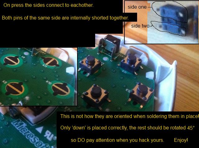

:!: I just noticed something, your pic of the switches before soldering is misleading, it doesn't show how you actually have placed the buttons; if soldered down like this, 3/4 buttons will be always triggering (unless the other pins are not touching the copper, not even through pressure) so careful readers!
switch orientation.jpg (59.64 KiB) Viewed 25077 times
So again, any orientation *can* work, provided you are aware what points to isolate and which to solder.
Otherwise, just solder all the pins in the orientation that's indicated in the text on the pic.

Off: :Quadruple Facepalm: I TOTALLY forgot to mention that. Sorry readers! Off is correct, the 2 pins that are directly across from each other will complete the circuit. See his pic! What I did was: I bent the pins beneath the switch and soldered them on that way (surprisingly easier than expected).
Plus, your project seems cool can we get some pics!! :D
**Scratch This**
[EDIT] :!: "Down" (A button) is placed incorrectly. The pins directly opposite from each other close the circuit. Only 2 out of the four pins need to be soldered for the circuit to be closed since the switch is SPST. I believe that they call that "One-way" in Britain. As I said above, I bent the two that I used underneath the switch, tinned them, tinned the copper (after scraping off the pads) and then soldered button to pad.
**This here is good**
[EDIT 2] What Off said below is correct I seem to have confused myself somehow :?: Thanks off!

Reddog9287 wrote:Off: :Quadruple Facepalm: I TOTALLY forgot to mention that. Sorry readers! Off is correct, the 2 pins that are directly across from each other will complete the circuit. See his pic! What I did was: I bent the pins beneath the switch and soldered them on that way (surprisingly easier than expected).
:o :o :o :o :o
:!: Stop confusing the (potential) readers man*, my pic is correct in pointing out that the 'A' button is the only one oriented correctly...
I just rechecked with the single button I haven't soldered in that the pins that are on the same side, facing the same way, having the same orientation if you will, are the ones that will connect to eachother when the button is pressed; the ones opposite eachother, the ones that, when folded under the button will touch one another, are already internally connected through a short. :!:
Now where's that quintuple facepalm. :roll:
on that note, you might want to update the OP with the correct info re switch orientation
