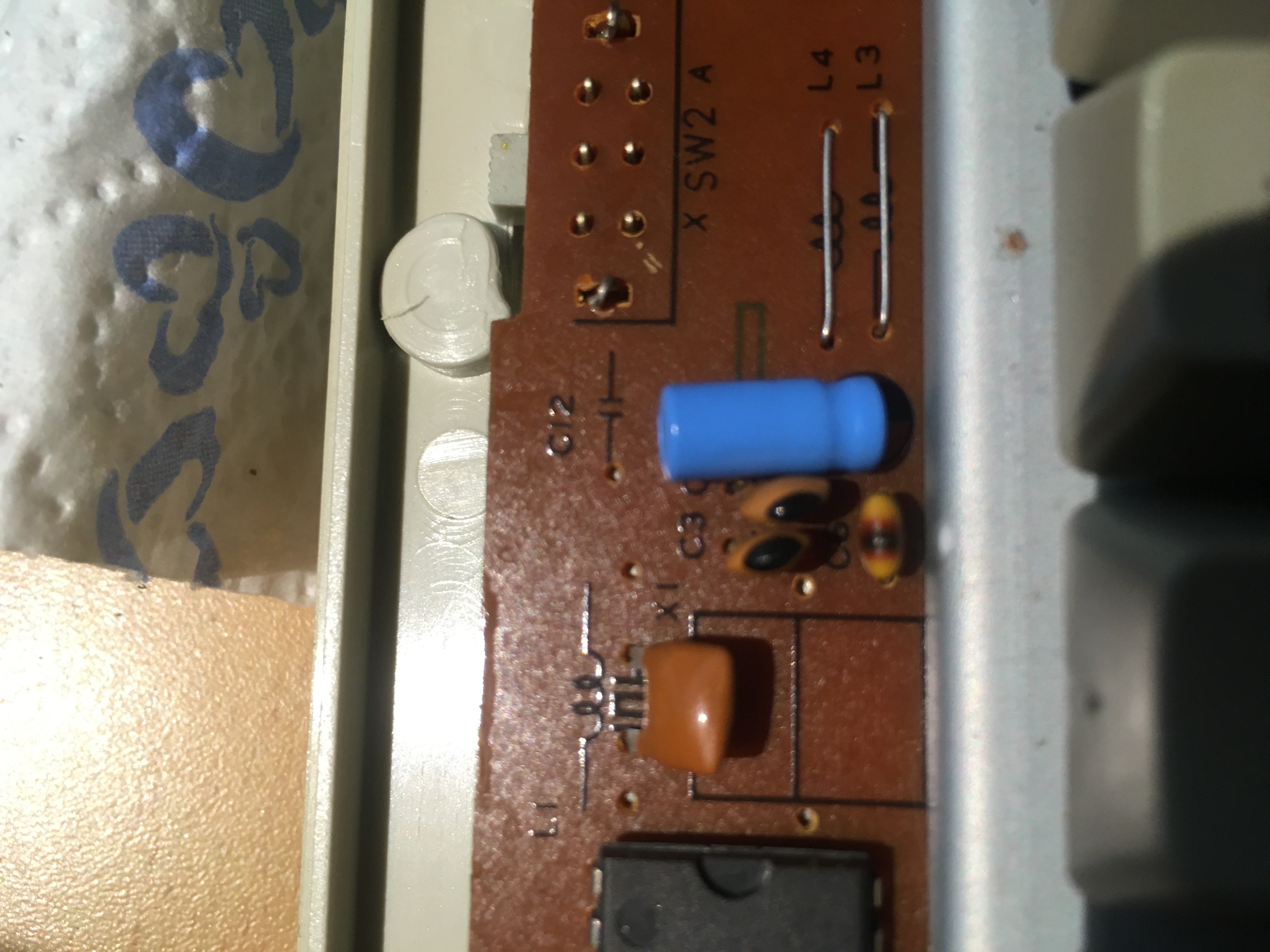

greetings
found the board in a realy great condition...so i orderd the adapter it arrived today.plug all in and i tryd the keyboard the first time (key tester)...immediately i fall in love ^^so i playd a bit typing of the dead and stuff... it workd all good
6h later i noticed the keyboard startet to behave strange... keys dont work or sometimes they do ...random disconnect flashing lights ...a windows massage popd up saying somthing like the adapter cant provide enought voltage ...and than i smelld smoke :o
anyways ih managed to open the case without breaking anything (was not that easy) ...
iam not sure but ih think its the capacitor under the two c3 ones that blew up...did some onenow the value of that specific capacitor
and here some more fotos from the boad
in the mean time ih clean the keycaps and the case
hope someone can help me out

On my FK-2001 that part is marked "6.00". But it has an "L1" legend and an coil symbol printed on the PC board, which means it's an inductor, not a capacitor. For that part to be burned there must be something downhill from it drawing too much current. Inductors don't just go bad like capactors sometimes do; they're just an insulated piece of wire wound into a coil. I would suspect the blue electrolytic cap next to it, or something else in that part of the circuit that gets its power through the inductor.

thanks for your help! L1 looks fine ..when you look on the pic what i made you see the blue electrolytic cap(c12)
than on the left they are 3 ceramic capacitor (c3 and c? the blue one hide it) c3 and the other one have a black dot or stripe on the top the 3. one is burnd black :D

Mine is an FK-2001 so it's laid out slightly differently. L1 is "missing" (not used) on your PC board. The orange part below it is a crystal, denoted by "X1". And I believe that's what the "6.00" part on mine is, although it's not labeled as such. What does the legend say on your PC board for the burnt part? On my board there is a tantalum cap nearby, C12, which is 3.3uf 16V. That's a likely part to go bad, and might be what the burnt part is on yours.
I've got another early FK-2001 here that I can open up and check.
edit: I opened up an FK-3001 and the third capacitor (marked with an "A") on that one is labeled 0.1uF on the PC board under the edge of the plate <attached>. That's an unpolarized cap, monoceramic type, probably a 50 volt rating, although it's not labeled. There are several other identical caps on the FK-3001.

@Polecat thank you so much for helping me out and open all the keyboards :D
i bend the cap a bit away and now we can see the part name its c6

If it's a 0.1uF cap as I'm guessing it's probably connected across the 5 volt power and there would be several others at various spots on the board to reduce electrical noise. If that's the case try simply removing the cap or unsoldering one lead temporarily to see if the keyboard works normally. If it's part of the oscillator circuit or if there's another problem the keyboard won't work, but you won't hurt anything by trying that.

oh ok i see but i have to bridge those two points than right?^^
Re: help! focus fk-2002 escom alps skcm blue
Posted: 08 Aug 2020, 21:55
by Polecat
wanderhoden wrote: 08 Aug 2020, 21:52 oh ok i see but i have to bridge those two points than right?^^
No! Don't do that or you'll short out the 5 volt power and that will do major damage. Just unsolder one lead and carefully bend the cap up and away from the PC board so it's no longer connected.

iam not sure but i think that happend anyway couse the keyboard cable was also warm ;/
Posted: 08 Aug 2020, 22:33
by Polecat
That could happen if the capacitor itself is shorted, and that seems likely seeing how it's burnt. Disconnecting the cap should allow the keyboard to work normally in that case as long as nothing else is damaged.
edit - that might sound contradictory, but a bad cap isn't necessarily a dead short, like you'd have if you connected the two pads together.

ah you are right both legs are on the same traid

No, a capacitor wouldn't do anything if its legs are connected totether. The pads you circled will be the bottom legs of the two ceramic caps. The two pads below the circle will be the cap in question. But a bypass capacitor connects *across* power, not in line with it, so you never want to connect the pads together when troubleshooting.

uh ah ok now iam with you :D ih tought it must be a closed circle^^ :P

wooohoo it works now
yeah you was right i was a bit of :D it was under the two i markd ....the cap have 104 on it

Nice, glad to hear that! 104 is the code for a 0.1uF cap, and the monoceramic type typically comes in a 50 volt rating. Not critical, those are there to suppress electrical noise and interference, but it's cheap and easy if you want to replace it.

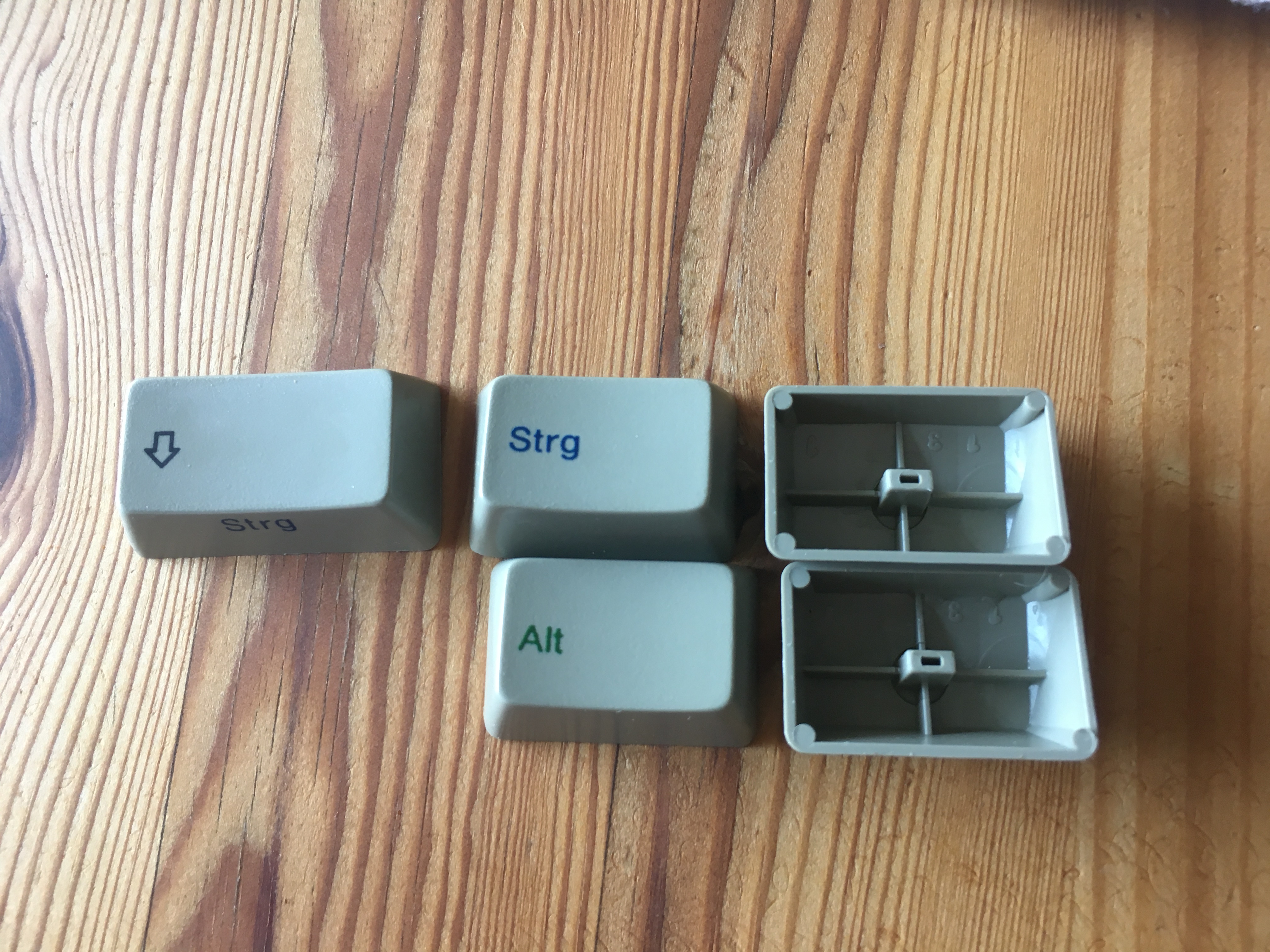

1 question i still have the keyboard and the keys are awesome but the keycaps i rly dont like those there a so thin ...i mean my main keyboard was a gen1 model m looking 4 thiker keycaps ....do you have any suggsetions where i can find some nice ones ?
I bought the black Focus brand new at a computer show back in the '90s. It was unusual even then, and I've only seen a few of them in all the years since. I finally got it where I wanted it, with an ansi-fied FK-2001 layout and double shot caps.
Sorry, I don't know of a source for new Focus keycaps as a set, especially for an ISO version. Almost every Alps keyboard uses a different layout, and new Alps keycap choices are very limited. To make matters worse, the stem positions on the Enter and Caps Lock keys aren't consistent between Alps keyboards. I've pieced together sets for several different Alps boards, mostly using Tai Hao sets as a starting point, but those aren't any thicker than the Focus caps. Perhaps someone else here has more info on this?

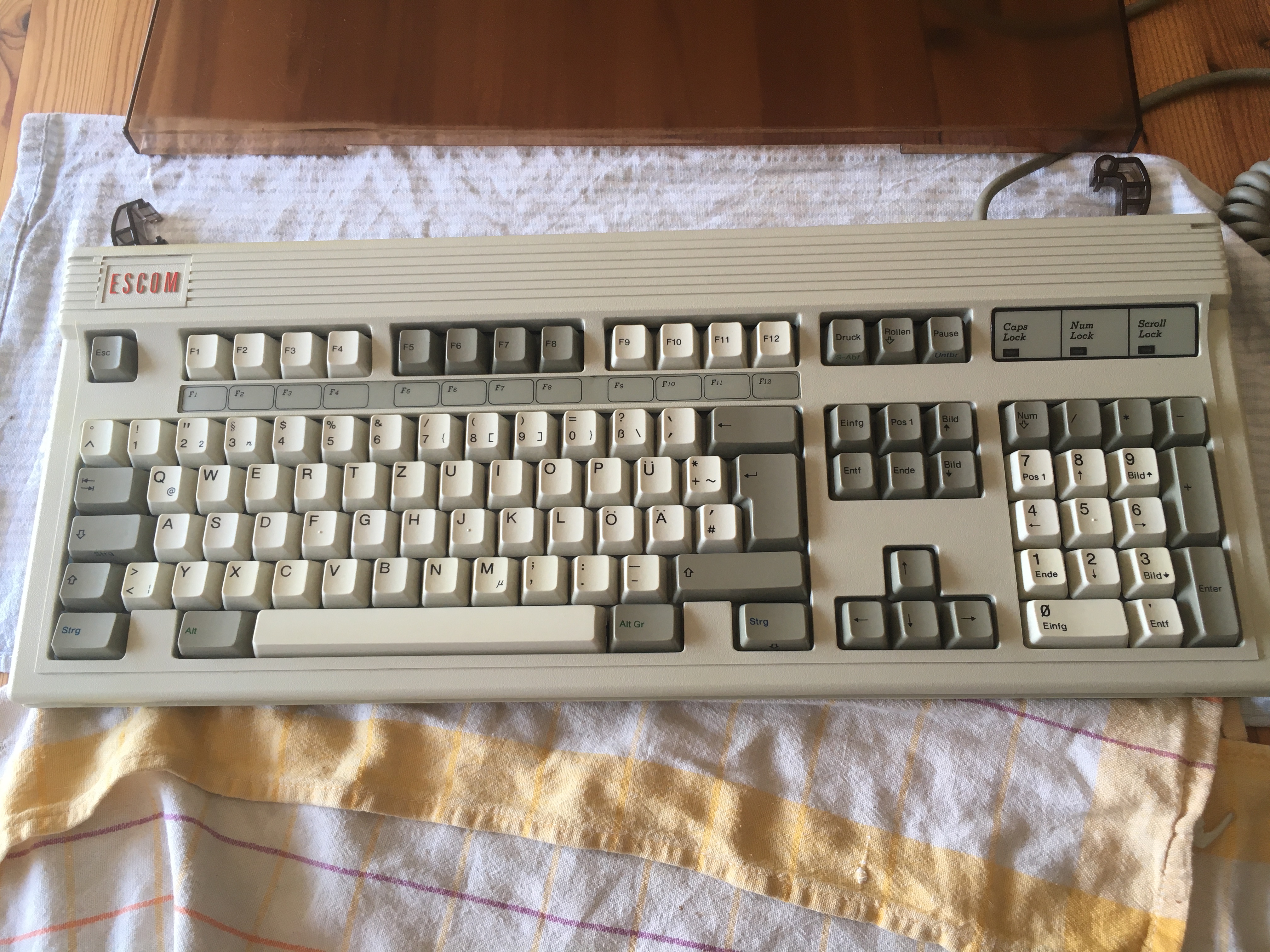

here some pics from the inside
the switchplates are white ....i tought they are grey ?

wanderhoden wrote: 12 Aug 2020, 23:28 here some pics from the inside
Wiki says white after 1987, so that agrees with yours:
wiki/Alps_SKCL/SKCM_series

just to finish this up ...got the capisator...all set and rdy
but i still dont like the keycaps
and here some fotos what i made
