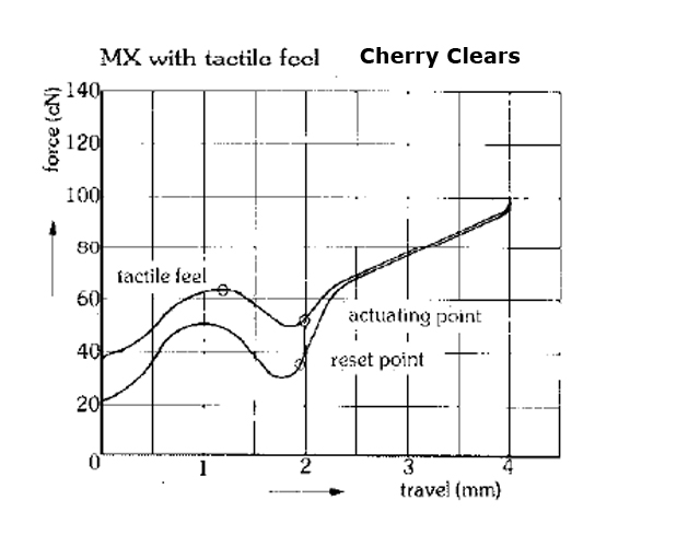

The 'strength' of a spring isn't about activation force - it's about how the force changes with compression. Two springs of different strength could result in the same activation point. It's the slope of the graph.
Comparing Cherry's force graphs for each switch, they have a different slope after the activation point. I believe this part of the graph is most representative of the raw spring strength.
I only measured a couple of springs of each type, but it appears to replicate what limmy found about brown vs blue (I don't have any reds). I agree more meaurements would be needed to make any firm conclusion.
It's pretty obvious that Cherry have some method for specifying a spring, that results in different springs for the black/clear/green group. In order of increasing strength we have: green < black < clear. However, if each was fitted to a black stem, the difference in activation force would be pretty small - the differences become larger towards the top and bottom of the travel.
I suspect they have applied the same method for red/brown/blue springs, it's just that the difference is less noticable. But, we would expect that ordering them by strength would give us: blue < red < brown, if the same method was used as for green/black/clear (In other words: clicky < linear < tactile), and that's not what the measurements suggest.

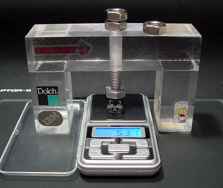

Here are more ideas on spring measuring equipment.
http://www.kbdmania.net/xe/577459
Source: http://www.kbdmania.net/xe/577459 by Scarface 2008
http://www.kbdmania.net/xe/533305
Source: http://www.kbdmania.net/xe/533305 by Ddogakddogak 2006

At least I know that Soarer's Clear Spring numbers agree with my ever so primitive Nickel testing. Damn Cherry Corp Force Graph is WRONG!
Germans aren't gonna like hearing this:
Cherry Clear Force Diagram.jpg (78.31 KiB) Viewed 18943 times
