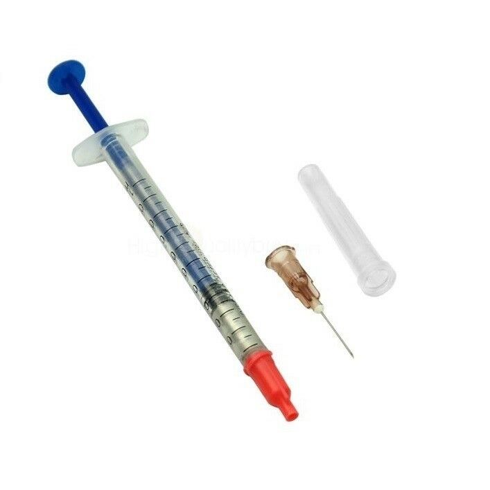

I would encourage you to consider silver conductive glue/paste for future membrane repairs. It's worked really well for me.
I've also used archival quality packing tape to hold membranes together.

XMIT wrote: 31 Mar 2021, 20:31 Nice!!!
Was considering a conductive glue for attaching the wires but i figured it wouldnt be any thinner than taping them. However using it to draw traces over the tape bridge etc to somewhere with more space to attach wires could definitely be an improvement (some wires are probably unavoidable since the traces would need to overlap). Not too eager to deal with membranes again though :lol:
