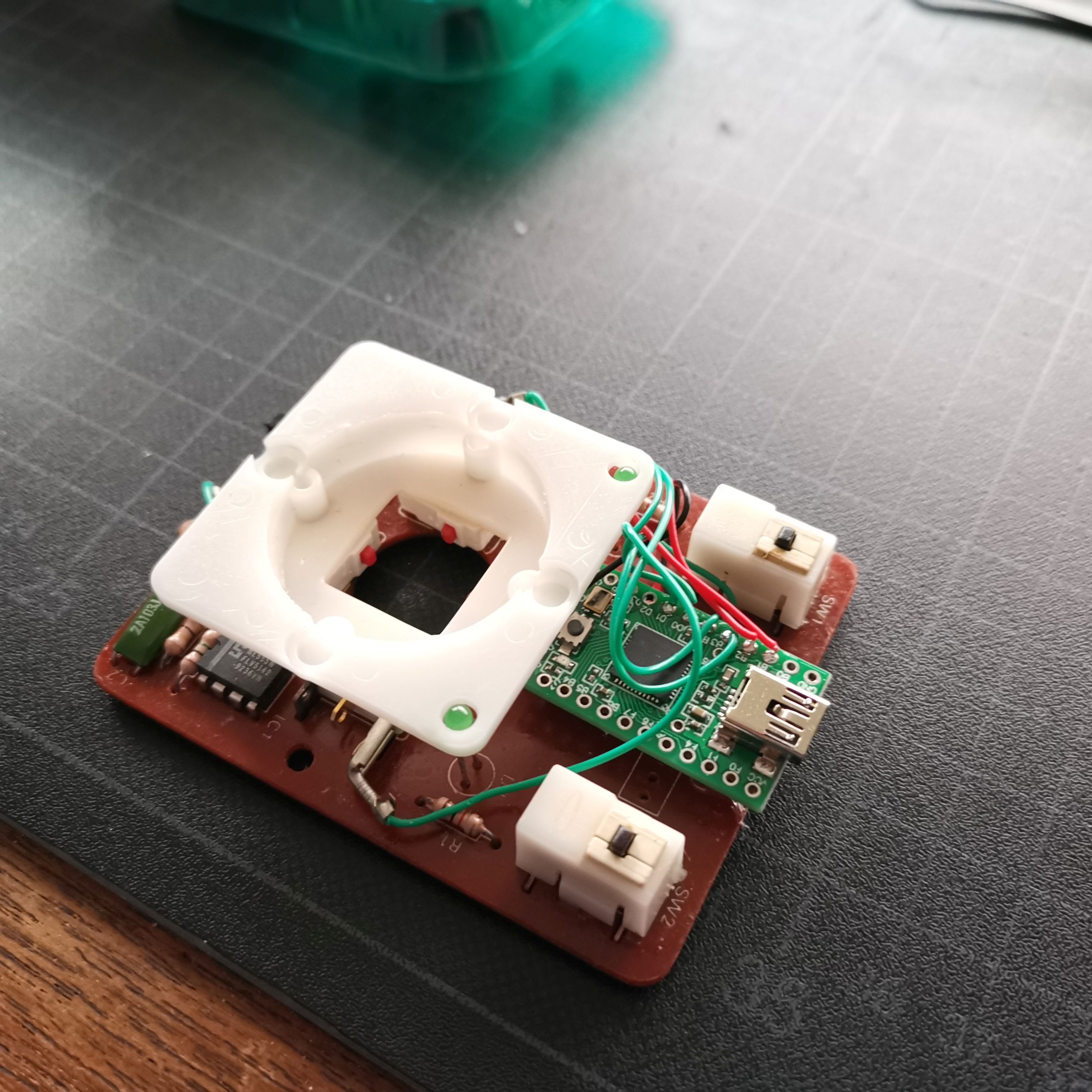

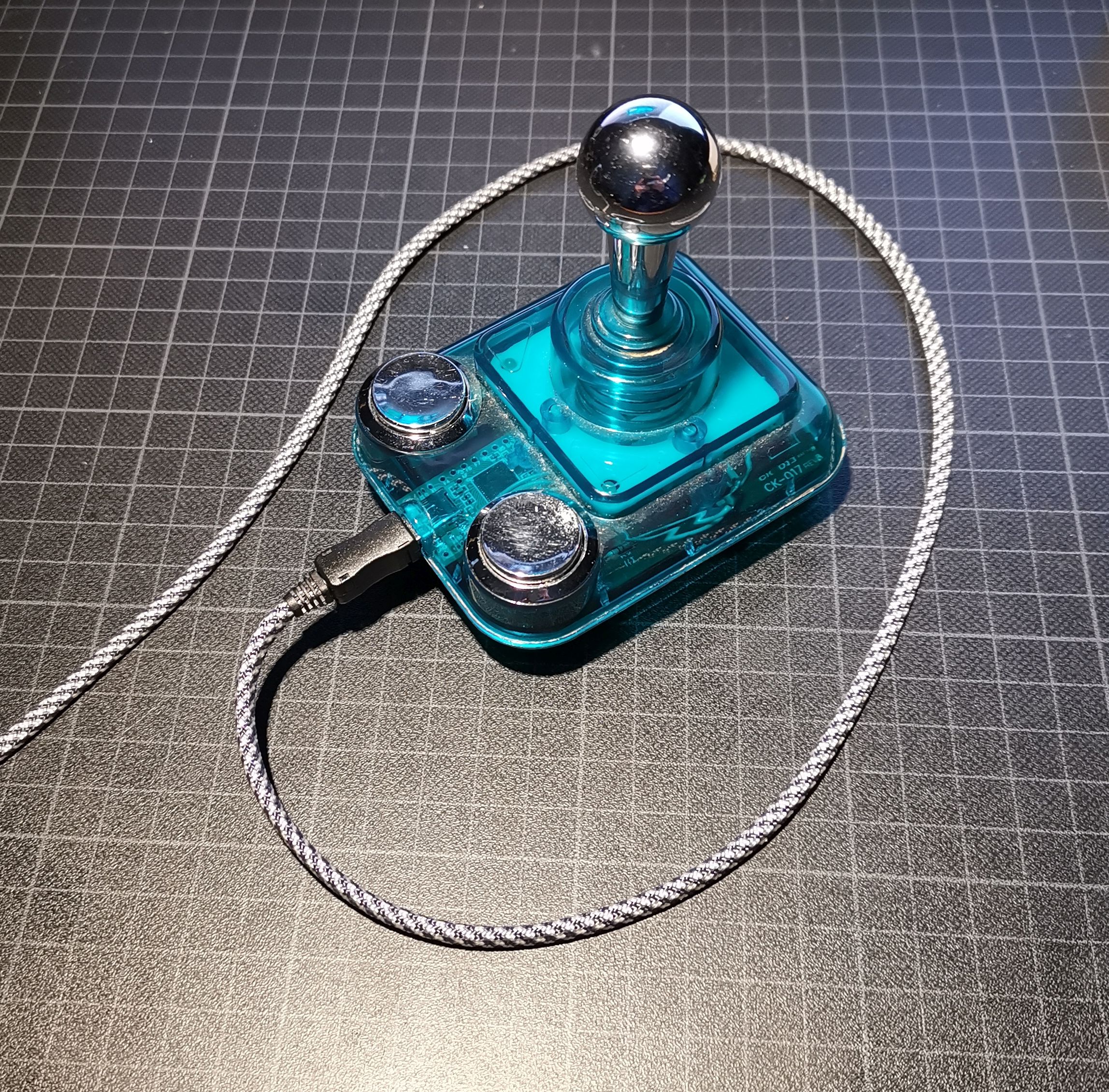

Posted: 18 Apr 2021, 23:29
by CeeSA
- Comp Mini.jpg (1.41 MiB) Viewed 30289 times
- comp mini pcb.jpg (754.51 KiB) Viewed 30289 times
Because the pcb is also the switch holder, I reused the PCB for ground connections etc.
I replaced the switches for the directions. I could not get the original one, so I have to take every switch apart and change one internal switch pins. Alltogether it made a lot more work than I thought.
Nice to have a keyboard joystick. So it willl work with many OS's / Devices.

Cool! Did you keep the auto-fire in some way, or did anything else useful with the switch?
Hmm.. So keyboard protocol is useful for game controllers, huh? Which keys did you map?

Posted: 19 Apr 2021, 09:48
by CeeSA
# Competition Pro Mini
matrix
scanrate 1
debounce 5
blocking 0
sense PB1 PB2 PB3 PB7 PD0 PD1
strobe PB4 LCTRL LALT down right left up
end
The auto-fire is actually not in function.
Re: Joystick Competition Mini w/ Teensy
Posted: 22 Apr 2021, 02:58
by Rayndalf
This is a really clean conversion, even with the translucent shell most poeple wouldn't realize it was modified.
It's the perfect size for a crowed desk. I wonder how it compares to the Logitech Wingman Attack 3 I picked up years ago.
Most joysticks that aren't terrible actually seem pretty good. Sure beat using the arrow keys anyway.
