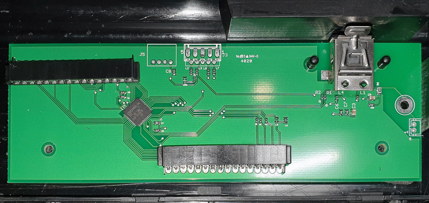

Muirium wrote: 23 Apr 2021, 23:55 Chyros covered it on his review. Unicomp hacked up the matrix to approximate marketing essential NKRO from what is fundamentally 2KRO membrane hardware. As I recall they also wanted to claim very high polling rate. They wound up needing two controllers to pull all this off, and, being Unicomp, they made a bit of an arse out of it.
Basically, they increase the matrix so they could strategically 'place' keys in a way they're unlikely to block with each other. The new matrix is 12x16 for just 8x keys vs 8x16 that 1xx key Ms use. At the same time, they've written new firmware for supporting the numpad layer and better suppressing phantom key generation. The latter of which is probably at fault here.
By "two controllers", do you mean physically or an 'enumeration to the operating system' technique? This is what the only PCB in the Mini M looks like:
The comments about the USB I can agree with. The standards part makes sense of course, but I like the pressure-locking solution it has versus what seems to be manual-screwing solutions for Type-C at present.

sharktastica wrote: 24 Apr 2021, 00:28 By "two controllers", do you mean physically or an 'enumeration to the operating system' technique?
Your pic answers it nicely: clearly the latter! So hopefully it's something they can fix in firmware. Extra points if the firmware update can be performed by end users.

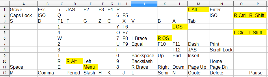

I posted this in another thread. Sharing here too. Biggest risk of blocking/ghosting on columns C and H. Hold down any two numbers and it will block two keys on the QWERT row.
M Mini matrix.png (24 KiB) Viewed 7663 times
