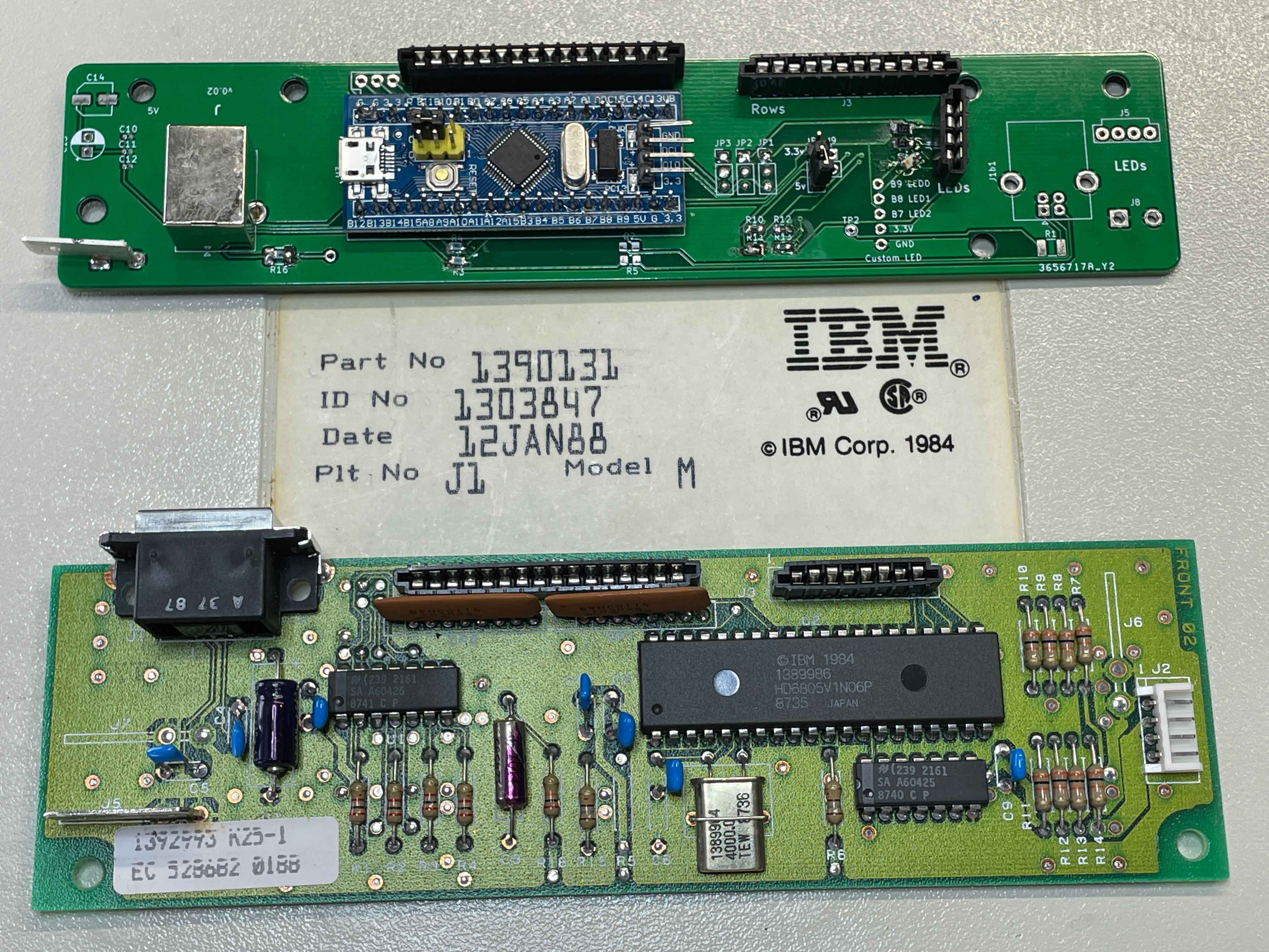

I'm working on building a QMK compatible controller for my Unicomp New Model M. As much as I like this keyboard, the controller in this thing is just flaky as all get out. Hangs after booting requiring a replug, etc.
I noticed something odd the moment I opened it up - instead of having the 16x8 matrix of vintage Model M boards, the controller and matrix ribbon cable both have 25 total connectors! This obviously can't be a 16x8 matrix, as there's an extra connector somewhere.
Has anyone decoded the New Model M matrix yet? I could potentially do this myself, but I'd have to drill out the rivets on my perfectly good new keyboard to get a look at the membrane.
Even if anyone knows which of the connections are rows and which are columns, that would be incredibly useful.
Anyway, please let me know if you've got info on this. I plan on posting all my design files online once I've got this working.

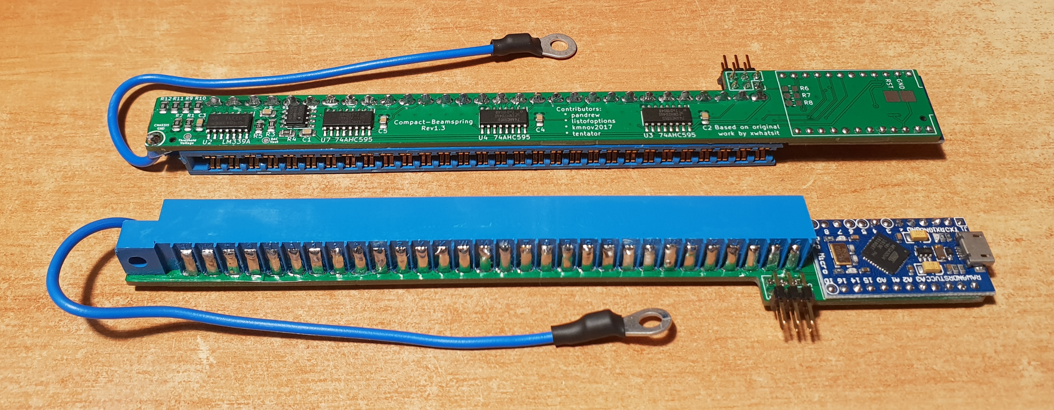

See for some additional info on a project that I am collaborating on with Wendell from Level1Techs.
https://youtu.be/xCHbd3x13rU
https://gitlab.com/esr/m-star
I primarily am contributing on testing and validating the new prototype of a QMK-based controller to add built-in USB support with a variety of vintage IBM and Lexmark model M keyboards (1985 - 1999)
2021 M-star. Replacement for 1988 model M controller

This project was the inspiration for making a New Model M replacement controller.
Sadly both the matrix and controller are totally different between the Mini M and New Model M, which is why I'm going down the path of building my own controller. The Mini M has a much larger matrix and membrane mounted lock lights, while the New Model M has a slightly bigger than vintage and controller mounted LEDs. The controller to membrane attachment method is totally different too.
Sounds like I'll have to build my controller and then use some custom firmware to read out the matrix codes as I press keys. Annoying, but not the worst thing in life.

I made an open source controller design here:
https://github.com/purdeaandrei/overnum ... roller_1xb
Unfortunately you can't order it as it is from JLCPCB right now, cause of the chip shortage.
I have a batch that I ordered before the chip went out of stock, that I will be selling, but first I need to experiment with depositing some carbon/graphite onto the contact pads. The controllers work fine without carbon, I'm just a little concerned about longevity without carbon. There is definitely a reason why Unicomp deposits carbon onto its controllers, and why the same carbon is deposited onto the membrane contact pads in normal Model M membranes.
Feel free to reuse information from the above project for your own design. For instance it may be worth designing a variant with the rp2040 chip as it will likely be supported by qmk I think.

pandrew wrote: 10 Sep 2021, 23:00 I made an open source controller design here:
Thank you, this is fantastic! This has all the hard parts of the board design done - getting the matrix landing pads and mounting screw holes in the correct location.
My plan is to use an existing SMT32 board similar to a Blue Pill and have my custom board simply receive the Blue Pill plus lock light LEDs/resistors. My only concern is that the Blue Pill doesn't have castellations, so I need to mount it to the main board with headers. I'm not entirely sure there's enough clearance in the New Model M case for that.
Were I up for doing my own surface mount soldering, the RP2040 would indeed be perfect for the application. Unfortunately the Raspberry Pi Pico board that I could easily use at home is a couple GPIO pins short of driving a 16x8 matrix plus three lock lights.
Anyway, thanks for the tip, your design looks great. Its very unfortunate that its nearly impossible to source raw STM32 parts at the moment .
Also, as for the graphite on the landing pads, I've been wondering if simply tinning them with solder with be good enough. The main problem with leaving the bare landing pads exposed is that copper will eventually oxidize, leaving a poorly conducting surface.

If you look at my design, you will see:
1) a square on the left, marking the area where a plastic hook holds the board on some, but not all unicomps. Apparently this hook is missing on the New Model M.
2) circles around the top row of LEDs. Those show the area where there are plastic pieces of the top case that are holding down the controller when the keyboard is closed.
You will probably want to avoid placing anything in those areas especially daughter-boards.
I don't know if there's enough space for a bluepill, but I can say, it's possible to mount a board onto another without castellated holes, you just need good plated-through holes, flux, and good soldering equipment. If the holes are not too small, you can make them wick through. You can see for an example the first couple compact beamspring controllers I've assembled here: download/file.php?id=62971
Also be careful with the hole sizes, there are two variants, for the new M use the larger holes.
