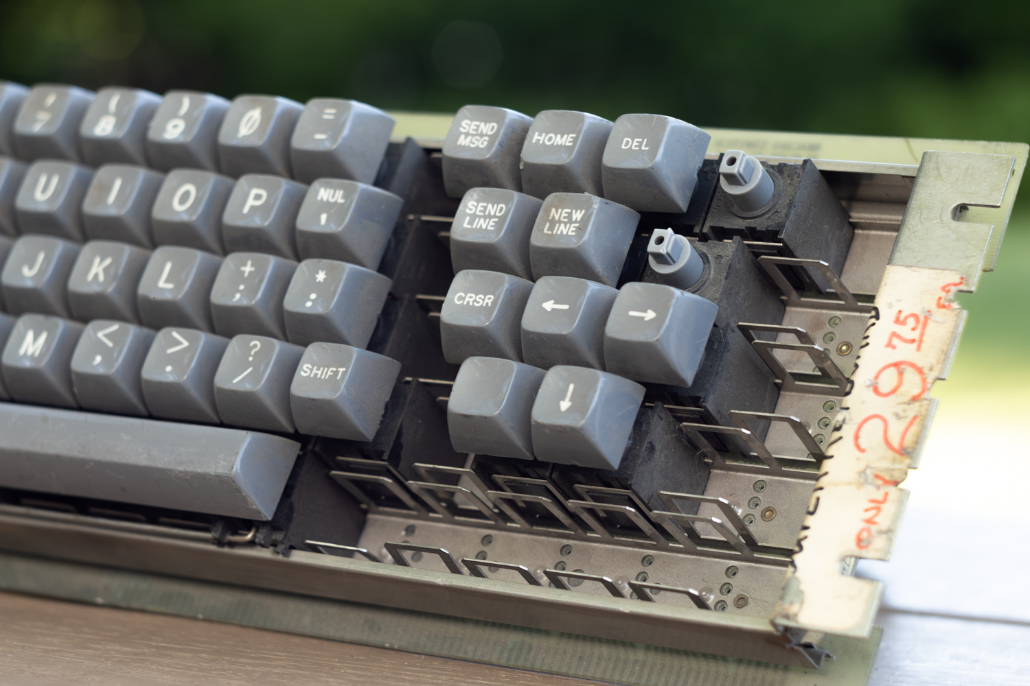

Close-up shot of the keys and switches. It's missing a few caps but is in otherwise decent condition considering I literally pulled it out of a pile of e-waste.
There's a piece of tape on it that says Super Keyboard! Looks like it was sold at some point for $29.75 which is a steal in my book 😄 I forget how much the recycling center charged me for each keyboard I took home.
The switches are each labeled:
6926
1SW1
Pretty hard to see but the label on the side has the following information...
Cat. List. K5 0326-S2SW3
Ser. No. 006
Date 6933
The reverse side of the PCB indicates it was made by Micro Switch in Freeport, IL
There's more text on the PCB that says:
SW-10033 [3]
And here's a wider shot of the PCB which shows how the keys are numbered and the nifty routing of the traces. 45 degree angles are for wimps! Hand routing is way cooler.

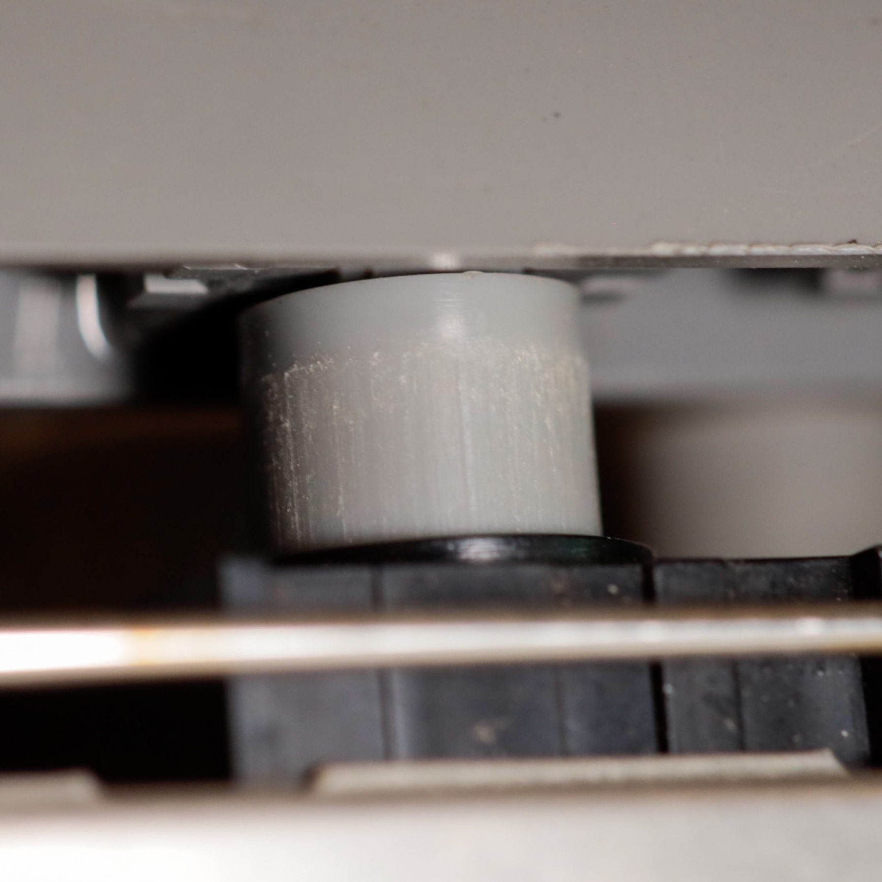

Feels pretty good all things considered. I want to make a typing video and capture the sound real well but unfortunately the spacebar doesn’t return when pressed. It gets barely stuck enough that a small tap releases it but it won’t pop back on its own.
Upon closer inspection I see that there’s some grime on that key’s slider. I think cleaning that stuff off would resolve the issue but I don’t know a safe technique to remove the stabilizer wire and I’d die if I broke off one of the plastic clips.

Yay, the spacebar is fixed!
The "grime" on the switch slider was a misdirect. I think those are just friction marks with a small amount of dirt. Trying to clean the slider off did not do the trick.
I worked up the nerve to remove the stabilizer wire and it was actually quite painless.
Looking at the spacebar stabilizer prongs (?), I found that one of them was slightly bent. Probably due to being smashed under a bunch of other keyboard in the recycling facility.
I used a set of needle-nose and regular pliers wrapped in electrical tape to straighten out the bent one as best I could.
Then I sprayed a touch of DuPont Dry Film Lubricant to the two prongs for good measure. I did not lube the switch.
The spray leaves a thin coat of white film which should help reduce friction a bit.
I of course gave these parts a good wipe down to get all the dirt off first. There was quite a bit of junk, both on the prongs and in the housing that the prong slides in and out of.
After all these steps, the spacebar works quite nicely now!

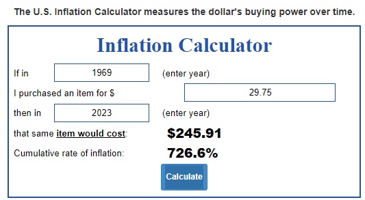

      I would certainly value it under $300 considering it is just the module and missing a few keys but what a great save and these early SW series switches are hard to come by these days
      Considering inflation the 29.75 would have been much better spent in the stock market ;)
